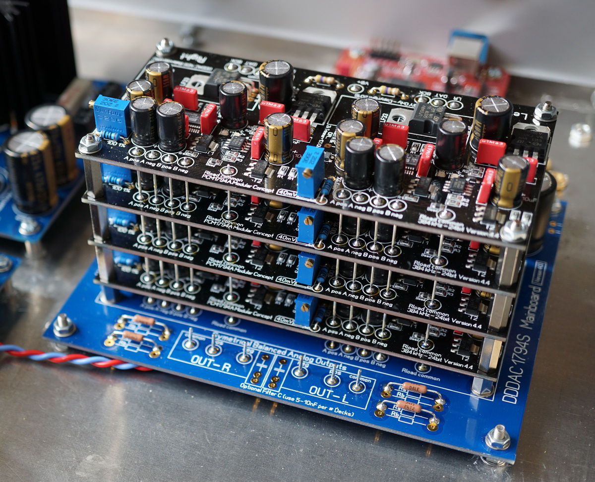

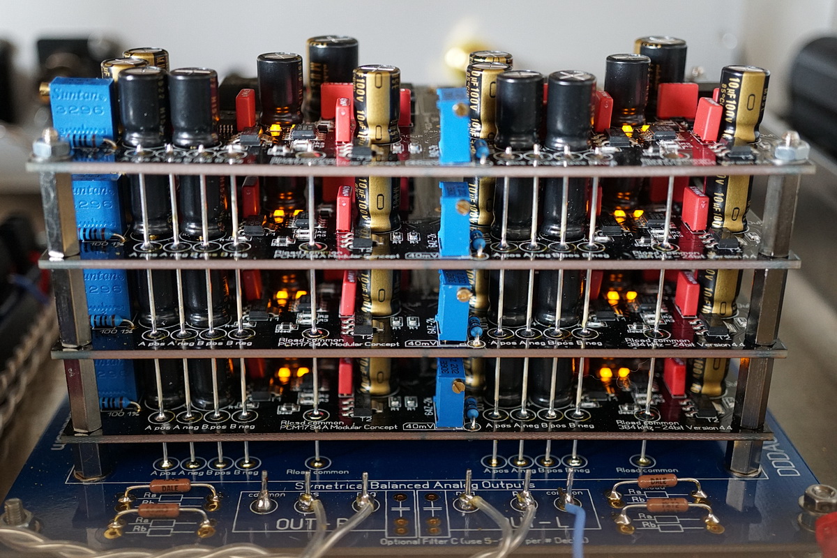

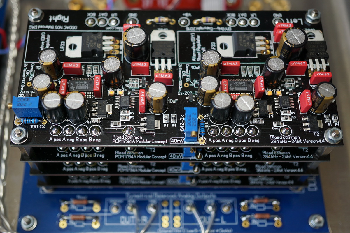

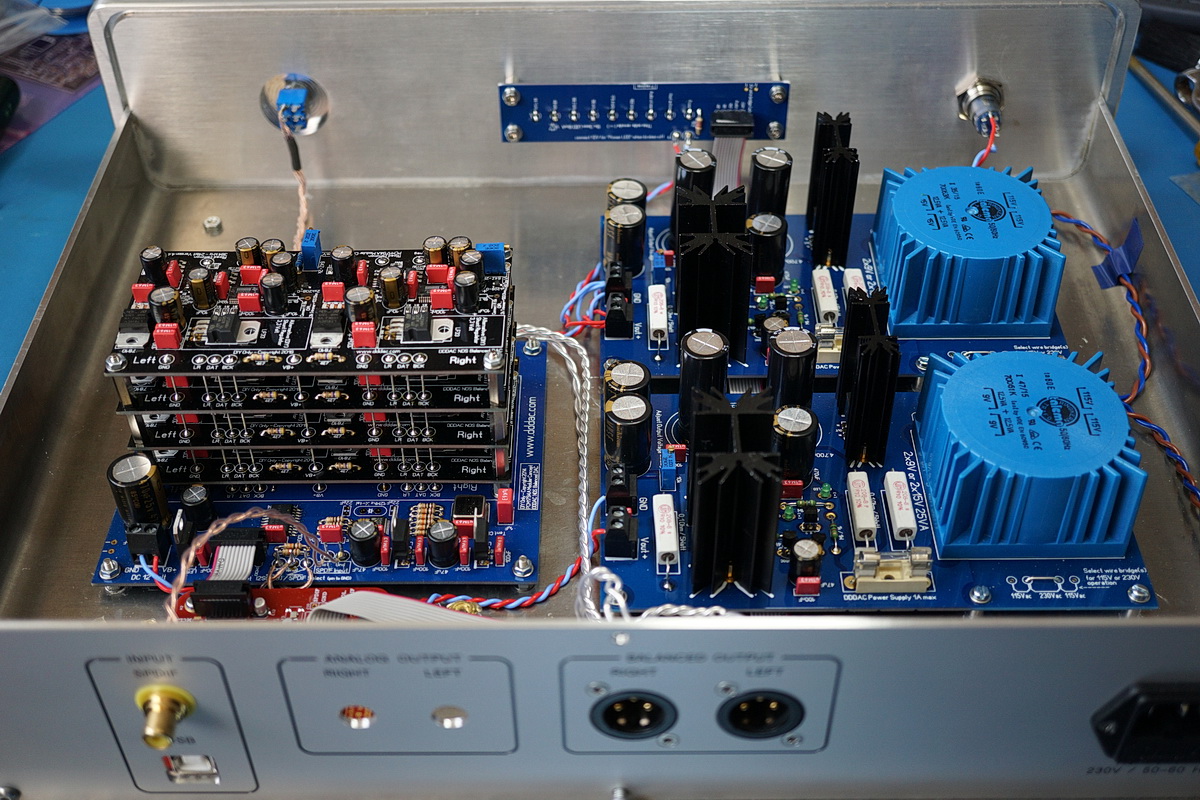

First pictures of the new DDDAC1794 boards in action...
The first DDDAC1794 Quatro with the new boards is build today and in action...

While a desoldering station is probably nice to have, I just cut the wires to remove the DAC boards and swap the "delay" resistors on the DAC boards.
now i tried with 2 decks and it works; no crackling and superb sound. back to 3 decks and crackling is back. changed the decks but no more than 2 decks are possible. thought that it could be the PSU and tried again with an lab mains adapter with enough current but the same problem with 3 decks.
think, the 1/2 clock delay and CCS-boards and shunts are alright otherwise it wouldn´t work with 2 decks.
any ideas where i can search? thanks, mario
Just checking, does or did it work with 4 decks and no 1/2 clock delay tweak?
never tried 4 decks, but with 3 decks and before 1/2 clock it worked without any problems. but i did all tweaks (CCS, shunt, 1/2 clock) at the same time. and i didn´t try to remove the 1/2 clock delay yet.
well may be try that?
