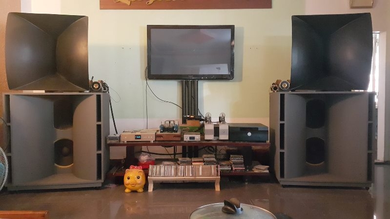

Probably there are people in Vietnam who wanna listen to the dddac. Mine will be to heavy and to big to take all around South East Asia on my next trip. Maybe get some boards and ask them to prepare a big 12 volt supply.
This is one of the systems i will visit.
Already did ask Doede but one of my Vietnamese friend wants to know if using the special Sowther will make skipping a pre amplifier possible if the power amp will be used with some extra parts. Maybe transformer volume control by SaC in Thailand.
greetings, Eduard

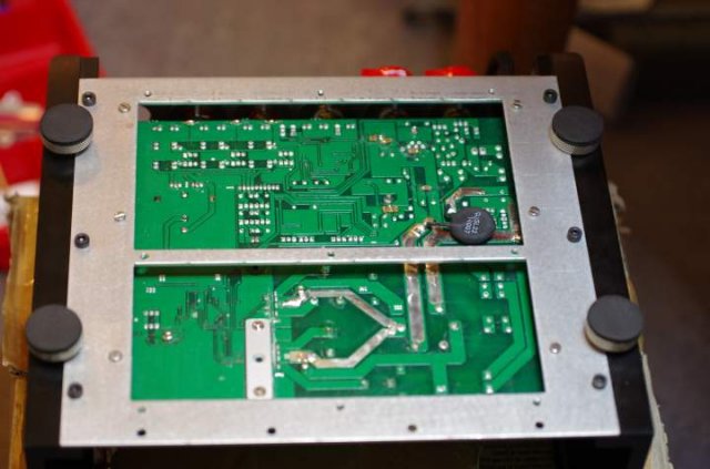

Hello everyone, I am back with my fault finding mission. I have replaced the original I/V filters with four 68R as I have two boards but this hasn't improved the fault, still only getting 1.28v 1.317ohm from the rload and still getting very low volumes. What is the next step for fault finding?
Thanks in advance
Thanks in advance
