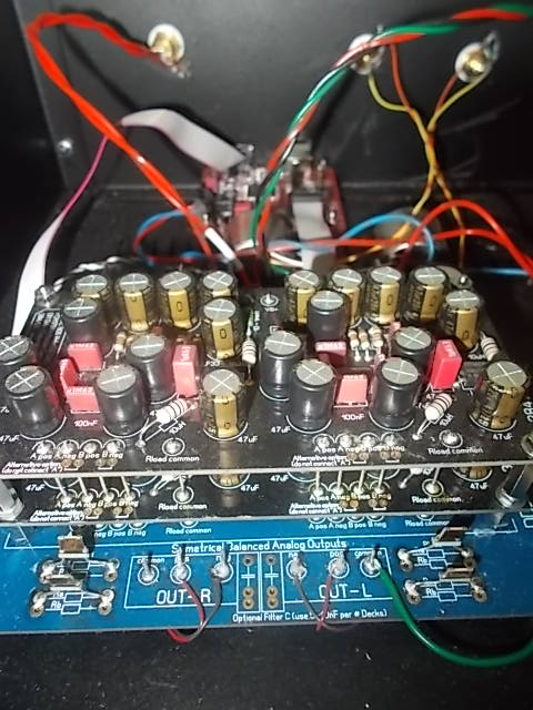

OK I feel like I am getting somewhere, possibly not in the right direction though?
I checked the voltage from the power supplies and they where both a little low, not sure how as I had done this a number of times in the past?
installed all usb driver and foobar 2000, played a bit of music but absolutely no sound apart for that coming from the computer, I will have a look at the settings again tonight to check its all set up right but don't think it is all fine.
With a computer plugged into the DDDAC I get a power and host active light but I also get a 48khz light which stayed on even without the computer plugged in, don't think this is right?
Analogy output now reads 1.37v 1.412ohm (right channel) 1.38 1.425ohm (left channel). At the s/pdif I am getting .75ohm 19milli volts.
I measured the other side of the dac boards and getting 2.44v at BCK 4.99v at DAT and 2.49v at LR but DAT voltage disappears when switching to spdif.
If no one has any ideas from this I can de-solder the cinemags and check everything again.

did you play music on spdif? no need to measure DC on digital lines, you always get values like that which are meaningless. I asked you to measure the Supply voltages, what are they? and some thing else, how did you connect the Cinemags? Which colors goes to what PIN at the dac board? or post a clear picture showing it. thx
Yes playing through the CD player I get around 10th of the volume than normal
Volts comming from the power units are 12 and 5v, the 5v goes to the USB board and mesures 5v at the input, the 12v goes to the Dac boards and mesures 12v at the input.
The Cinemags are wired up as follows:
Orange - Spdif ground
Yellow – Spdif central pin
Brown – analog out negative
Red – analog out possitive
Black and white – chasse (ground)

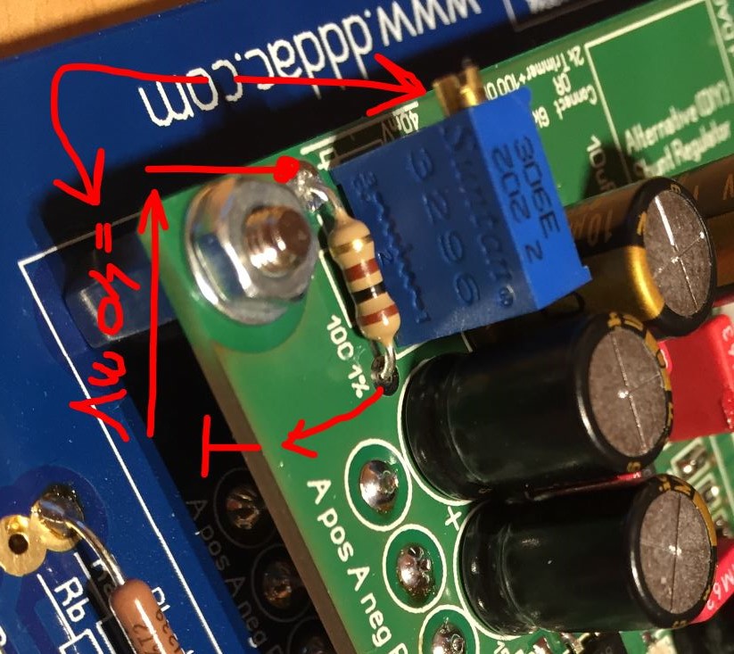

Can someone please explain what the four white plastic washers are for in the new shunt DAC kits?
Was not in the older kits
Hello ,
That is why i started a new thread ! i think they are used between the nut and the stand off that mounts the dac board to the mainboard. The pictures on the audio creative are not that clear but i think you can see them being used.
By the way did get a message about the 6 Kohm resistor and the 2K trimmer.
In the picture that Doede did post some time you can also see the washers
Greetings, Eduard
You could copy and paste this message to the new thread.

I think I know what you mean, but does not Spdif means the RCA output connector. it is de digital input from your main board connecting the digital output of a CD Player... did you try that?
also the picture is not the best looking at connections. Where is thick green wire going to (connected to "common")?
I strongly recommend to disconnect the Sowters, so you have a basic set up and measure DC voltages at the output (POS verus Common and NEG versus common) and also the 8volt DC supplying the dac chip. Not the 12 volt and 5 volt. I need to know if the dac chips gets 8 volt. You measure this after the conductors (the one under 45 degrees close to the outputs)

Evening all. Just to let you know my dac is now up and running!!! after a very interesting evening at dwjames place yesterday evening. Turns out I had missed a couple of resisters, which I think regulated the power on the dac boards, and the resisters between the ground and live on the RCA's where the wrong value.I think I know what you mean, but does not Spdif means the RCA output connector. it is de digital input from your main board connecting the digital output of a CD Player... did you try that?
The only down side to the evening was that I got to listen to an incredible system which I fell in love with! Now have to work out how to best to change the rest of my system to emulate it.
Thanks again for everyone's help on my very long and rocky road!
Sorted 🙂Evening all. Just to let you know my dac is now up and running!!! after a very interesting evening at dwjames place yesterday evening. Turns out I had missed a couple of resisters, which I think regulated the power on the dac boards, and the resisters between the ground and live on the RCA's where the wrong value.
Very welcome!. That was an interesting little puzzle for my tired brain, but as with most of these things it's simple once you work it out. To clarify, it turned out that one of the decks had no pin CCS 6k resistors fitted, so we swapped in the test 2SK246Y I had lying around and this doubled the output, but still to only about 20% of normal expected volume.
But now there was normal volume output from the dac when we tested direct from pos/neg but not from the output of the cinemags. Turns out the load resistor across the rca plugs was about 1.5Mohm each for some reason. With these snipped out, normal service was resumed and the music flowed very nicely 🙂
