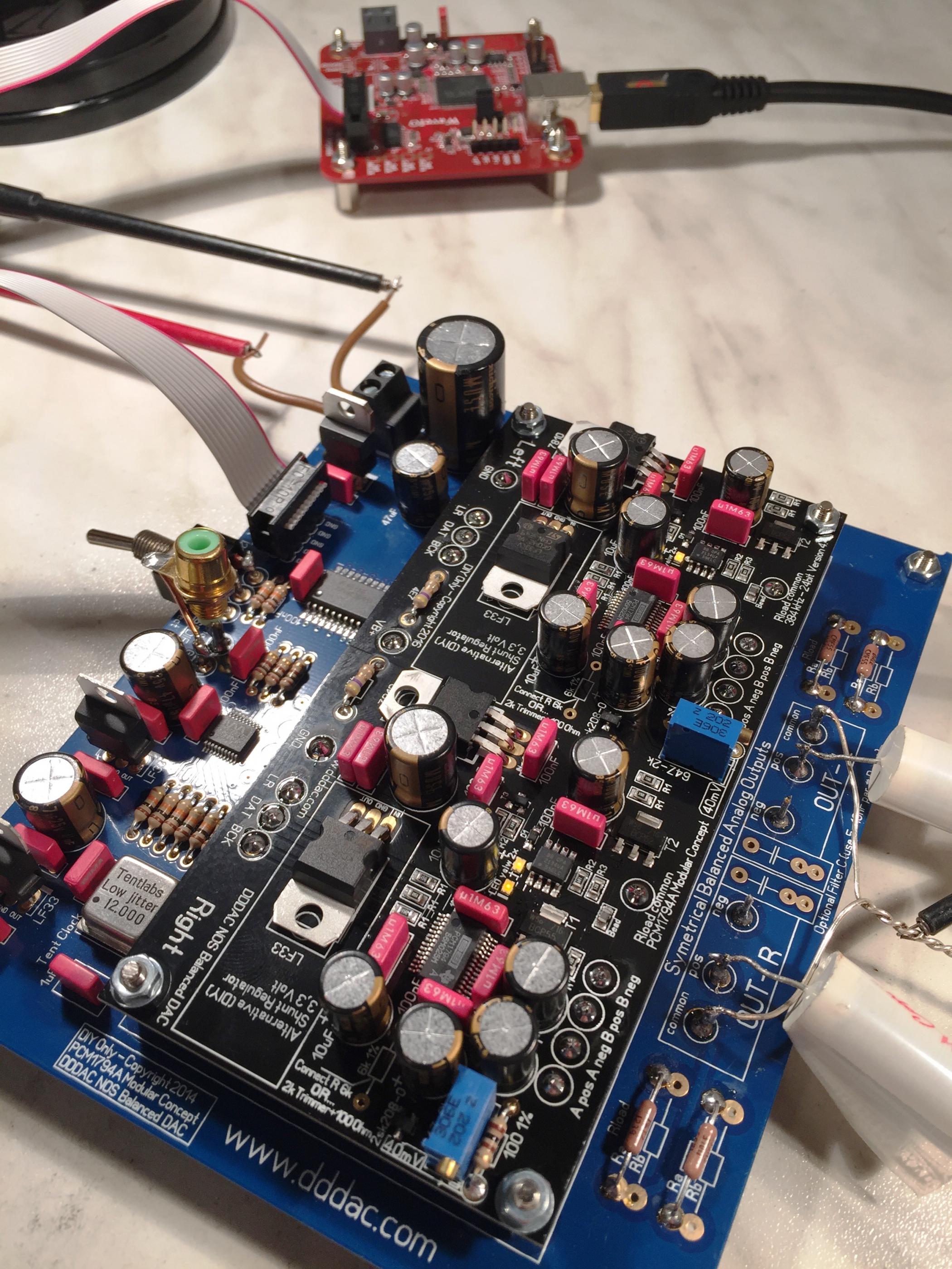

Received the boards back from the SMD assembly house and built yesterday evening the first production DAC. See image... Everything worked right away, so I am a happy man 😎
Audio Creative will have all boards and parts for kits next week hopefully (depending on DHL) so the new dac modules will be available very soon now.
I was lucky with the FET batch (bought 1000 pcs for 500 dac boards, so we will be good for some time). With the standard position of the trimmers and this batch, the DC bias was at cold start 38mV, so very close without adjusting (!) to the required 40mV. Meaning at switch on, the DAC was playing right away correctly. I tuned to 40mV after half an hour warming up.
Just FYI.... Current consumption of one DAC module is now round about 210mA (due to the TENT shunt regulator taking some extra current of course)
The standard power supply from DDDAV will be ok for 4 decks so to speak.
