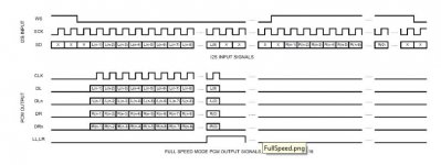

So what are they supposed to output? What did you tell the Ian board to do so to speak?How did you connect it? Small drawing may be or pics ? The DAC boards need 24 bit right handed I2S delayed 32 bits on one channel. Is that what the Ian board outputs?
Hi Doede,
don't get me wrong, it is just an experiment.. your design work's perfect.. also with IAN's FIFO connected via I2S .. it sounds fantastic.. IMO best DDC solution compared to Wave IO, Amanero and JL Sounds.
Additional I want to try to feed the DAC boards directly from IAN's additional I2S to PCM board .. it's just an experiment and i would share the result here because some users may be also interessted.
btw.. Output Format of I2StoPCM attached.

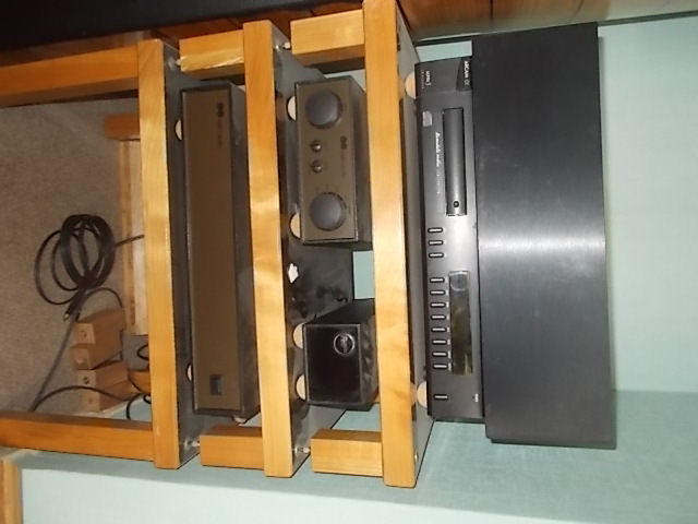

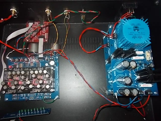

Thanks dwjames, you have no idea how grateful I would be for your help, where are you based? I brought the dac over a year ago so a few more week waiting wont make any difference.
Anyway here are a couple of pictures for folk to look at.
The setup is basically two decks with components I received from audio creative including the cinemags as the output caps.
trying to work out which the I/V resisters are, once I have I will let you know the value and the reading I get with the multi meter.
Thanks once again
