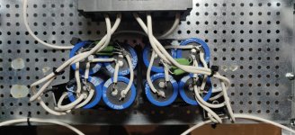

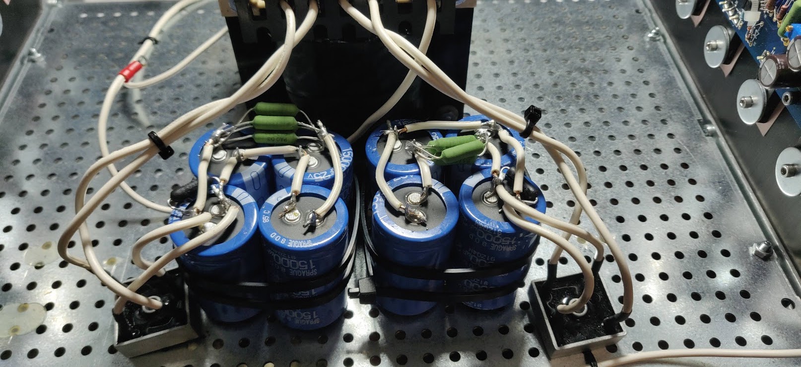

I try to understand the issues that Zen Mod sighted on my amplifier.
I am not sure if a change in arrangement will help or do I have to change the arrangement from a square of capacitors to a single line for every power supply. I think I haven't addressed the problem completely
ZenMod can you check if something like the photo I have posted is ok or do you think I need to change the whole arrangement? The thing that keeps me thinking is the bridges on the left and right...
Bear in mind It is not the final setup, I just moved them there to take the photo. I will fix them on the case when I am sure about the arrangement.

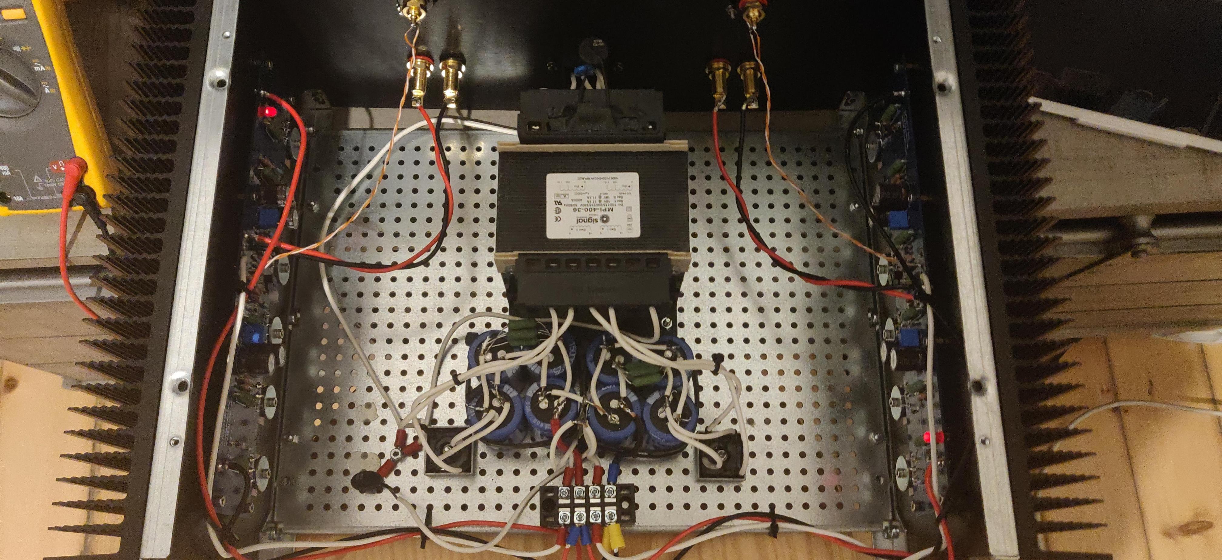

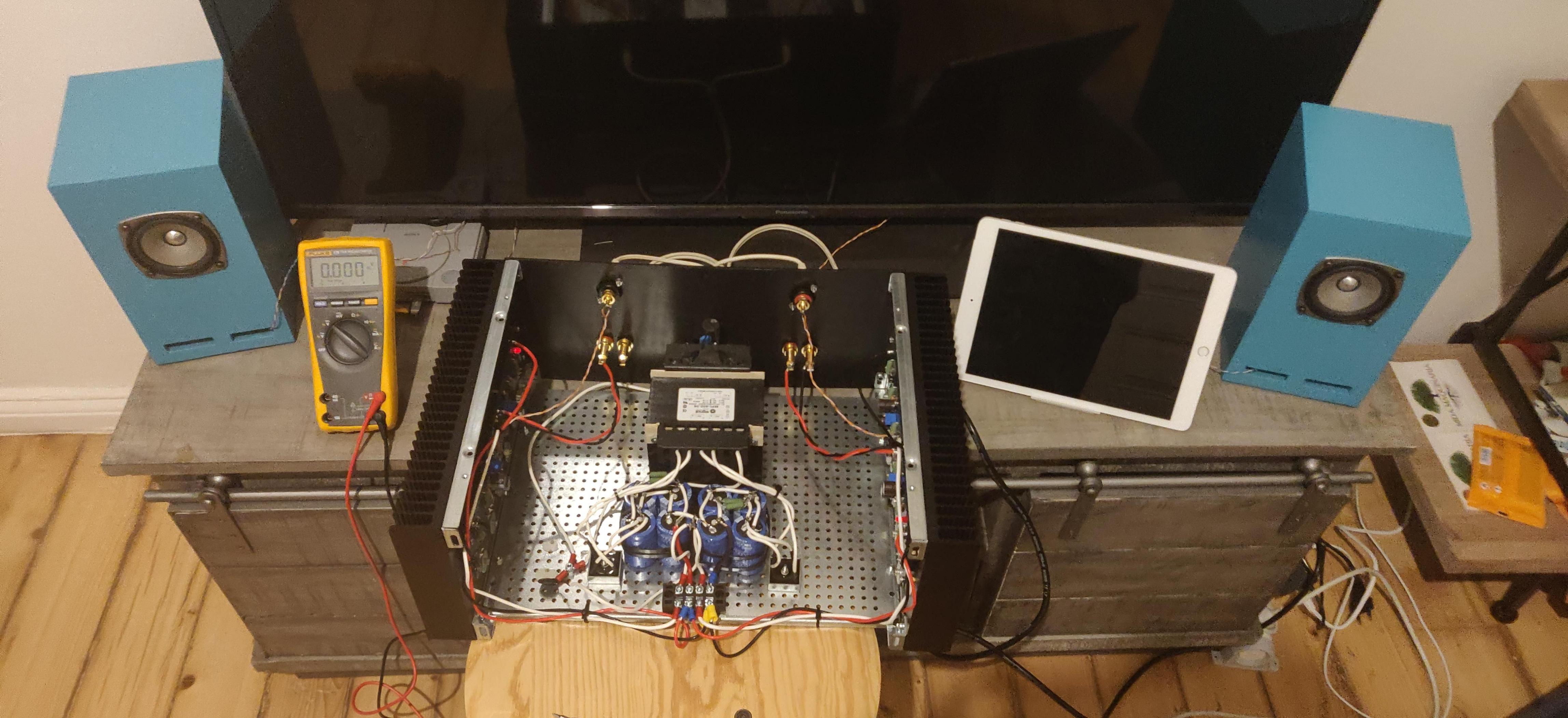

Found time and continue my build!
First thing first,
I insulated as 6L6 told and use colours for the wiring, changed Kerafoil, and moved capacitors (hope I got what ZenMod tried to explain) and now I gave a working amplifier with great help from the forum!

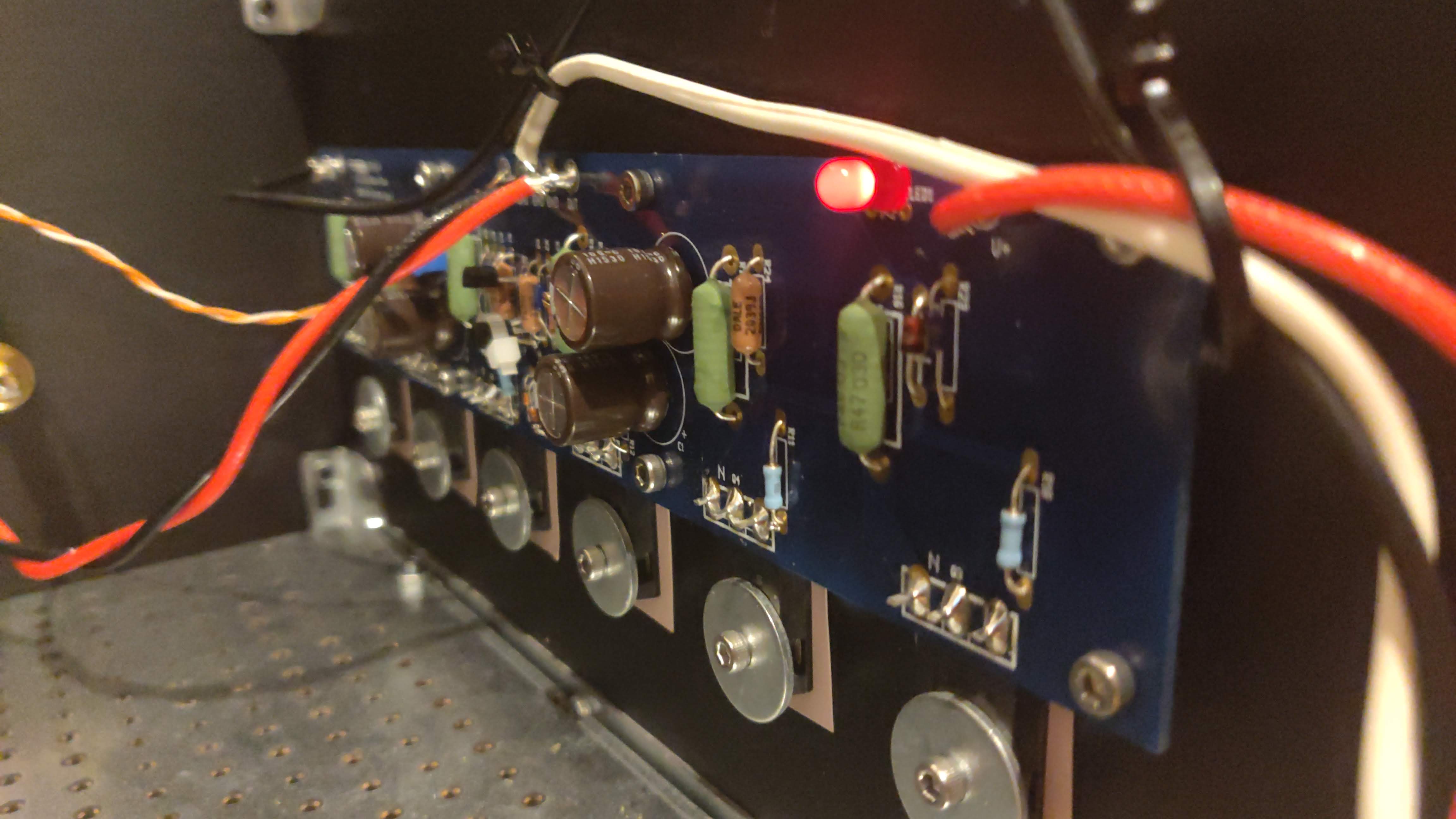

I attach some pictures if anyone can pinpoint anything wrong, I will make the wiring a little bit cleaner next days...
One question, I am trying to set the bias, I have maxed the potentiometer and on both channels the bias is 0.120 after one hour (it started at 0.113). Both channels the same. Do you believe there is something wrong or should I change the R9 resistors?
The potentiometers are bourns so I think they are good.
The DC offset is set to 0 +-0.2 mV

Your first picture gives me vertigo! Good luck with the resistor swap. I think everyone has to do that... I have 7.5k in mine.
Ok , I will try to lower the value
This might be my next task too... To find out what value works best, you could piggyback a resistor (10K - 20K) onto R9 resulting in a perfect value... (piggybacking a resistor is easier than replacing a installed one...
