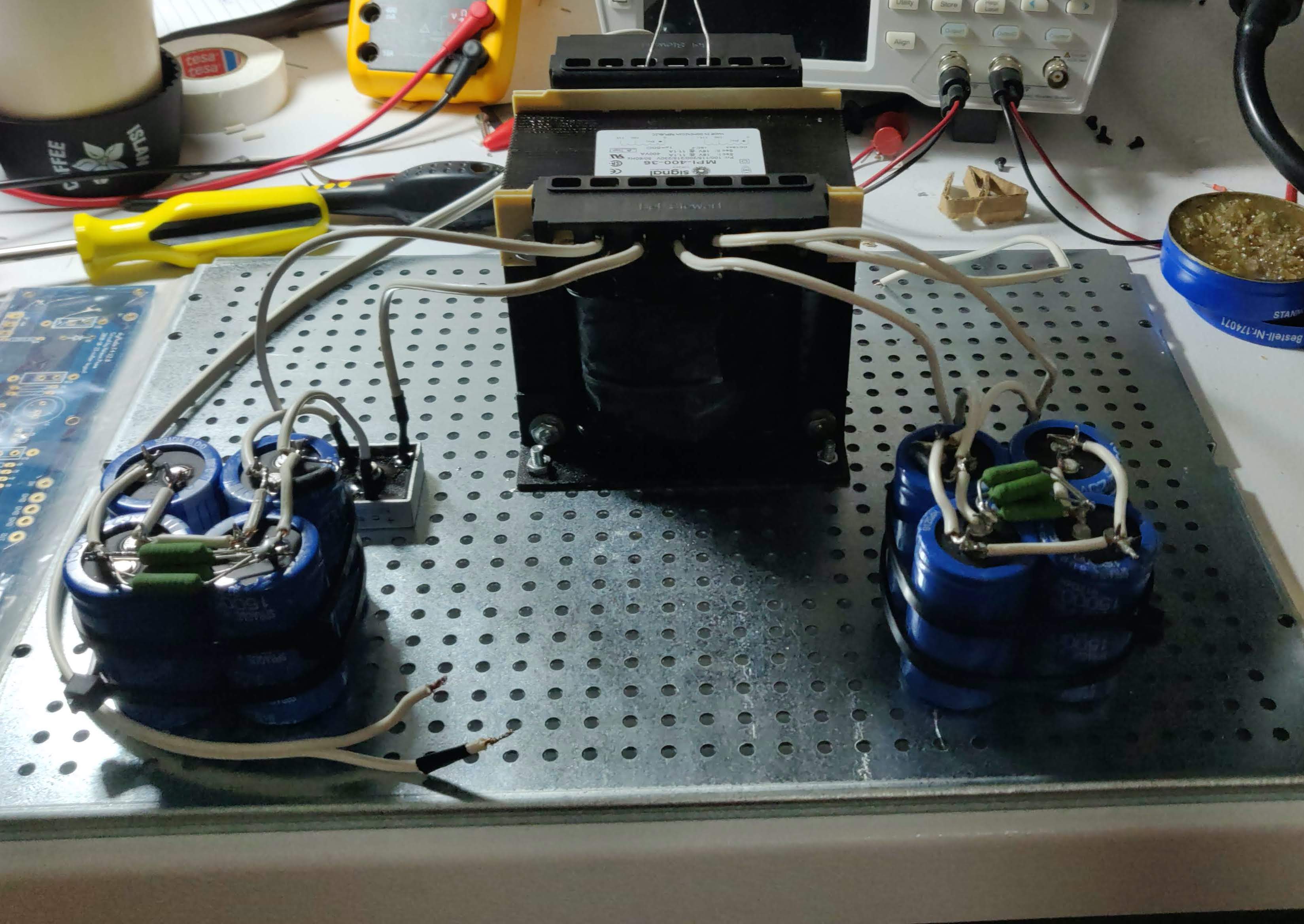

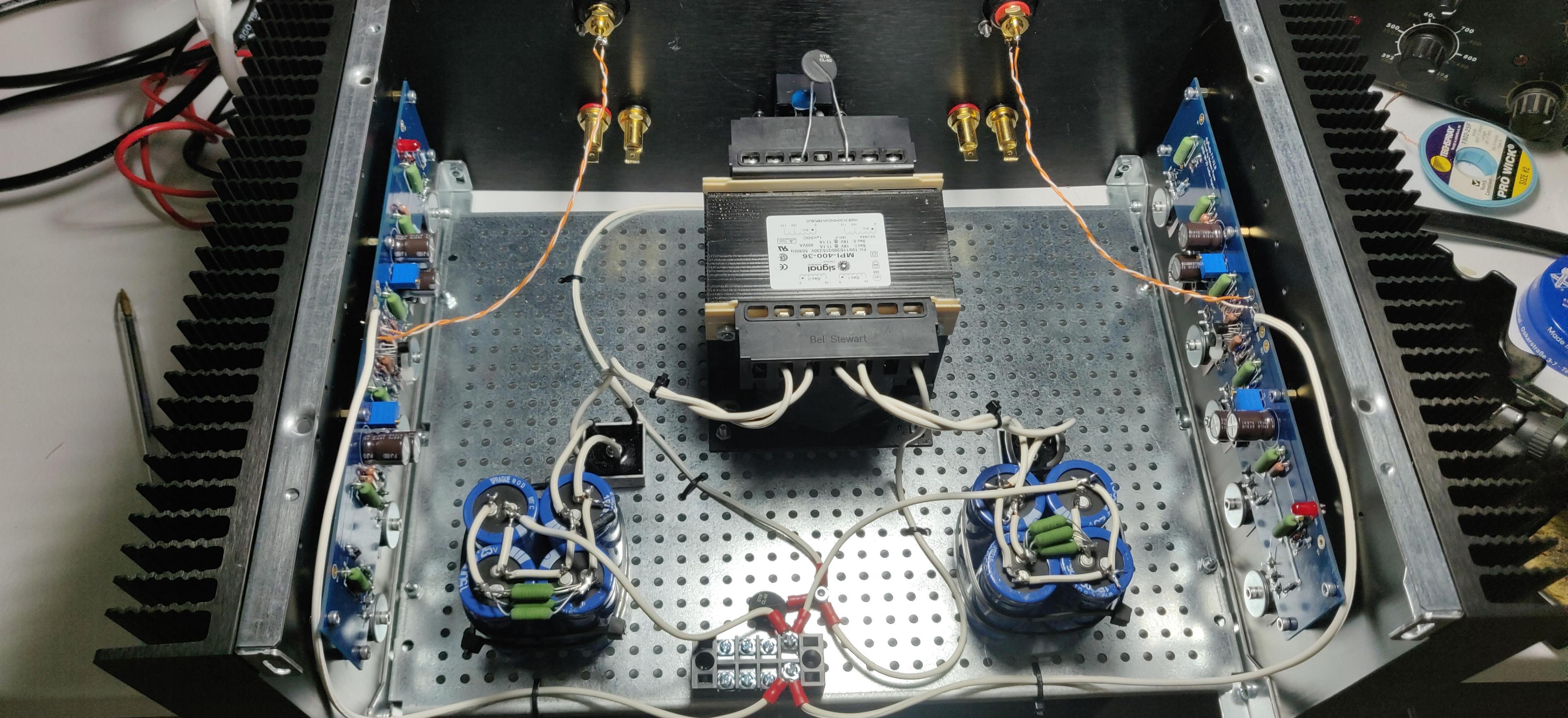

I have started my F4 build yesterday.
I finished the power supply and I have populated the channels boards with everything except the MOSFETS and the potentiometers!
The kit from the diyaudio shop along the case from modushop makes a great diy friendly build! Having the comments of these forum is of invaluable help also!
Some minor questions if someone could help here:
1) For the power transformer I have used the Signal 400VA (https://gr.mouser.com/ProductDetail/530-MPI-400-36/) Is it any good or I should look for something else?
2) I have used 25Volt capacitors for the power supply (https://gr.mouser.com/ProductDetail/75-80D153P025KE2DE3/), are they good and more important will it blow?
3) Finally I used these capacitors for the channels (Access to this page has been denied.) do you think I should replace them with something from Panasonic?
I will try to post finished build photos when I receive all the components!

1) Power transformer seems fine. You'll know when you put a load on it...If it hums you'll be looking for something else.
2) In the future order something with a little safety margin...35V or even 50V.
3) Just go with what you've got.
Looking forward to seeing pics of a working amp!

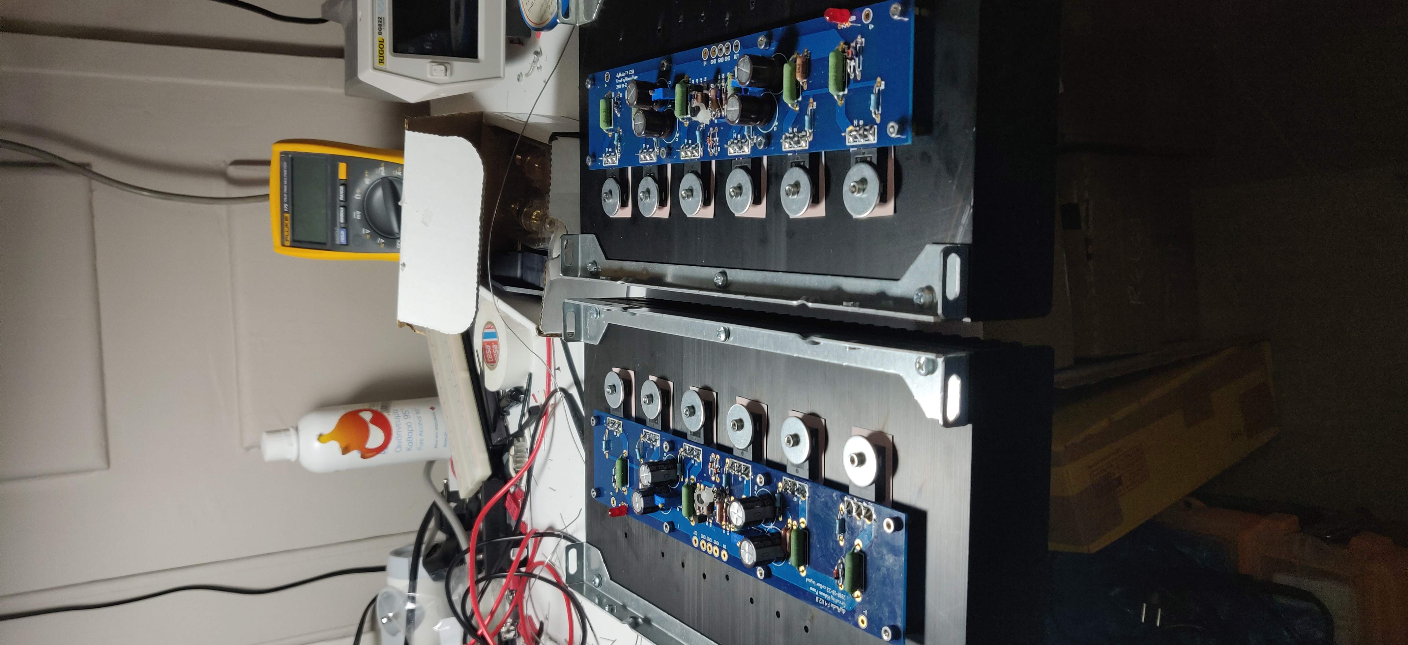

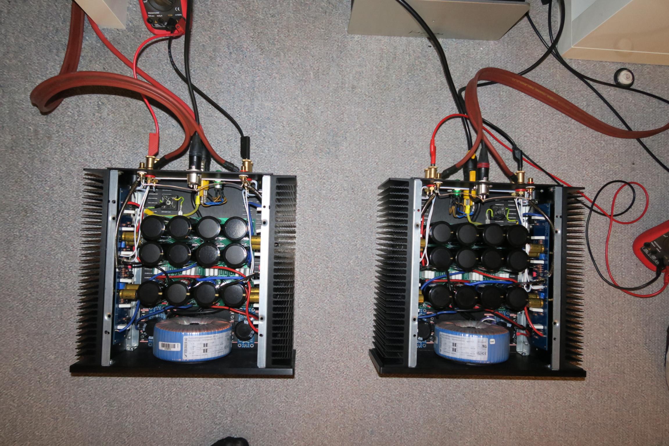

With a long line of projects lining up finally got to finish a set of F4's
Simply couldn't get sufficient heat into the F5's running them as monos. This wasn't entirely unexpected as the ceramic heat transfer pads do work well.
Rebuilding to F4 dual balanced mono's solved that issue. Temperature is stable just above 50C, so all good.
So many here seem to be running the ClassA's cold in huge cabinet's....
I don't mind a little heat - In fact I grew up making Class A's, JLH's Hiraga etc.
If you didn't burn your fingers on the heatsinks, it meant something had gone wrong in the build: cold amp = defect amp
However talking about big cabinet's it quite quickly get painful when too compact, keep promising myself that next time I will leave ample space for working on the things. Next I will probably not be able to resist cramming in an extra set of electrolytics, to again prevent a clear look at the baseplate
Some notes:
Biased as std. @ 0.43A,
rails at just below 23V, RC: 3x//.56R & 4x6x56mF/35V
Stable, easy to adjust - only slow Matched sextets in each unit (not needed but because I had them) A bit dull compared to a recent Doxa adjustment, which was like catching butterflies with your bare hands...
No hum, no noise, nice ambience, nice clarity - nice amp
Thanks Nelson! & Thanks to everybody else especially 6L6 and ZM for an inspiring thread!

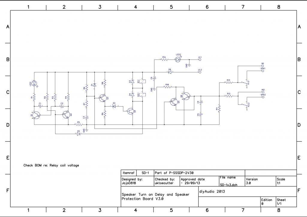

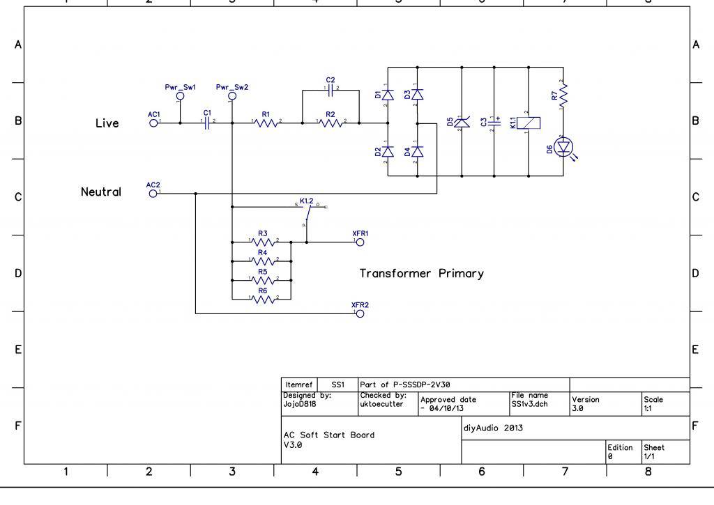

I work with diyaudiostore's stuff:
softstart-board
toroidy 2 x 18V 500VA "audiograde"
universal PSU, with discrete diodes, 8 bloody 47000UF 20% 35V caps, all classic...
F4 boards
speaker delay/DC-protection (powered by a 24V 2.3VA transformer, perfect!)
schematics attached, even though I did not work with it (I just barely can identify parts and connections, but don't understand schematics).

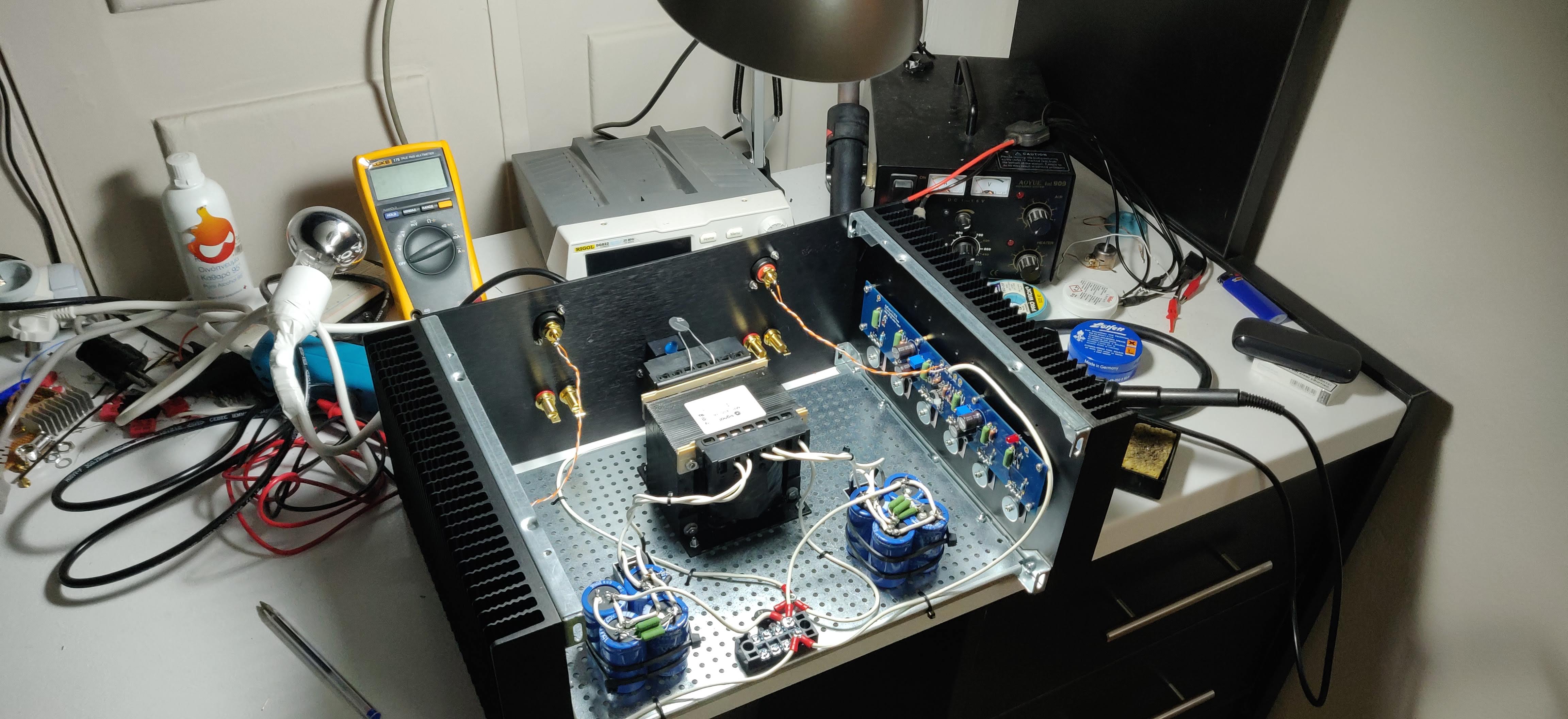

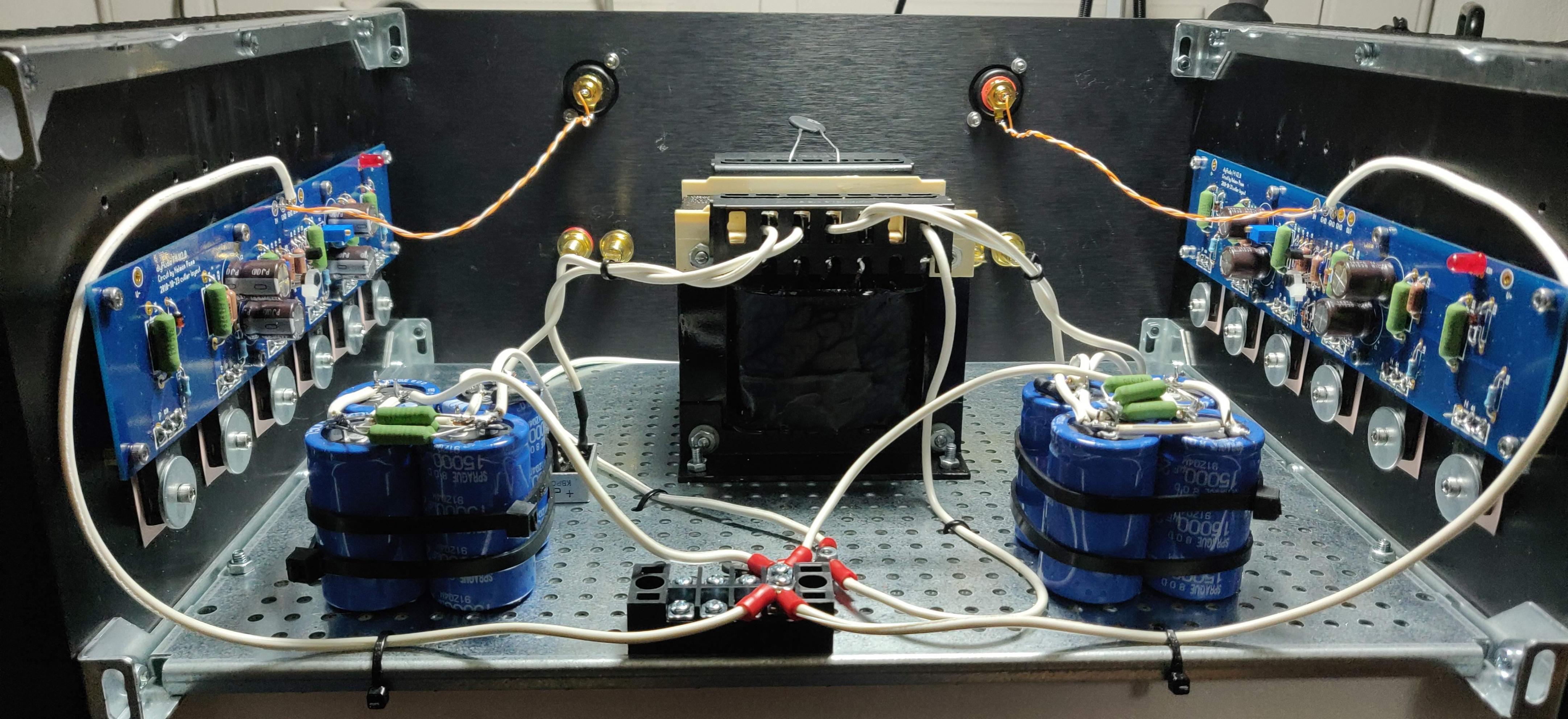

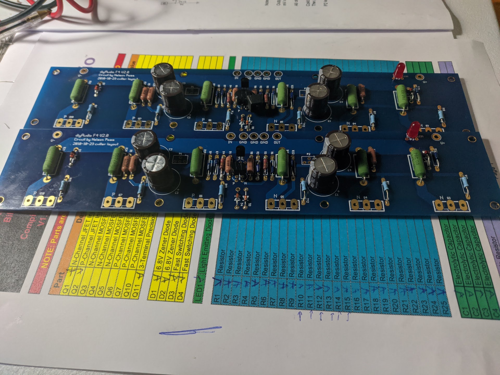

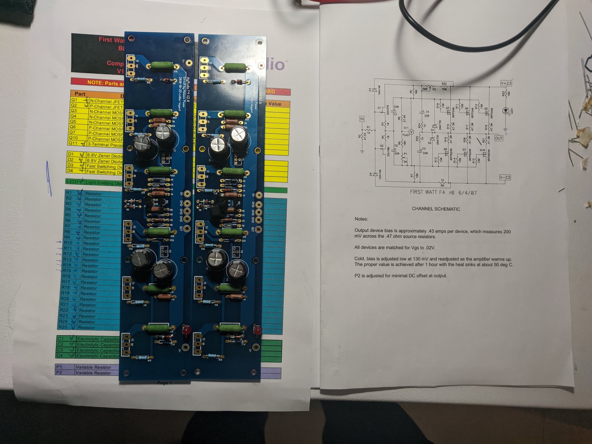

A happy new year with a lot of builds and listening!
Finally, some more parts arrived so I post some new photos!
And here are some question!
1) It is difficult in Greece to find the right parts sometimes. I found these Kerafol foils (Kerafol Thermally conductive film for semiconductor enclosures 0.25 mm 1.4 W/mK Suitable for TO 247 70/50 TO-247 | Conrad.com) They are not the same as in diyaudio shop. The conductivity is about 1.4W/mK. Someone else has asked this question again but he did not receive an answer so I believe that can help others located in Europe also. Is this part good or should I change it to mica?
2) Furthermore is it right that you just put it between the transistor and the heatsink and it works from the pressure of the bolt? I find it doesn't stick.
3) For the cabling of the input signal I used CAT-5 solid core wire. If I use it for the output is it too thin? I am asking because I have connected my speakers (Vulcan Woden Design) to my current amplifier (a modded TPA3116D2) with such a cable.
4) Do you see anything particularly wrong from the photos?
I have never built an expensive amplifier (I have built only Class-D in the past) and I am a little anxious for the results!
Also, I built a Bulb Tester to be ready for when I will power the amplifier for the first time! I haven't thought of that before! What a clever tool! I highly suggest it for novice builders like me!
Hope these questions can help other builders too!

That looks quite nice so far!
The insulators are good material for the job and mounted correctly.
Cat5 makes wonderful small signal wiring.
The exposed legs of the CL-60 on the transformer have the full mains on them, please insulate.
Please get wire with different color for wiring PSU to the amplifier boards. Keeping track of everything when all white will be a challenge, and nearly impossible to troubleshoot on the forum if needed.
Things appear good, carry on!
