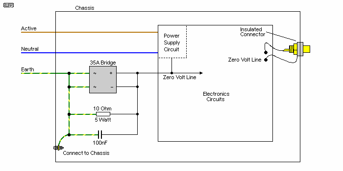

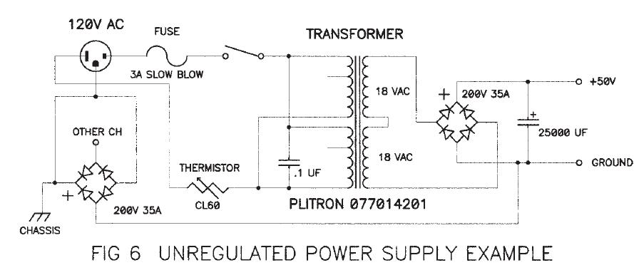

Here I have a question about the ground-loop-breaker... I discovered that the use of a diode bridge is widely accepted as good practice (best practice?) and even begin to feel comfortable about implementing it from Papa's schm... but then:
• there's the thermistor left, and I'm not sure anymore wether it was used too, on which side of the diode bridge?
• what about the resistor/coupling cap option, as of Rod Elliott?
• chassis-connection: Is it sufficient to connect the baseplate (which is connected to the 'real' chassis itself, but the anodized aluminum is said to be a bad conductor...), or should I make an additional connection, where I could expose the bare aluminium?
Lastly, a side-question (my literacy of schematics become obvious at this point 🙄): Looking at Rod's schematic, which is very clearly laid out with the ground loop drawn as consecutive parts (bridge+ / bridge- / resistor / capacitor) — does it make a difference wether they're going from one point or must they be one after the other?
(Papa's breaker is here
Rod's breaker is attached below)

I'll leave the technical replies for others, but will just note that I have zero noise using the standard thermister solution.
No comment on which audio ground scheme to use, except to choose one. There is no need to series connect a thermistor to the diode bridge.
The whole chassis should be tied together electrically to safety ground. So if anodizing is interfering with conduction between parts, sanding of parts at interface locations may be needed. Often times the screws holding the pieces together will electrically join the pieces. However the best thing to do is to check with your meter.
The safety ground wire from the IEC connector should connect directly to the chassis ground point. The audio ground then connects to the chassis ground.
From what I can recall, the resistor keeps the circuit ground (0 volt) independent of the chassis ground by floating it to chassis potential. It also prevents ground loop current from forming if you connect an equipment with a ground loop (or Pin1) problem. The bridge bypasses the resistance.
My guess is that if the zero volt line becomes more positive instantaneously than the diode (bridge) forward voltage (Vf), it will automatically be shunted to ground (earth). If it is less, it will charge the capacitor and then the resistor will dissipate it when it discharges (t=e-t/RC).
