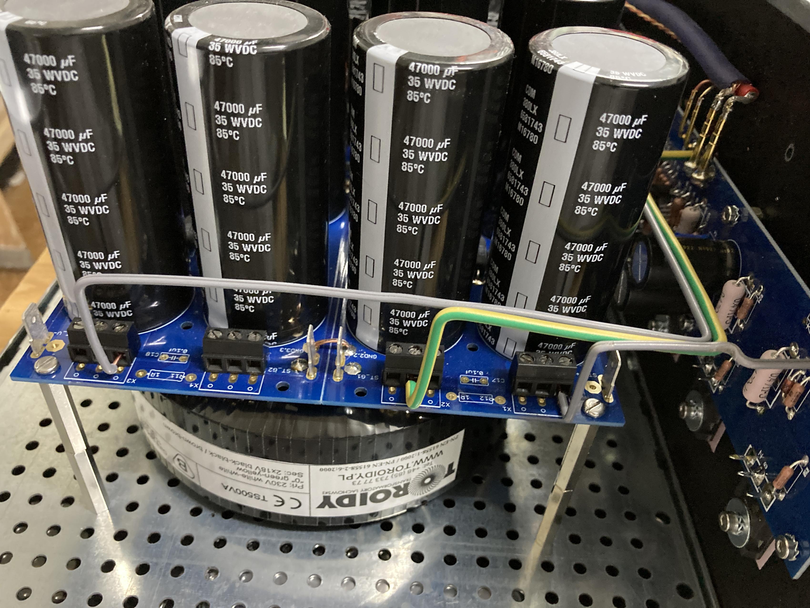

Oh, those spades... they're residue of my unplanned build. I just went after that splendid build-guide before I made up my mind about the layout, and they're soldered so good that I didn't dare to try removing them. I'll cover them with shrink tube.
BTW I'm thinking about making a transformer-box — for aesthetics and maybe isolation too, and I'll probably will give it it's own foot underneath the chassis (according to this article in LinearAudio)

his or mine ?
(seriously, EUVL's amp is just awesome, to use that word! I'm nowhere there but still a happy camper)

tap to big xformer , if you're using center tap as GND - protection circuits often use AC sense as base for operation ( enabling fast power- off) , for which you need connecting directly to GND and one secondary side of big Donut
if you're using 2 bridge arrangement for big Donyt(s), better to use small xformer

his or mine ?
Ha! His. But your wires are beautiful too!

Not sure what I'm seeing, I'd say 2 bridge arrangement, so no connection to my big bugger? DOH!
Please tell me what I see here
Yeah.
Two bridge rectifiers
One, thr2... don't tell me I can't count

erm, sorry, but, I'm not sure about the speaker protection unit.
Is it worth/recommended to use it?
And, can I just tap a secondary of the big transformer (2 x 24V 500VA), or do I better install a tiny second one?
The speaker protect board is also a startup delay so you don't hear any thump out of the speakers on power up. They alone made it worth the effort to me.
You can tap onto the main power supply to drive it, but having a load on one half of the supply upset my OCD so i went with a dedicated transformer.
