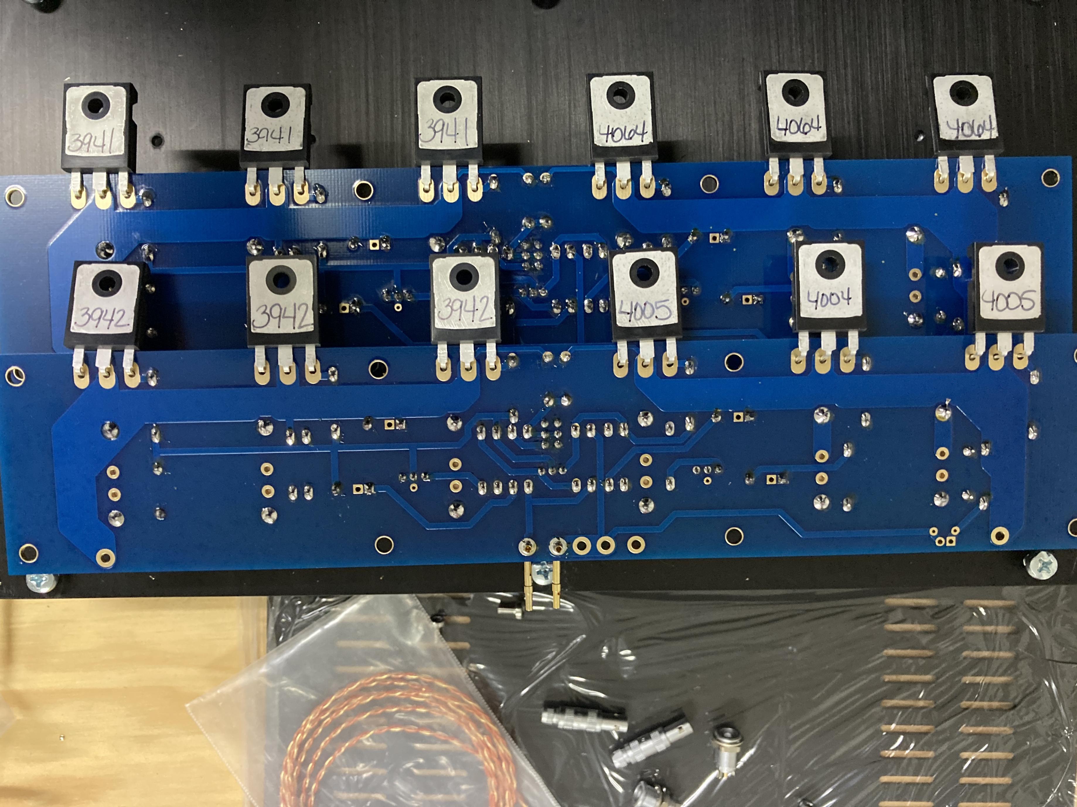

If on the metal, that’s the Vgs, which is the actual measurement. Still, don’t separate the trios.
And to answer the next question, the Vgs of the N channel will almost never match the Vgs of the P channel, and they don’t need to for proper operation.

I've noticed Vishay are producing tighter matching parts compared with 8 years ago.
I just built an F4, matching the MOSFETs myself for that.
Bought one tube (25 pcs.) of each, Vishay IRFP240 & '9240.
Did match all FETs at 25V and 500 mA.
Out of my tube of '240s, I got three Triplets within +/- 1 mV. And another two Triplets within +/- 3 mV. And then, two more pairs within 1 mV.
Of the 25 pcs. of '9240s, I got one Octet within +/- 2 mV, or two Triplets within +/- 1 mV and a perfect pair ... also, there's one more Triplet within 1 mV, and two more perfect pairs ... :)
Spread between highest and lowest Vgs was about 9 mV for both the '240s and '9240s, respectively.
And the '240s and '9240s were less 10 mV apart from each other in Vgs.
So, if you buy a complete tube of each from a reputable distributor, you could actually just pick your MOSFETs randomly from the tube and be done with it ... :p
Therefore, I have to second pico, and I'm happy with Vishay's production tolerances :D

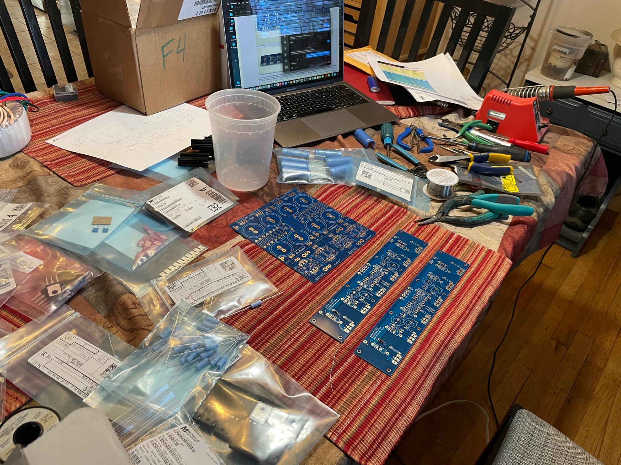

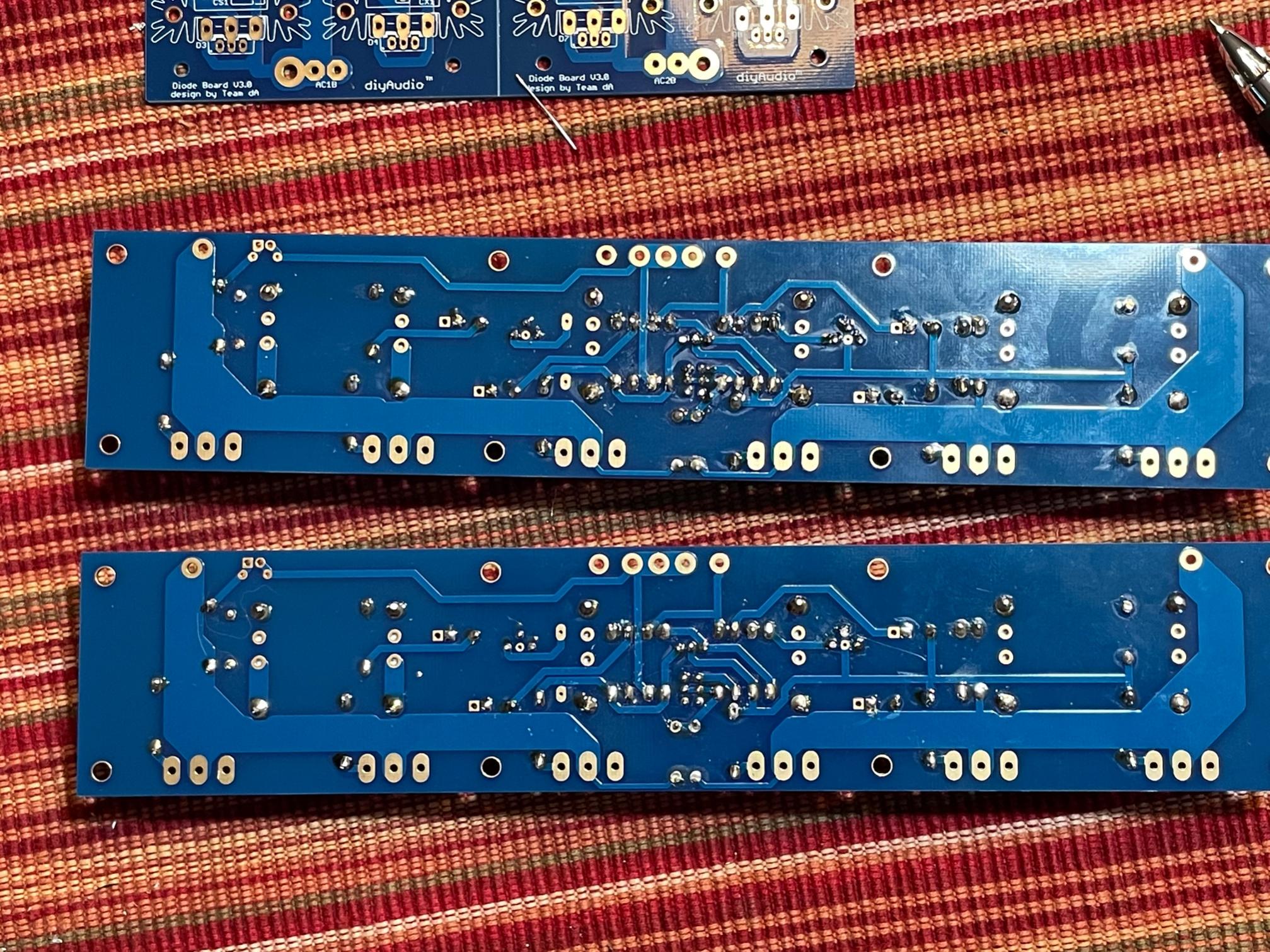

While I'm waiting on the cabinet, I got the amp boards stuffed.
I'm missing R22. Somehow overlooked it when ordering. I checked my stash of 1/2W resistors and don't have a 750R. I love paying $10 for $.40 worth of parts! I'll wait to see what else I missed.
I received the Antek 5220 500CVA transformer. The dang thing weighs over 10#.
I'm a little confused on the PSU. I'll start and post when I get stuck.
