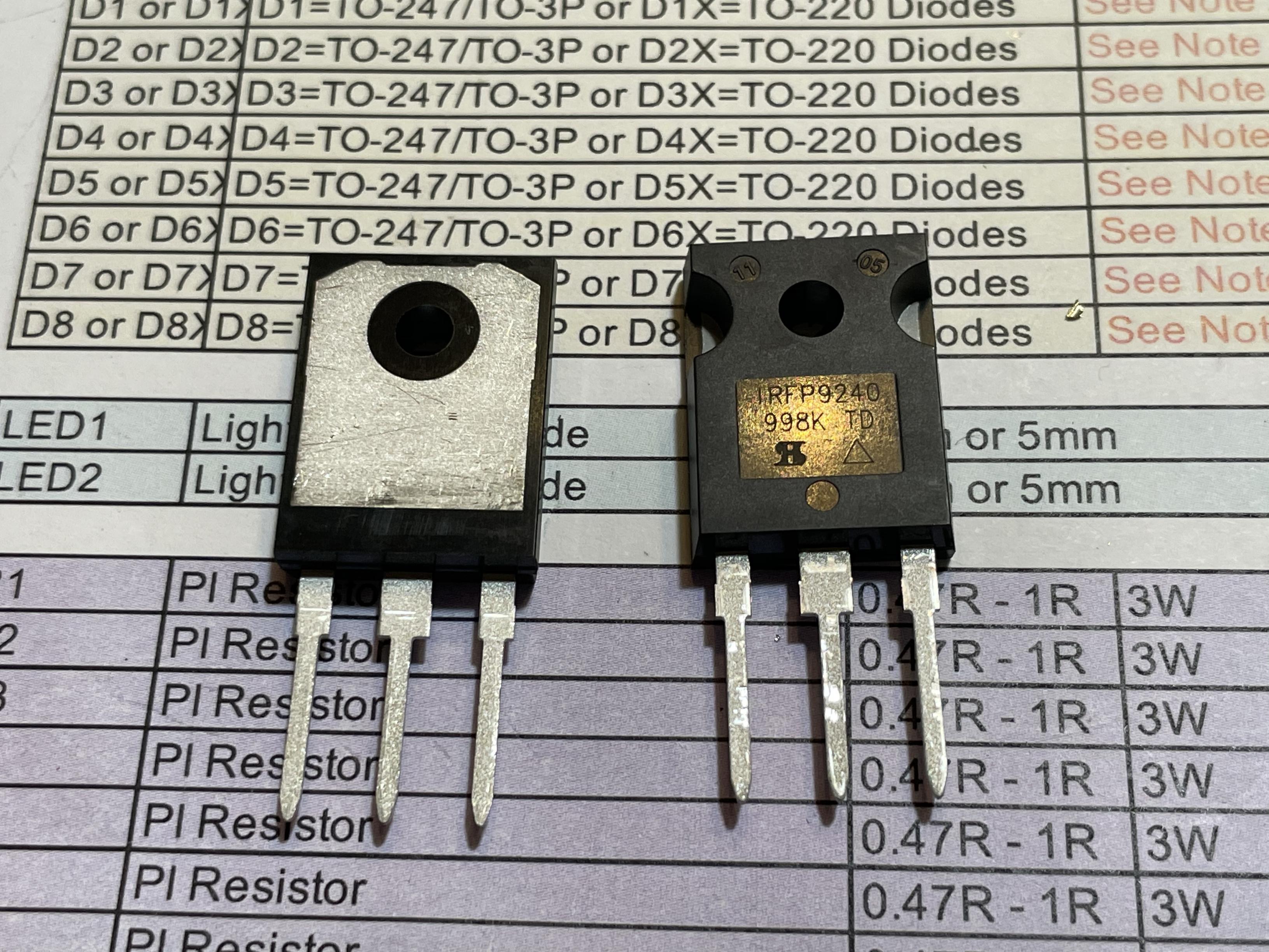

So I think I did a bad thing. I accidentally mixed up the mosfets that I bought from the diystore. There are 6 in each bag. I'm assuming they were matched? Anyway I can check them?
Mine had the values noted on the body‘s back-side (the metal side), hence my bragging about the precision of the match (#2302)... yours not?
Do the N’s come in one bag and the P’s come in another, or was it 3 N’s and 3 P’s in each bag?
I don't know. They're all mixed up now.
Part numbers are 6 x IRFP 240 and 6 x IRFP 9240. 240s are Ns, 9240 are Ps. I guess there was 3 of each in each bag?
Any chance all 12 are matched?
I think I got it. Part numbers are 6 x IRFP 240 and 6 x IRFP 9240. They are clearly marked on the devices. Whew! Thanks!!
Is that the engraving/print on the front-side? If so, you‘d still need to sort out the triplets. I‘m confident diyaudiostore did note the value on the other side (they came wrapped as triplets?)
They came in bags of 6. I assume one for each channel. There are no other markings. The text in the store reads:
Included in this kit are the semiconductors needed to complete an F-4 amplifier or BA-3 output stage, with the exception of the input JFETs. MOSFETs were matched in accordance with standard operating conditions. This is enough transistors for 2 channels (one stereo amplifier).
6 x IRFP 240 (F4 and BA-3)
6 x IRFP 9240 (F4 and BA-3)
2 x TL-431 (BA-3)
The IRFP9240/IRFP240 MOSFETs were matched at the rail voltage and current that the BA-3 and F4 articles suggest, specifically, 22v and .4A, and then grouped by VGS to within .1V.

Are their numbers written on the plastic or the metal of the mosfets?
Not that I can see
