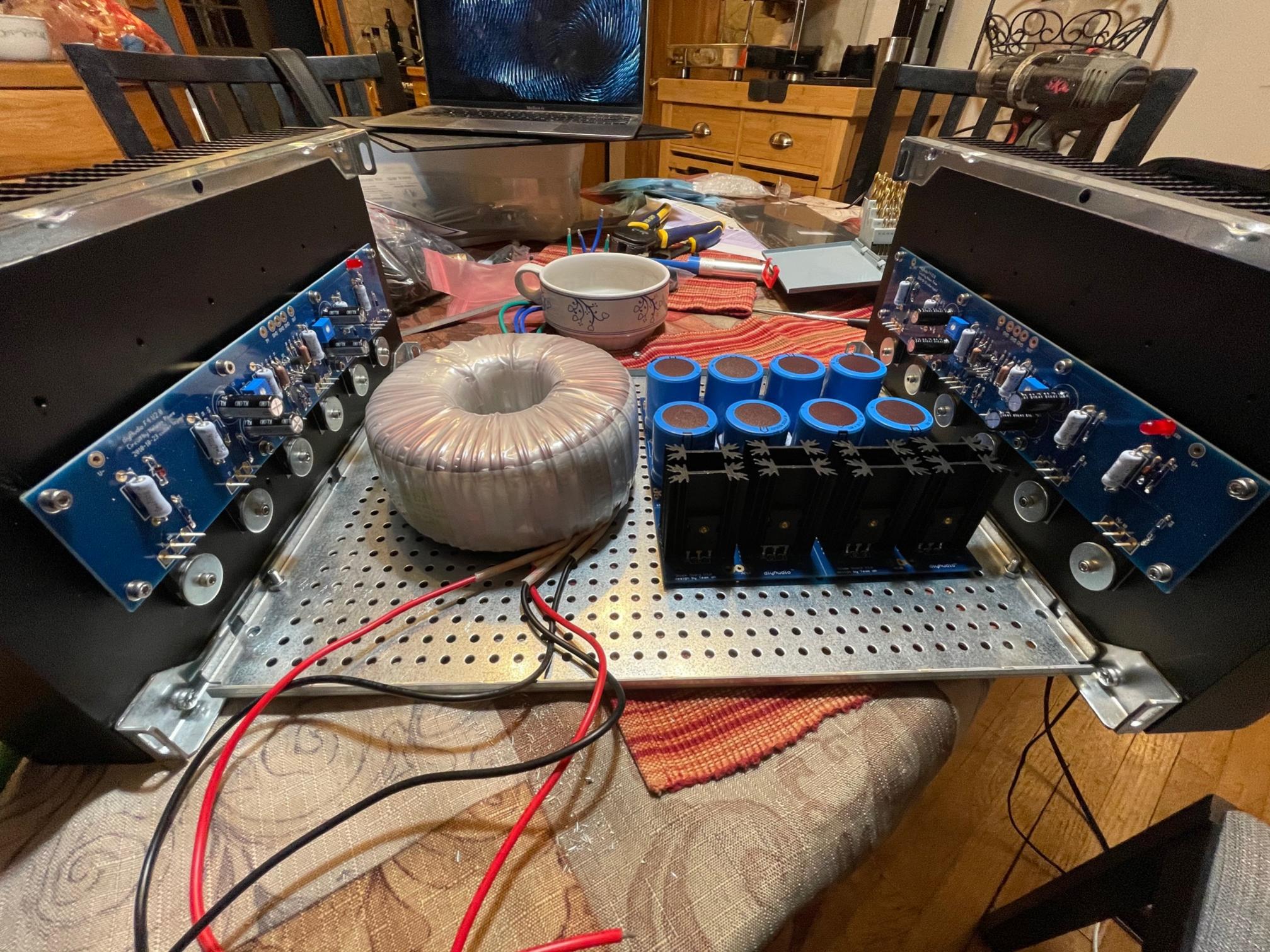

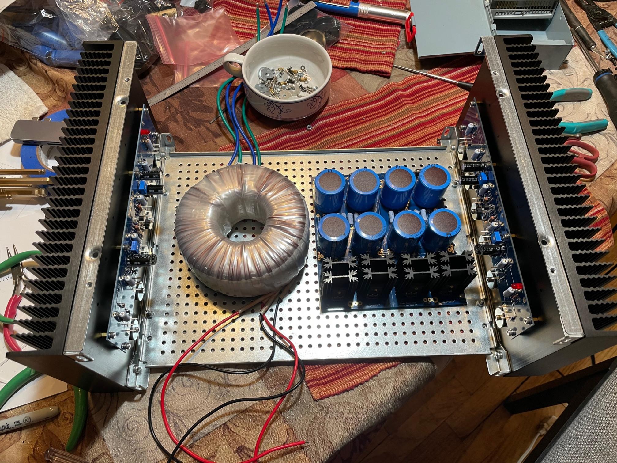

I received the chassis and 35V filter caps to replace the 25s I initially installed. These are 22KuF.
I mounted the mosfets and arranged the PT and PSU. I thought about using 3.5" standoffs and mounting the PSU above the transformer, but I'm concerned about heat. I have a few tube amps with exposed toroids and they get pretty warm.

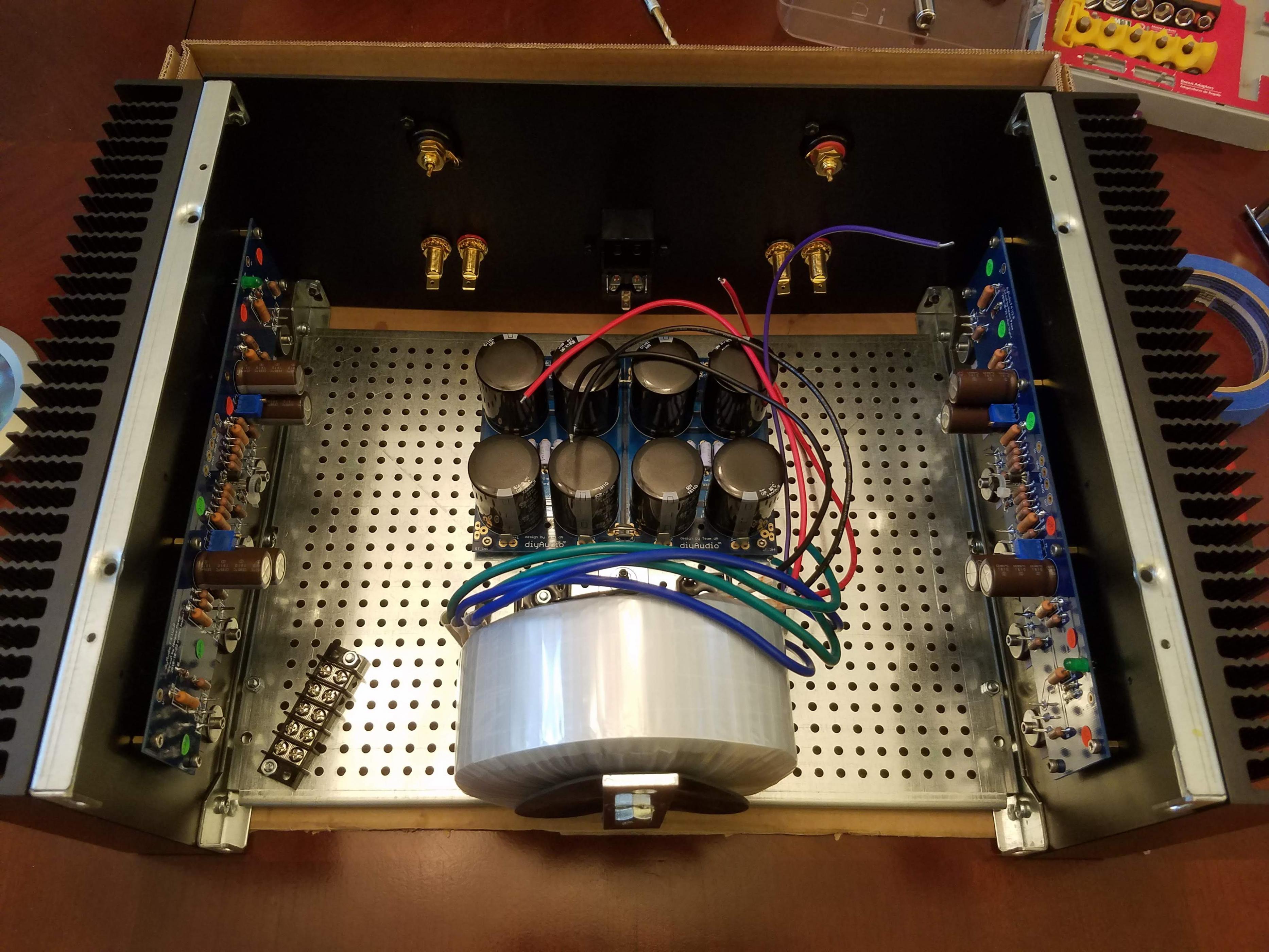

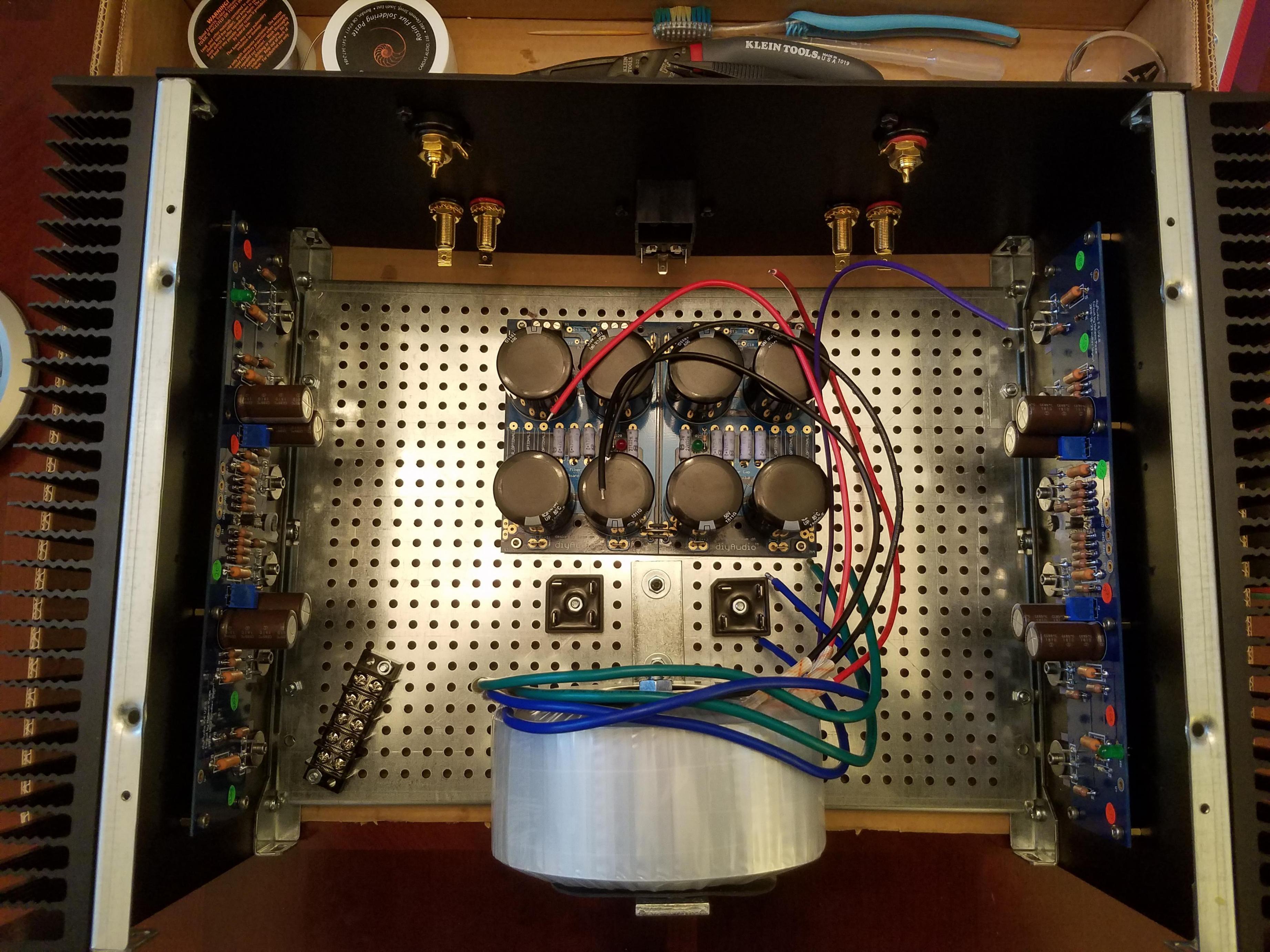

What about having the transformer in a vertical position, close to the front plate? I have mine config this way. I built the bracket myself from this specs L-Bracket – Toroid

Everything is going to get warm anyway, rectifier heat sinks and chassis will all happily sit at 50c when up to temperature, the F4 is really an electric heater that makes music!
I get it. It just makes sense to manage the heat in the best way possible. Since heat rises, it seems bad feng shui to put the power supply right on top of the PT. But I'm used to tube amps that supply 300-500V. How hot would this transformer get?
I like this a lot. Thanks!!
