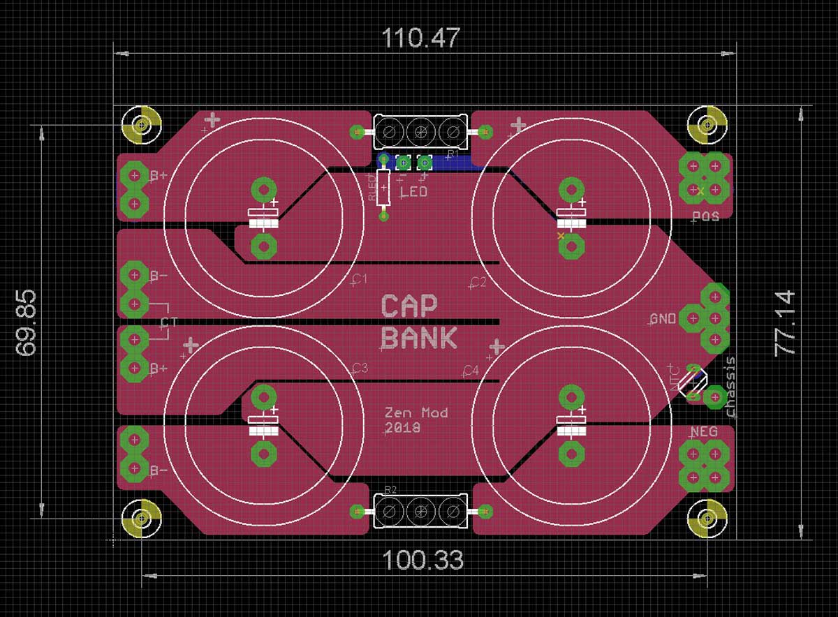

1. 86/82 are magic numbers: I found two articles at Conrad - No. 189056 and 189058
2. no need for thermal goo and it'll be counterproductive
3. too thin for out, unless you use more wires
4. wiring of caps is not good; see enclosed pic and think of pulse current distribution
5. do not power on until you get proper insulators!!!; use mica and grease (if you have them or if it is faster to get them), in case of F4 they're not critical at all; do not forget split washers at mosfet bolts!!!
disclaimer - Keratherms you have are maybe even good enough for F4 (not too much heat per one mosfet) but as matter of priciple .......... I had wrongly delivered exactly that type of K. instead of proper one, and I didn't even checked what's written on bag sticker ....... and it costed me dearly....... blown pair of Dynaudio drivers, time, scorched pcbs....

I am waiting for wires with different color so I will hook the board with them as 6L6 suggested and also I will insulate the CL-60.
Right now I have tested only the PSU and I will proceed as myleftear suggests.

For the wiring of caps you mean that the paths for the negative and positive power supply are of different length or you mean that all the wiring on the caps is wrong? If I am completely out of subject here please ignore it and I will check further on this!

can't be sure thingie is Alu-oxide type, or something like that, which is good one (thermal goo necessary)
all what I can read in data is - ceramic-
without more details or at least C/W figure, no go
washers - you need both big ones and split ones
split ones are safety parts here - thermal cycling is tricky thing
will try tomorrow to edit one of your pics, if you don't catch that cap wiring by your self in meantime

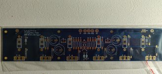

F4 unpopulated board pic?
Hi friends
I'm tele-investigating my F4 build-history due to something not working (debug-assistance is underway in my separate thread)...
I find it a bit difficult to lookup parts-positions on the populated board, and I couldn't find a drawing or foto in a high enough resolution to look up positions.
So, has someone a board that isn't populated, who would like to make a picture of it in a high-enough resolution that the smallish part-denominators are readable?
I'd gladly make a infinitely zoomable pdf-drawing of it for all interested fellows...
thank you!
david

Virtual F4 (drawing of the board, kind of a stuffing-plan)
Thanks to all for their support!
As little as I can return, here it is—I just took the various sources of the boards cvilletypor made and made a graphic out of it.
Thus, IF anyone once might be in need to identify a part on the board hidden in the chassis, this may help a little.
I flatly copied the labels (and verified that Q10 IS Q10 for whatever reason), so that everything fitted the foot of the board...
There are 2 Versions: a colored one, better for onscreen view (and you can search for text ;) ), and 2 outline b/w versions (with type vectorized, not searchable).
For easier view, I put all labels horizontally. This may be problematic for printing because the text is rather small...
HTH
d.
