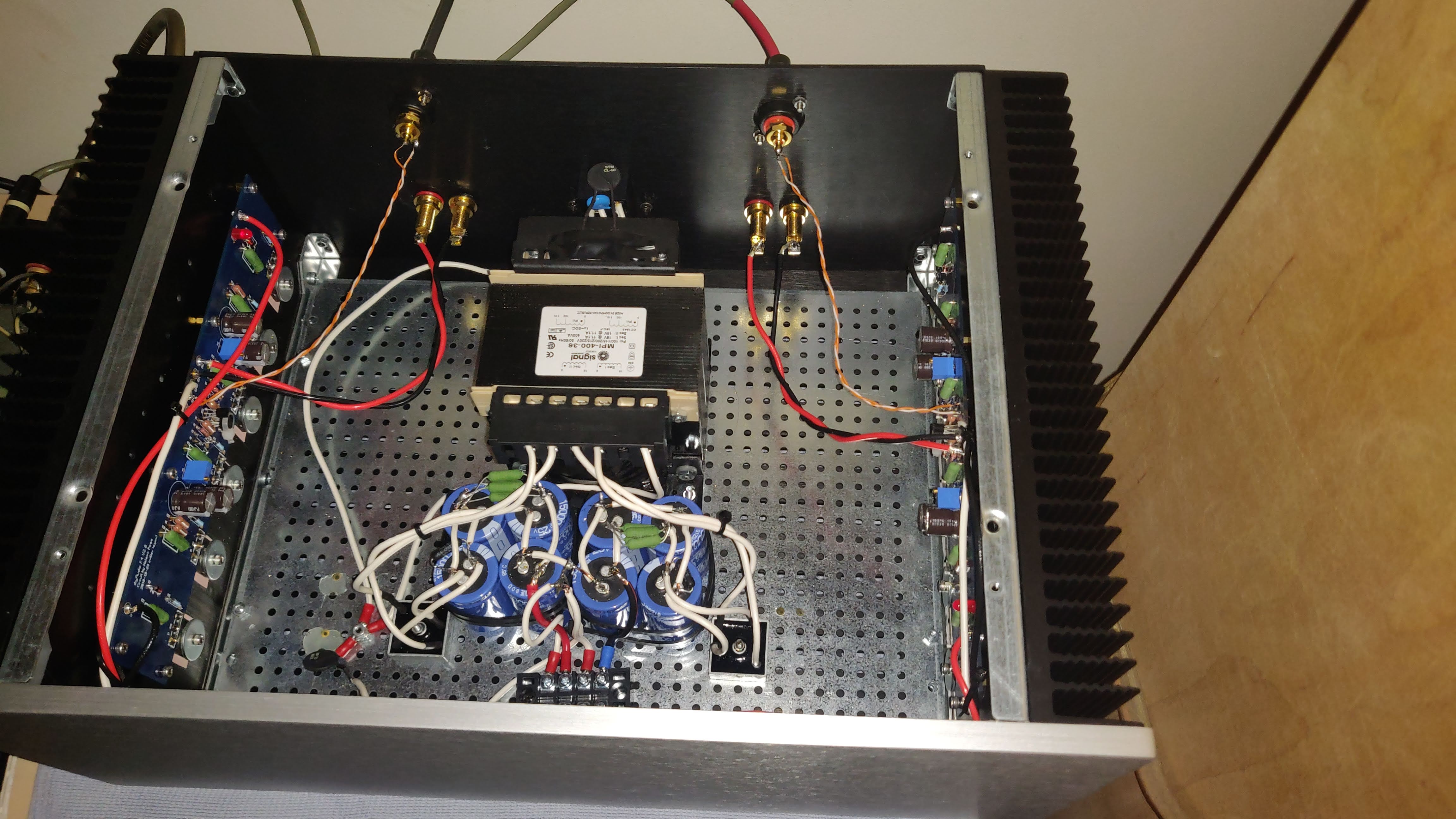

I did as myleftear told and piggypacked a 10Kohm resistor and now I fixed the bias to 200mV!
I have 96db fostex speakers and I plugged it on a 2V source DAC.
Some findings:
1) In terms of volume I really don't need an amplifier, it is not party volume but is enough for the neighbours to complain! That was great finding
2) In terms of sound is the simply the best amplifier I have built, no other comments here, it is incredible.
Some questions as always now!:
1) I measure the bias resistors and not all transistors are at 200mV, some are at 180mV and some at 205mV, is this right?
2) I have a mechanical buzz on the transformer which is audible from the 96dB speakers. You have to move your ear near the speaker to hear it, so it is not critical. The transformer has an interwind shield, I have connected on the earth ground after the thermistor and not on the power supply ground. Do you think that if i connect it to the power supply ground can help here? Do you think than I should change the transformer?
Is these current pulses as Zen Mod said before and I need to check the wiring of the capacitors?
Thanks everybody for all the help again!

xformer static shield (blind winding, whatever) goes to case metal, so safety gnd
no use of polluting audio gnd with it
one of these days I'll find adequate sketch to explain how to properly wire those cap banks
It would be great Zen Mod, I think it will help other members that may want to wire the caps point to point!
I studied the presentation you posted before and I think I made some improvements but maybe I still need some help!

I used 400VA in my F4 so no shield, but in my M2X, I have the transformer shield connected to chassis ground at first, then later move it to the GND of the H9KPXG (to eliminate a long wire). Both arrangement are quiet.
As for the bias resistor voltage reading, the small difference could be from the tolerance of the resistors (0.38 amps for 180 mV and 0.436 amps for 205 mV) or temp gradient near the resistors when the MOSFET's are just heating up. Have you tried increasing the bias to 250 mV and then wait for 30 minutes then measure the voltage?

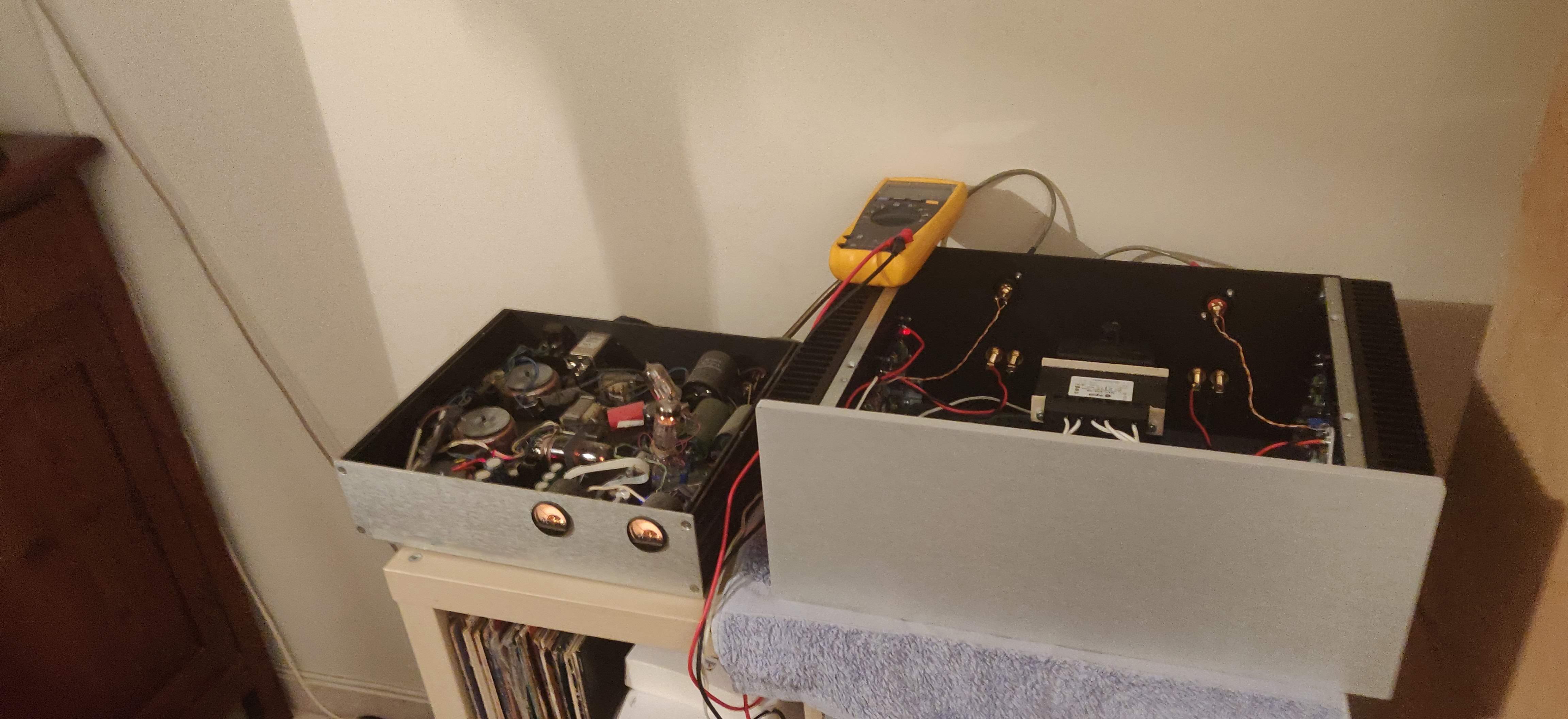

Hello,
the resistors I have used are 1% tolerance (https://gr.mouser.com/ProductDetail/71-PAC300004707FAC00/)
I changed the bias to 250mV after an hour and waited for 30 minutes, the transistors are now between 230mV and 250mV. The transistors have been bought from diyaudio store so the source is trusted!

F4 build is complete. It's been going for 2-3 hours, I've worked through the bias and 0 DC adjustments, and it's sounding good.
I do have an issue with bias on one channel. The voltages across the 3W resistors are currently:
Is this telling me that the MOSFET at R17 is poorly matched with the others?
- R16: 0.215v
- R17: 0.185v
- R18: 0.215v
- R19: 0.205v
- R20: 0.205v
- R21: 0.205v
it's in 15%, don't fret
just the reason that next time (next amp needing matched parts) - invest some elbow grease in own matching

No. You probably have a 0.47 3W that’s off a little. Those are hard to measure without a good meter.
Again, as Zen said, don’t worry about it.
