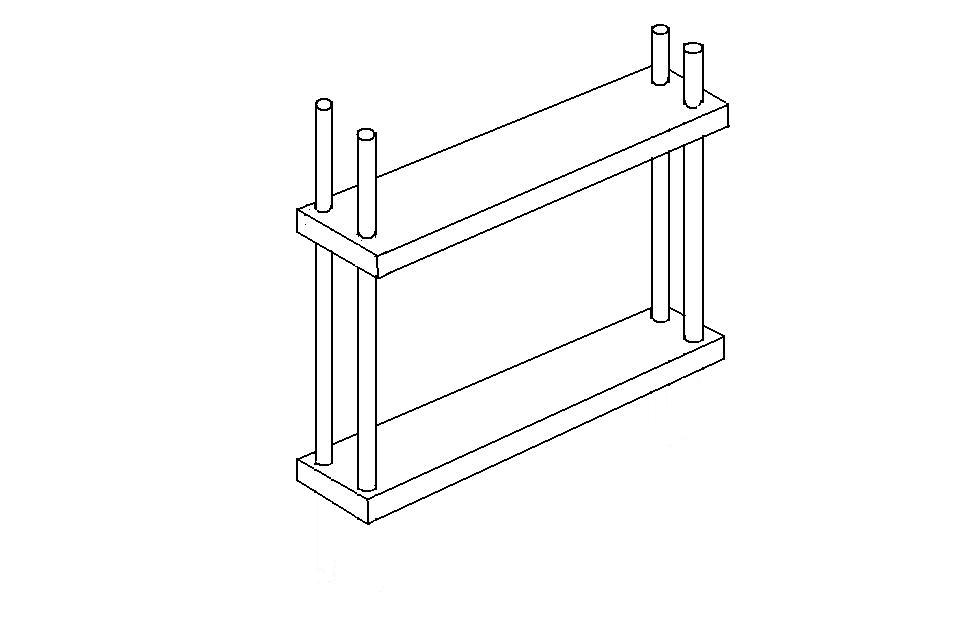

I know we should really stay away from the very strong neos
But I really do think they are essential fore this
Or at least, I dont think I will bother with it otherwise
As I can get quite stubbern some times, I have found an almost safe way to assemble the magnet/pole unit
Magnet I would like to use is 2"x1"x3/4" N50, pulls 142pound, quite hefty fellow
Theres also a 1"x1"x1/2" N50, pulls 58pound, and much easier to handle
Or maybe alternatively consider disc magnets
All magnets should be placed several meters away from the unit to be assembled
My guess is that 1 meter is not safe enough, as they may very well come flying like rocket
Every magnet handled should be marked carefully
Polarity is best found with a small magnet, of which you have marked polarity also
When handling a magnet its best to have a tight grip of the thing
But not when placing it, best to let it go if one cant hold it
Pole unit should be firmly secured, before placing any magnets are placed
A wooden plate could be placed between magnets when placing the first row of magnets
That way the magnet to be placed wont be able clash together with previously placed
A wooden stick and hammer might be needed to get them lined up perfectly
To get the remaining poleplate in place is best explained by the drawing below
Threaded rods with nuts(8mm) are used to control this exstremely dangerous part
One poleplate should have threads fore the rods
Still great risk of something unpredictable and very bad could happen
So all fleshy parts should kept on a safe distance at all times
Did you get a good look at valvitude's frame/magnet assembly on his tall ribbons over here?
http://www.diyaudio.com/forums/showthread.php?s=&threadid=104748&perpage=25&pagenumber=6
He used threaded rods and a strong custom built stand. He also used superglue on one side and epoxy on another side of each magnet.
These huge Neos just scare me with their bone-crushing power.
Makes me want to re-try those electromagnet calculations again. Yikes!
