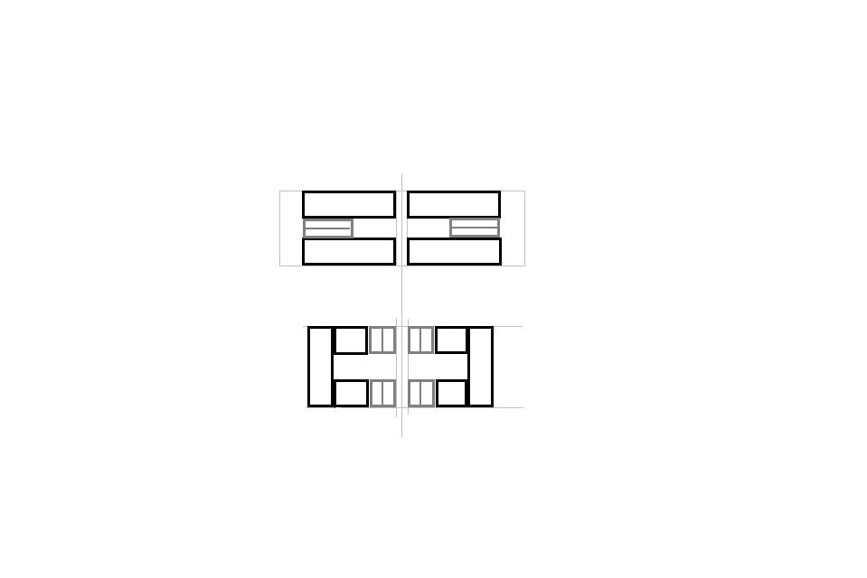

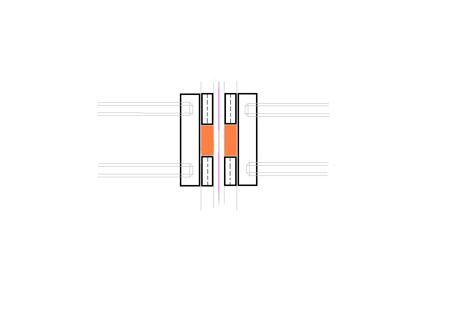

Might also be worth to consider which typ of strong magnet that are commonly available, at affordable prices
I also find it important to use a construction principle that on its own will give a sturdy and accurate result
And as simple as possible, without too much fiddling
With the below pictured design I am worried about whether the magnets prefer to stick to the iron, or whether the magnets would like to get together 😱

The gap can be made longer, and made deeper, and skinnier for more force, but I don't think we are going to be able to push it any higher than about 1.2-1.6T using steel pole pieces.
Since these pole pieces may also need to act as the physical supports for a lot of magnets, using a soft type of iron will likely not be able to maintain the gap evenly, if only supported at the top and bottom.
A design that had supports in the middle somewhere would either need to go through the voice coil "bobbin" in a dipole design, or around the back in a monopole design.
If the front and back are split for a true bipole, the gap can be supported, or even adjusted, at several points, or even continuously. But splitting the front and back gets tricky when looking at the windings.
I wonder if a design very similar to what has been drawn here, but with no rear membrane surface would be practical. We could keep both pairs of magnets, and both the "up" and down" windings, but simply drive the forward element only.
And, actually, this would still be a dipole, but I don't think HF would get radiated well towards the rear.

båndsei,
I stand corrected. That's a mighty pretty picture.
With real world magnet sizes, how big of a gap can we get at that level of flux? 3mm? More?
Any bright ideas on keeping the voice coil centered in the gap? Putting traces on both side (or in the middle on a non pcb version) will keep the force equal on both sides, and driving it from both the front and rear (using two gaps) should keep it moving in a straight line, but it seems like the smallest breeze in a room, or a bit of sound from another driver would tend to push everything sideways.
LOL - Coat everything with teflon and just let it scrape away occasionally?

Båndsei
Very interesting result indeed
Im afraid those magnets will way too difficult and dangerous to handle
Though it might be possible with use of threaded rods, to get the last iron pole in place, but theres exstremely high power on hand here
Commercially assembling would be done before magnetising
Anyway, neos that big cost a small fortune
Thanks for simulating
Any chance you could get time to sim the one below 🙂
But it will probably look very much like what we have looked at earlier
Your sim above clearly shows that things start to happen with the very big neos, but unfortunately not very realistic
But diaphragm weight should be considered, and this one is a bit heavier than a palanar ditto, and is only driven in a small part of its area, where as a planar is active over almost the entire diaphragm, and thereby works ok with much less field strength
Lots of things to consider

tinitus,
Is that 2 or 3 pieces of steel/iron on each side? If it is 3, and all of the white rectangles with black outlines are iron, then it will short circuit and have almost no flux in the gap.
It it is 2 pieces or iron per side, then it is essentially the same design as the one above it that he made, but stretched vertically.
Also, is there a way I can email or IM you directly? You have disabled the ability for us to email you directly from your profile here.

Sorry that wasnt clear
Magnets are forming the gap directly
Iron is on the back
The orange in between the magnets is wood, to keep magnets in place
But magnets are much smaller this way, and its more reasonable to handle
Though I have found some 2" x 2" x 1" N52...45USD...but how to handle those I have no clew, I wouldnt dare to
but VERY tempting 😀 maybe it would mean much less magnets 🙄 but people who have handled even much smaller neos know that they behave like crazy when they get close together
edit, ahh, seems I missed the magnets size on Båndseis sims...not quite as big as I thought, and might be worth the hazzle, as with that design the magnets will keep in place, with the iron on both sides
But somehow I think I will prefer a wider gap
Iron is on the back

I like smaller magnets as well, if we can get sufficient flux in the gaps.
I still like the steel on the outside, if possible, if for no other reason than to protect the brittle magnets from a flying screwdriver. It would hit the steel instead. I think the best design may be one where the steel is strong enough to hold the gap open.
I don't really know the scale of his drawing, but a bigger distance between the gaps may be necessary, as you mention. That will need to be decided by how the voice coil is wound. I think we are looking at a tall pancake winding that can be largely rectangular, but will need some empty space between the front and back sections (the wires going up and the wires going down).
Ultimately, the design I would like the best would be a tightly stackable one. A design that does not rely on support above and below the magnets, so that many of these could be built individually and then stacked, without any large breaks in the line source. Possibly, a transducer that only has a driven element on the front will be the only easy way to do this.
I don't really care too much what it radiates out the back (bipole/dipole/cabinet mounted) too much. Ideal would be a bipole or something appreaching omni, but I can deal with a dipole easily, or even a strong forward weak backward HF pattern.
I would definitely not prefer to spend $45 USD on each magnet, and seeing the FEMM results from smallish Neo40's, I think it will be possible.
