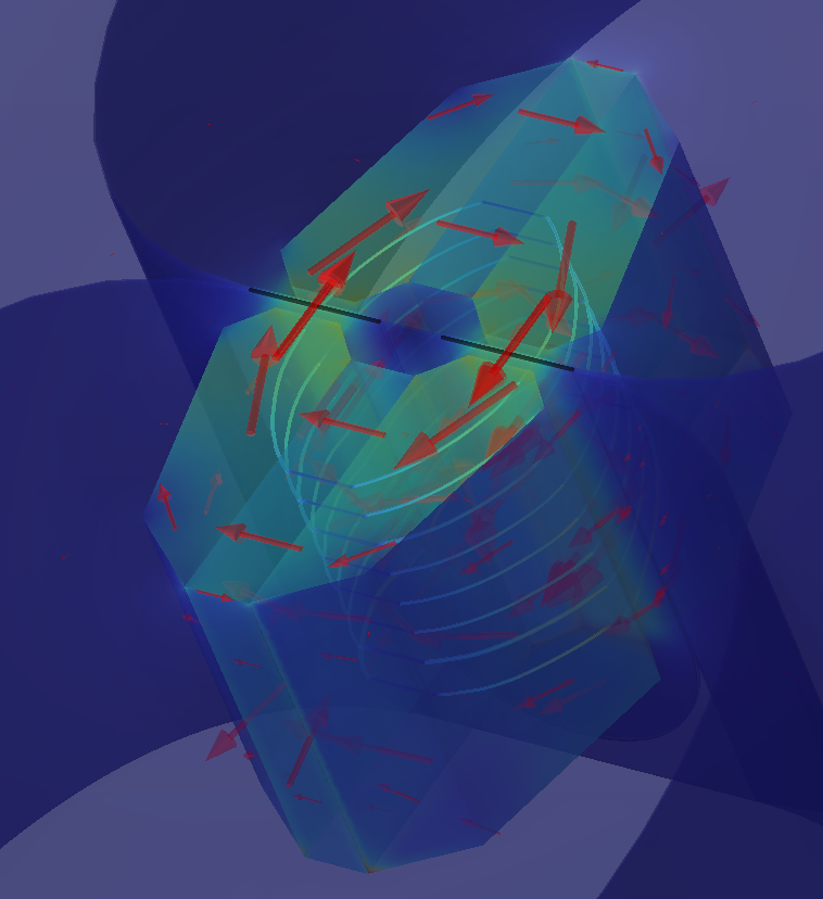

Yes, the second option would be good. I myself made the magnets extend all the way to the end of the pole plate. But experiments can be useful. In my opinion, the most important thing with the Rubanoid is to prevent reflections at the end of the membrane. This hasn't been discussed enough.
out of interest, was the logic of extending the magnets across the entire pole-plate so you could squeeze in more magnets and therefore a stronger magnetic field, or is there a relationship between the plate and the magnets that means keeping them consistent gives you the best use of your magnets
thinking as i type, assuming the magnets are all the same size and strength, then 10 x 25mm magnets in 250mm plates must be a more concentrated mag field than the same magnets in a 500mm plate, for example, right?
Sorry if that seems a simplistic statement to the guys who understand magnetism - but assuming its true, its definitely one thing to add into the mix , and from what i see in previous postings, its not something many others are doing

? well the coil should be as small as possible compared tot the magnet stack (slightly longer) (so use as litle as metal compared to the length of the magnets and let the coil peep out just above the magnets). ... clearly else halve the coil would be in a weaker field if they would be 30 cm and the magnets only 20cm.
What i thought when i read the post was, a smaller ruba sounds better in the top end then a longer one, and there is also something to say about. since if they are long they act like a line source. and a 30cm line source... does not sound nice. also the top end does not add upp after 6-10cm everything ebyond 10 cm length adds more and more to the lower end. could be nice but could also make it heavy on everything under 3 khz etc
Hi WrineX - very excited to be discussing this with you. there are 2 main points you raise
On the first, you are certainly supporting to the view that the coil needs to be HIGHER than the magnet stack, and I assume this is for the earlier stated reason that the curve of the coil is outside the mag field, and yes, it follows that the height should be as little as possible outside the magnet stack - except that the measures i took kinda support the opposite, which was the best measures were from a 140 coil (including curves) within a 275 magnet stack, so SHORTER - the one i did where the coil was higher than the magnets (but still shorter than the pole plates) gave the poorest measures of them all, . I can only think that other factors were influencing or masking this, possibly including your line source comment

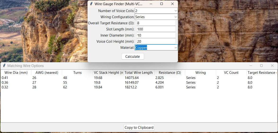

is the impendance the same ? if you used the same coil but longer/smaller it would change 🙂 also its hard to use femm for instance to see exactly what happens in the middle. it might be a tiny bit stronger then using all of the field in combination with lower impedance. (at the ends there is more steel less magnets, i mean the metal extends further then the magnets) due to the way these motors are contructed. when sing fem you cant model those 🙁 sicne it is 2Dwhich was the best measures were from a 140 coil (including curves) within a 275 magnet stack, so SHORTER - the one i did where the coil was higher than the magnets (but still shorter than the pole plates) gave the poorest measures of them all,
Yeh, impedance was around the same level - its not identical across a the different sizes, but i calculated the turns needed at each size to result in similar resistance - the 140mmm one had a couple of turns too many and was the highest at 8.7ohm (it was calculated at 40 turns, and i may have miscounted.... ) , but all the others were 8.0 or higher
I am certainly not ruling out that the differences were influenced by the resistance
and yes, i was kinda wondering if the field is constant or concentrates out from the centre - that might also influence why a smaller membrane of 6-10 is preferred for high frequencies?
as I said above, i suspect there are many factors interacting, and for sure the impedance could be one of them - after easter i can create a series of membranes at 140mm with different ohm and see what effect it has, beyond sensitivity - but i would like to spend a little effort in doing a proper Design of Experiment (DoE), working out the factors i want to test and running different combinations of them together, as that is the only way that the interactions can be spotted - unfortunately i no longer have the statistical software thar helps with this, so i will need to calculate it myself, so need a nice clear day
