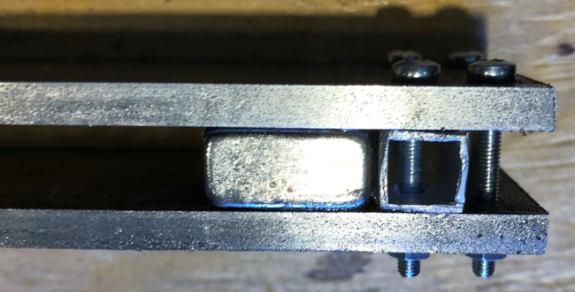

I've come inyo some 25x40x14mm n52 magnets and some 33cm long pieces of 25x10mm mild steel cold rolled bars. I intend a small (30cm) experimtal rubanoid motor. What's the best step-by-step way to construct the motor sides. Do I glue all the magnets to one bar then slide the other bar into place? Or do I slide each magnet one at a time into place between the bars then glue. Hoping someone that's been through this can give thie insight. (I will probably need to construct a jig to keep from losing digits. )
Hi cubby, this is the most tricky and dangerous part. Here is the translation of what wrote the late inventor :"Magnet assembly (the only difficulty is assembling the magnets and assembling the two motor halves once the magnets are assembled)
- Place the second flat bar, gently bring it closer to the glued magnets. When it is in place, slide it in with a wooden mallet.
Assembling the motor halves is quite difficult because the magnetic force is intense and you can easily crush your finger and have It was difficult to remove it.
I used softwood wedges and glued the air gap shims on them. Then I rolled one half of the engine onto the other with aluminum rollers. When the engine halves were in place, I removed the rollers and then removed the wooden wedges with an aluminum blade.
(This is the hardest and most dangerous part to do. Keep away from children and wear thick gloves.)" Just do it and good luck !
- Mark the orientation of the magnets. when assembling they must repulse and not attract them to each other.

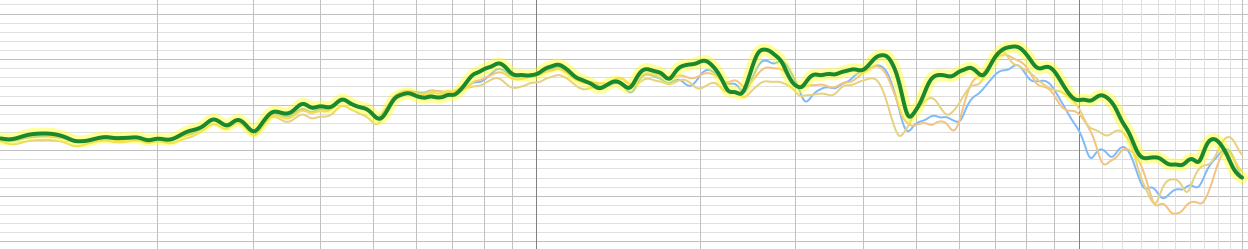

So I tried to run a design experiment.
I made 4 identical membranes – 140gsm canson, same method of fixing the coil and combining the membranes - I focused on making the membranes identical rather than making them sound /measure the best, so used things like double-sided tape etc.
The only difference was the height of the coil, and also the variation in measured DC impedance
so to summarise - a coil half the height of the membrane / magnet stack performed as well, if not better, than coils which were sized closer to the membrane height/magnet stack
I have deliberately removed the scales etc on the graph, as the experiment was to compare traces, not optimise the response etc. the SML coil is the highlighted one, and pretty clearly (at least to me) performs best
Absolutely not the result I expected – I actually ran the result twice, a week apart and on both left/right motors, and the results were consistent
So right now, it looks like size is important, but despite what you might have heard, bigger is not better

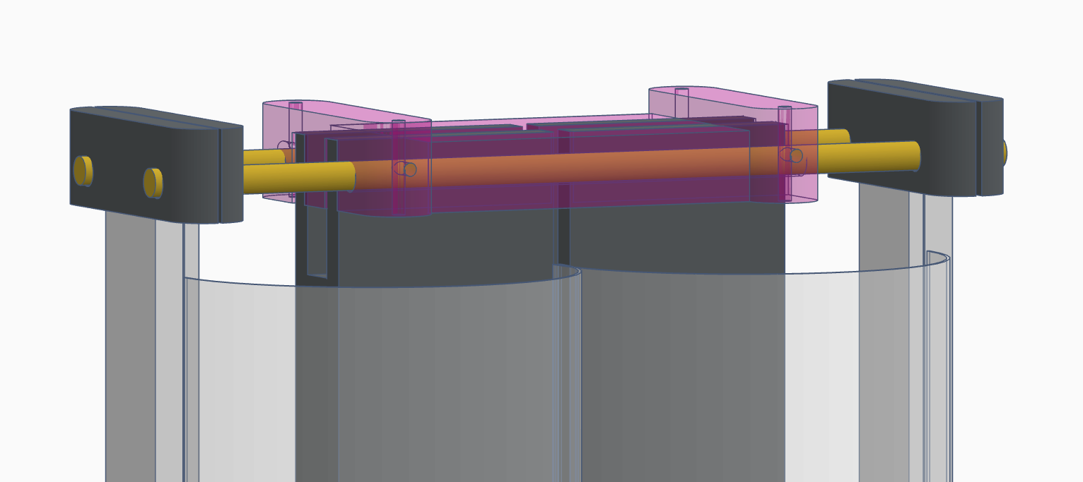

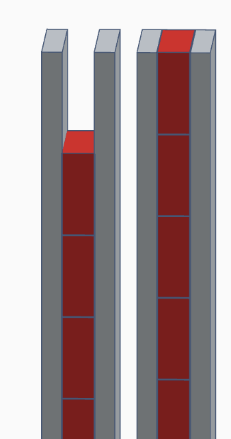

The coils should be slightly longer than the pole plates and located in the center of the magnets. Why are the pole plates longer than the magnets? So, was the short coil tested in the longer drive? Regards
Hi Ruba1, so grateful for the reply
to confirm current dimensions - the pole plates/magnets are (depending on your orientation)
*horizontally - magnets and steel both 50mm
*vertically - 360mm steel poles/275mm magnets
the extended section above the magnets (effectively 2 "prongs" of 42.5mm) is where each side is secured and inserted into the top housing - this kinda follows the various postings here - a great visual example is this one from Solhaga, back here: https://www.diyaudio.com/community/...peaker-of-a-different-kind.69450/post-5483517:
My suspicion os that when you refer to length, its the horizontal you are talking about? in that case, the length of the magnets and the pole peices are both the same, at 50mm
I might be misusing the term motor, pole plate etc. so that might also explain my confusion? if so, apologies

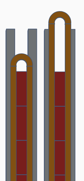

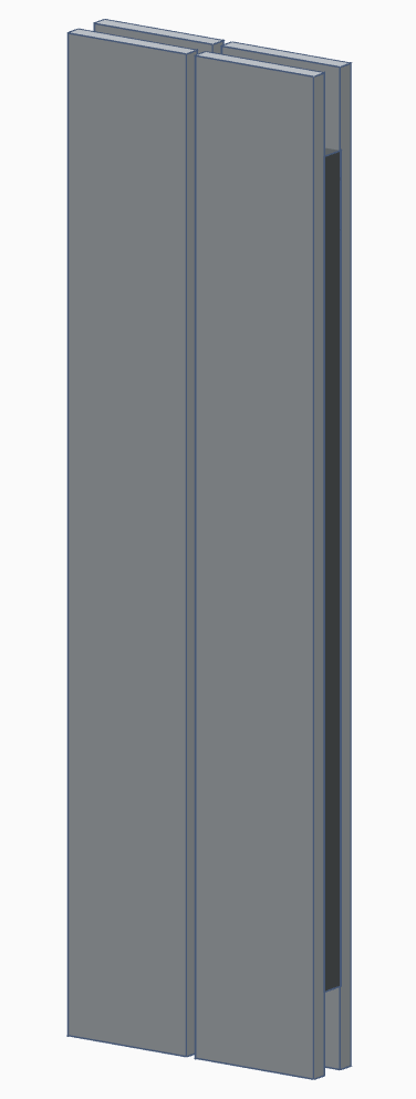

please see image below of my design, where i have made the top housing transparent purple, so you can see the prongs entering the housing:
what i interpret from your comments can be shown pictorially below (magnets in red, mild steel in grey)
on the left is what i have now
in the middle is what you seem to be recommending?
on the right is a rough view of how the coil is currently located
(obviously, i am only showing one side of the motor here 🙂)
Again, really appreciate you taking the time to respond - just not sure my initial post was clear enough? really hope this one helps refine things

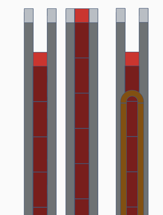

Okay, misunderstanding. So, the coils are in the middle of the pole plate. With the short coil ends, with a radius, there may be lateral movement. I don't know if you can hear that. Regards
again, thanks,
i remember an earlier post- might have been WrineX? - that seems to relate. you are saying that keeping the radius of the coil outside the magnet field would mean movement would be reduced/removed in the lateral plane. right
so something like either of these (the 2nd is maybe the only one that would work for this):
if so, that seems very logical and worth me trying, to see if its audible - thanks👍
