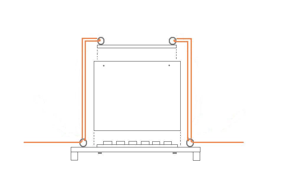

One way to make a tool fore assembling
Two is needed, one fore each end
Its not too complicated
Need to be changed/modified a bit fore joining the two assembled magnet systems
At this point theres exstreme power to be handled
Theres a total of 20 magnets involved fore each speaker
Each magnet have a pullforce of 100lbs
That a 2000lbs of pullforce
Man, that means that this thing could lift a small car
Thats pretty dammed crazy
Might have to update my welding, before building the tool
Glue is still to be considered
Maybe silicone
Its able to hold very big aquariums together
But maybe dont give the best metal-to-metal contact
If thats important at all

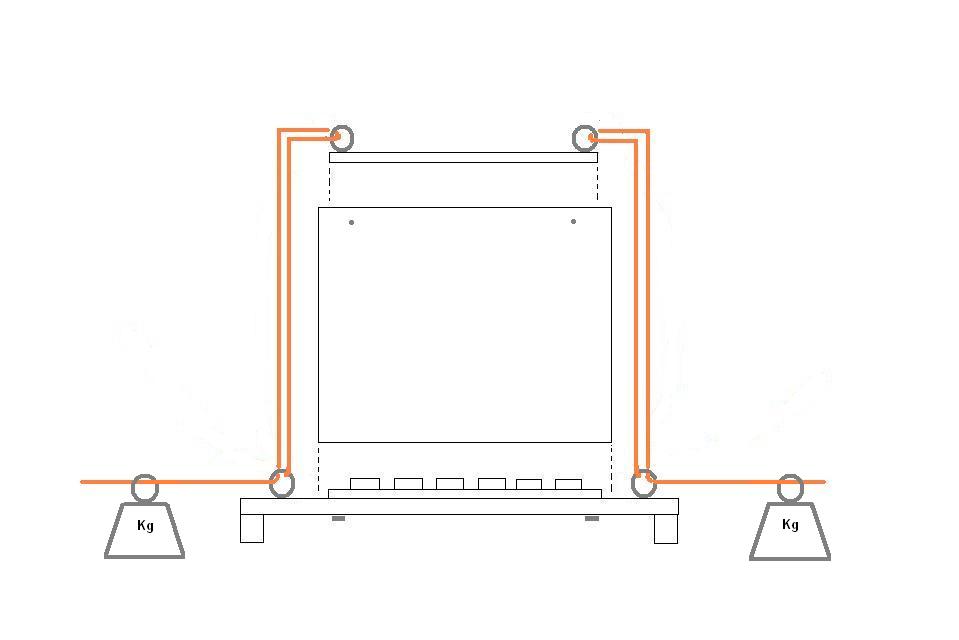

New simpler tool
Im grown up by the sea with sailing and ropes
I know that its easy to control exstreme power with a rope, if done right
So I thought, why not
I also reconsidered my choise of magnets
I know that a row of magnets dont like to get too close together
They may spin and act like crazy
Though, I would expect that these powerful magnets will hold on to the iron quite well, but not really sure
I have also just read that the neo magnets may loose their power over time, if place with same pole very close together 🙄
Some means of fixing the magnets while glued on to the iron may be needed
Using iron poles, why not let the iron do the work
Im sure its equally good with less magnet, and some distance between them
But instead use the best there is
Looked at some 2" x 1" x 3/4", pulling 145lbs 😀
Im sure that if two magnets should clash together by accident, it will be impossible to depart them again
So everything possible should be done to avoid that
A piece of wooden plate might do the trick

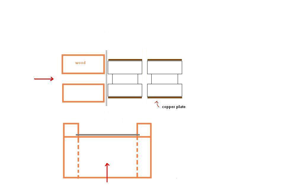

Picture shows first step assembling each magnets section
A wooden box is used to fix the poleplates during assembling
Next step with assembling the two magnet systems is almost the same
Hi Tinitus
I think it is a good idea to mount the magnets with some distance ,but donnt use iron ,it will shortën the magneticfield.
I have a good way to assemble the magnetsystem.If you look at the picture from Rumanoid,I think there is a 10x10mm.alu "in front" of the magnets.So if you assemble everything ,but the magnets,the alu has to be fastened with stainless bolts thrugh the iron,You can slide, or tap the magnets in betwine the irons.There will be no use of glue as the magnets will atract each other cross the gab.
Ps.I would use solid alu5x10mm. to get the magnets closer.
PPs.Try it out with ferite magnets,to avoid accidents.

My english is not so well, so i must have got it wrong.The magnets have to be mounted between 2 picees of iron 10x40mm.
my.php
Here is a picture that could illustrate what i meant as i said slide it or hammer it between the iron bars.
I dont want to build my own "rubanoide",but if i had to work with magnets that strong i would test the progres to assemble it with weeaker magnets,just in case.

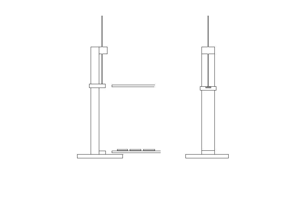

Båndsei
Its a very interesting idea you suggest with assembling the iron poles first, and then slide in the magnet
Im will try to make a secure and safe tool fore a better controlled process
I think of this little tool like its kind of a "mousetrap" 😀
I imagine it works with placing a magnet into the "trap"
Theres an alu plate preventing the magnet to fly hard against the iron when approacing it
Then "simply" pull up the alu plate and the magnet is secured between the pole iron
As you say, it will probably need a bit a tapping afterwards to get the magnets fully in place
I have high hopes about this
The big advantage is that with the preassembled poles, theres no handling of the exstremely dangerous assembled poles
Its all held perfectly in place by the magnets
No glue needed
And once the whole thing is assembled theres no dangerous magnetism arround it neither
