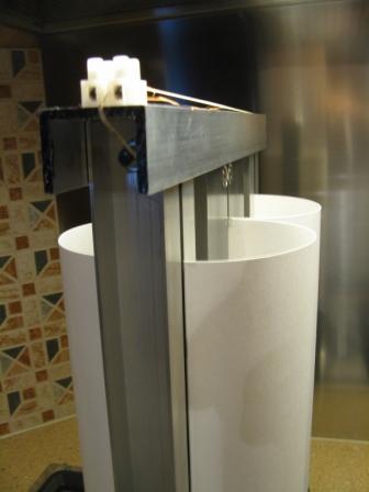

Actually, I have made a pair a view weeks ago.
They are playing right now.
It's a cheap version with ferromagnets instead of neodymium magnets.
The "ruban" is 200 grs hobby paper. Coil: Ø0,2 mm copper, hand wounded and glued between the paper.
Magnets 40x25x10 with a total height of 300 mm.

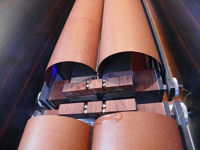

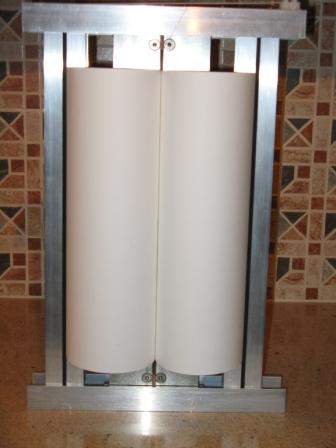

A few pictures of my prototype.
The sound.
At the moment I have no good reference, but they are easy to listen to, a wall of sound, invisible, small sweet spot.
Suspension.
None, just the paper. But it was not easy to adjust.

Looks like a solid build, nice
Yes, I also believe the "coil" to be a tricky part
I will consider to do it underhung
I think the original Rubanoide has a thread to prevent sagging
I consider to use 2 strings in a "V"..."a henfoot", like men of the sea call it

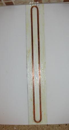

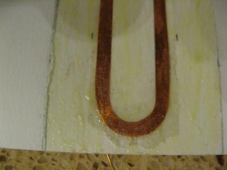

Coils are hand wounded.
Every turn was glued on the paper with cyanoacrylate.
3 to 4 hours work, and a lot of patience
Here's a closer picture, just before sticking the two pieces of paper together.
Center distance of the coil 20mm, length 300mm, turns 16.
Henjo

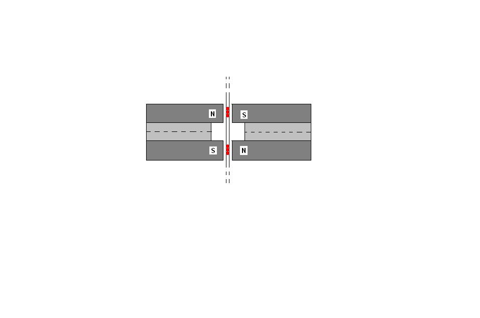

Fore what its worth, here the principle of "motor" design
One huge advantage is that you can use very strong magnets, without having any problems to keep them in place
Another big advantage is the narrow magnet gap, over a ribbons and planars
And you get two gaps with opposite polarisation, perfect fore the "voicecoil" having "two directions"
And you can make it underhung
And not to forget all the other stuff like sensitivity, huge bandwith, cheap materials, use of solid copper wire, etc
And probably close to indestructable

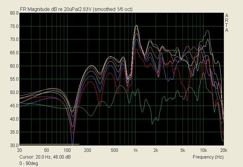

Here is a quick and dirty measurement. Uncalibrated microphone.
Graph isn't labeled. Steps of about 15 deg.
Yellow = 0 deg.
Green (light) = 90 deg
BTW magnets are ferrite class Y30BH.
Henjo
