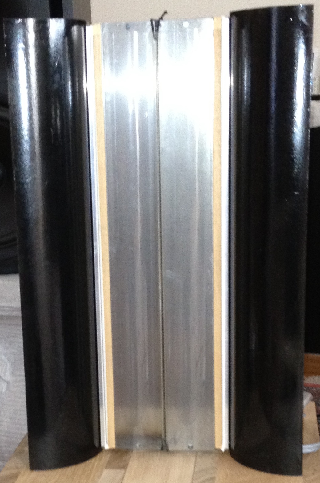

my own Tangent Ribbon !...
Here is my own tangential ribbon...
Sound is immediately loud. It lacks some high frequency range and it haves an uncommon radiation pattern !
Definitely an amazing driver !... It surely deserves more studies and developpment, IMHO !
Hi ondesx.
Please more information!
Looks like a planar diaphgram?
What is there with the radiation pattern?
Why did you change the rubanoid type of diaphgram?

Hi, good prototype, congratulation.
If you are looking more high freq response, i believe that it is good to understand the technology. I think that this kind of driver is on the Distribuated Mode Loudspeaker (Or DML) group driver technology. You can google it. Rgds

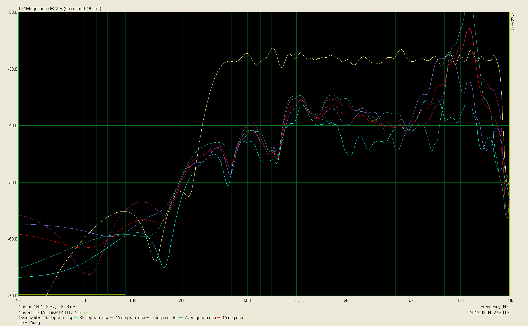

Hi All,
Vincient Brient and I are the only ones who are posting measurements of this ribbon on the web. Ever tried to find measurements of the commercial variants of this loudspeaker?
You know why? Because they measure miserable.😕
Here is my second measurement publication in this thread.
In this graph are 5 measurements.
0, 15, 30, en 45 degrees. Without DSP.
Calculated average power respons of the 4 mentioned above.
The 15 deg. curve represents approximately the average power respons.
So I tuned the FR at 15deg with DSP, and is represented by the yellow curve.🙂
Measuring distance was 1 meter.
Henjo

You are partly right Henjo!Hi All,
Henjo
