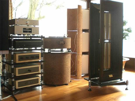

Not much usefull information, but anyway a nice look
http://www.audio-consulting.ch/?Products:Speaker

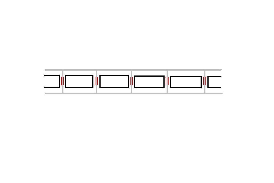

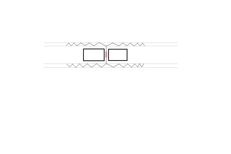

Still thinking about other ways to do the diaphragm
Maybe something like this
"Diaphragm" ? maybe just ordinary paper 😀
But how about impedance ?
With foil fore "voice-coil" it will need a trafo
Maybe multiple thin copper wire could be used ?
Mechanical construction at both ends become slightly difficult

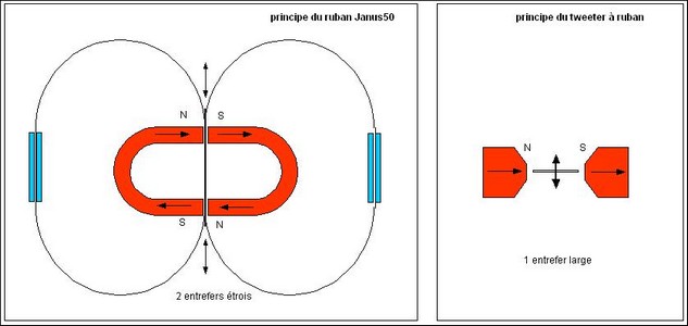

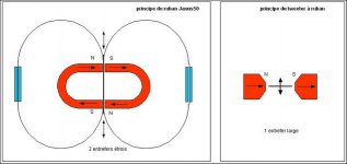

When I click on that "construction" link at the bottom of that page, it appears that "no secrets" is not what the author has in mind.
It says there (in French):
"I have decided to protect my invention." (and paraphrasing heavily) "Send me a check for 200 Euro and I'll send you a key to get to the secure documentation about how to make one."
I like your picture better, tinman.
I could actually design from that. And an adjustable gap sounds like the way to go with this completely.
I would probably cheat the big horseshoe sections and use two bars and a piece of steel to complete the circuit on each side.
I am now assuming the flat coil has the conductors go down the front and up the back, so that the entire coil and membrane acts together as a single dipole arrangement (since the gap in the back has reversed polarity from the gap in the front).
