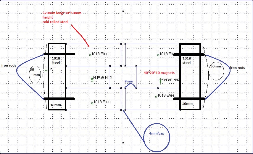

well you can add another 2 pieces of threaded rod holding the steel in shape. bolt a piece of aluminium to the steel and thread it since there is no room for a nut in the middle part
of course i used wood now but it can be a super structure of your liking 🙂
something in the line of steel u shape or aluminium extrusion machine profiles ? easy to assemble and easy to line up

I'm kinda stuck at the "u"reinforcement bars... Do you know any lightweight alternative to the reinforcements that i use now? They are kind of bulky and heavy..
I'm searching for an alternative but found almost nothing.

Same but in aluminum ? Except for the motor itself of course . Look for aluminium extrusion profiles either blank or the machine building blocks

I have a one more thing to ask you please. Can you simulate the case bellow?
I am curious if an adenum of the same steel on the back of the magnets will short circuit the magnetic motor or will increase the field strenght in the gap and ads resistance to the hole motor structure..

it does not work like a horseshoe magnet you will have to make 2 L shapes and sanwitch between the end of the L , hard to explain. Anyways if I remember correctly all the field will go to where you shorted the magnet. 🙁
The backing plate may be of stainless steel. So no shorting of the magnetic field ?I think i modeled that one before and iT Will short iT 🙁

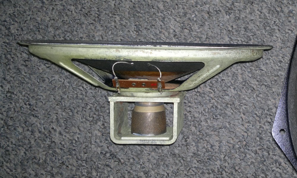

Thank you my friend. Indeed i was thinking at the very old electromagnet speakers or alnico's like the one bellow. I thought it was a good ideea. Sad..

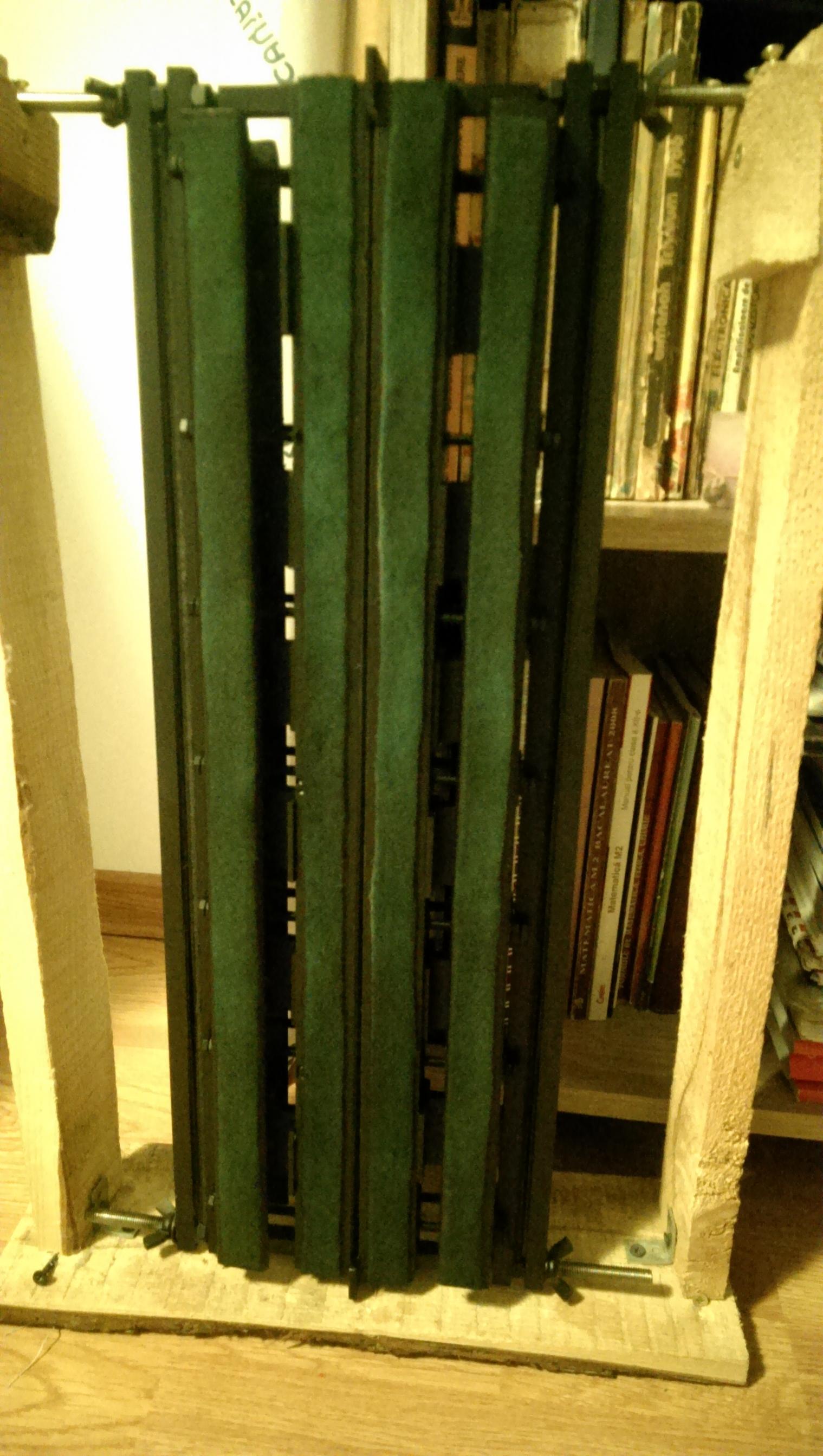

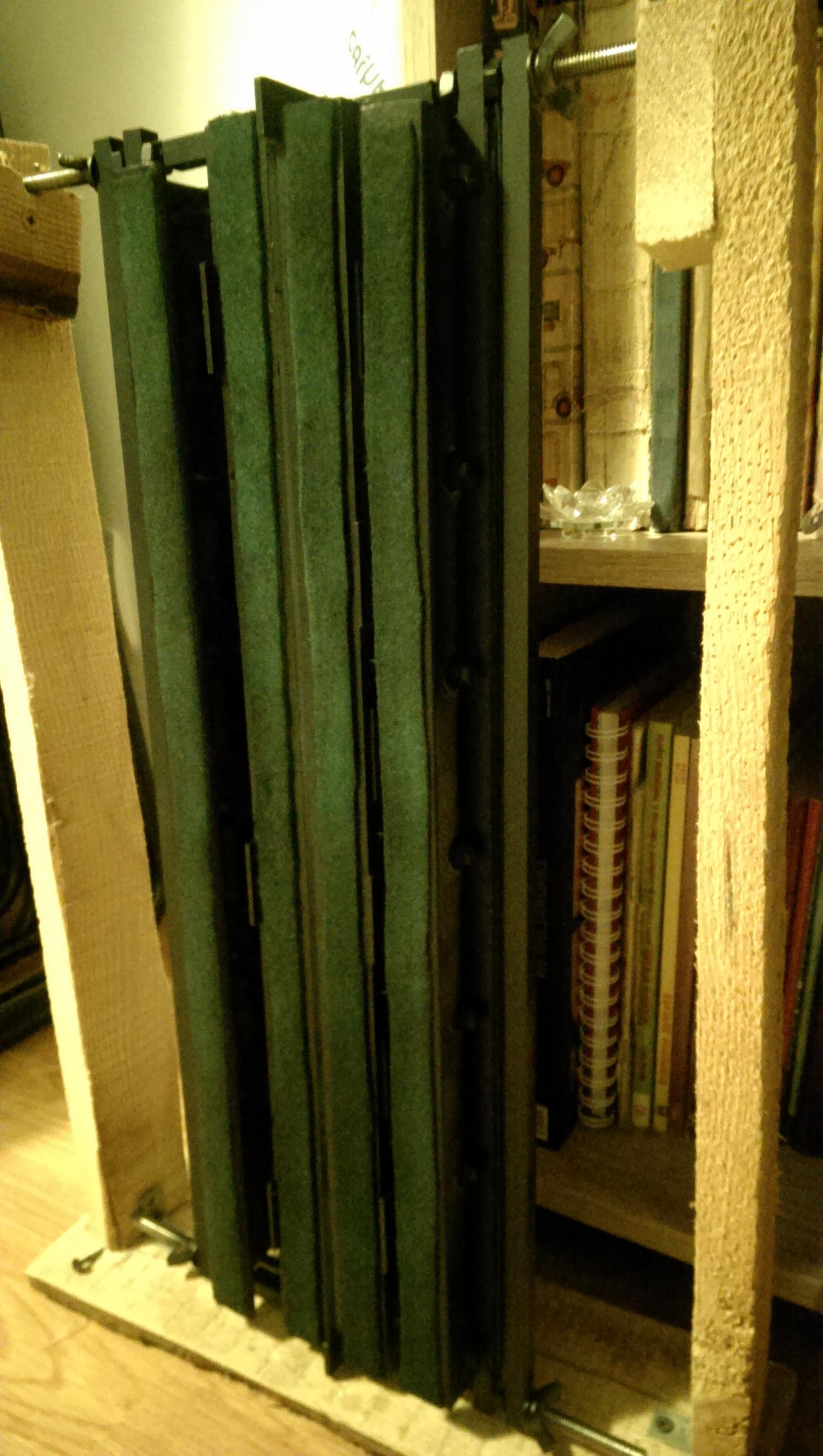

Anyway. I just found a sollution for the wood problem. I made diy H frames from the T's that i allready got. It seems that the specially treated oak got squashed (1mm the left side and 1 mm the right side) by the pulling force, so i remained with just 2 mm gap and the membranes rubbed. This week i will reassemble the motor back.
Will post pics tomorrow. I'm glad that i finally found a sollution.

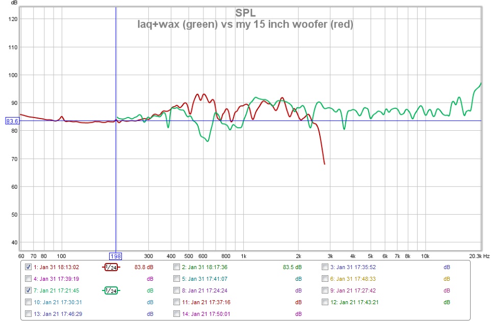

I forgot to post a pic with the 15 inch woofer+ ruban. After the listening sessions i dissasembled th ruban to make the final coils and seen that the gap was smaller and rubbing as i sayed earlyier. Here are some measurements. The mic was at the level of the frame of the 15 " bass and after i measured the bass, i positionned the mic perpendicullary, on axis at the level of the round edges of the ruba cils, with the bass disconected, to measure the laq+wax almost finall version prototype ruba..
I listened to this interesting combo and making adjustments for about 2 hours then diassembly everithing. The filtering was second order for bass and first order for ruba(300hz cutting point). The ruba was positionned 10cm in the back (still on axis with the bass) for my bass tastes to be fullfilled
The sound was very powerfull (at 10W mono@jlh 69 amp @75% volume from the phone), in a way that i could barelly hear my wife speaking (from almost a meter a way, where she was) 🙄 in a listening room of 20sqm at 3 m away from the speakers. The sound quality was even more staggerring now with the adenum of the bass. Its pitty that the ruban cant go lower than 150~200hz. Its interesting how the bass contures and spices everithing up.

Ps: the measurements where made with no filtering. I cutted the frequencies from REW, then joined the graphs togheter.

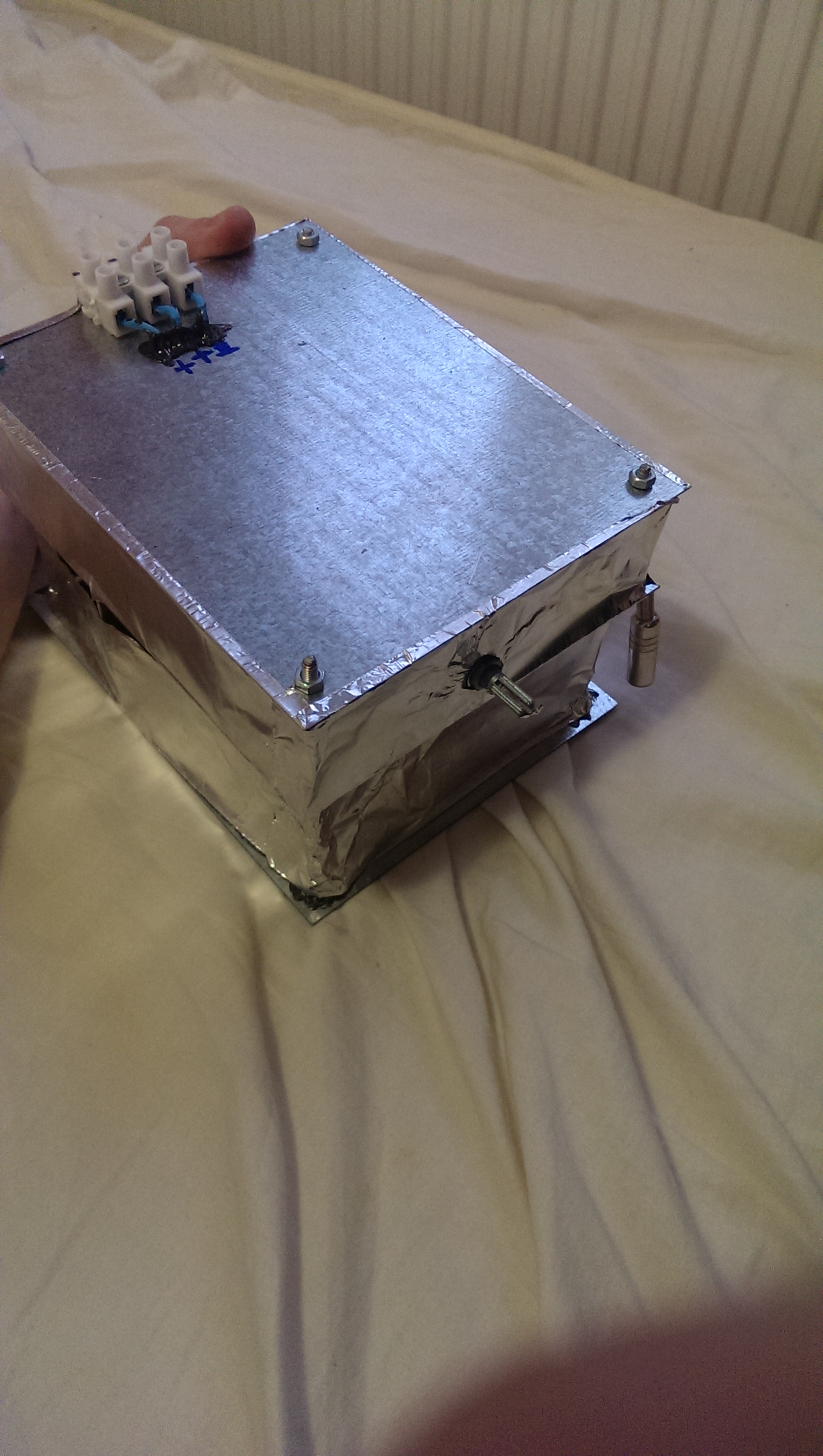

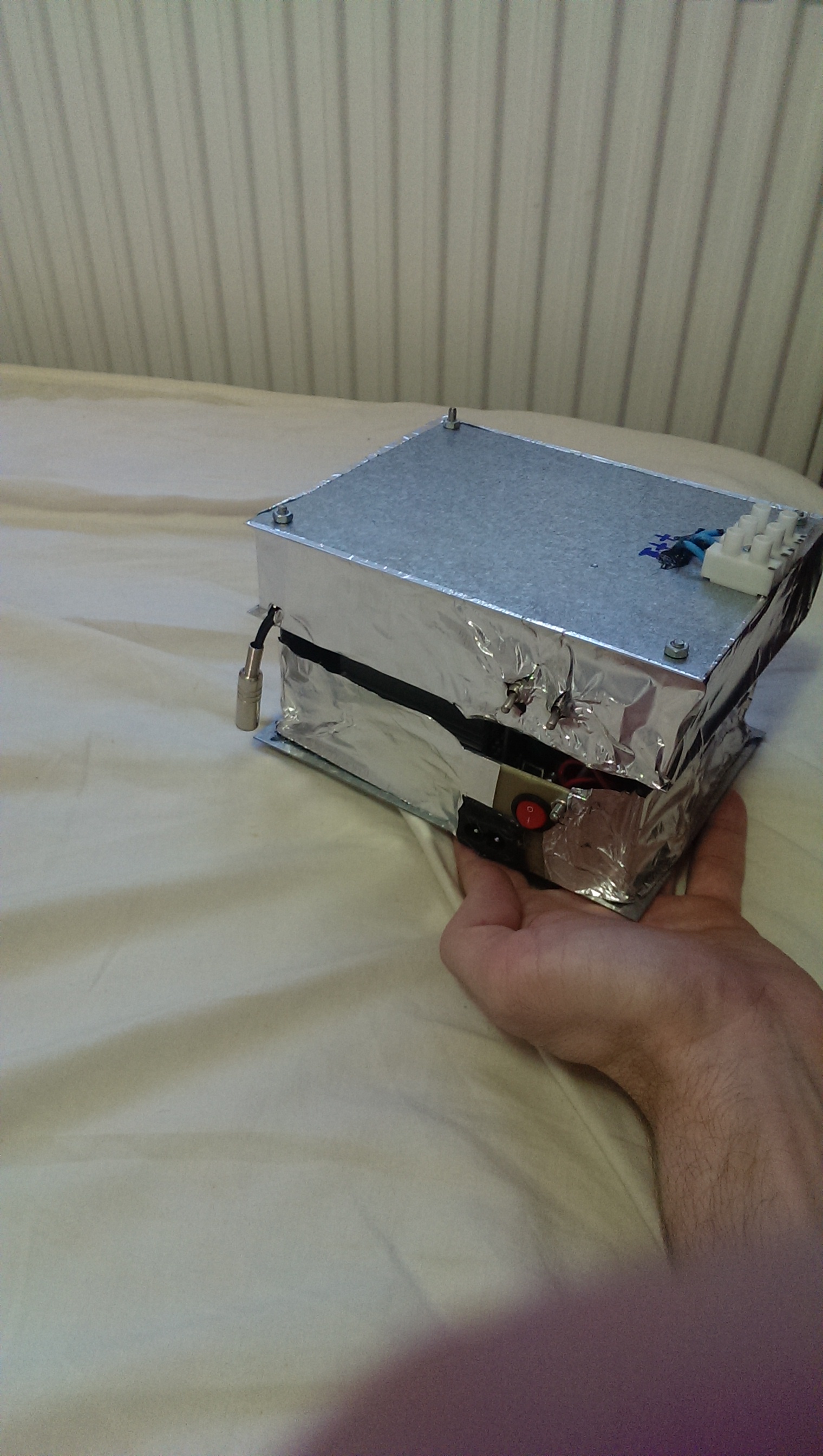

Also i made a new housing for the mic phantom and preamp wich is completelly shielded in a carbon steel 1.5 mm case. Everything is shielded and well bolted now.
