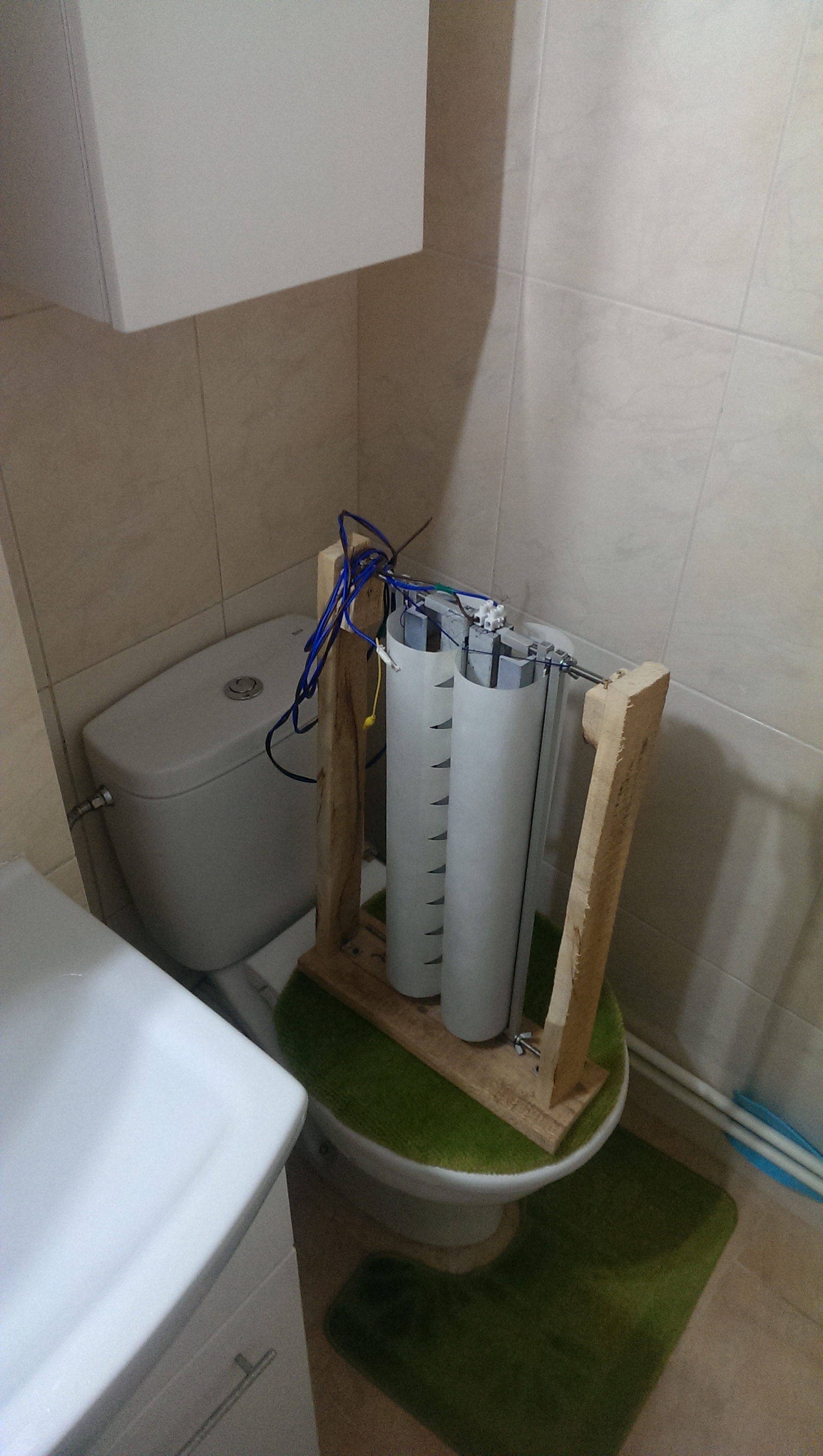

This morning when i made a hot shower, an extreme test came to my mind... i close the fan that vents the steam out of apartment bathroom and after an hour i placed the wax + laq ruban onto the toilet seat and let it cook as seen in the photo bellow...🙂) Of course you couldnt have that much humidity in your house even if its raining like pouring drops with a bucket outside. 😀
After three hours ( 30minutes ago) the results are encouraging. The membrane bended in the 4mm gap but not much. I still had almost 1mm till rubbing in the center. Took about 20minutes for the coil to get straight again in my listening room (wich is periodically vented for fresh air). If i had 3mm gap, the coil was definetly rubbing.

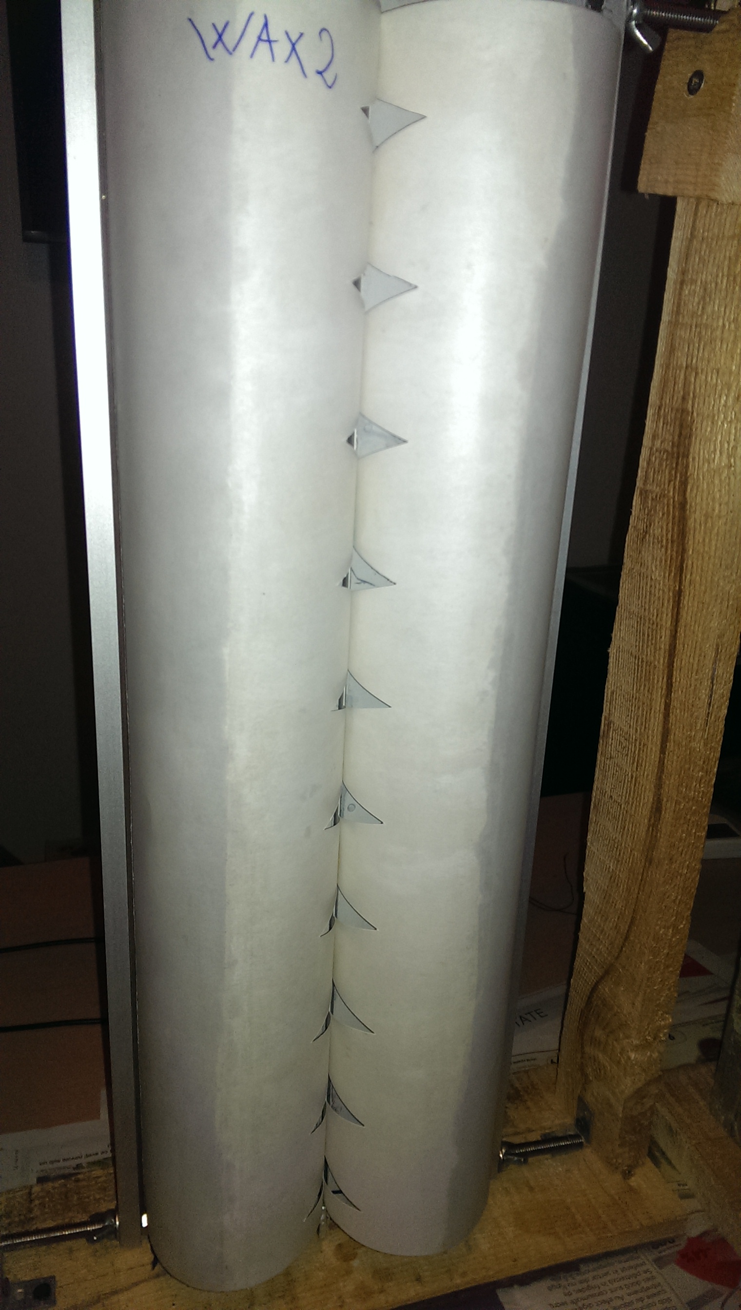

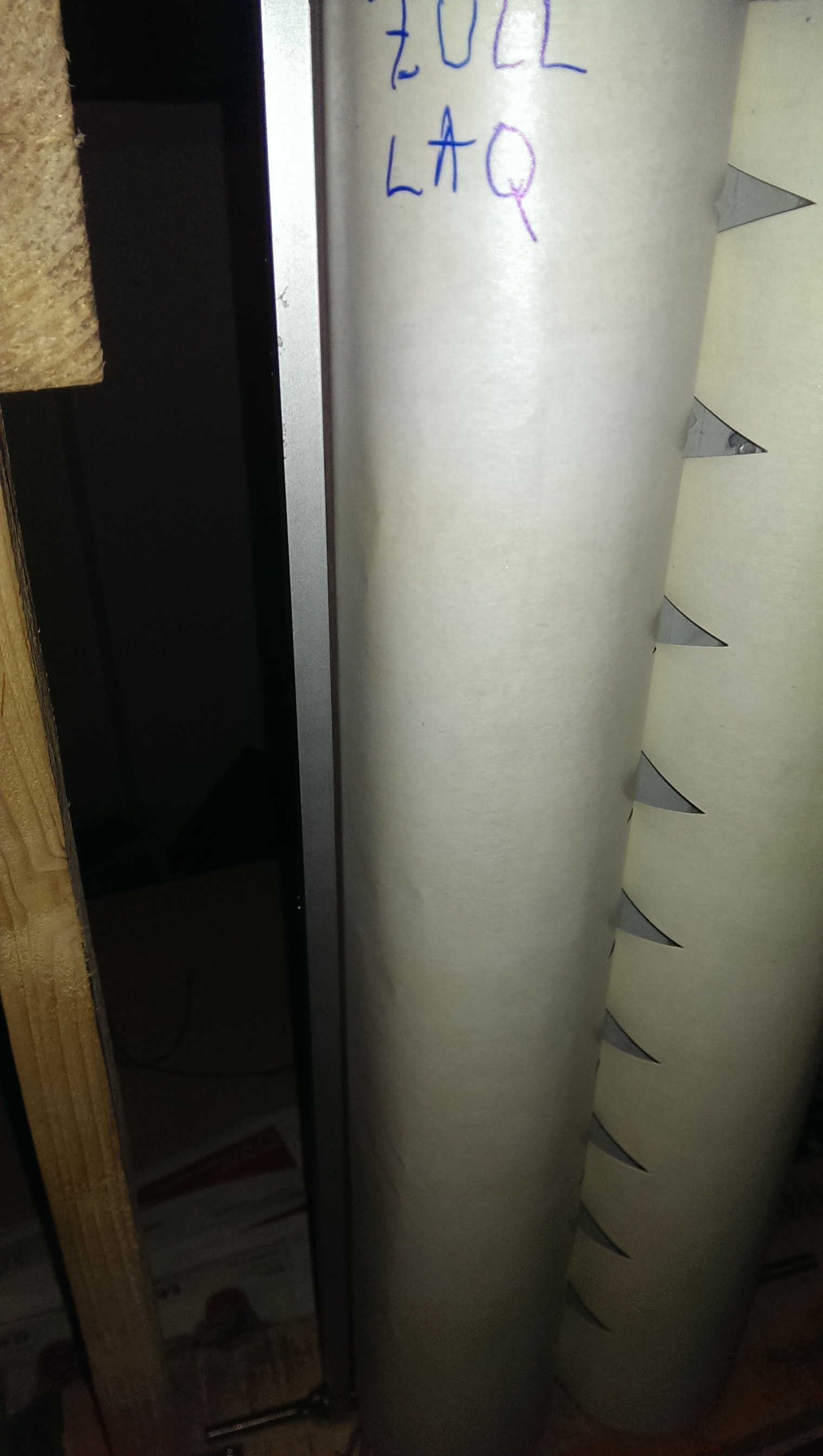

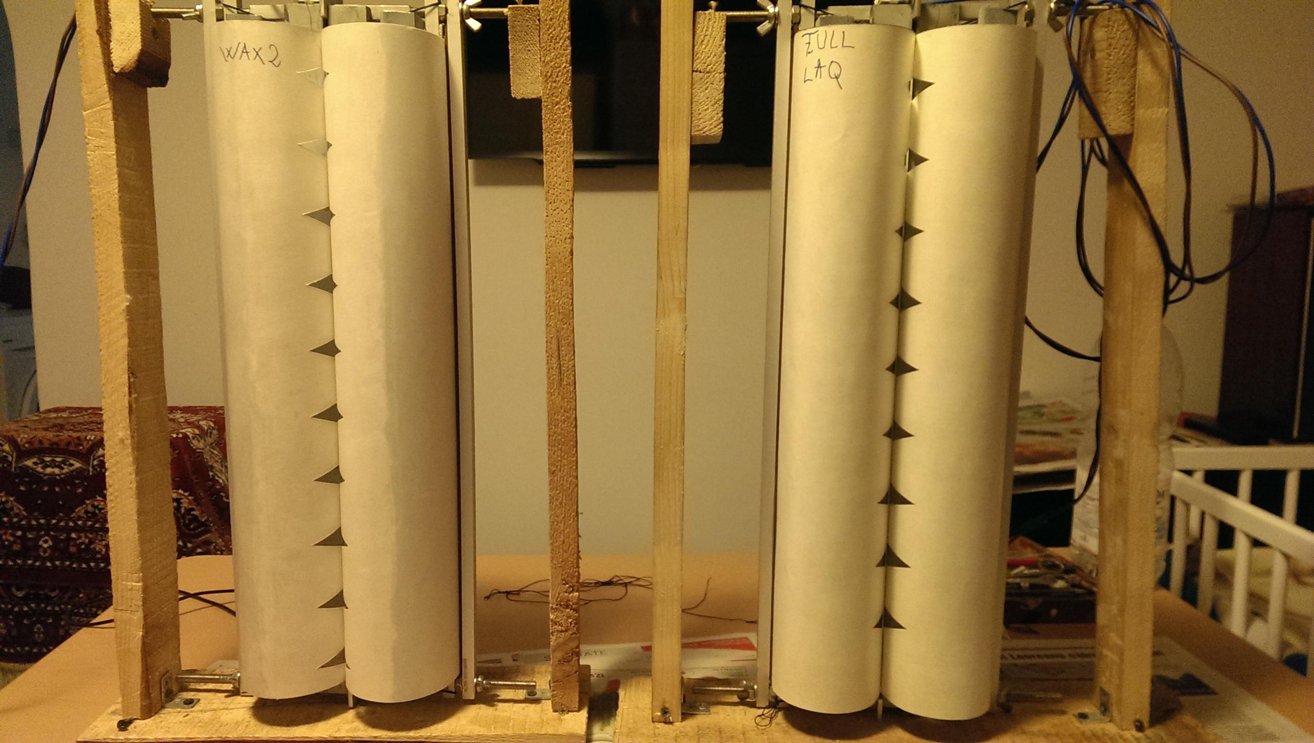

Today i auditionned two vers of rubans: the full laq (wich has laq applyied on all the surface and no impregnation for the coil former) and a 50-50% laq/wax with the former impregnated with laq.
There is a subtle difference (soundwise)between them: the full laq seems to be more sensitive at microdetails wich is a sign of more hights and the voice is more present in the room and but the 50-50 wax has more roundness in the voice wich is an effect created by the stiffness of the heavier impregnated coil but the voices are reproduced like the singer is abit in the backcompared to the full laq and seems that this speaker has abit less hights but an overall balanced sound.
Both speakers have same 15ohm dc impedance.
Hard choice to make because both are singing great.
Practically i see this situation this way: the full laq is emitting sound from and onto the surface of the membranes wich have laq applyied on them and the paper act as dumping and sound reproduction, but on the waxed one is being the sound is being emited inside the membranes and on the surface.

Here they are. As you can see the full laq is abit unforgiving to wrecklees assembly (small deformations seen in the pics).

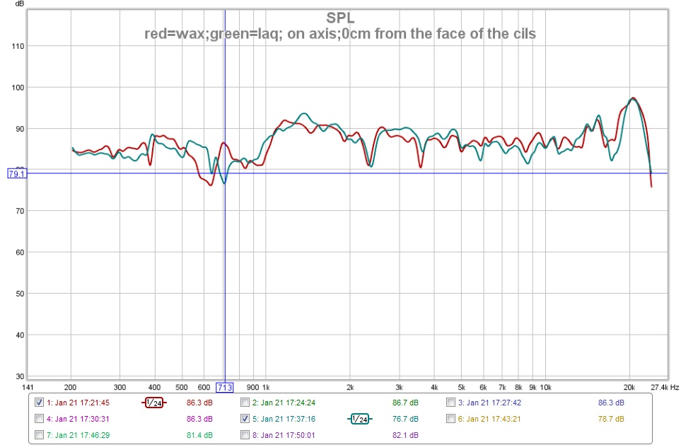

Well my friend, i actually made measurements for the full laq and wax 1 versions in the past weekend, wanted to post but didnt have time to open the pc again and write my thoughts down. This wax 2 vers isnt measured yet. I hope that tomorrow after work or sunday i will post the graphs.

Here they are my friend. To be easy for everyone to follow and watch the graphs i posted the graphs just for the laq+a comparison (law vs wax)+THD for LAQ(i pointed out the highest distorsion, the rest are bellow 1%). If you are interested i can post for the wax also.
I didnt measure yet the 50%laq-50%wax ("wax2" from the post here). I will measure it this week.

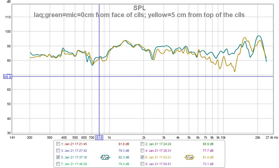

red=wax;green=laq; on axis;0cm from the face of the cils.jpg116.5 KB · Views: 474

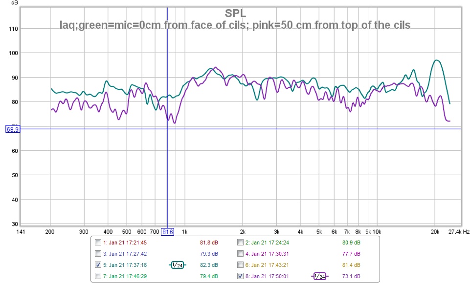

laq;green=mic=0cm from face of cils; yellow=5 cm from top of the cils.jpg117.3 KB · Views: 434

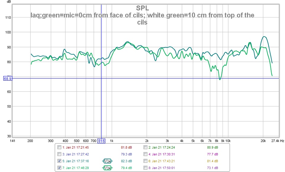

laq;green=mic=0cm from face of cils; white green=10 cm from top of the cils.jpg119.1 KB · Views: 202
laq;green=mic=0cm from face of cils; pink=50 cm from top of the cils.jpg122.1 KB · Views: 196

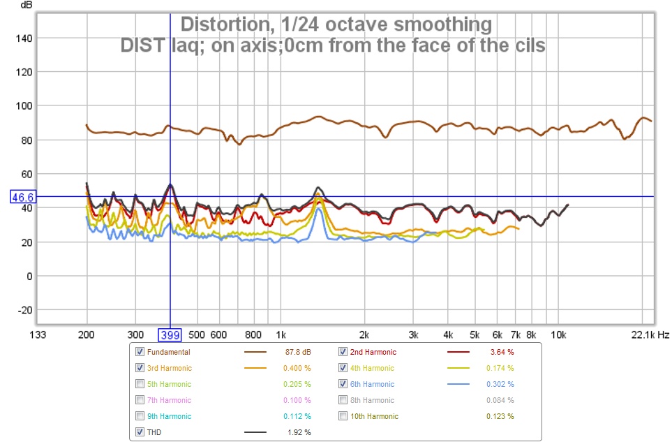

This is what i sayed in my earlyier posts: when increasing the distance from speaker to mic, the mic is begining to pick up noises and reflexions. To me the only relevant measurement is the 0cm from the face of the cils, till someone from Piatra Neamt/Romania wants to help me with an anechoic chamber to proper measure this speaker.
Distortion you can measure up close ,frequency response would be at least 50 cm since some phasing would not show up otherwise . A combination would be best but anyhow looking good !!! I just bought some new foam for a big one 🙂 60 cm instead of the curently used 20cm . I hope the low end will improve below 300 🙂

For the THD graph i played lower dB so that it would match with the other distances. At 50cm dist i played it loud and could generate a new dist graph if you want to see it?Did you played loud with the distortion measurement ?
It doesnt alter this actual graph with allot of dist. I seen it yesterday.
