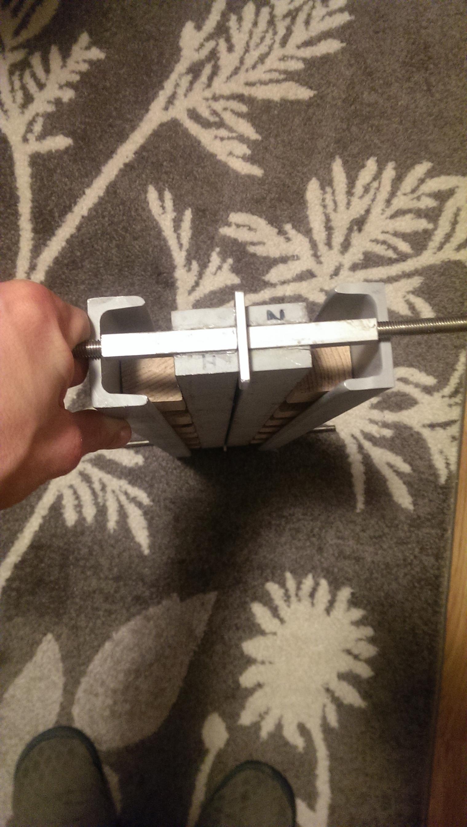

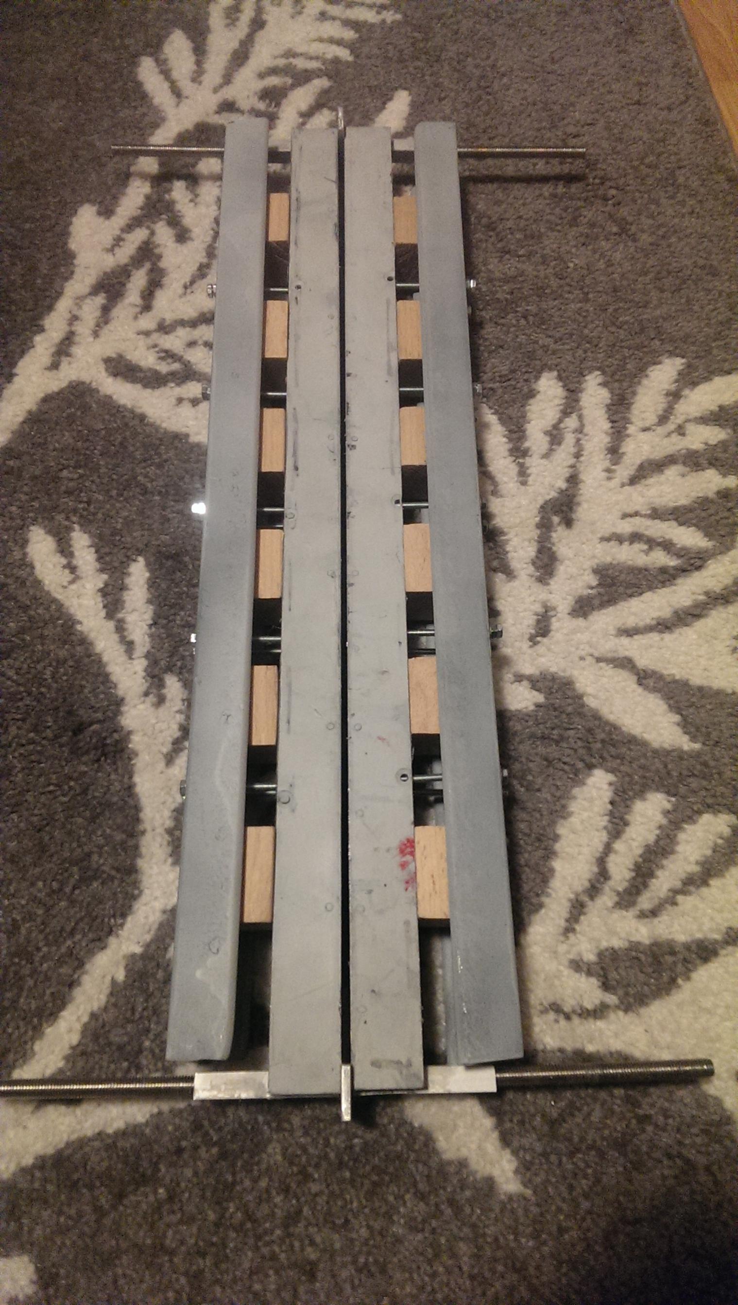

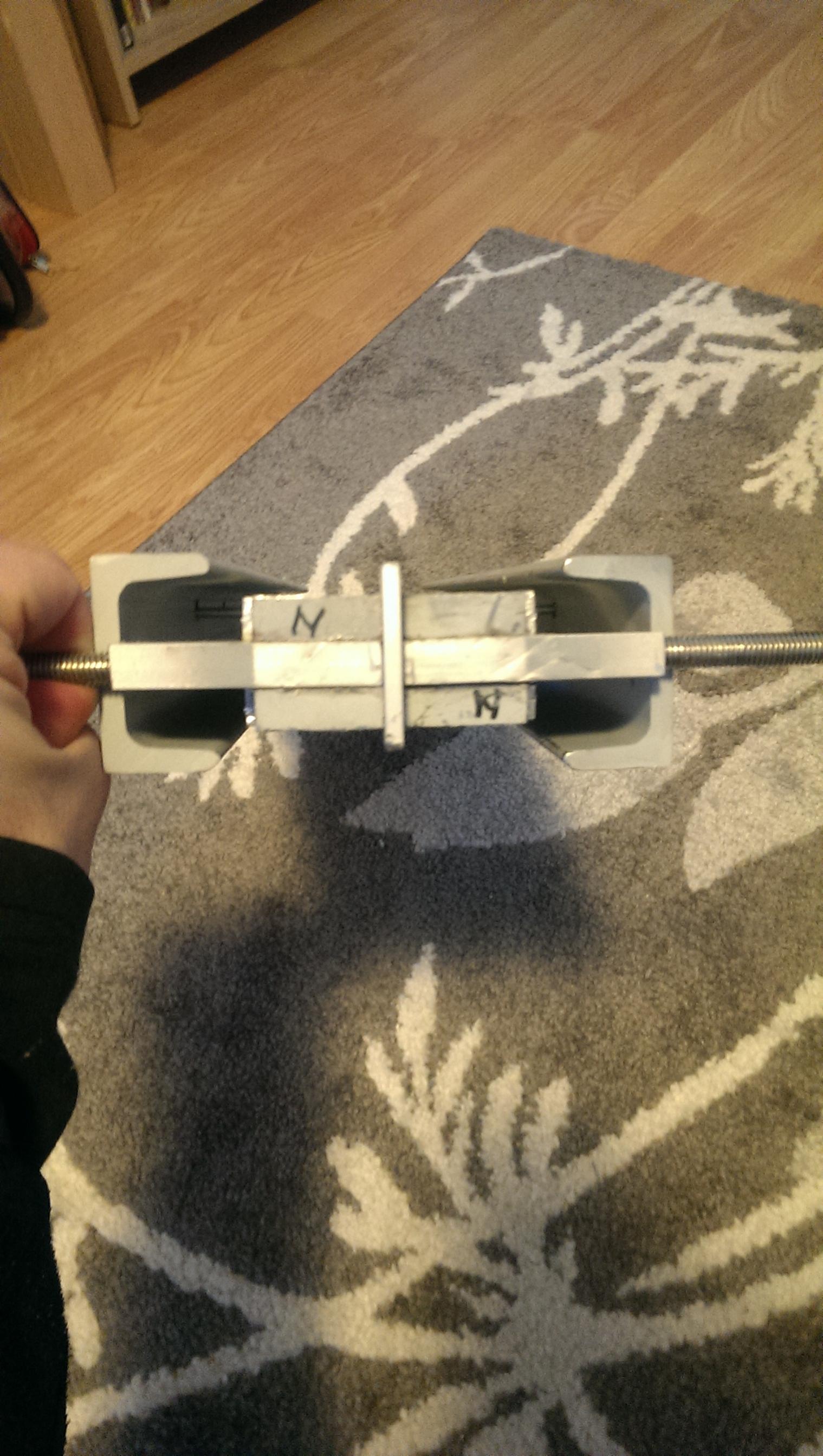

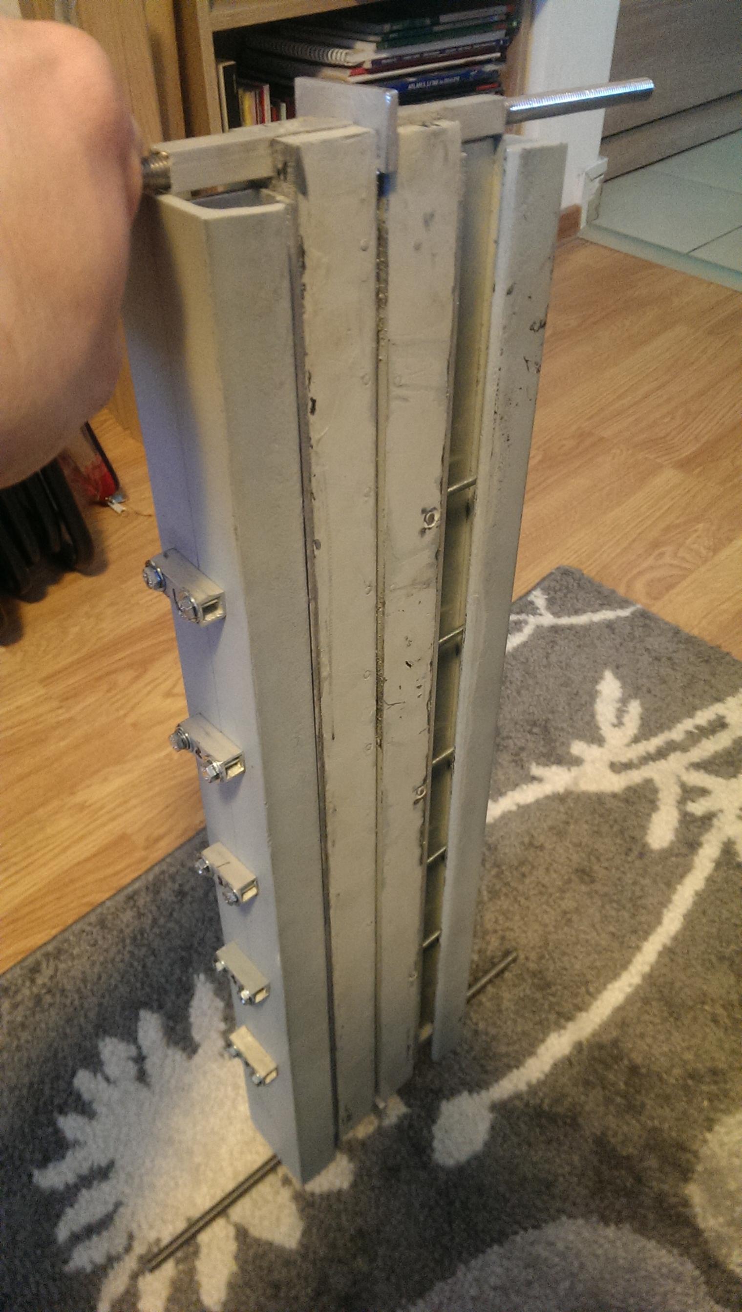

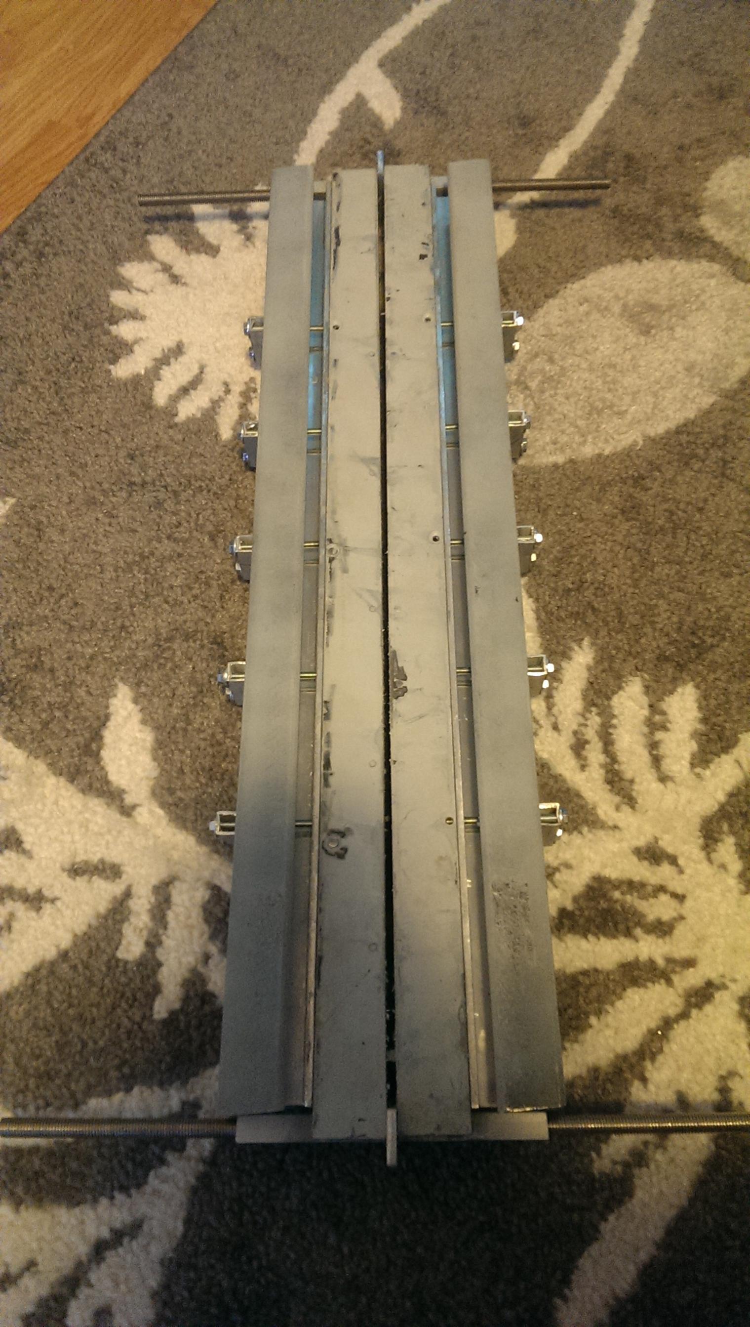

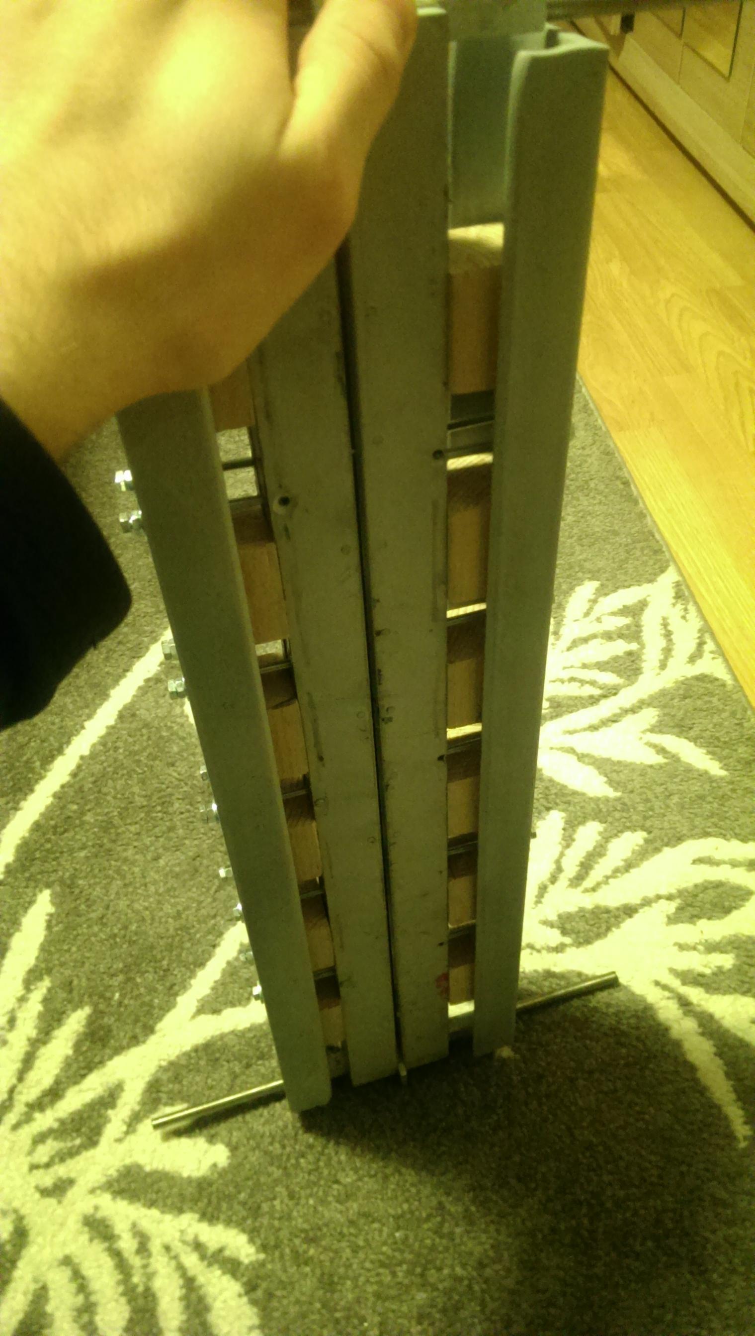

Is it the photo or me , picture one does look like the u shape is bending oitwards ?
Might be the picture , anyways that's a huge motor
Hello my friend. The bending is just in the pics. The reinforcements are still straight.

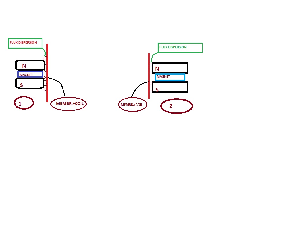

I have a very important note to make:
I made the painting bellow with just half of the magnet motor structure to show what i want to point out.
Now, remember that i sayed in my earlier posts (case 1 from the pic bellow) that the overhung coil is the best?
It seems that this was the case for my earlier motor structure.... Now with the actual rectified plates (straight edges plates) that i use now (case 2), with the jlh 69 amplifier (10w in 8 ohm and 15w into 4 ohms), both 4ohms overhung coil (@3.4cm wich was the best till now) and 8 ohms (@3cm-the classic version wich sounded very good in the past) has the same dB (subjectivelly speaking).
In the past the 4 ohms overhung coil had more dB's than the 8 ohms on the JLH if you know what i mean.
Now i suspect that is all about the flux dispersion in the gap as i pointed out in the painting bellow, case 1 and 2.
So, folks, all of you who wants to build these speakers, the overhung coils are best just for the case 1, with rounded edges for the plates. For case 2 , straight SQUARE edges plates, from bellow (wich i have now), i will research this week wich coil is best: underhung or 1:1. I kept the older coils and membranes (i still have about 15 pcs left from more than 20 different implementations).
If overhung coils are used on straight edges, you will definetly loose dB's
Cheers

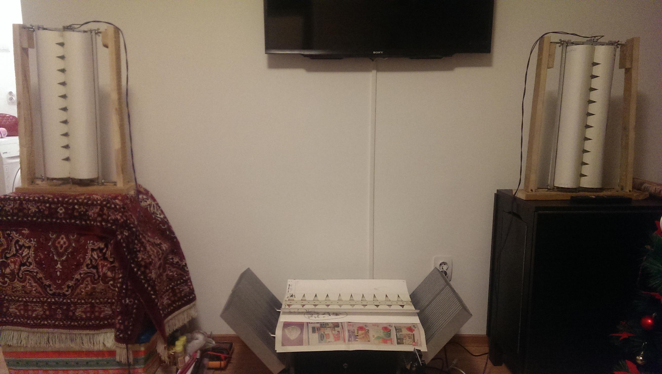

Happy new year to all of us!! 😀
I did almost nothing to my rubans... An aunt died and then hollidays.. 😡🙁
Anyway i just assembled them today with the oak wood. I will post soon why. 😉

In the meantime i found out that the front of the cils doesnt have to be completely sealed from the back because you loose some of the presence of the singer and abit of the roundness in the male and female voices. Better damp the cils than seal the back to front.
Another important aspect wich i consider to be in the top is about the coil (look again at the pic bellow):
* for case 1 the best sound signature, presence, gain, clarity and overall details i found the overhung coil with large traces to be a real winner; going underhung makes the voices thinner like a tweeter and makes the inpression of rolling at aprox 1khz (strange!!) and a 1:1 coil makes a softer sound, i'll describe it like a good tube amp if you know what i mean and favorising abit the voices; this was one of the hardest decisions to make from this whole project because i had to choose between two speakers that where so close in some aspects and so far in other;
* for case 2 ( just listened today and made a couple of comparisons) to gain the same strong points as in the case 1, a 1:1 coil is recomended wich means a 10 mm thick plate => 10 mm width coil shoulder; going overhung wil definatelly loose dB wich is not an option, and going underhung will gain dB but the sound becames very thin, a definite sign that its favourising the upper spectrum.
I'm glad that i had the oportunity to test and listen to both magnetic motor structures, (i'm refering here to both round plate edges and straight edges), and want to report that if i had the oportunity to start all over again i will definetly choose case 1 with rounded edges because it leaves the oportunity for the diy'er to choose between two flavours.. The active area that i had in case 1 was about 8 mm from 10 mm with the edges rounded at about 45 degrees.
Now i have an active area of 10 mm from 10 mm with a straight flux dispersion as shown in case 2 from the pic bellow.
Cheers
Sergiu

Picture 1 should have higher flux but shorter gap. In the picture it looks the opposite 🙂
There is not much much going on on the rounded part it will focus to the closest parts the flat part of the metal in this case. This is how they focus a high field without saturating the metal in ribbons
Its annoing and hard to do the drawings in paint. 😀
You are right but it seems that the underhung structure from case 1 its not only concentrated on a smaller surface but it also disperses abit of flux on the rounded edges and thus covers the rest of the overhung coil wich is outside the gap, compared to the straight ones from case 2 where the flux is weaker because of the larger active surface and the straight flux dispersion caused by the straight edges.

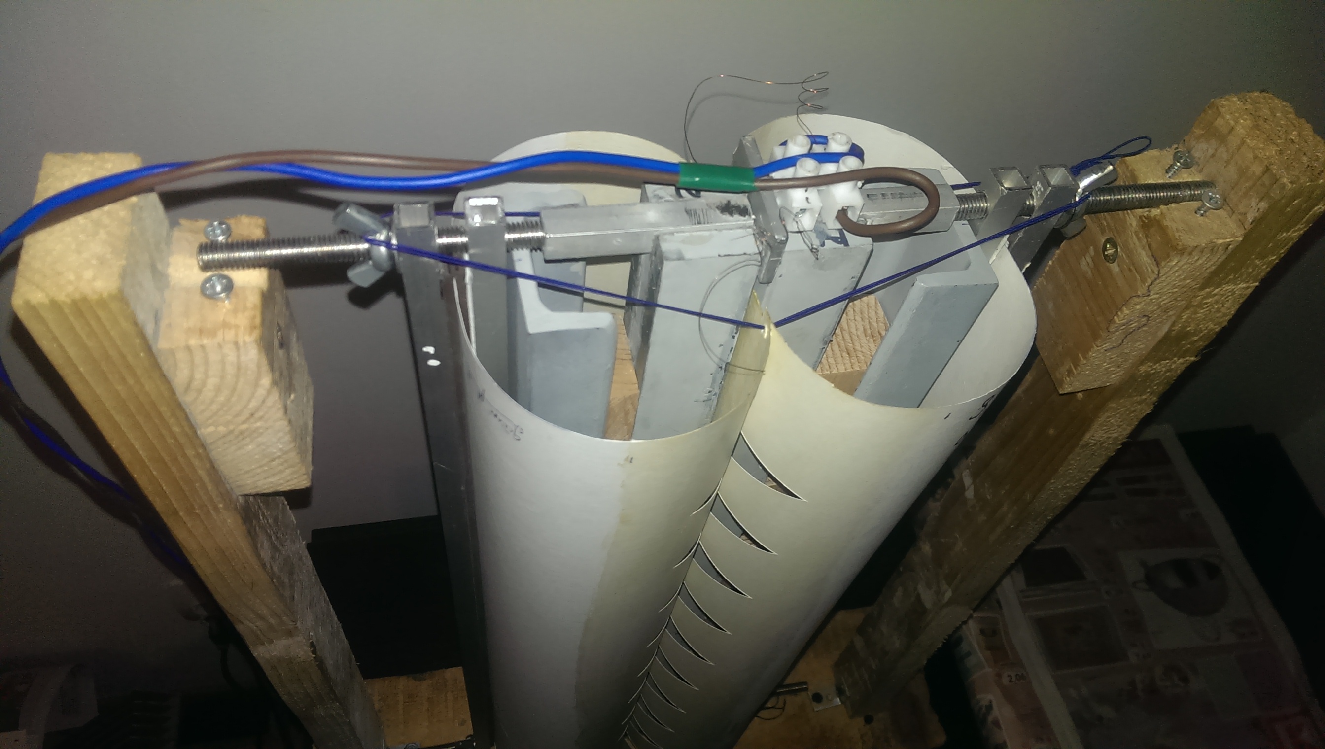

Today i buyed some gray pvc pipes (160mm int diam) for the sound reflection curved slots. Cant wait to see how they look at the end. The pvc pipes that i buyed are used as sewage pipes, have 4mm thickness or more and can be found in various diams at ceap prices. I buyed 1m long pipes at aprox 5$ each.

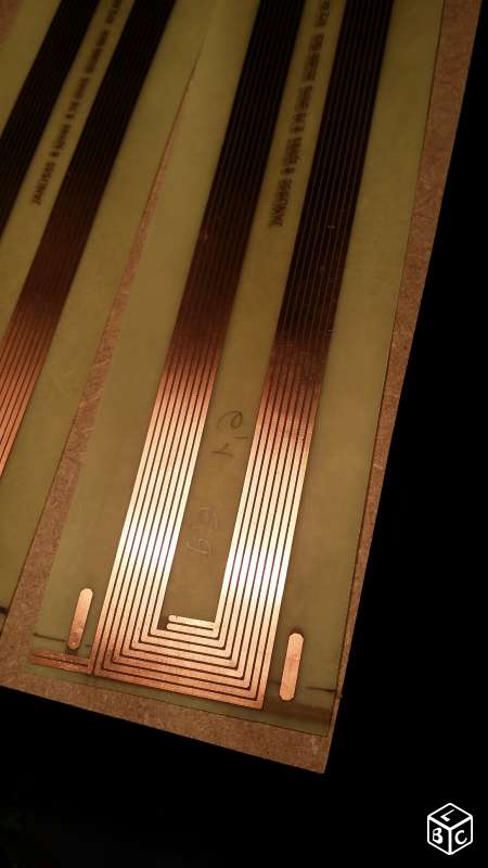

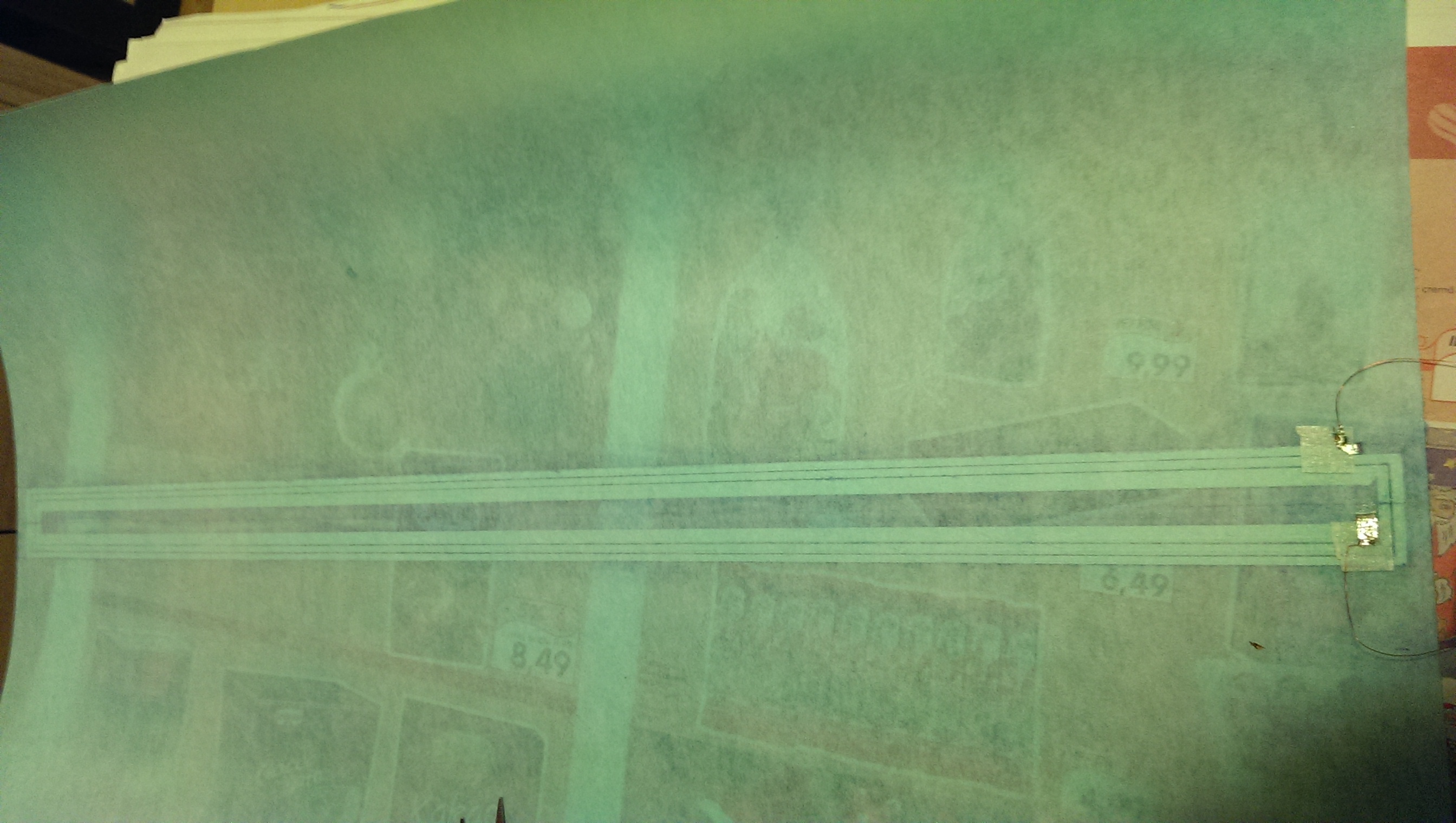

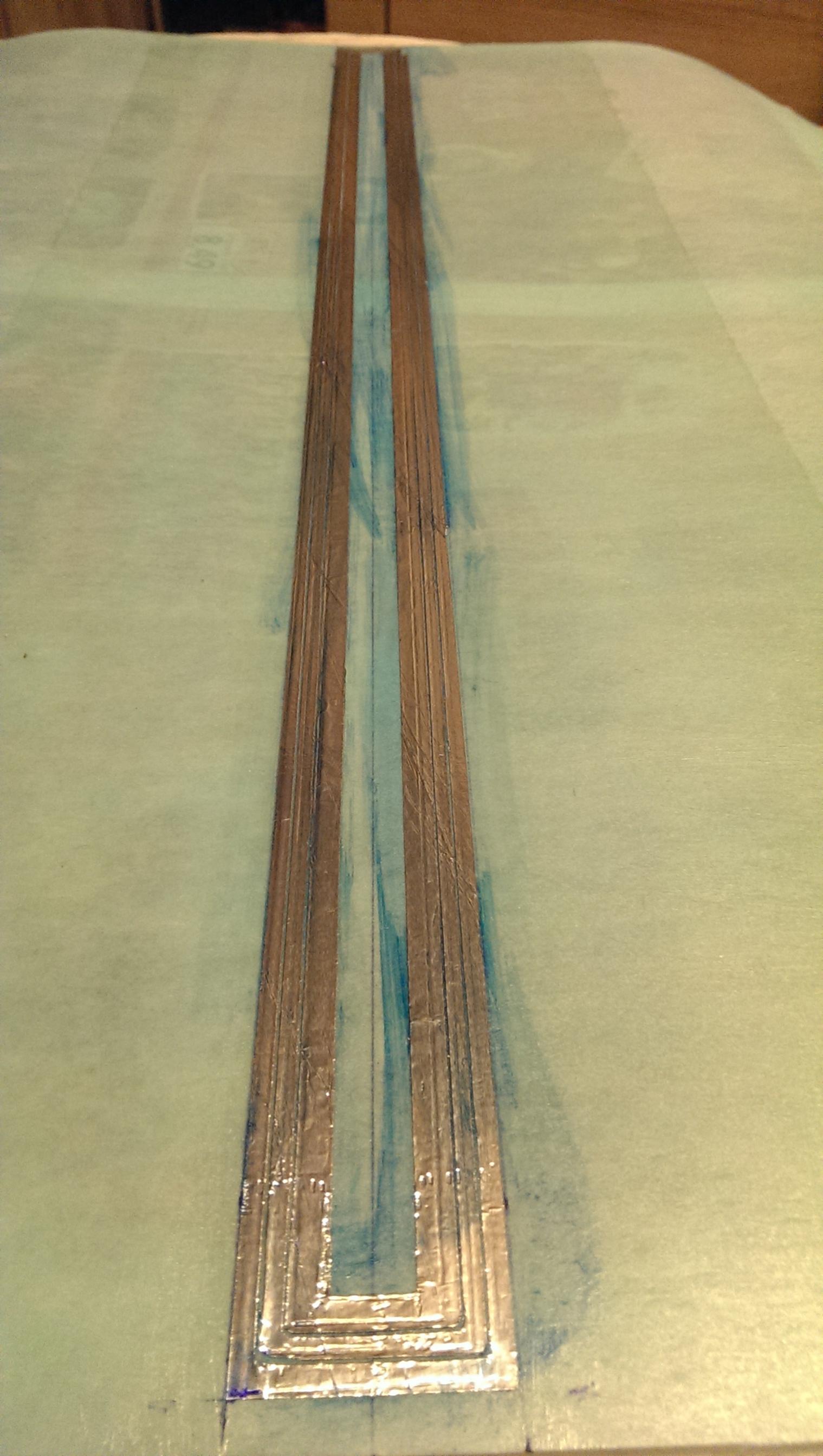

Helli my frien. I just made another coil today with fat traces, better contact and maybe a better overall one. The dc resistance is only 4 ohms from three turns. I will leave it dry for this night.
Tomorrow i want to try another type of coil. Like the one Deminiere uses. I found a pic from a pcb maker in France. In one of the pics bellow you will find the actual copper flex coil used in the Janus 50. It doesnt seem like a hard thing to do, i just have to look through my Al foils for a thicker foil and cut the traces smaller.. I allready have a pair of cutted membranes somewhere on the shell. Cant wait.

nice, the ciols look like mine 🙂 but i really think you cant cut it that thin. get some proper polyester laminate clad. called duraflex get some photo resist spray etc , just teh normal crap you need for etching and some transparency. then print the coil in 2 parts. find a big UV light and develope the stuff. etch it and your done. it might be annoying to for small fast tests but the end result will be awesome. or go 2 separate coils. and i could print them for you. send me the copper clad ill print it for you and send it back and you can etch it as you wish.
ebay has the copper clad its 0.1mm thick even meter rolls
Nah, it takes too long to send it to you and received it back. I done some coils at the begining but with no more than 6 turns if i remember well... My wife sayed i'm crazy when i started cutting the traces that thin. I allready started cutting 4 traces with succes. I have four more to do but i leave it for next week cause my back hurts and i'm abit tired. It takes twice the time but hey its really fun. I hope i dont make a mistake next week and ruin it. 😉
