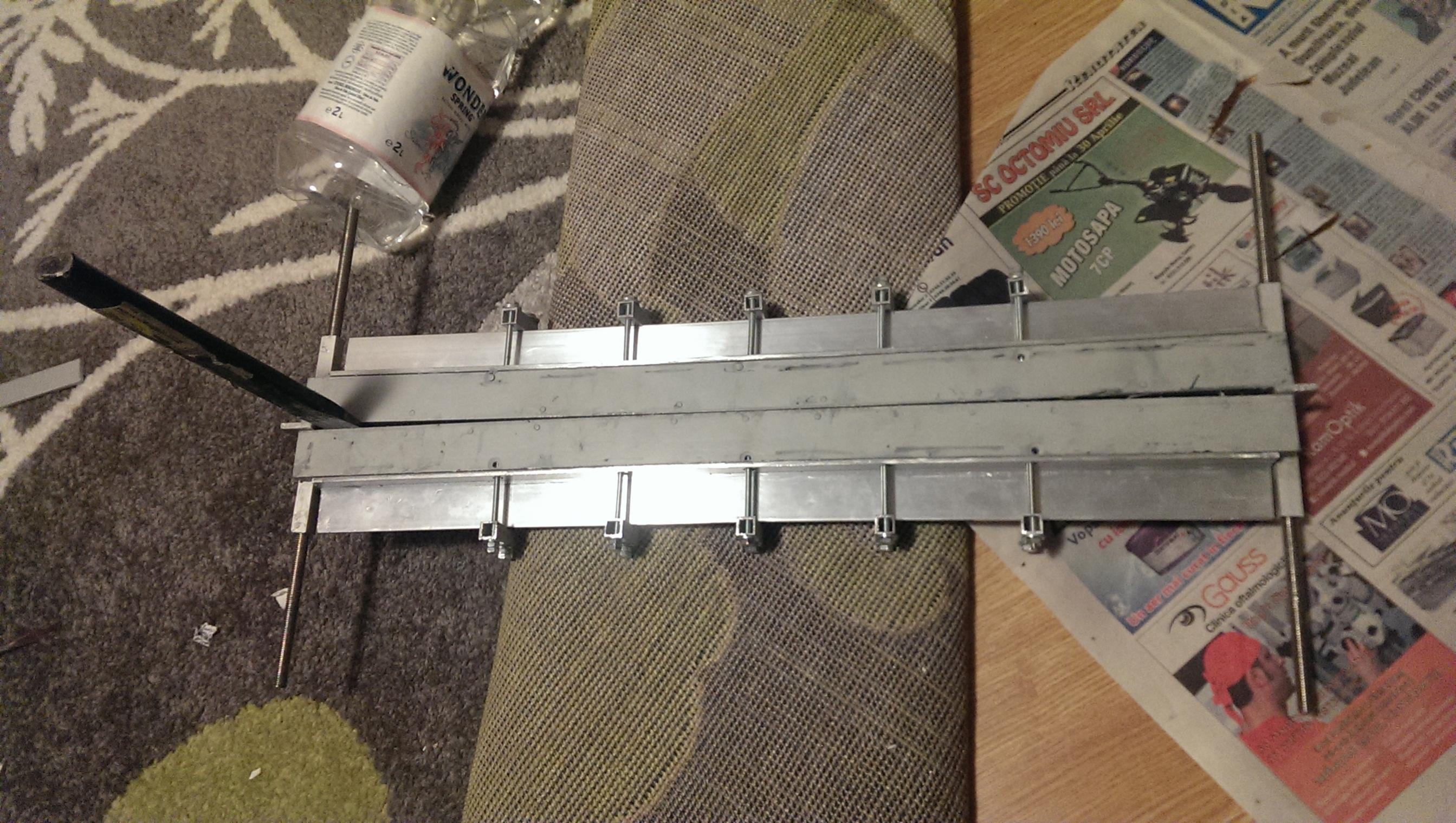

You are right my friend. But this is the solution that i found for the huge strenght. I was inspired by a train bridge when i was on a barbeque. 😎
This night i will assemble the motor structure and will report back tomorrow if it bends. Cant wait.

Bad news! The plates bended instanteneusly in a blink.. i tensioned the steel rods at max but it seems that the force is just huuge at 1.4T. The tensioned rods only ads planeity to the steel plates instanteniously after dissasembly the speaker motor.
I have to think at something else. Now the magnets are at 6mm from the steel edges (will increase this at 8mm) and have a 3mm gap (i still want to keep this gap, but will see)..

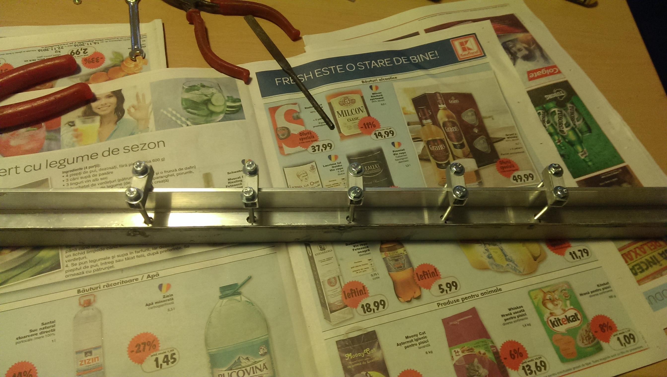

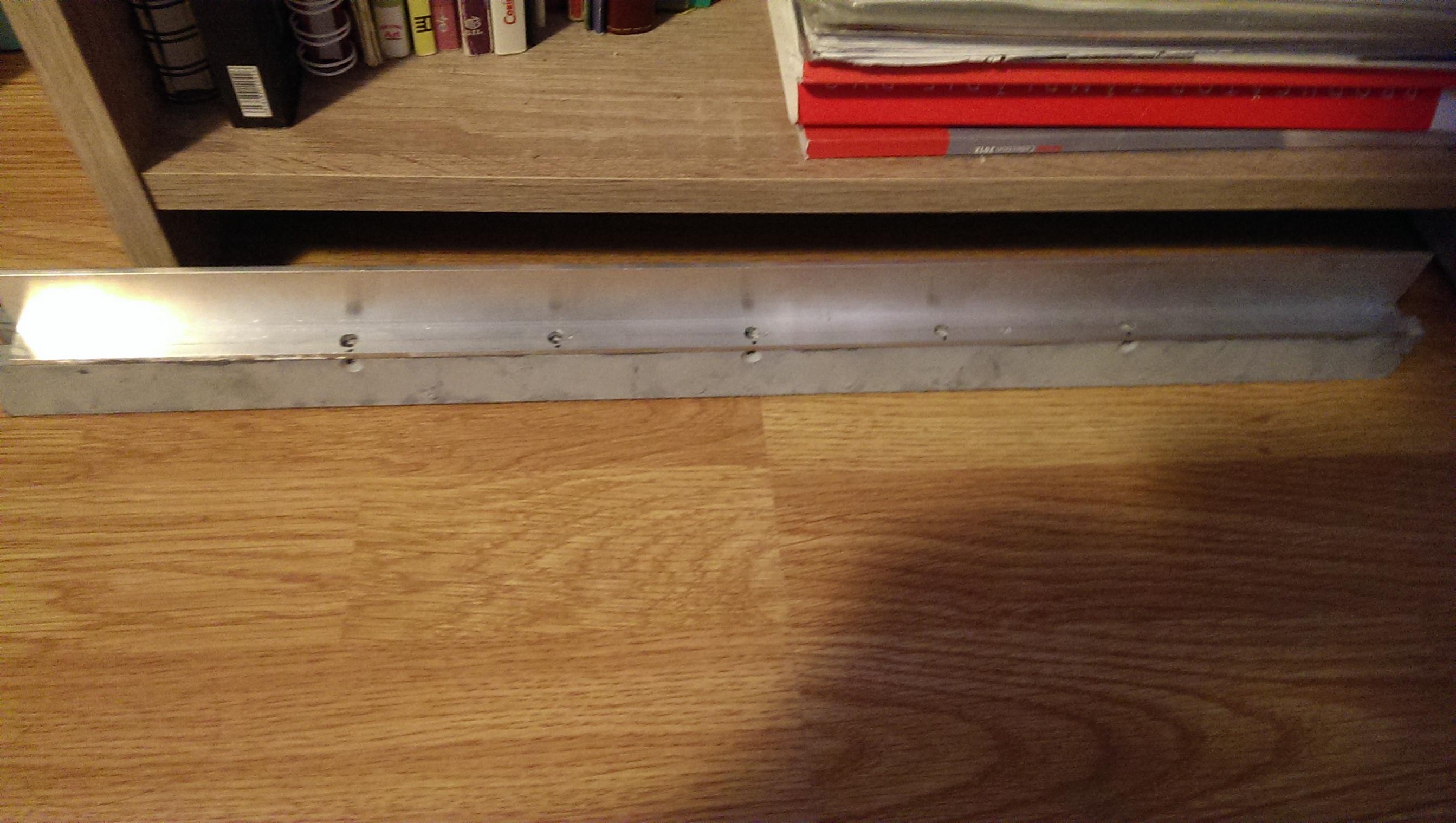

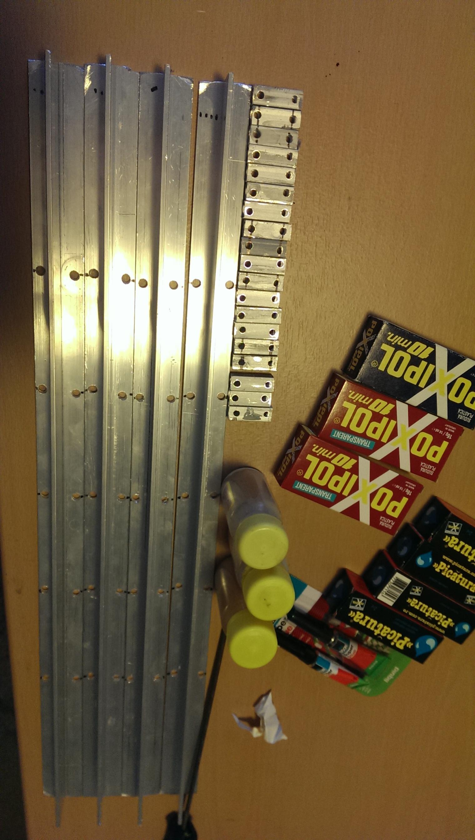

Hello guys,

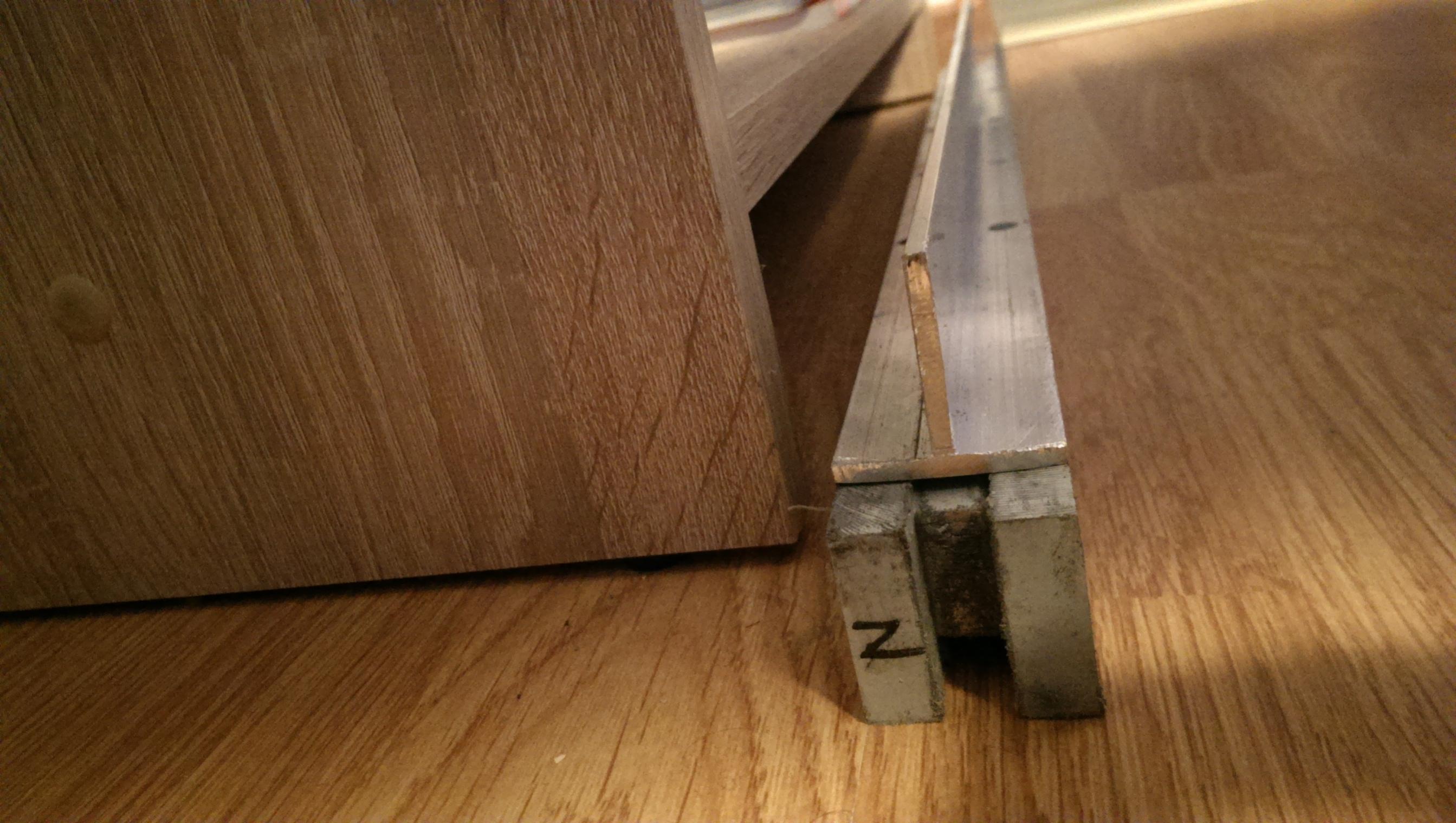

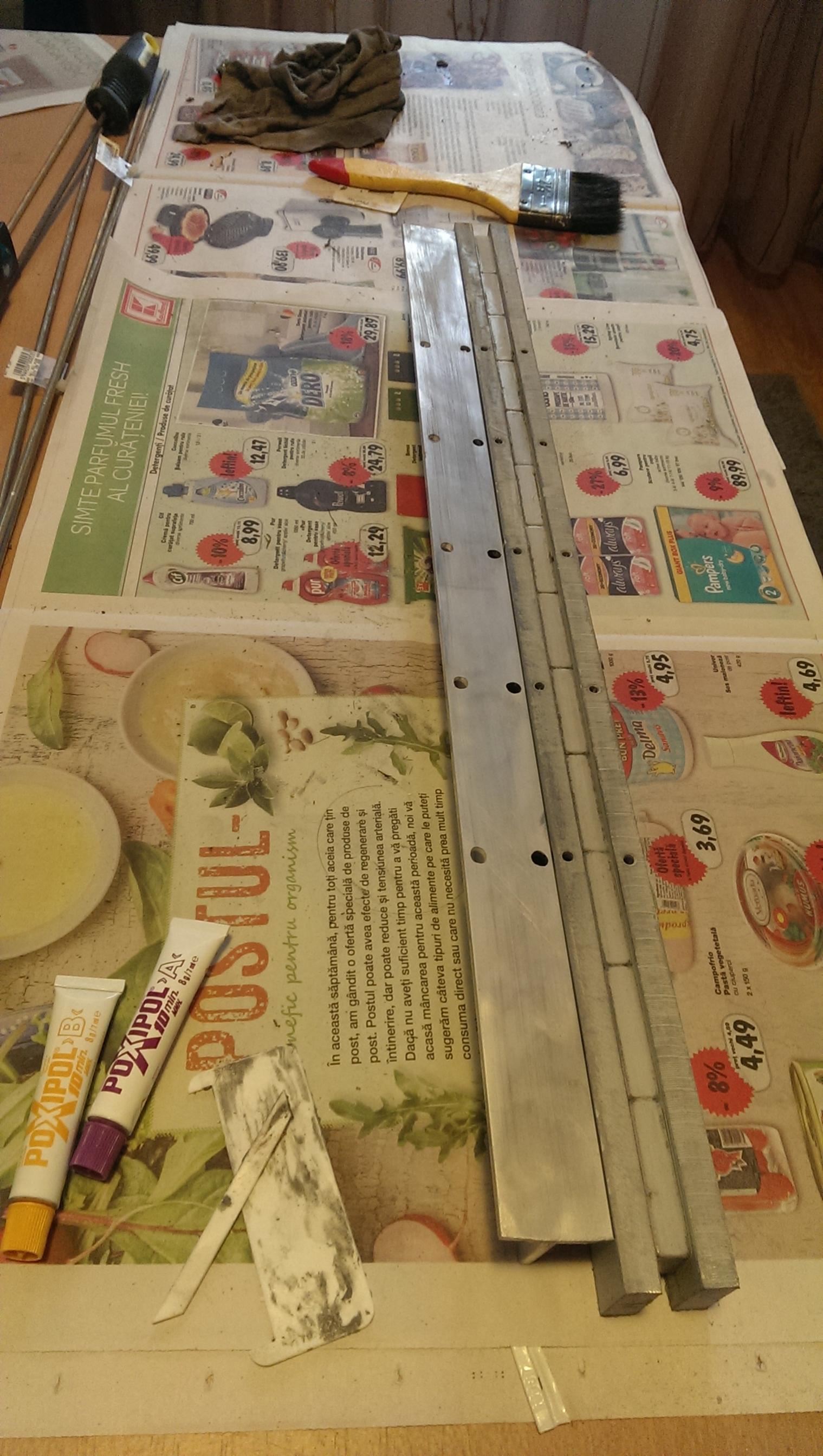

I just wasted my last resort... I glued the magnets at 8mm from the edges (10mm was in the originall ruban) and increased the gap at 4mm and it still bended.... I'm thinking at another solution but till then any advice from you guys will very welcommed...
I think the program femm has a bug or something.. i say this because in this current case, practically, i aproached the magnets with 3 mm and get just 0.15T force in plus, from almost 0.7 to 0.855 T but in reality the plates bends like butter. I think i need a gauss meter at the end to practically see what's happenning here.

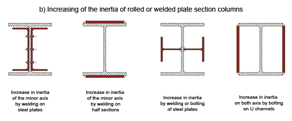

The Al "T" that i use for now has 3mm thickness and i dont know how to calculate its resistance at tensionning and what do i need in plus to compensate the brute force generated by the motor.
I am thinking to reinforce the "T" 's with four "I" 's at 3mm each like in the first pic from left to right. See the reinforcement example from bellow. So i will have a T with 4 I's, 2*3mm per side. But i dont know if it will work. I dont want to go blind.
Can someone help please.

sergiu, trying to get the needed rigidity by making a stiff enough beam is by far the hard way to do this. In fact by the time u get enough stiffness this way u will have a massive and huge magnet structure.
I have built similar speaker designs over the years. In all of them I used a "U" channel with the magnets glued to the inside walls of the U. This sidesteps the huge beam nessasary to resist magnet force.
If you want to use those aluminum "L " you have there U can simply epoxy or bolt them to a flat section of Al or even wood and make a U channel of sorts. This is much easyer using steel however as the magnets will hold to the steel as you try to glue them.
In many of my own designs I used a square tube with flat plates welded or glued to the sides of that, then the magnets glued into the U channel created by this. The pic below doesnt show it well but u can see the U channel at the left. This one made from 1 inch square tube with 1/8 inch steel plates welded on sides extending enough to fit magnets. This way all the riggidity is done by the short distance across the back ( 1 inch tube) , rather than the long distance. Very stiff and easily resists the magnet force

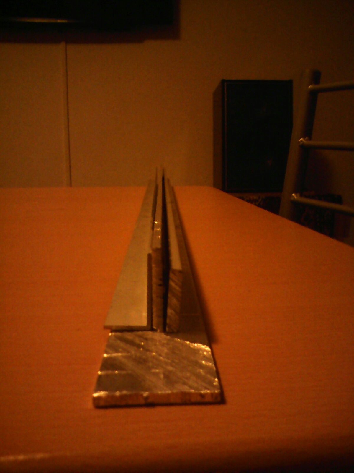

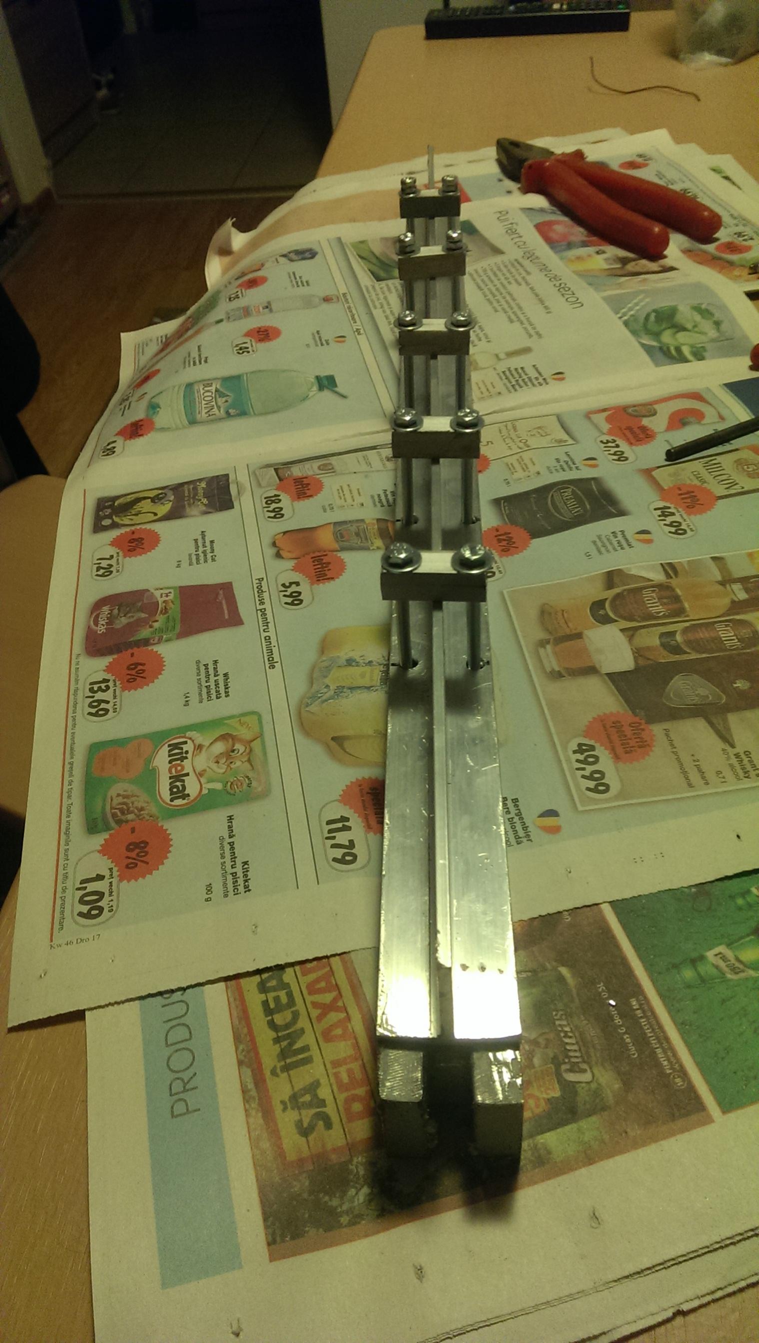

Hi Lowmass,
Thanks for the advice. That's why i'm afraid, the huge assembly obtained by reinforcements... But i have to try, i cant go back, because my plates are cuted this way and i cant go back, i have to make this work. The only way to go back is to wait another two weeks for new steel to come wich is not an option for me.

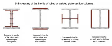

I see your pic so what do you say will be tougher for me from the pics bellow, reinforce with allot of L or I , both or square Al pipes filled with I's insyde?
Sergiu
Sergiu

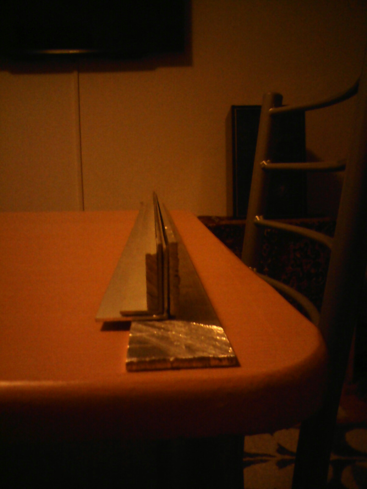

Well if your going to forge ahead I would take whatever u have and make I beams. That really is the biggest increase in stiffness.
From what I see in both picks I would take the added "L" parts and turn them around to make I beams out of your backbone. In fact I wouldnt be concerned with making the web between thicker but would try to get as much distance between the I beams stressed parts ( the top and bottom plates of I beam). Take the L sections and only overlap with your T section enough to get abunch of screws in there. Maybe overlap only about 1/4 inch. This way you get as tall an I beam as possable. Then use your remaining flat plates to add to the I beam section farthest from the magnets.
The idea is to make as tall an I beam as possable. Cant remember for sure but I think calcs say if you double the Ibeams height you get about 8 X increase in stiffness
Thank you very much. 8 times stronger is allot and temting, but there is a BUT wich is that this is the max i can go, no more than 30mm tallness. If i go taller the cilinders will be bigger, and adds increase mass + add too much dampening,... Tested 'the bigger, the better' cilinders theory and posted it in one of my oldest posts and the results werent impressive.
But what if i add two 4 mm I's and two 3mm I's per 'T' (one of each per side to occupy the total of 7mm wich i have now as gap between the perpendicular I from the T and each M5 rod) and bolt everything with glue and allot of steel screws bolted like toothsaw onto the perpendicullar I to prevent further bending? This way i will get 17mm thickness of I's instead of just 3mm like now. What do you think?
But what about a square 30*30*2mm pipe (this is what i found on the market) filled with I's?
