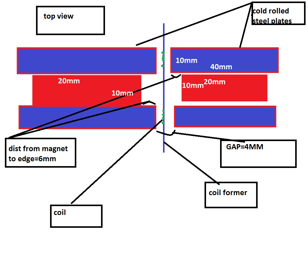

FEMM cannot simulate according to your layout as it would require 3D simulation, The drawing should be made as an inter section seen from the top (or bottom).
A glance at your drawing tells me that there are no magnetic circuit with gaps.

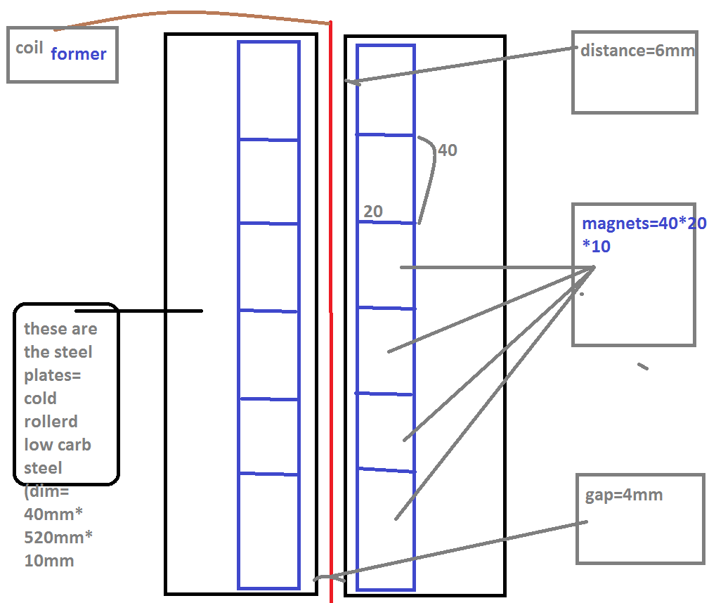

Sorry here it is. I have atached a top view and laterall view. I want to know if it will saturate with the magnets close at 6mm from the steel plates edges and 4mm gap as drawed in the pics bellow.
Now, as we speak, my magnets are at 1 cm dist fom the edge and 3 mm gap.
My magnets are N42, neodim, 40*20*10mm aranged as in the pic bellow.

Nope, the motor looks more like the one from bellow. With a 4mm gap for the coil and the magnets at 6mm from the edge.
Can you change the plates material from pure iron to cold rolled steel?

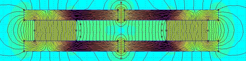

Sorry for the misunderstanding. I'll do a new simulation shortly.
What type of cold rolled steel are you using?
These are the ones that FEMM has in its library:
I have simulated with these before, the result doesn't change much from Pure Iron. Just how saturated the material can get really.
This is the same simulation as the last but with 1018 Steel instead:
The steel is aisi 1017. But you can simulate it with 1018. No prob for me.
But i am a bit confused, i have only 0.7 T between 15mm and 30mm gap?? Is this an average or what? I think is very low.. isnt it suposed to be higher?

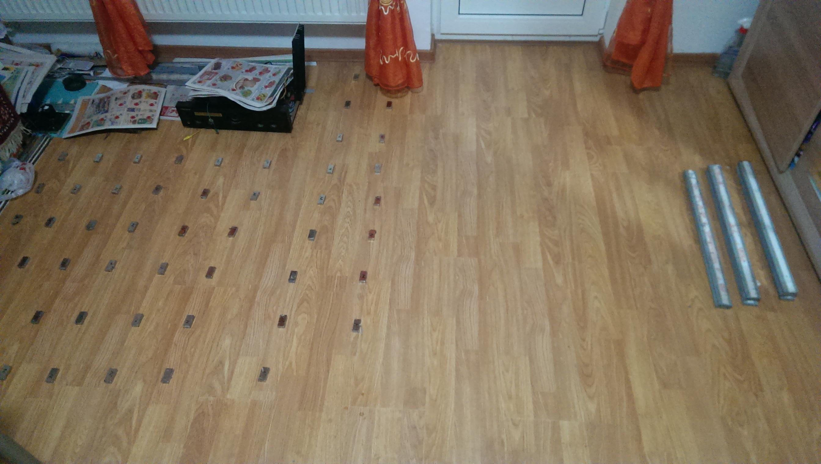

I just disassembled the rubans and preparing them for the milling machine.

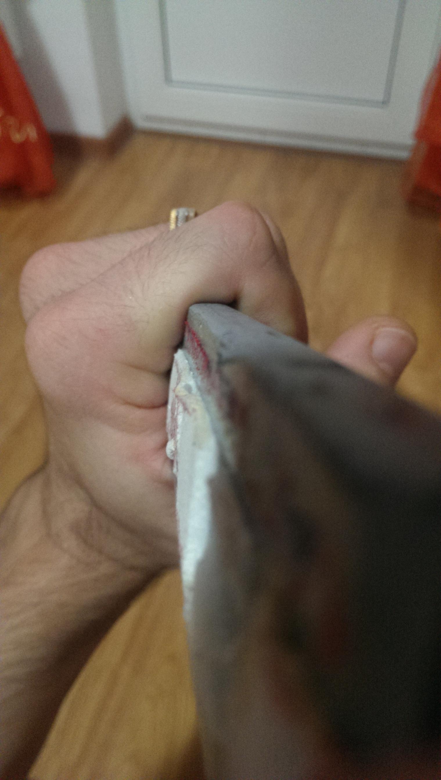

So, if i have the edges from the plates straight i have 0.7T , but if i have the edges rounded like in the pics bellow? Please have a look at the pic bellow because i couldnt draw them in paint..
So it seems that i will get a maximum 1.1~1.2T at max if i have the plates edges smoothed out?

I disassembled the rubans yesterday and preparing them for milling today.

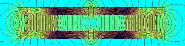

But with rounded edges you will get a smaller region that is linear.
What is your desired height of the gap, that is, do you aim for an under hung motor or an over hung motor?
The problem with your suggestion is mainly that the flux takes other routes apart from the wanted ones. In this case on the other (outer) side from the magnets:
If you make the gap's height more focused, the flux density will be heigher but the height of the gap will be less:
Here's a simpler motor:
With rounded gap, note that the height now is much smaller and not that linear:
The overhung metal mentioned somewhere in the begining of this thread is wasting flux, solhaga's design works around this all the metal is in contact and is thick enough in the places needed to not be saturated. And smaller then the overal thickness at the gap to focus the field :) nice design. 1,4 tesla
I don't know about the needed Xlinear for a Rubanoid. Perhaps a short gap is enough.
Perhaps it can be even shorter with a pointier pole piece or any other shape.
But then you're chasing tenths of T.
A problem with high flux densities in the gap is that the construction must be more rigid.
520 mm long pole pieces will for sure bend towards each other in the middle.

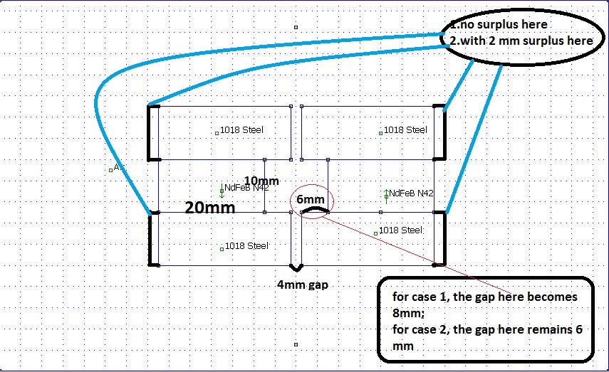

Thank you very much Solhaga. Your simulations explains allot of things for me. I forgot to tell you that this speaker sounded best in overhung mode (1.2cm coil shoulder vs 1 cm plate) and 1:1 coil width shoulder to plates width ratio (1cm coil shoulder vs 1cm plate). What has bigger field if flatter plate edges are used? What do you recomend?
I will post a drawing bellow from my phone with the dims for the modifications wich needs to be done at my actual plates. The zones that are shaded will be preciselly removed by my colleagues at the CNC at work. The modifs will begin this thursday 22.09.2016 and ends at the same day, so i want to ask you again for another simulation.
After the milling is done i will remain with the situation bellow (that i drew directly onto a simulation of yours). The question is : will those 2mm remained on the back of the magnets (outside the active area as i drew below) influence the flux density drastically and need to be removed or leave them as they are?
Knowing that aisi 1017 saturates at aprox 2.05T is it ok to increase the dist between the magnets and the plates edges (from the gap side) from 6 mm to 8 mm or leave it at 6 mm?
I ask you this because till thursday i can still modify my drawing.
Thanks in advance.

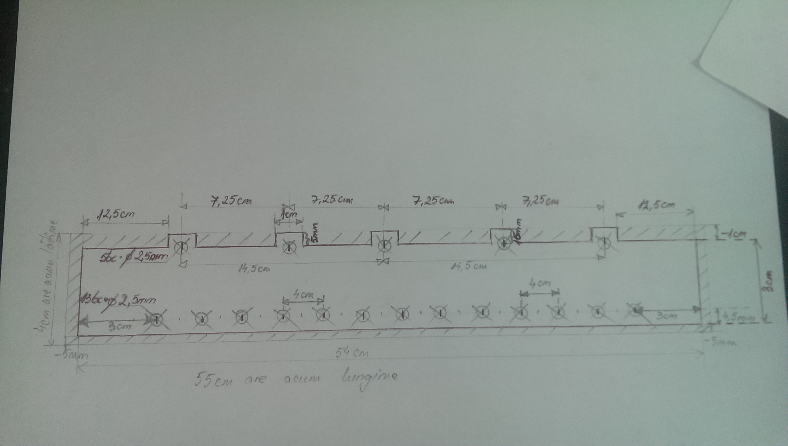

Here it is. This is the scetch that i drew for the guys. This will be for a single plate. The 13 pcs drilled holes will be filled by custom aisi 1017 rods (group of durity is Group 10.9 wich is the strongest) alternatelly so that they will not cause magnetic short circuit and they will keep the magnests still, instead of the 1cm square Al 52cm long pipes.
The 5 drilled holes will be filled by tensioning rods wich will have a strong suport as a reference to hold on and they will keep the steel plates tensioned so that they will not bend. I have readed on the net that aisi 1017 steel has more pure iron in it and less manganese and is less flexible compared to aisi 1018. So i have to keep this thing in mind and be very carefull.
Thanks in advance.
Cheers
Sergiu
Sorry, I don't understand where the magnets mounted.
Could you make a simple "3D" sketch?
