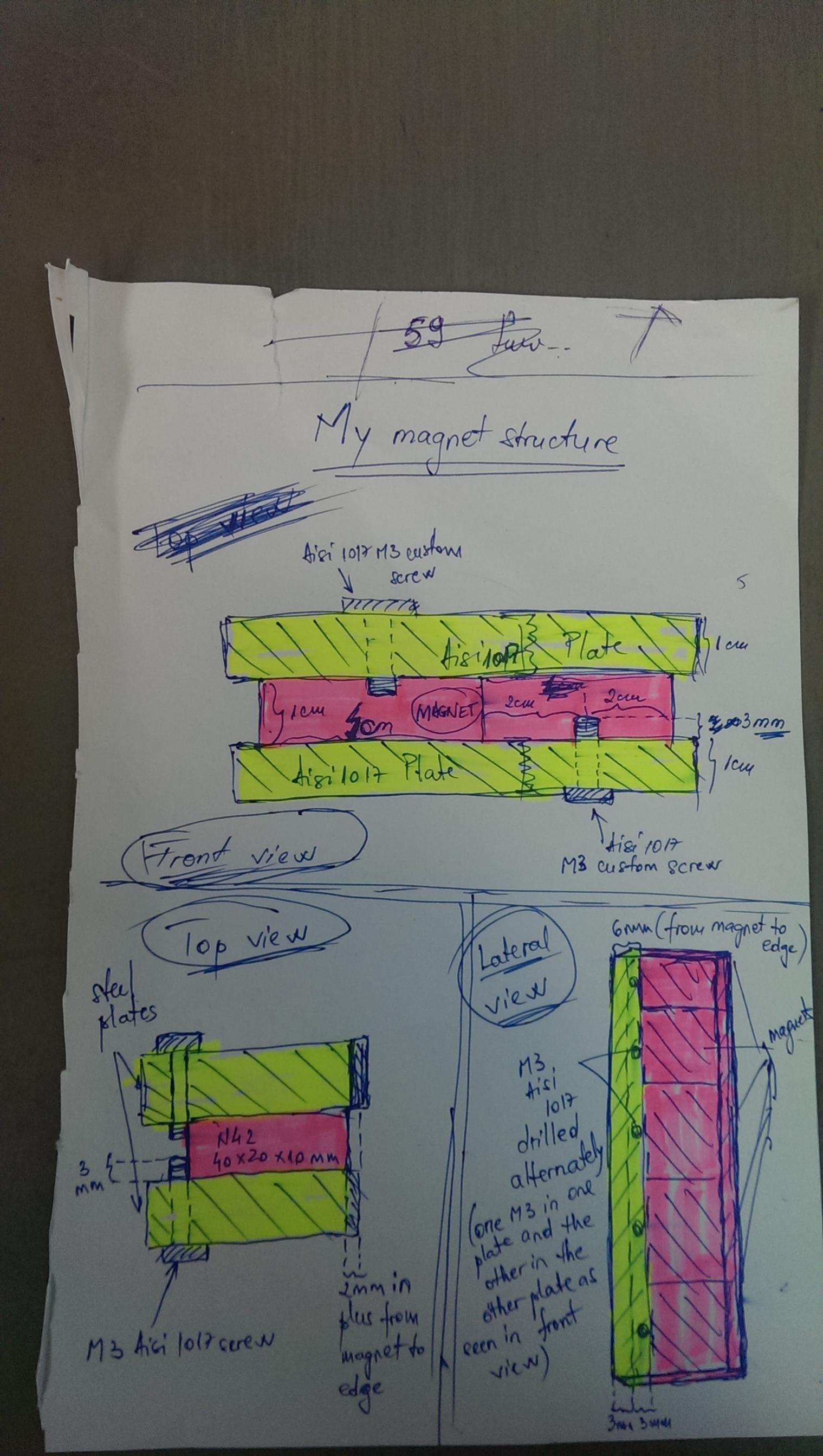

Hello Solhaga, this is what i had in mind to keep the magnets in place and to prevent the steel from bending.

I have another question, what gap or dims do you have in the sims from above (quoted from post 914) that you reached almost 1.3~1.4T and what gap or dims do you use now here in case 1 and 2 (post 922) that you dont have at least 1T? Strange thing..
Sergiu
Case 1 and 2 are according to your dimensions given in post #917.
The gap is 3 mm in post #914.
Although not a complete and all correct analogy, you can think of the magnetic flux density as water coming from a barrel of water (the magnet) via a water hose (the pole piece).
It's all about to avoid all the leaks and bends that can dampen the flux.
And then put a thumb over the water hose's end...

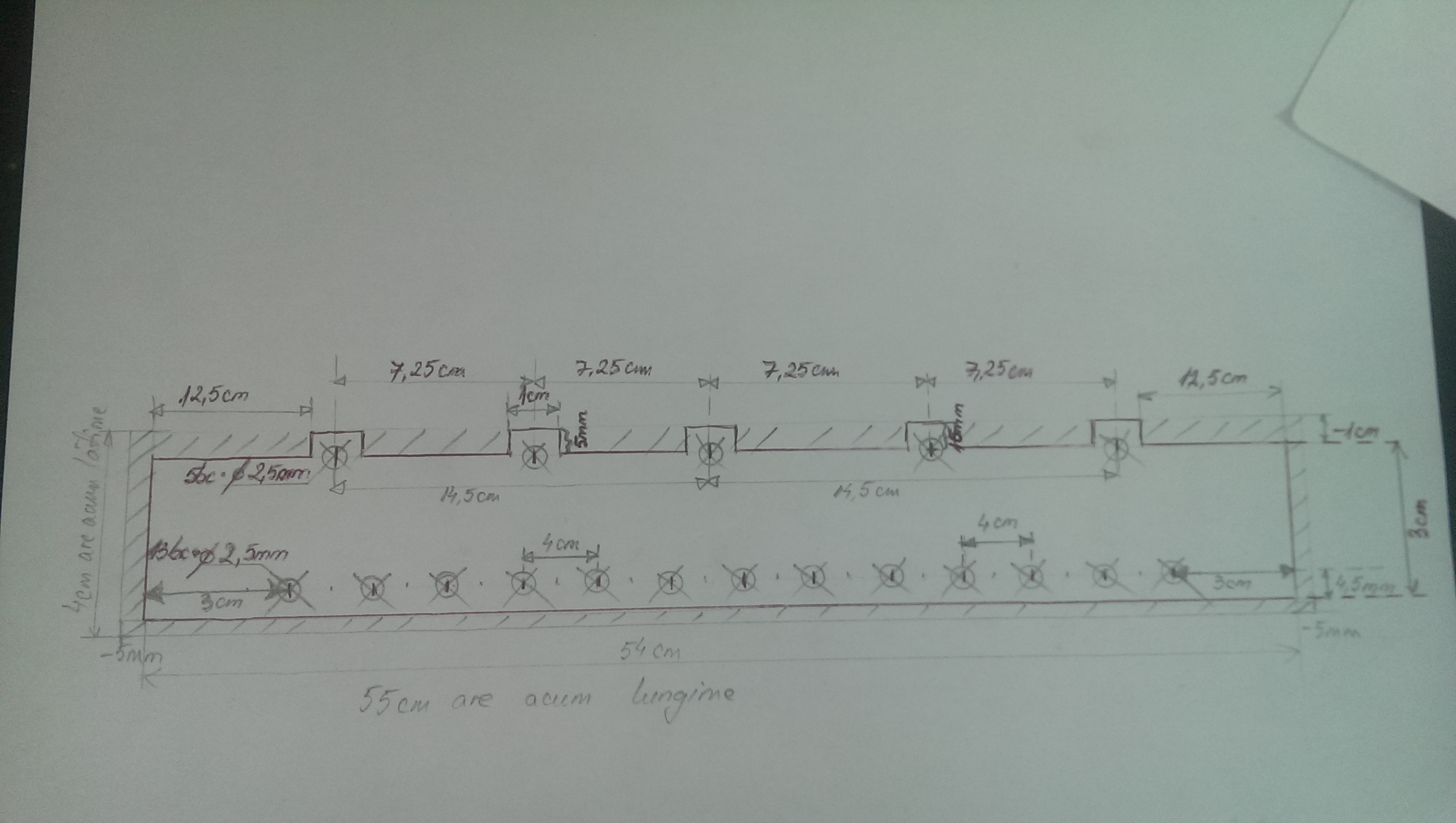

It seems that the guy (old man) from cnc misunderstood the drawing and drilled allot of holes altought i explained 3 times.... 🙂))
Anyway i redo the drawing and things changed. I'll show you when i come home from work.

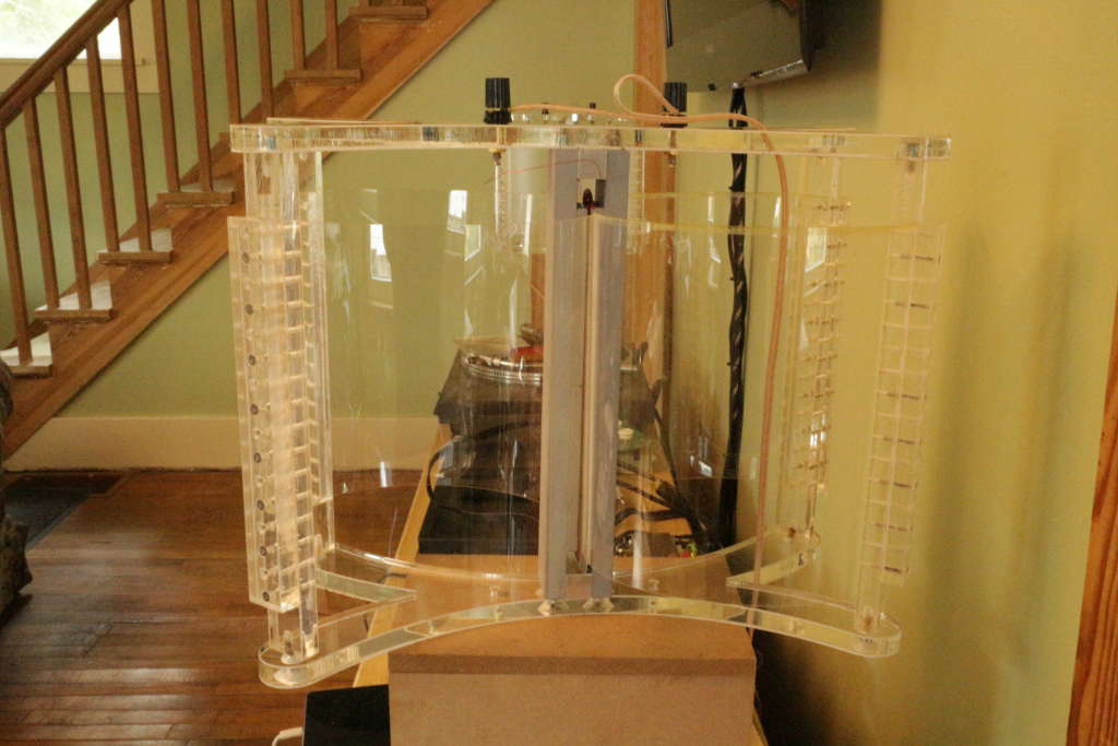

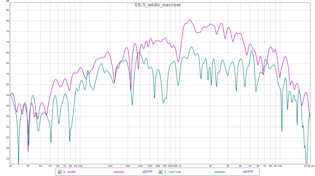

For the membrane, I've given up on Kapton tape and found polycarbonate film that I can get for very little money, especially as compared to Kapton. Attached is a picture of the latest version with a couple frequency response curves. I need help figuring out the right way to measure frequency response. I don't believe those curves.
The motor is completely different from what I see posted here. I used 0.25" x 0.5" x 4" N45 magnets epoxied to the wide side of a 0.5" x 1.5" low carbon steel (1018). The gap is 0.125". I've used 30AWG wire for the coil. The Membranes are 0.10" x 8" x 19.5" polycarbonate (you can only see reflections in the membrane since it's as transparent as glass).
I'm driving them with an 8LS amp from S5 electronics (http://s5electronics.com/l8stereo.html). I've also hooked them up to my kid's modern multi-channel SS receiver. They sound much differently depending on the amp they're hooked up to - the SS amp produces much better bass response.
The frequency response curve is with the 8LS amp. I can't collect a curve with my kid's amp as I'd have to move far too much equipment. I have to believe that the type of amp used for generating the curve makes a difference based on the fact that the speakers sound so different when powered by my kid's amp.
How do I account for coloration from the amp in the frequency response curve? I realize we can't really do a reference standard test, but without good measurements, I can't properly assess the affect of changes to the design.

Hi Snot,
Your ruban looks very profi. Nice work. It seems that you have to measure your amp, or include the amp in the calibration loop used when calibrating.
Cheers
Sergiu

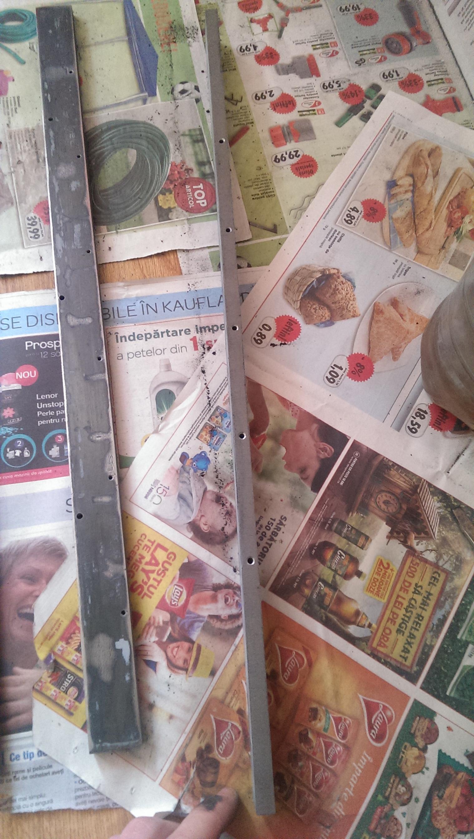

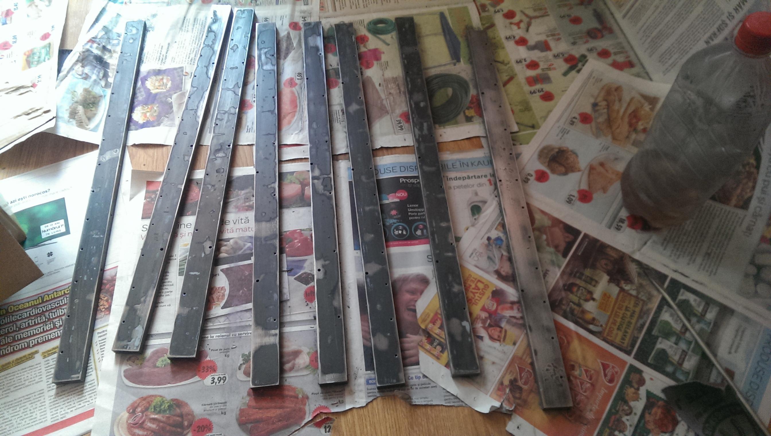

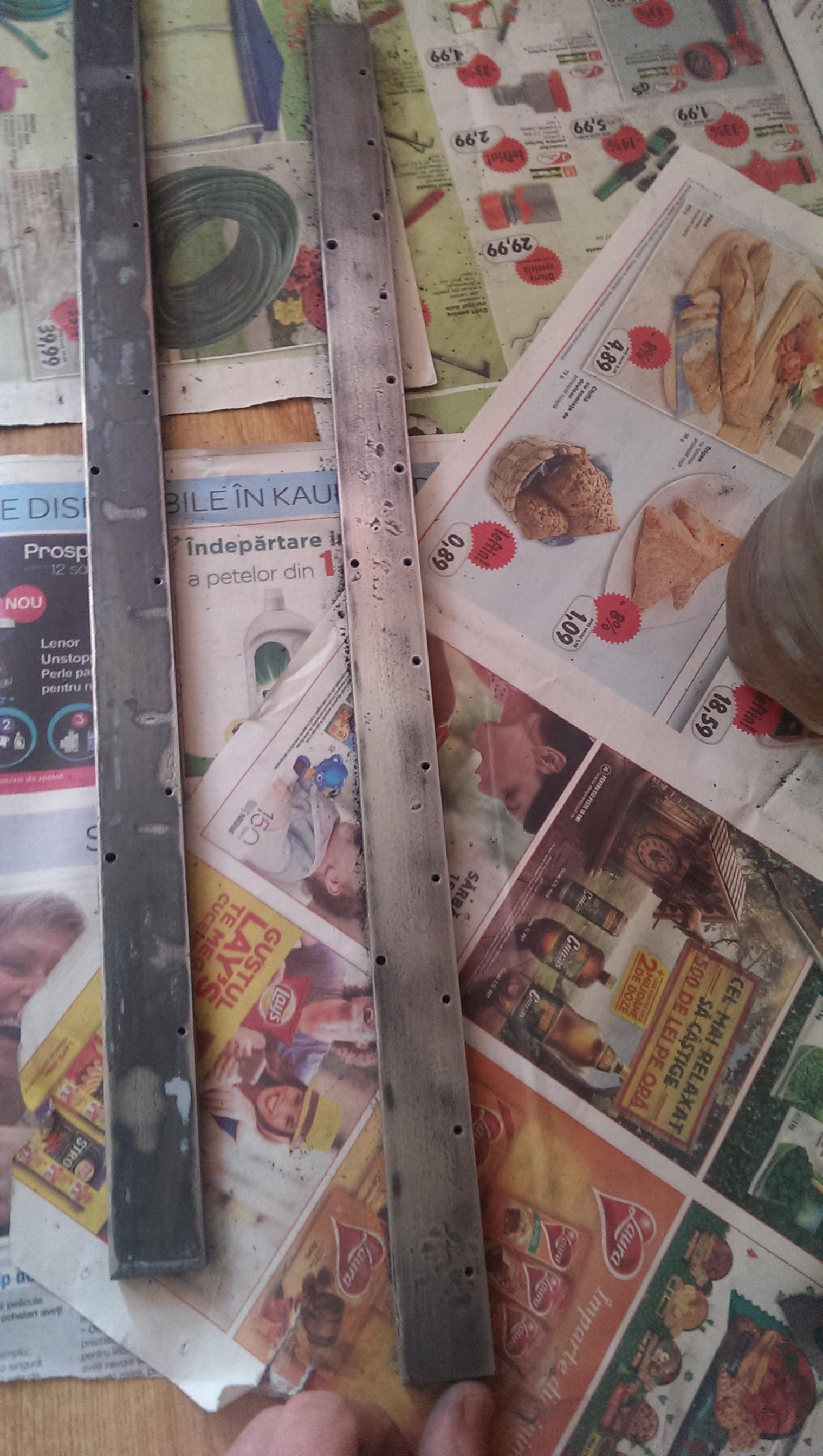

Hello Solhaga,
Look what the idiots did... 🙂) An almost different thing!!
I laught but i think i should cry also. I drew some earings in the initial drawing, so practically, they should have cuted out the surplus to leave those earings there, but instead, because it seemd allot of hard work, the boys eliminated those ears so i had to modify the project as seen in the pics bellow.

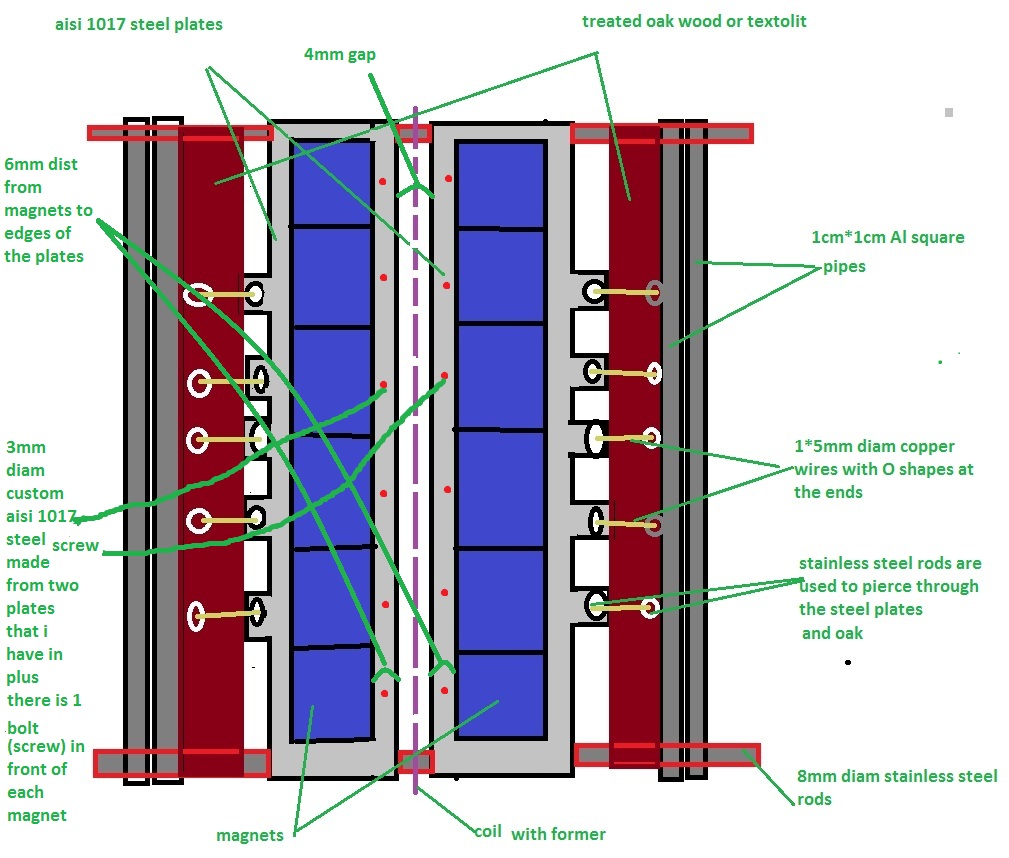

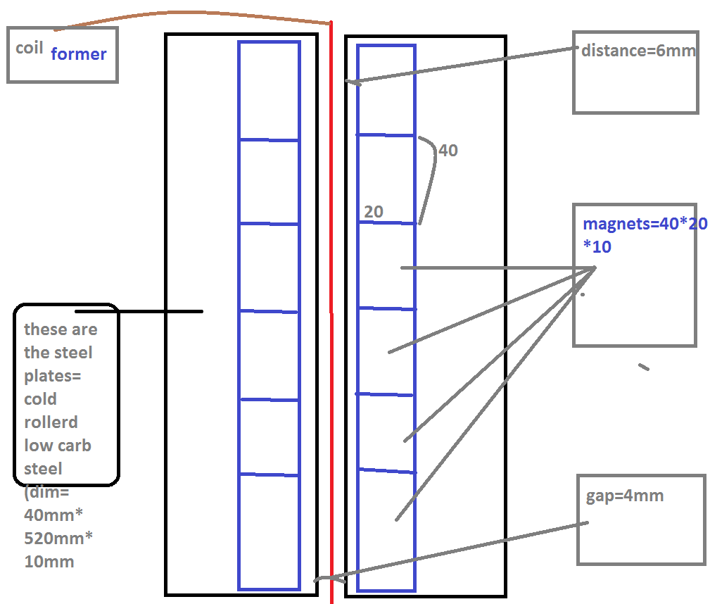

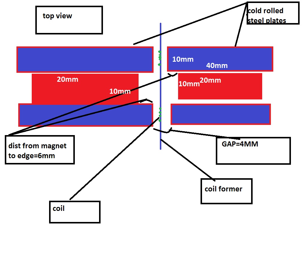

I have a question if you can help: what do you say, is it ok to put aisi 1017 screws in front of the magnets (instead of the Al 10*10mm square rod)? Will these screws short circuit the magnetic field?
I draw a scetch bellow so that you can make an ideea of what i meant.
Thanks in advance.

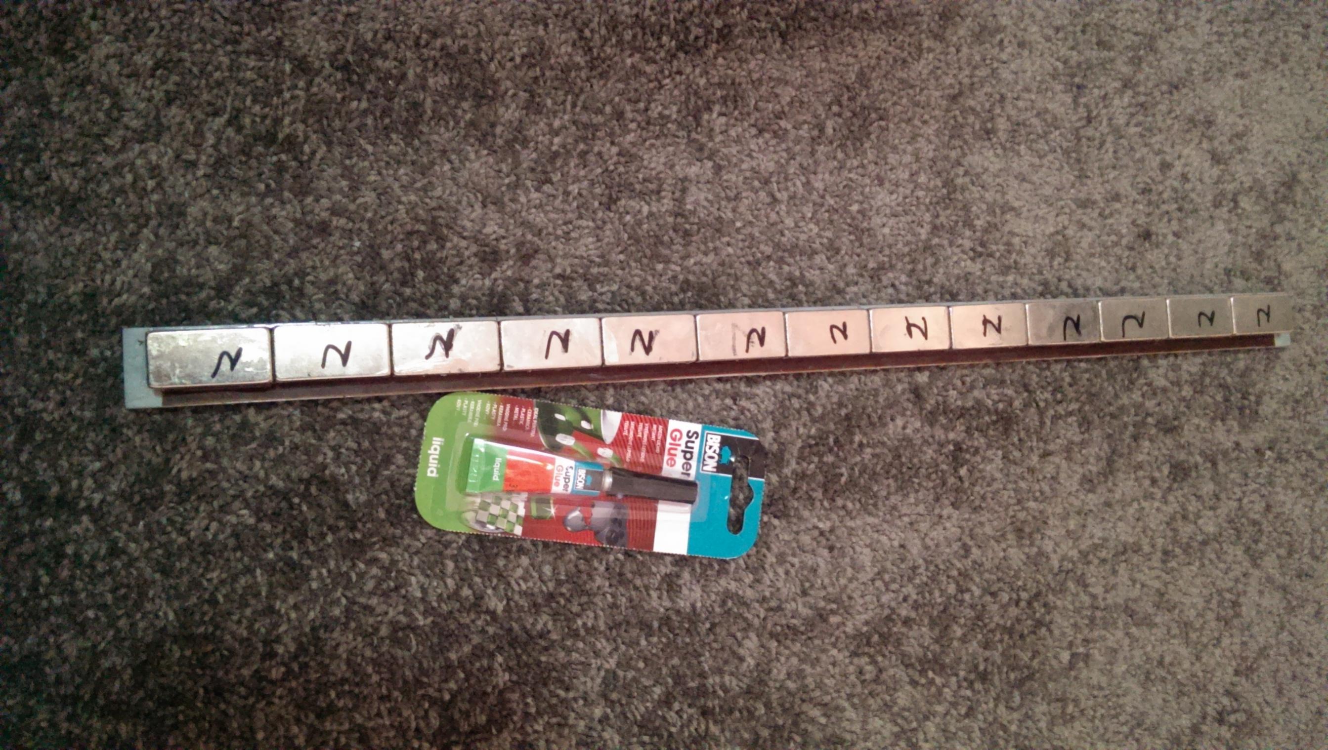

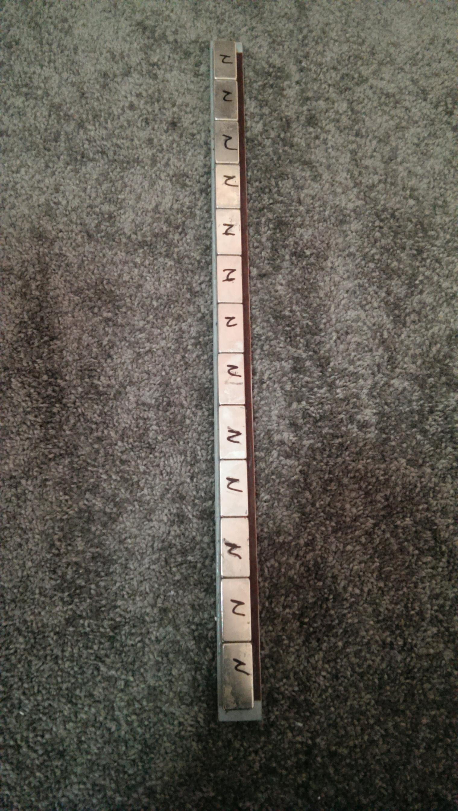

Hello guys,
I'm back at last.. This time with a fresh start. I eliminate the square Al pipe from the front of the magnets and use 0.5mm slim textolit (like the one used on the very old "in air" valve amps layouts) .
I still have to put magnets on one rod (just finished three as seen in the pic). Now i have eliminated the surplus of materials and will have a 3mm gap as in the past and the magnets as close as 6 mm from the edge of the steel plate.
Aftter i will finish the assembly i still have to find a good reinforcement so that will keep the steel plates away from bending.

Hi serg ! nice, you should gain some spl i guess 🙂 not that you needed that with this much power 🙂 but welcome back my frend!
and be carefull !!!!
well it becomes harder and harder to gain anything. 🙁 doubling the field is out of the question after a while.
Yeah, you're right. If i had a PA bass for open baffle with a bit more xmax, i would have leaved the rubans as they where...but the bass that i have doesnt have huge xmax, instead it has high spl forcing me to go to ported or a huuge enclosure for infinite bafle... IB bass is also a good thing but i'll loose abit of spatiality. I think that in the end there has to be some compromises that needs to be done in each enclosure design/combo. 🙁
