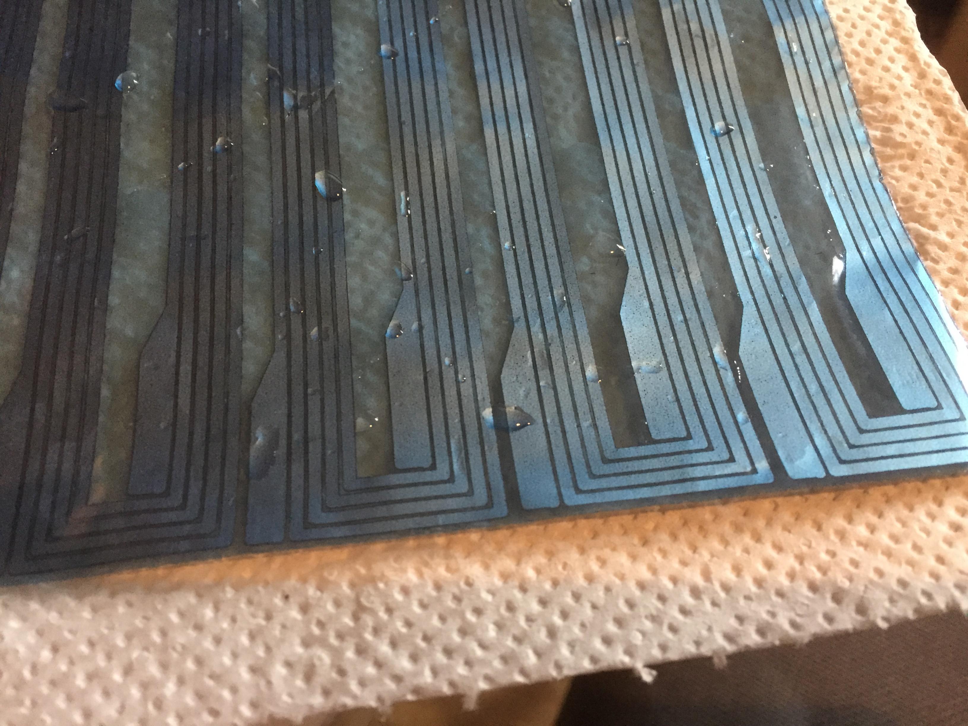

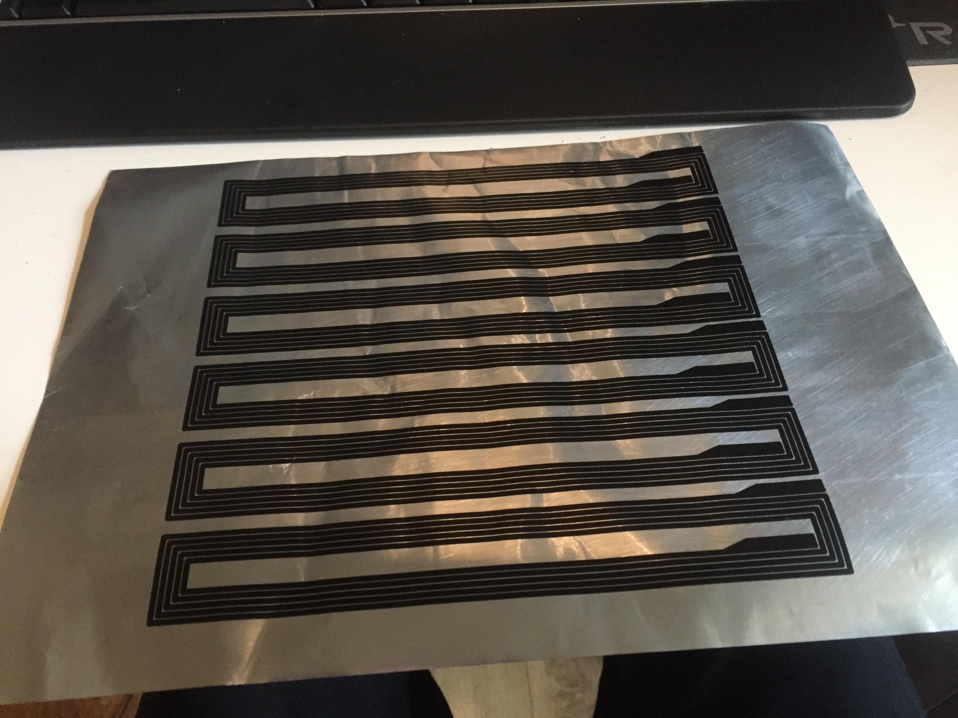

Ok i used my laminated foil for coils now, the foil i used was also a sample in this thickness.
so serg if you want some decent coils. look at these i did not try yet how small i can make them , i do know that 0.3 - 0.35 is somewhat the smallest gap in between the windings before the ink smears just enough to not etch nicely.
max size 280-290 mm so you would need 2 if you would want to use them. just glue them on with a glue that adheres to polyesther, use the flux to solder the leads to and to solder a bridge from one coil to the other 🙂

Interesting my friend. Very interesting coils you got there. Still, i have to wait too long for the coils to arrive. I will try my best to make them by hand as neat as i can.
I think that before you stick the coil to the cils you have to laminate the coil on both sides to transfer to both of them the same quantity of sound .

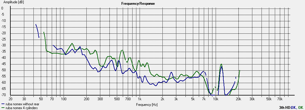

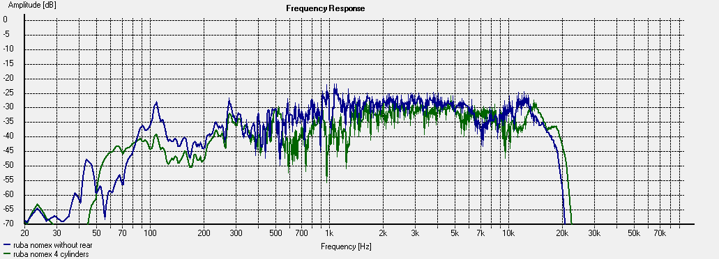

here a small test. goal to see the real diference
4 cylinders vs my open back 2 cylinder design.
same coil same nomex 410 0.17mm same motor same size.
first picture freq response second distortion
looks like 2 cylinders wins. i though i might have some disrtotion because of the fact both sides are not the same. but apparently the fact that 4 cylinders are working in tandem and sharing the space between them destroys more then it gains. no output no nothing except more distortion and less output even.
to minimize distortion , mostly present in the lower end of the sprctrum it would eb nice to have 2 complete ones above each other with one turned around and out of phase. so the distortion of the uneven balanced motor will cancel each other out. like they do in open baflle every now and then. another aspect is you could let the top one play fullrange and the bottom one only 500 and lower. this will increase low end output witch helps with the distortion. there is no need for more gain above 1khz
now i listen to them with some tweaks and a gain of 9 dB down 500 hz 🙂 it is playing fullrange from 65 hz 🙂 cant blast ofcourse and distortion down low is not where i would like to have it 🙂 but casual listening he sounds pretty funny 🙂 oef i noticed my coil being 1.6 ohm 🙁 poor amplifier 🙂

uh yeah you have to sandwich the coils within the paper. since you use 2 of them above each other its simple in series and your ready to rock. good thing is the coils is shielded from the metal may it ever hits it you wont short your amp and the rest.
i do this: paper coil paper. just impregnate the paper with epoxy, put the coil on solder leads, epoxy them and add the last paper. put it in a press to dry. i use a heat gun to get the epoxy viscosity down and brush it out while heated. this ensures it is getting soaked, and speeds up the dry time after.
