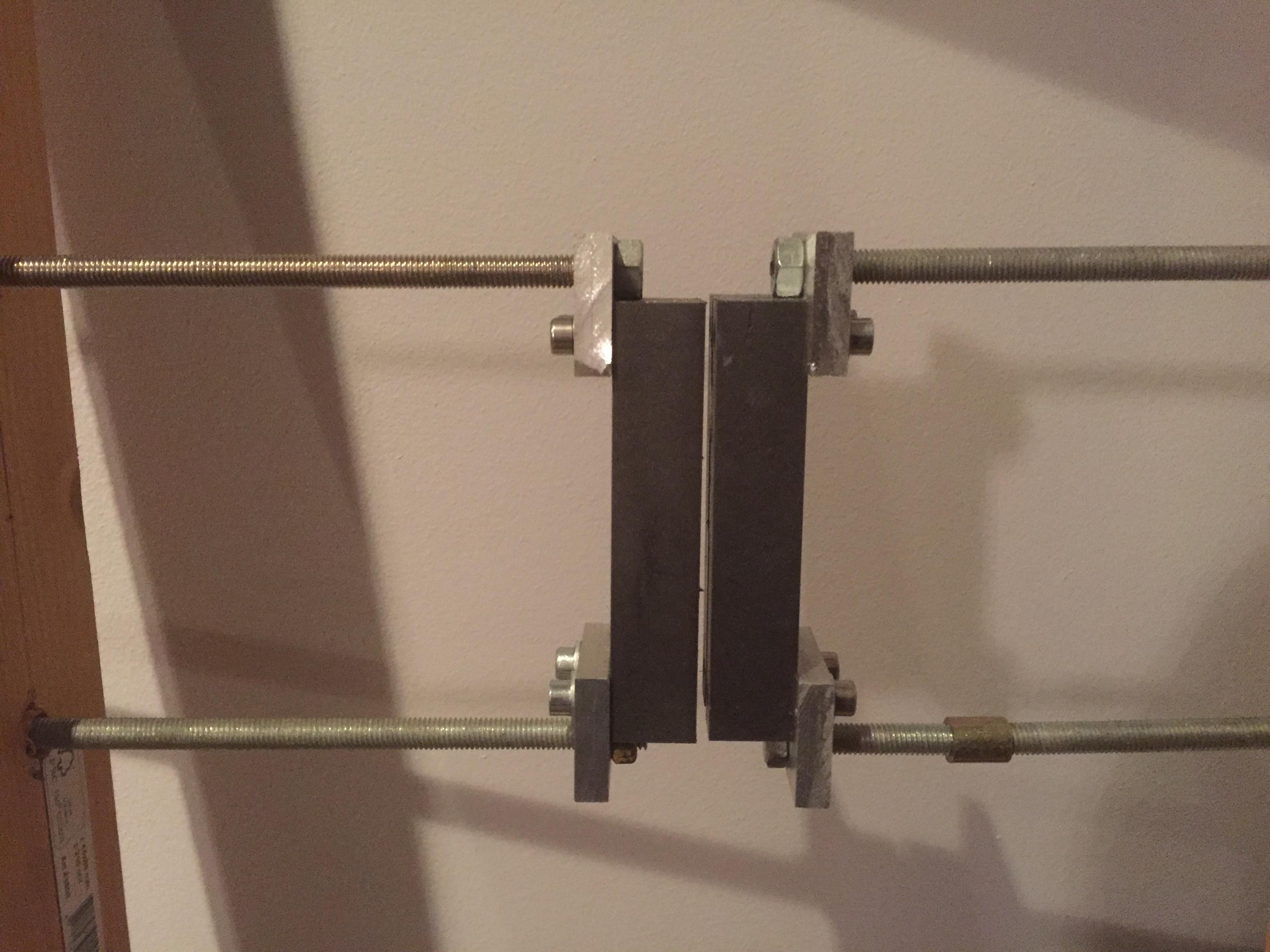

I realy should make the big motor to see what happens. What I did test was this
I made a motor that does not have spacers between the bars I threaded the steel so you Suspend them to the side supports(where you clamp the paper) with an stainless steel threaded rod in this way you can make the coil bigger then the motor so you can move the turning point of the coil outside the gap so less movement in directions you don't want and the oportunity to put all the force of the magnets where it belongs in the vertical traces and not the horizontal. Another benefit is you can adjust the gap on the fly by the 4 rods ( made 2 aluminium bracket that hold the 2 steel bars and the magnets in between in the top and one at the bottom)
Because the bars magnetic field, the 2 sides attract each other so they sort of hover in the air only fastened from the side by the rods.
It is much saver to construct then sliding them together with something in between. It is also much much more work.
I'll try the old method for test (with big membrane) with the old method since it is less work and the magnets are weaker 🙂 I'll post a picture of the construction of the above tomorrow 🙂

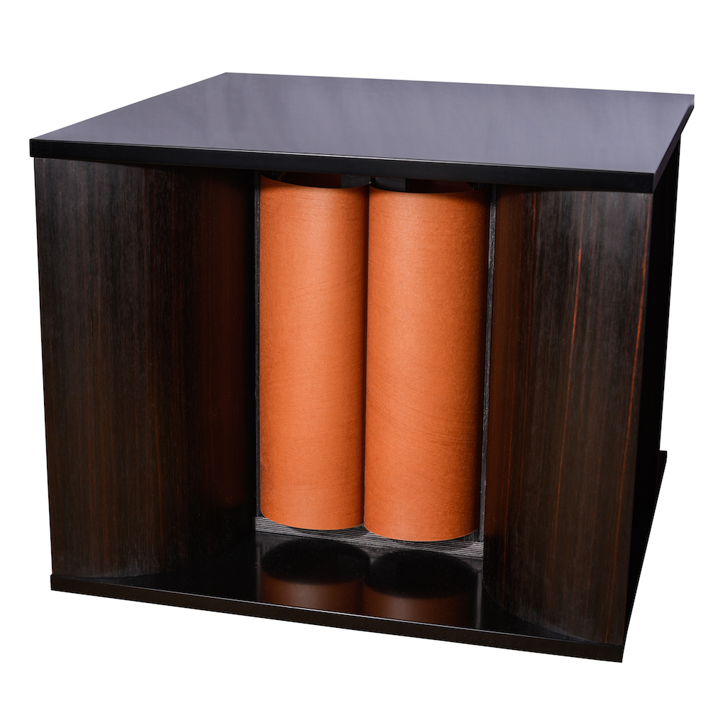

Take a look how the new rubabas 2 looks. It does differ from the first one wich had flat membranes like your first fullrange attempts my friend.
The ideea is interesting and the results:
"Freq: 15Hz to 600Hz
Over 96dB/w/m efficiency
Resonnance frequency at 10 Hz, which is quite unique , as one octave below 20 Hz
Impedance 8 ohms
The most interesting thing is that if you look closely at magnetic motor you can observe how small it seems and how huuuge the membranes are.
ps: the images are proprety of audio consulting's site and are not for making a bad image on their products or for publicity. They are pasted here just for informative and study purpose (of new things) .
Impedance 8 ohms

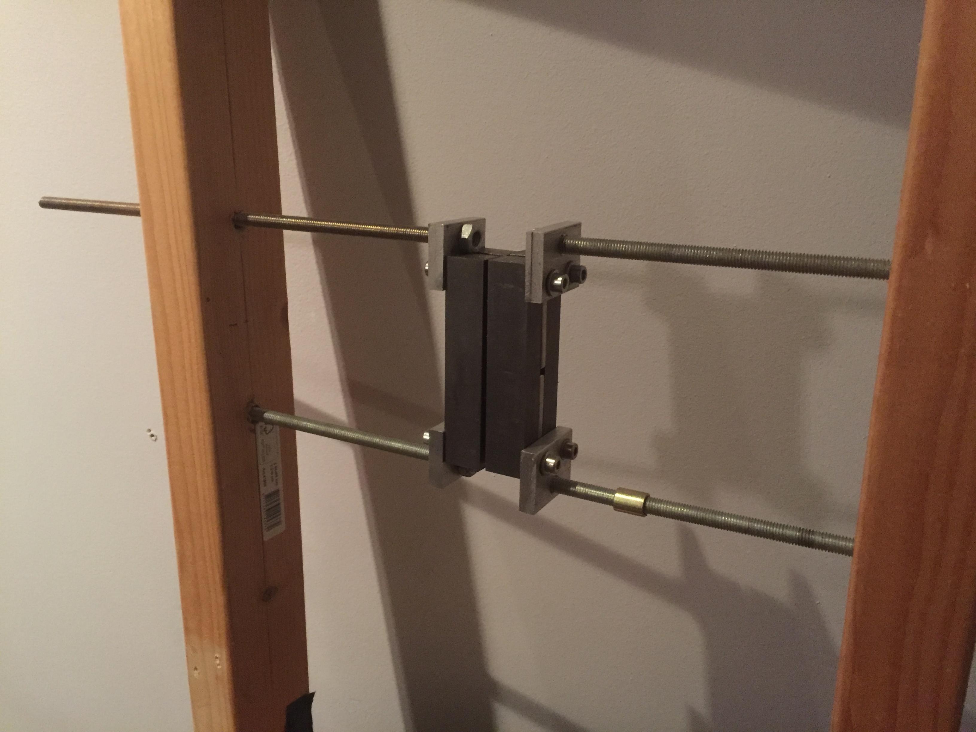

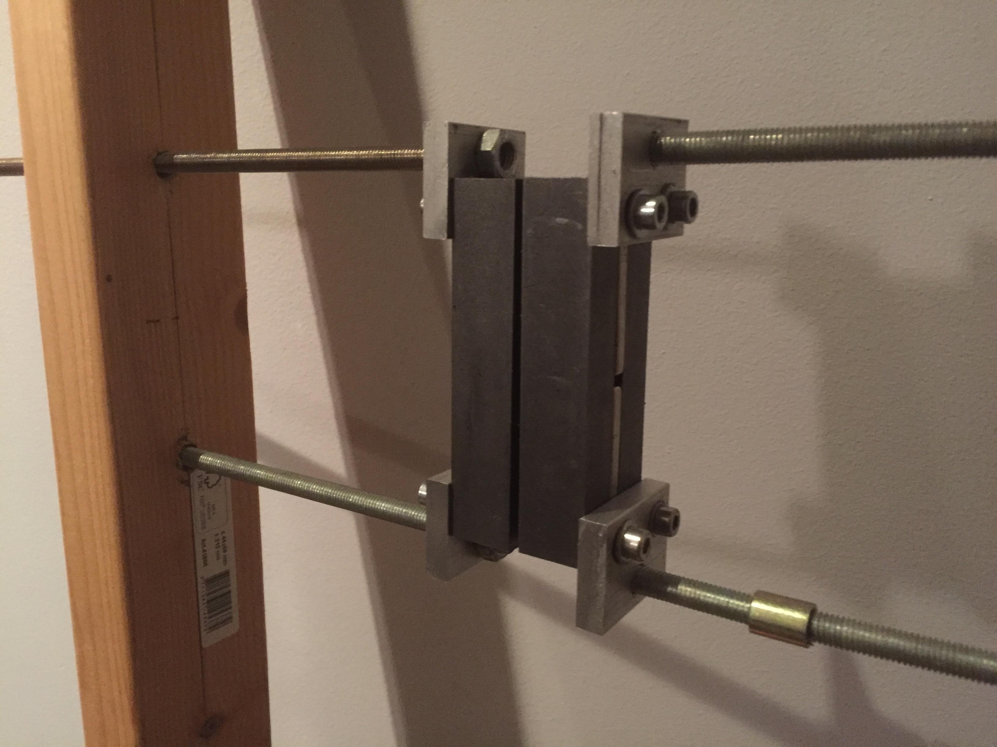

Here ar some pictures of the tiny motor. It sucks. Well not the method but the size 🙂 might be useful for stronger magnets or longer motor and even bigger membrane but for this version the frame is to big and the driven area to but hell its just an idea to build up a motor witch you can change the gap width of and use a membrane bigger then the steel bars are long and as wel keep the horizontal pieces of coil out of the gap so it moves to where it supposed to go , instead of up and down 🙂
Interesting my friend. Its a very fast way for testing different configs. Nice job.
By the way, if you want to go with a higher magnet structure, what do you have in mind for keeping the bars straight?
