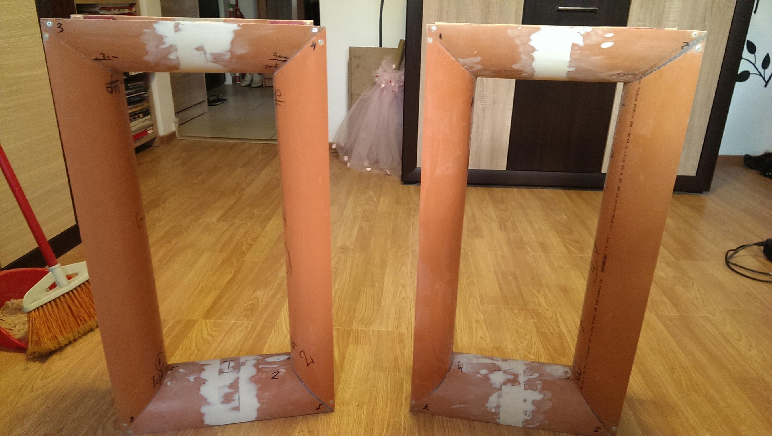

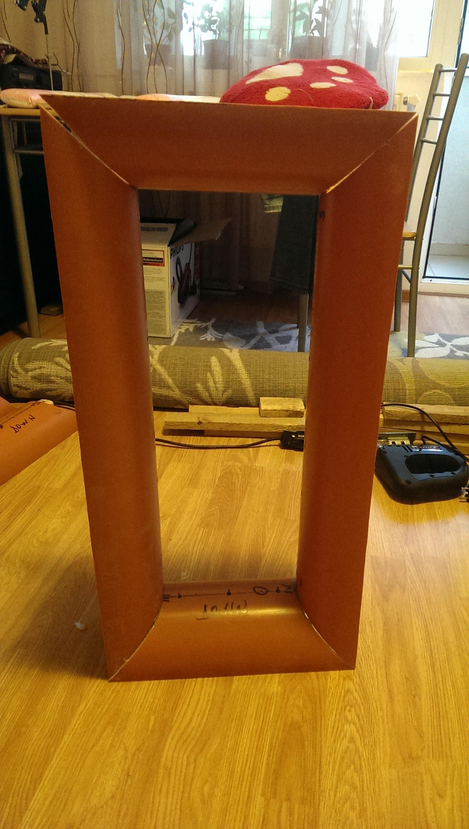

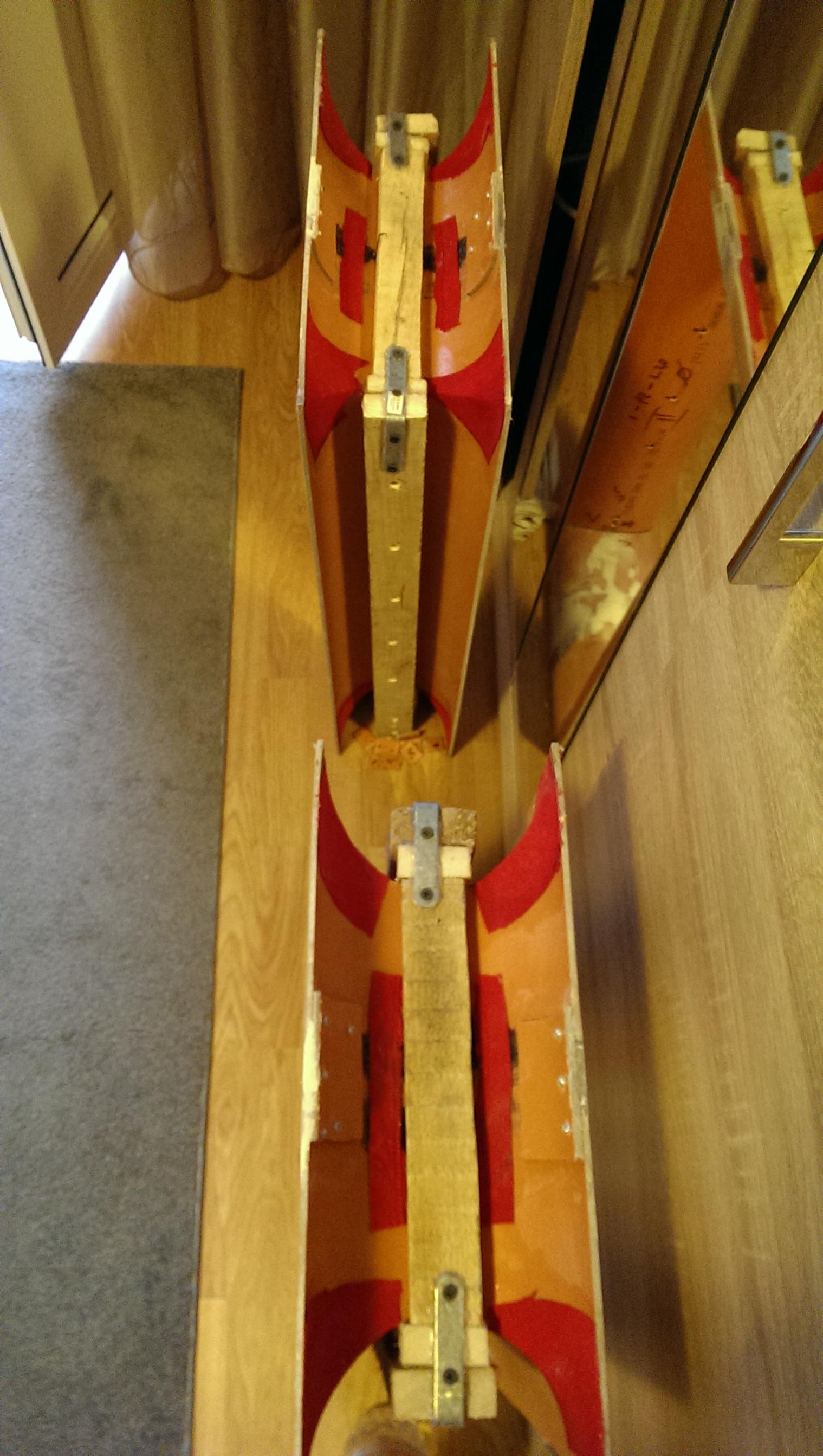

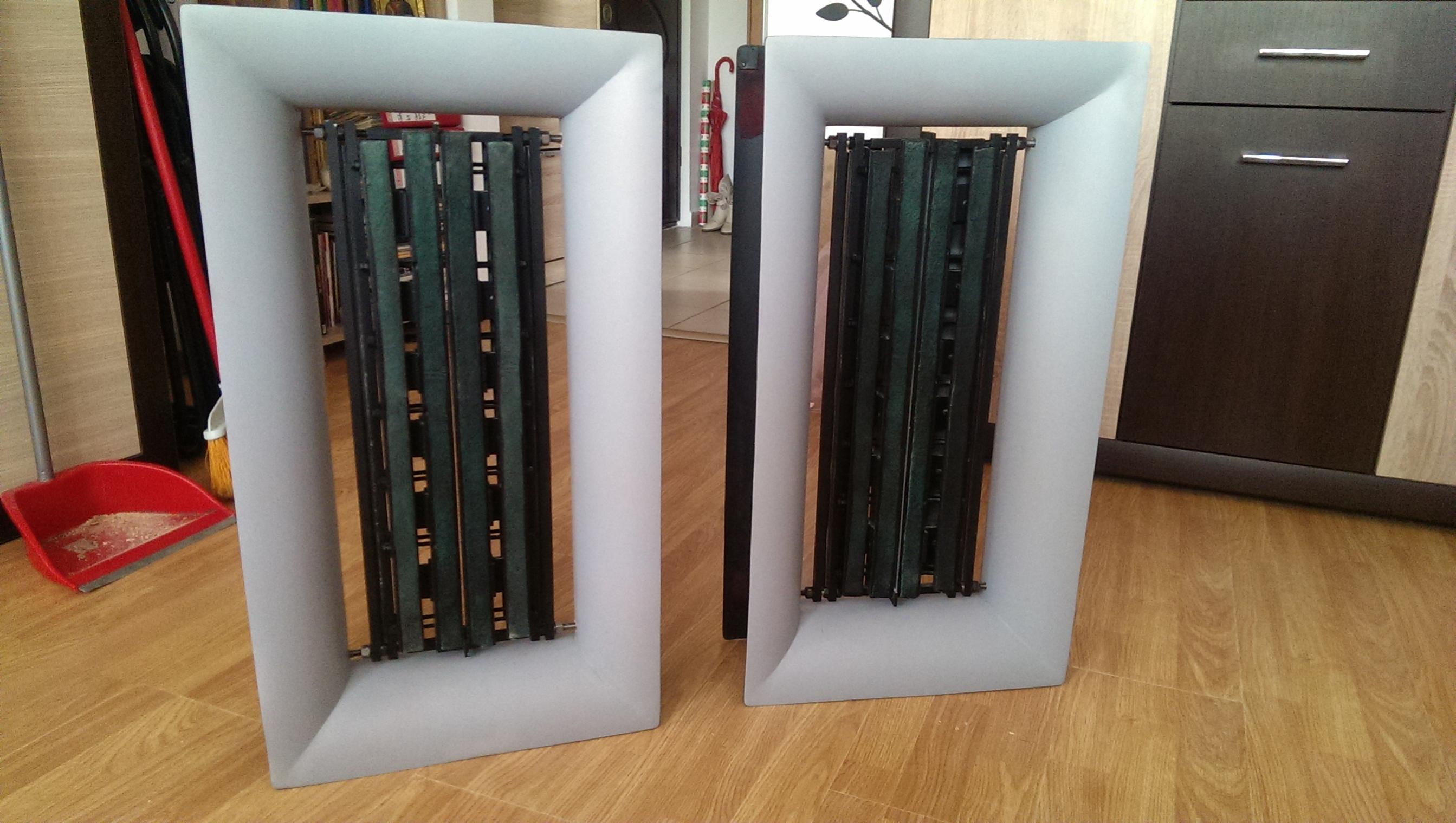

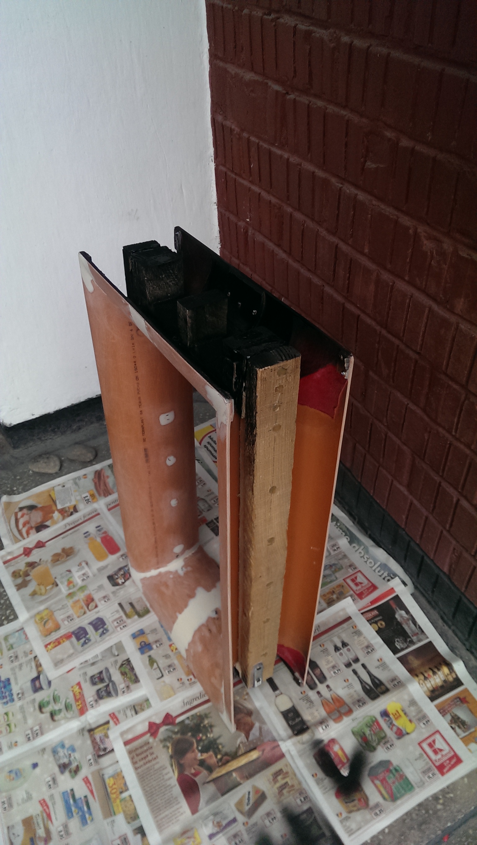

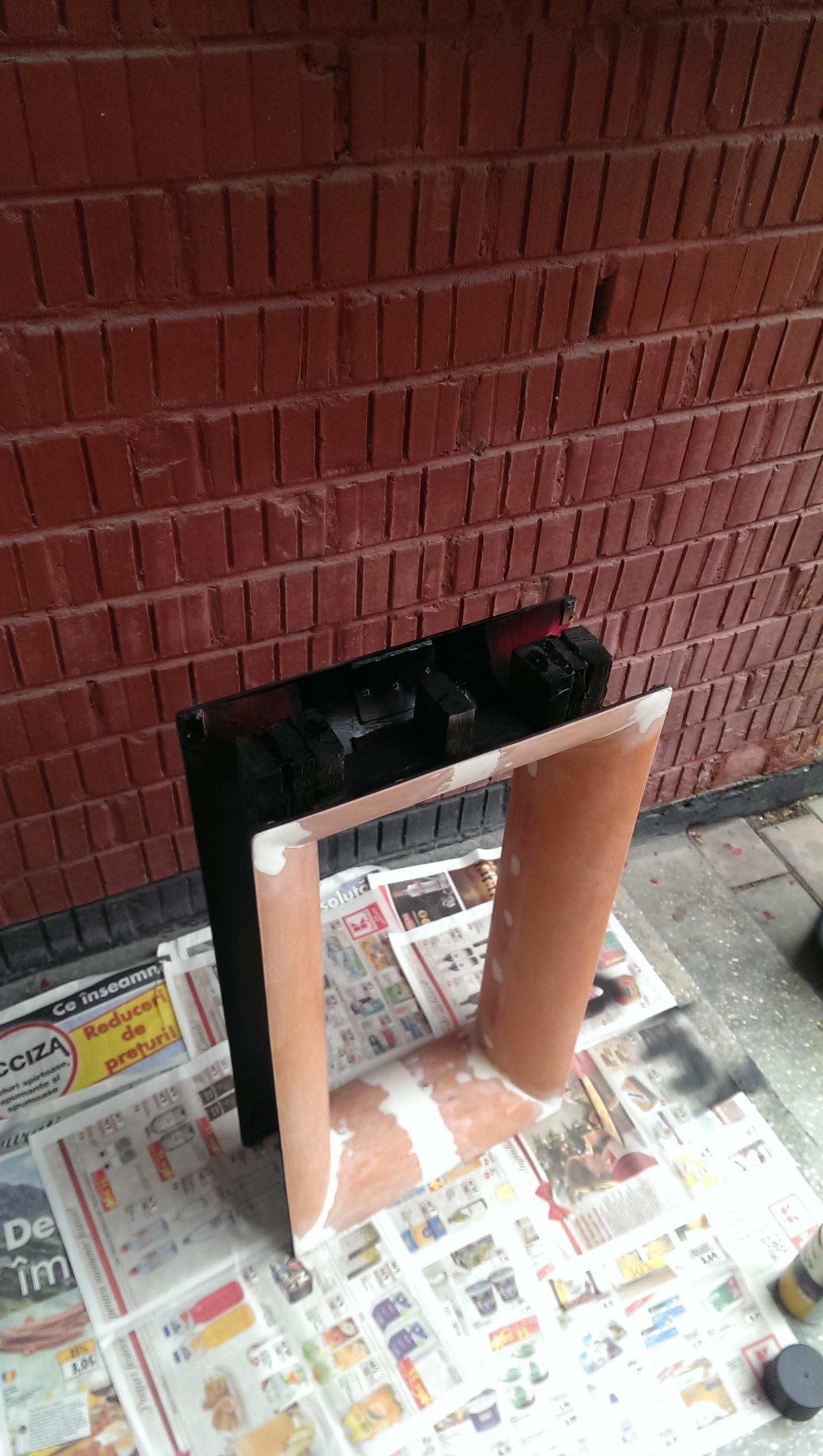

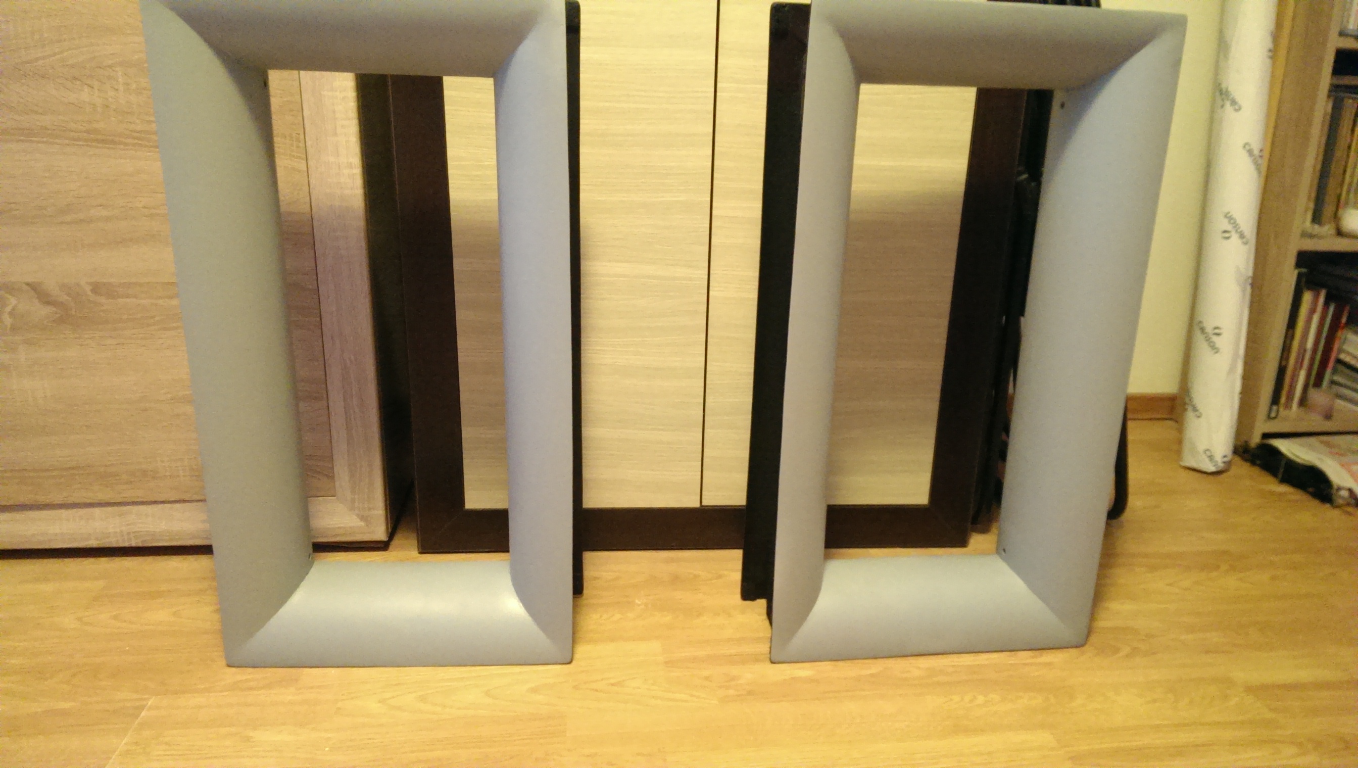

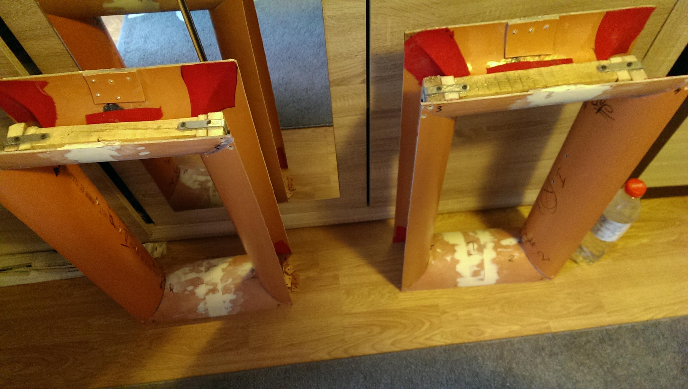

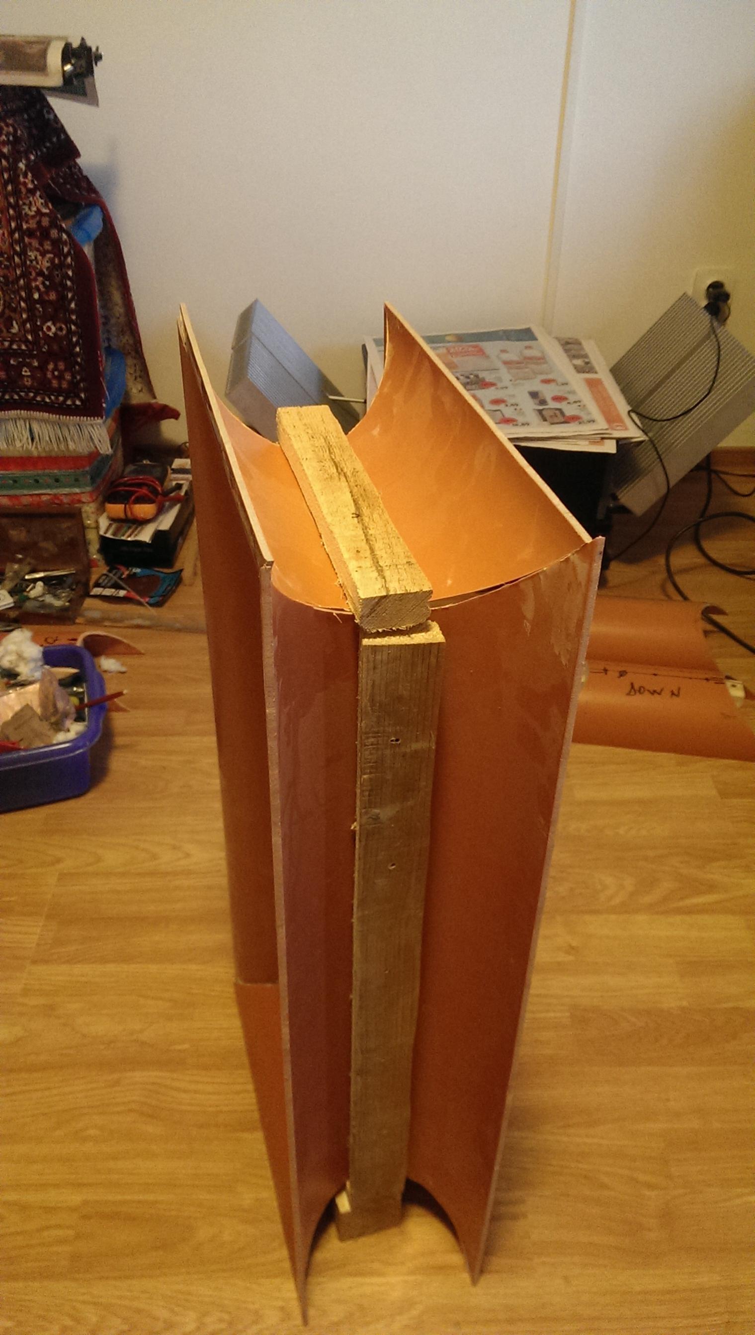

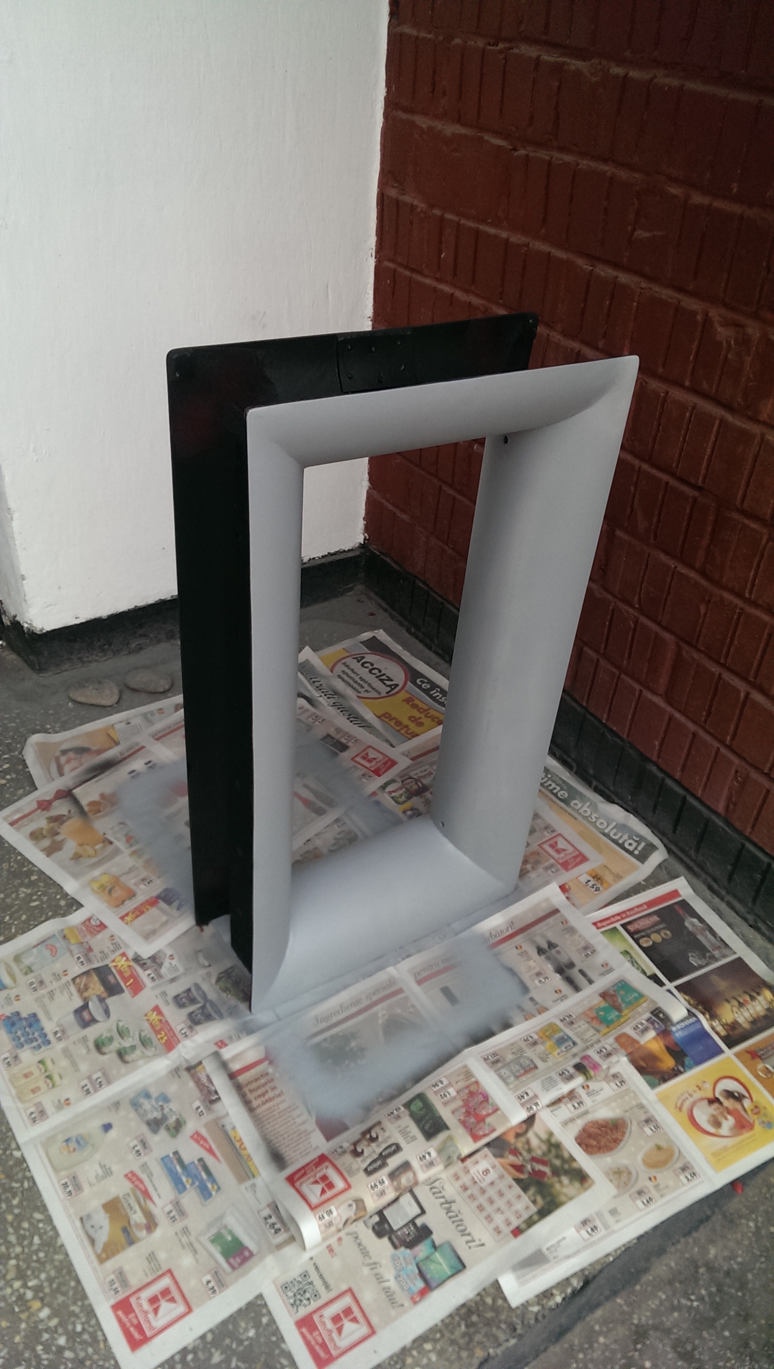

I know it has been a while, but i couldnt resist... I finished my final coils and membranes a month and a half a go and now i'm on the frame. I loved Audio Consulting's frame so, it all started from a plumming pipe as seen in the pics bellow. It still needs allot of hard work and will take it to an authorised painting shop for the glossy black that i want for the frame. The interior of the frame will remane matt black as i painted now and then covered with a matt black foil to cover the wooden frame. I still need to find some elegant handles for the frame because i couldnt find on the local shop, so maybe from the net.
Will post some more pics when finished.
Cheers
Sergiu
Ps: i painted the primer on the backyard. 😀

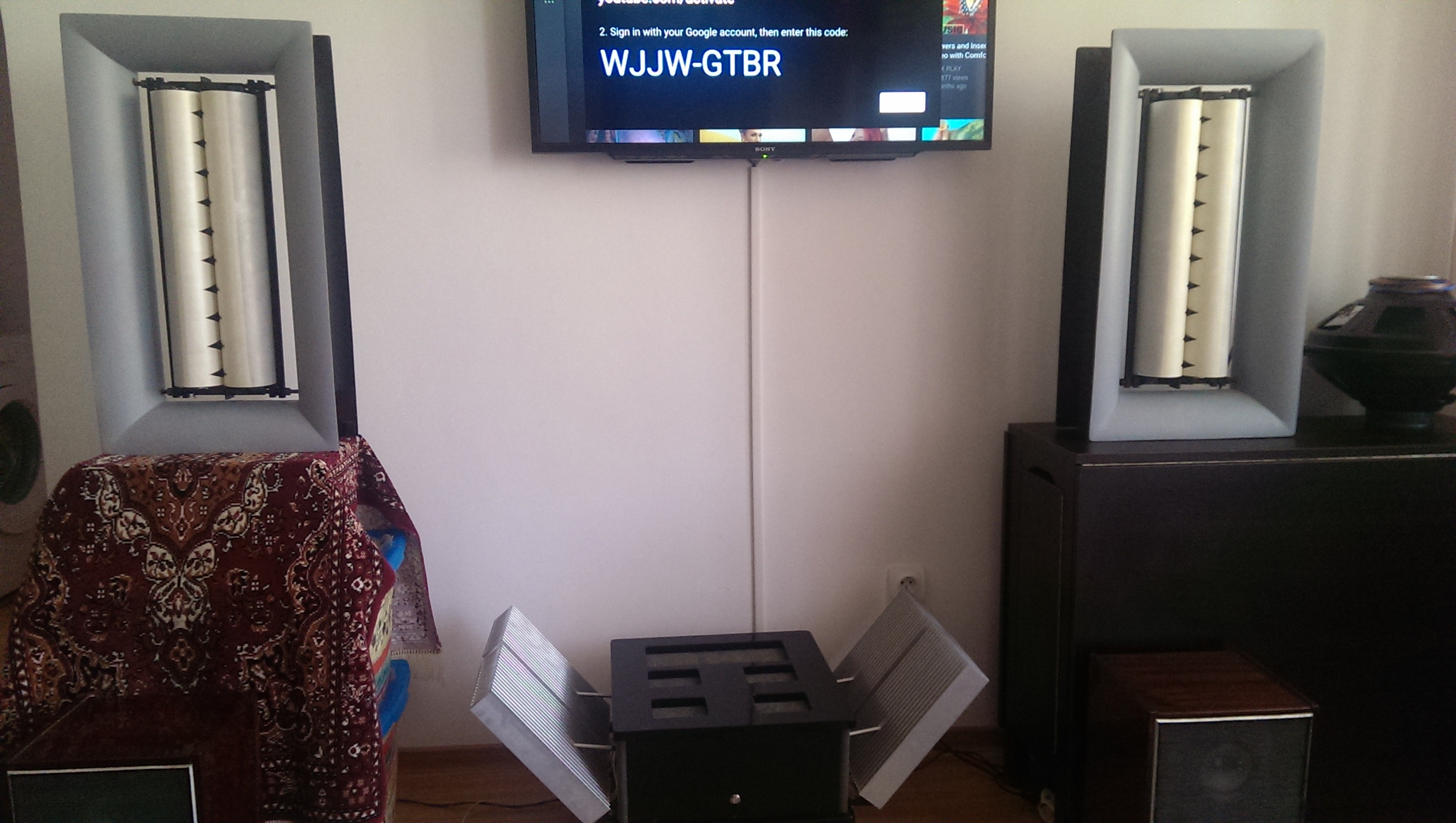

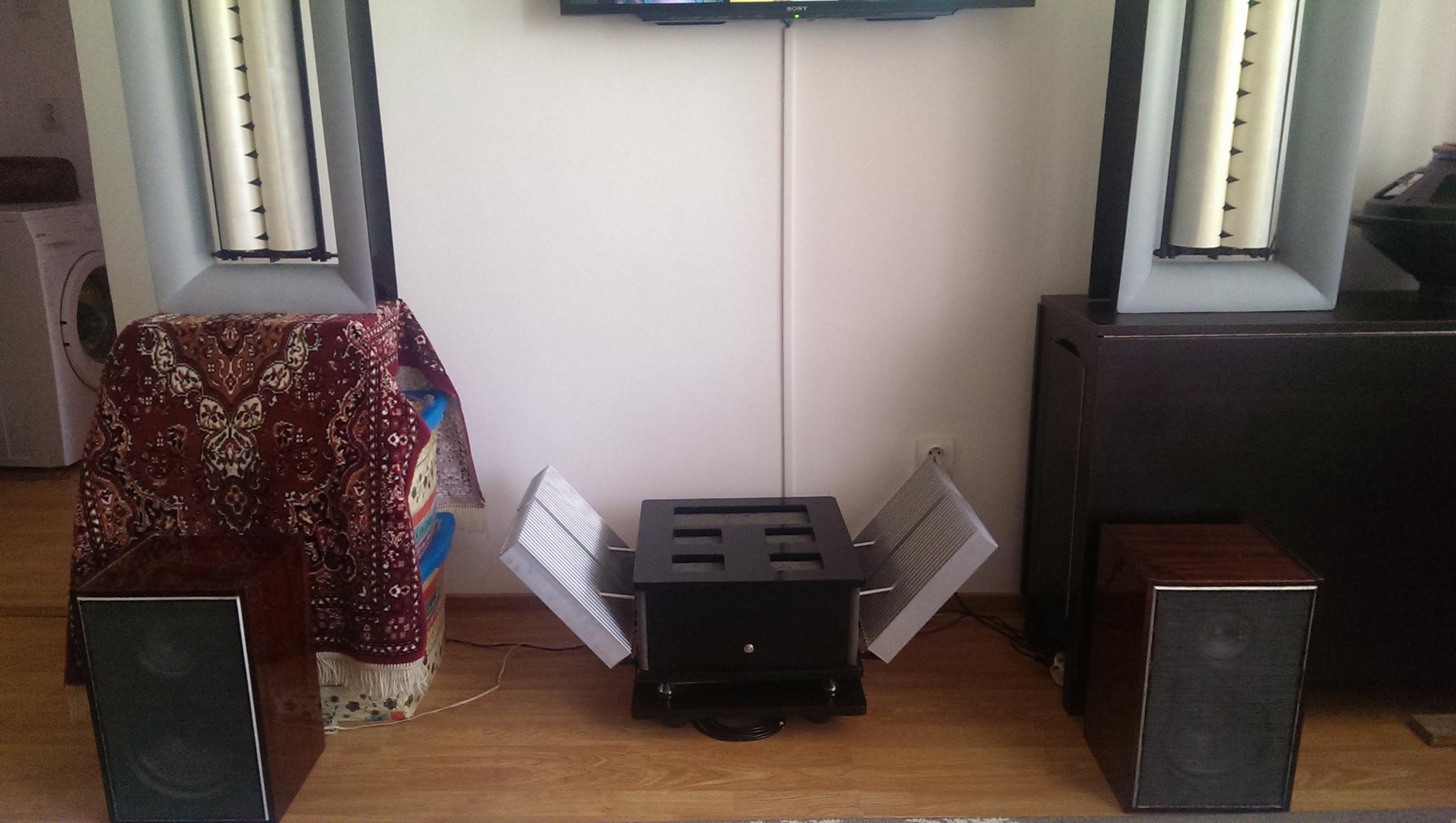

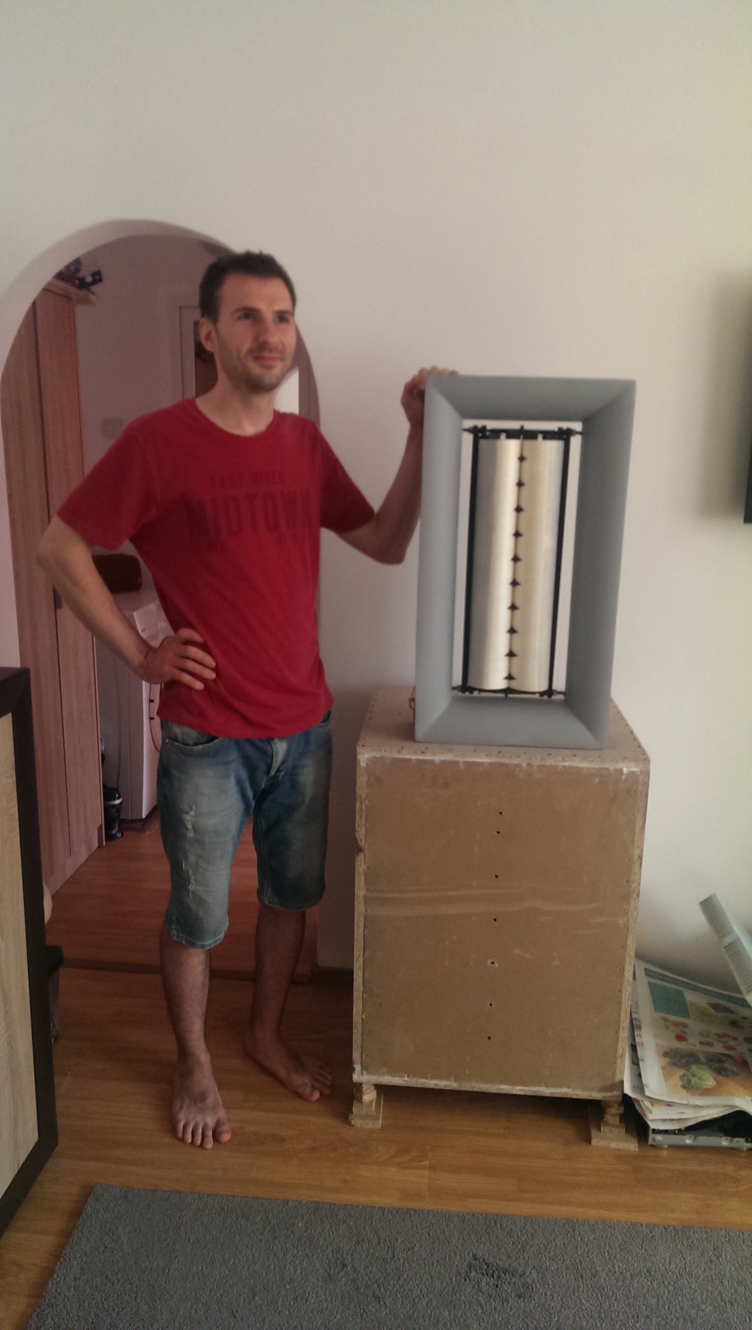

Here it is my friend,
My diy ruba, preassembled and ready for the final paint. I used a pair of old refurbished 8inch sealed speakers for bass. They are possitionned on the floor and not so sensitive (you can see how far the rubas are positioned in the back). The real 15inch bass speakers that i want to use are positioned on the right, on the table.
I can confirm now that these speakers, assembled like this (with deflection plastic exterior frame) are on a whole different level of sound reproduction with staggering presence, effortless and very appealing mids, very good hights , very good horisontal dispersion but poor vertical dispersion. That's why it is needed a least a 50cm ruba or bigger or stacked to cover all the room.
Coupled with the right amp (the Hiraga 30watter modified in my case) they sing like nothing you ever heard. It took me so much time to find my suited version because i didnt use the original magnets and steel so i had to make it work best for what i had and on top of that i had to make them sensitive enought for 10w amps.
For example i have the old 1969 jlh amp for measuring tests and tested this amp yesterday to see if i had enough dB for small amps ( because my mic isnt calibrated for accurate dB measurement) and the result was as expected, at half volume i can barelly hear my wife at 50cm. So plenty of dB for my future projects (ex: hiraga nemesis compensee, pass de-lite, Macura power mosfet folower)....
The plastic frame makes the sound more concentraded so for example on the tests when you sit in front of them (perpendicullar on axis) you had a huge sweet spot like about 90degree (way bigger than regullar tweeters, ex: 45degrees left and 45degree right) but when moving to the edges, like the rest of the 45 degrees so near 180 degree left and 0 degree right the hights diminishes and the mids also. Now you dont have this problem anymore and the verticall dispersion has improved. Now i understand why Audionec uses such a big wood frame: to improve the 3d imaging and to mask this effect. Clever ideea!!!

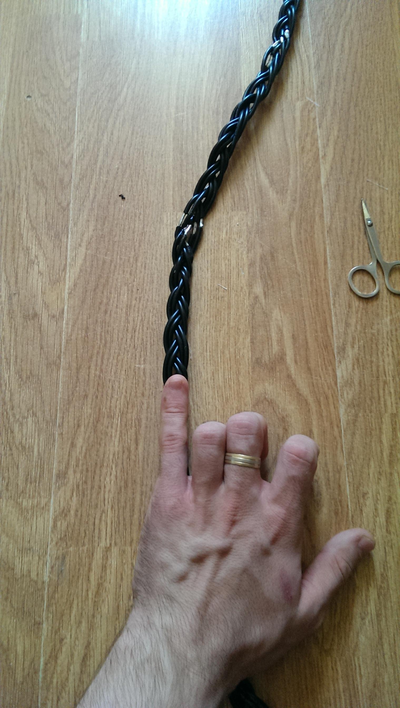

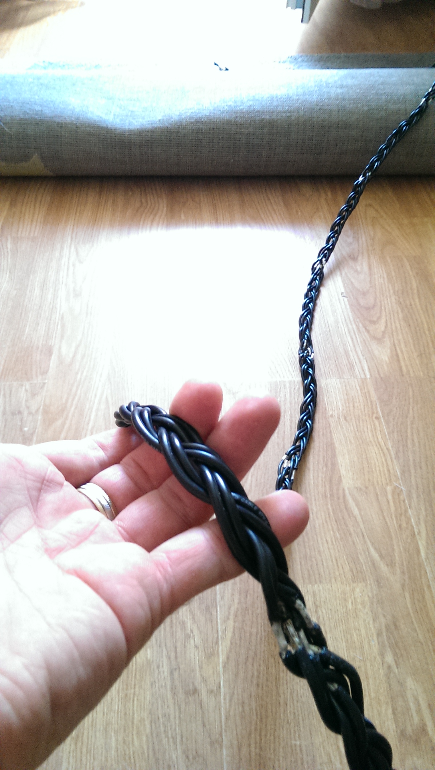

Hello my friend,
Glad to know you are good. Thanks for the apreciation. Actually i finished the bass speakers. They only need paint and the rubas small finishing touches and the final filters( till now i fast improvised some filters to fine tune the combo). I also prepared some serious cables for them wich are also not finished yet.. 🙂 I atached some pics bellow (from two weeks ago+ myself in them). I took a well deserved two weeks pause but will begin work tomorrow and post new pics.
Cheers
Sergiu
Ps: the combo got pretty big and heavy as you sayed. I'm 1.85m tall and they are almost as tall and heavyer than myself. 🙂
The bass is a minimum requirement for infinite baffle. It is 10x time the vas of one speaker at 235litter and heavy damping and down firing with 10 cm gap between the speaker and floor.
Cheers
Sergiu
