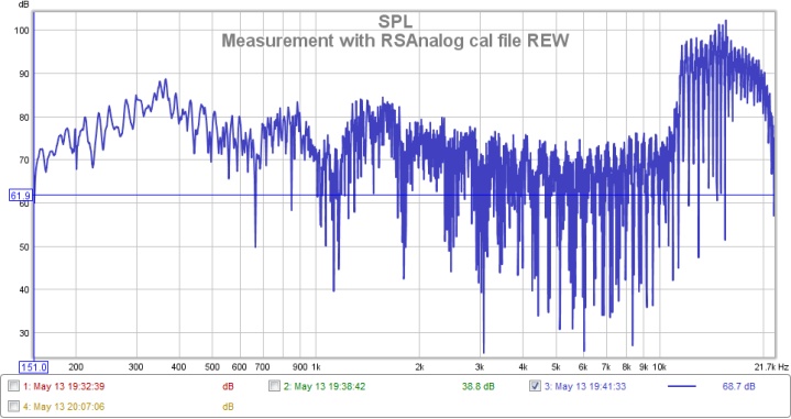

These are the measurements. It is a really strange thing. With a different cal file and a preamp i get similar measurements. The strangest things of all is WHY these two programs measure different?????!!!
Can you see any problem here Wrine?
Do you have any video tutorial of how to measure with HOLM please?
Thanks in advance.
Sergiu

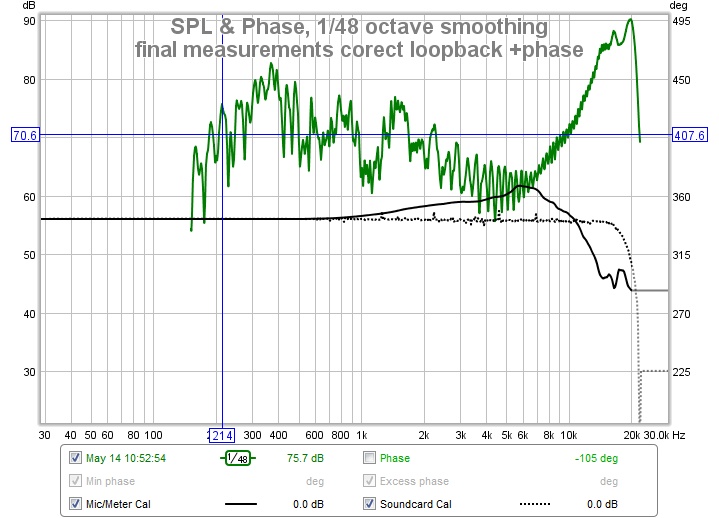

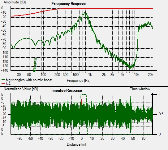

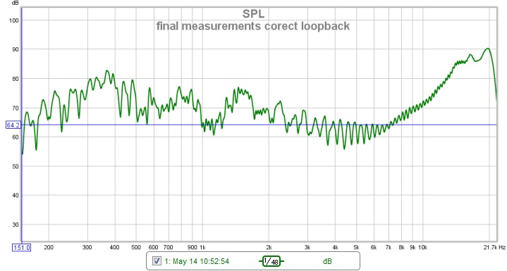

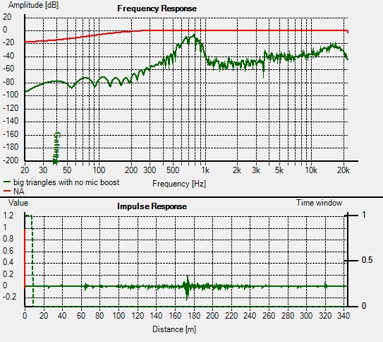

Here we are Wrine,
After almost a whole night loosen, and after reanalising the whole thing and graphs over and over again i have learnd some things and foun out the problem. There where three big problems in REW:
1. the loopback cable was way too long and had some leaky joints (now i use a short one without joints)
2.REw its pretty strange, BUT FIRST you have to measure the soundcard (hit calibrate);
3. Then hit MAKE CAL, AFTER measuring the souncard and your good to go.
I did all these steps incorectly because this is my first contact with this stuff and didnt know how to do it...
Now what i really believe, is that HOLM is doing a souncard cal and loopback, and dac cal at the same time. When i changed the loopback wire everything was very good and back to normal here.
If you look at the graphs bellow you will see what i meant when i said that REW is strange. There must be some settings there that i still dont know how to use and they are ruinig abit the measurement because i dont perceive, subjectively, a huge amount of hights.
I think that holm is very accurate here and its the program to use.
Look bellow and please tell if i'm wrong Wrine.
These measurements are from THE CLASSIC RUBAN with reactangular cuts in the active portion and round cuts in the middle of the coil.
Cheers
Sergiu
