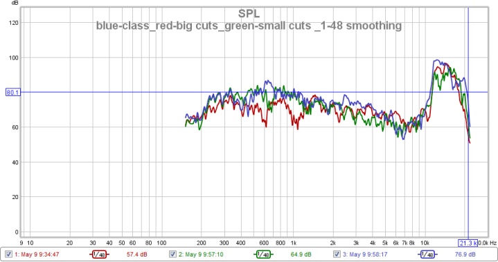

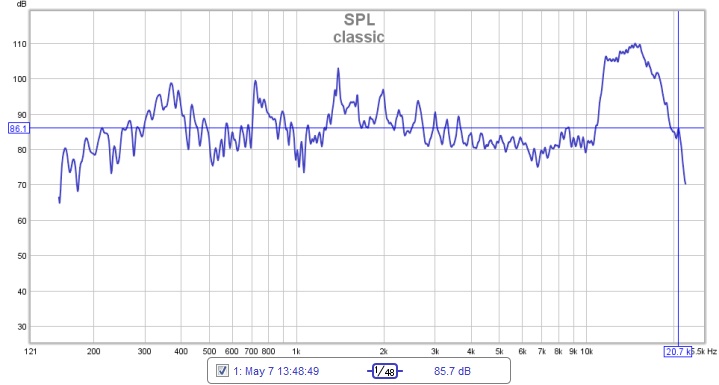

And here it is. The complete graph. Yesterday i tested from 150hz to 20khz. Look Wrine red is classic, with elastics and hinges and green is the butterfly.
What do you say? I know that it sucks at hight frecv, now i can really see it, but its almost there at the bass chapter. Am i right?
These measurements are taken from 1 m at 2v output and a 66uF /150v cap in a first order filter arrangement for 300hz .
Cheers
Sergiu
Looks like classic performs better in all area's
Btw something looks fishy about the drop at high freq. I'm not sure if it is correct. I assumed a drop since I had it but not this drastic and for both models exactly the same. I think something goes wrong in the calibration or limit of a soundcard. The drop is to heavy. Try looking up some of my measurements to see if they compare at all. Since I got higher then 12 kHz with the mist heavy paper I used even plastics got above 12 kHz if I remember correct.

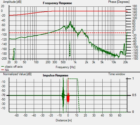

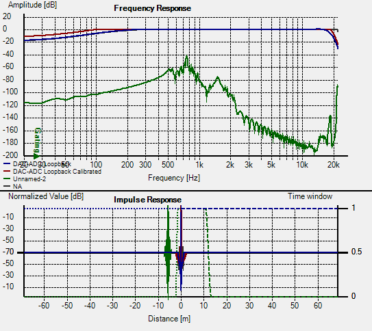

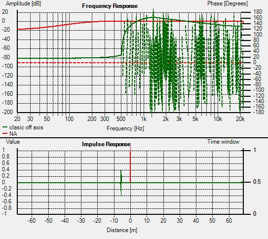

The first pic from right to left is off axis, the center is on axis, and the first is also on axis.. Forgot to mention in the pics. I think this program (holmimpulse) is abit unclear and needs some more fields here and there...I'm abit dissapointed in it.
something still is wrong.. first try to let it show the raw response. not gated!
then there is still something weird going on with the calibration files or something. the drop in holm does not look normal. also the huge peak now in REW looks weird to.
it looks like in the calibration files it just ads almost 20 dB above 10khz... no speaker has such peak in that direct line, at least i never seen one.

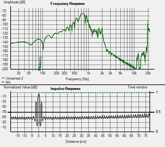

Aniway. Here it is the raw measuremnt. I didnt understand a thing from it. The very strange thing is that i used the same calibration file in the same programs.. Very strange.
I will verify and test again on monday. Thanks again.

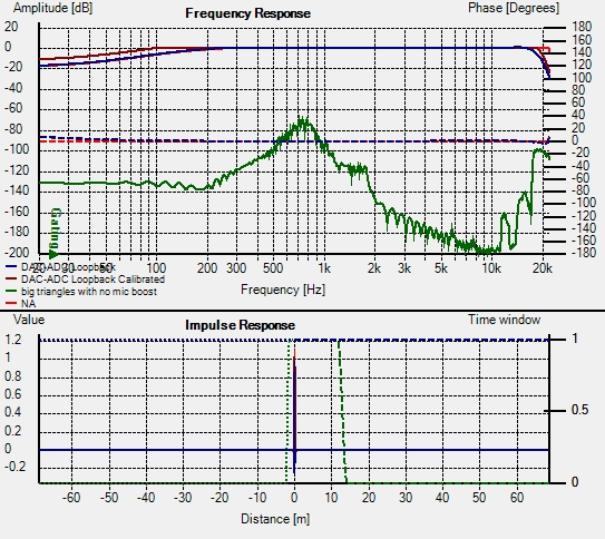

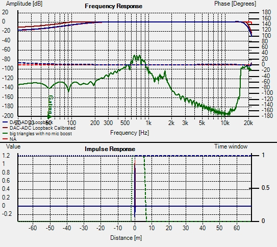

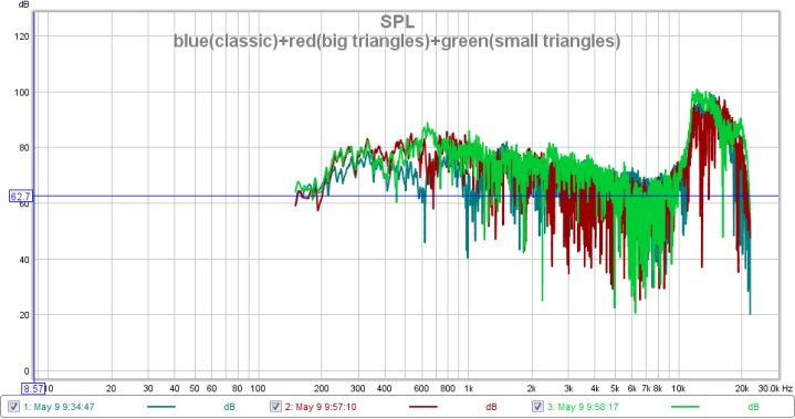

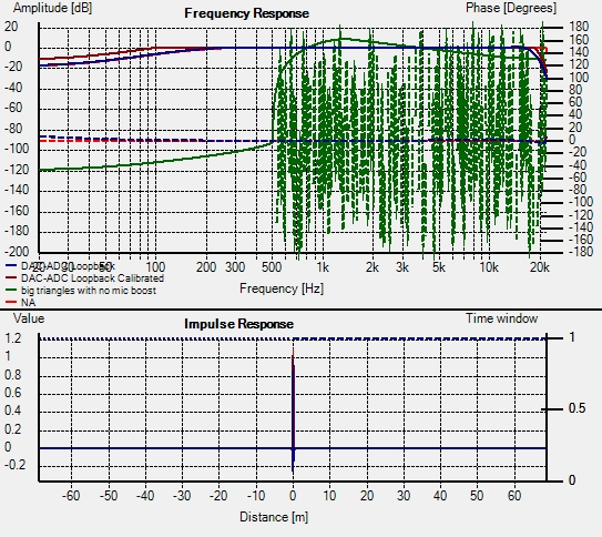

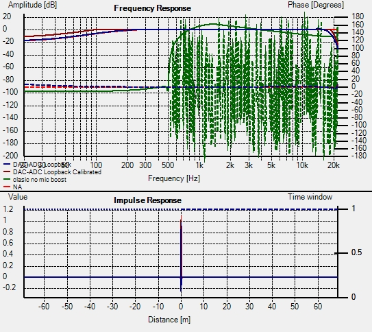

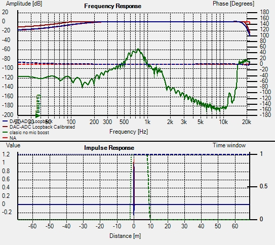

Wrine, my friend,
It looks that something fishy is going on here. And i suspect that this is because i dont have a mic preamp. I take the signal from the mic and injected straight into the mic input to the pc with mic boost for satursday measurements and no mic boost for today...
Look bellow. What do you think?Am i right?
Ps: my opinion is that small triangles withe the back cutter is more smoother.
Cheers
Sergiu
Cheers
Sergiu
blue(classic)+red(big triangles)+green(small triangles).jpg80 KB · Views: 280
Still the huge hump is abnormal,and the holm ones are completely wrong 🙁 look at my latest measurements in the video. Something technical is wrong. Best and simplest would be a cheap mic preamp with phantom power and your done no more weird results.
