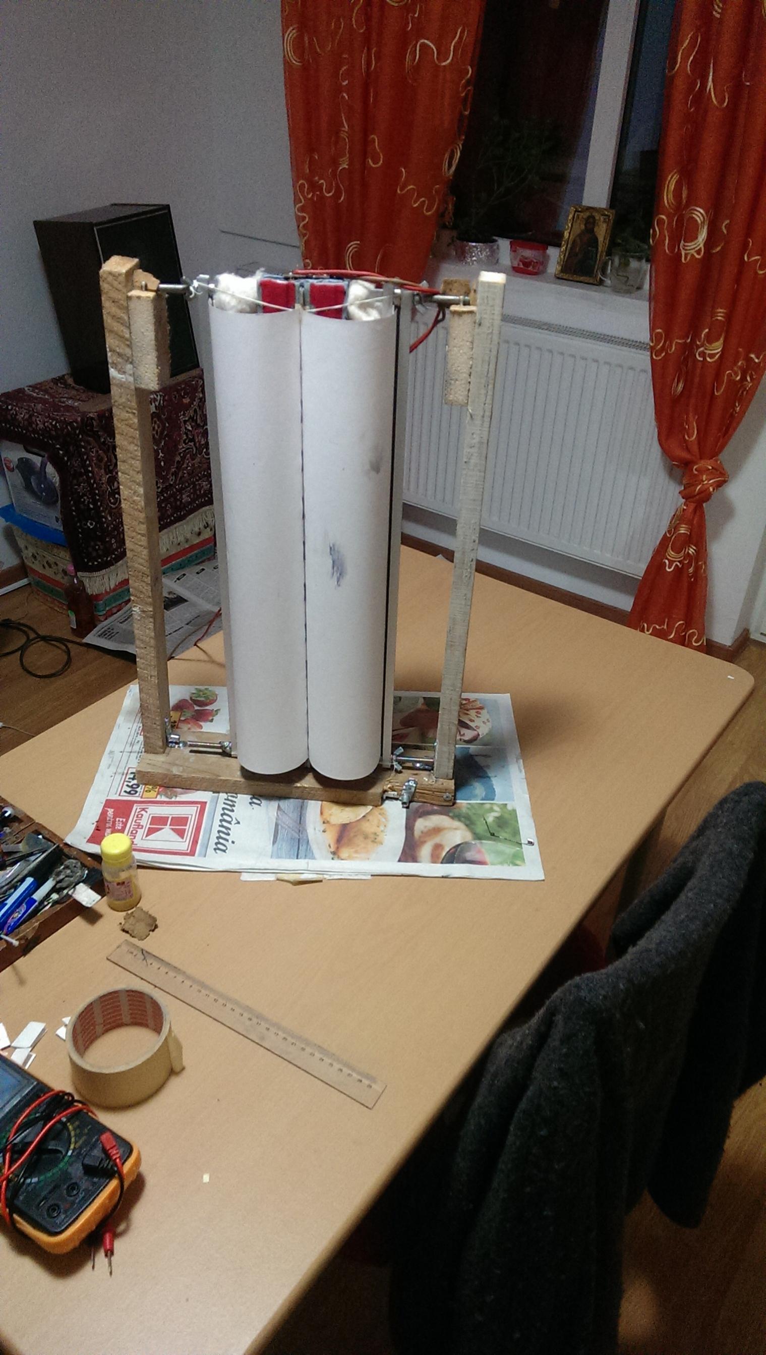

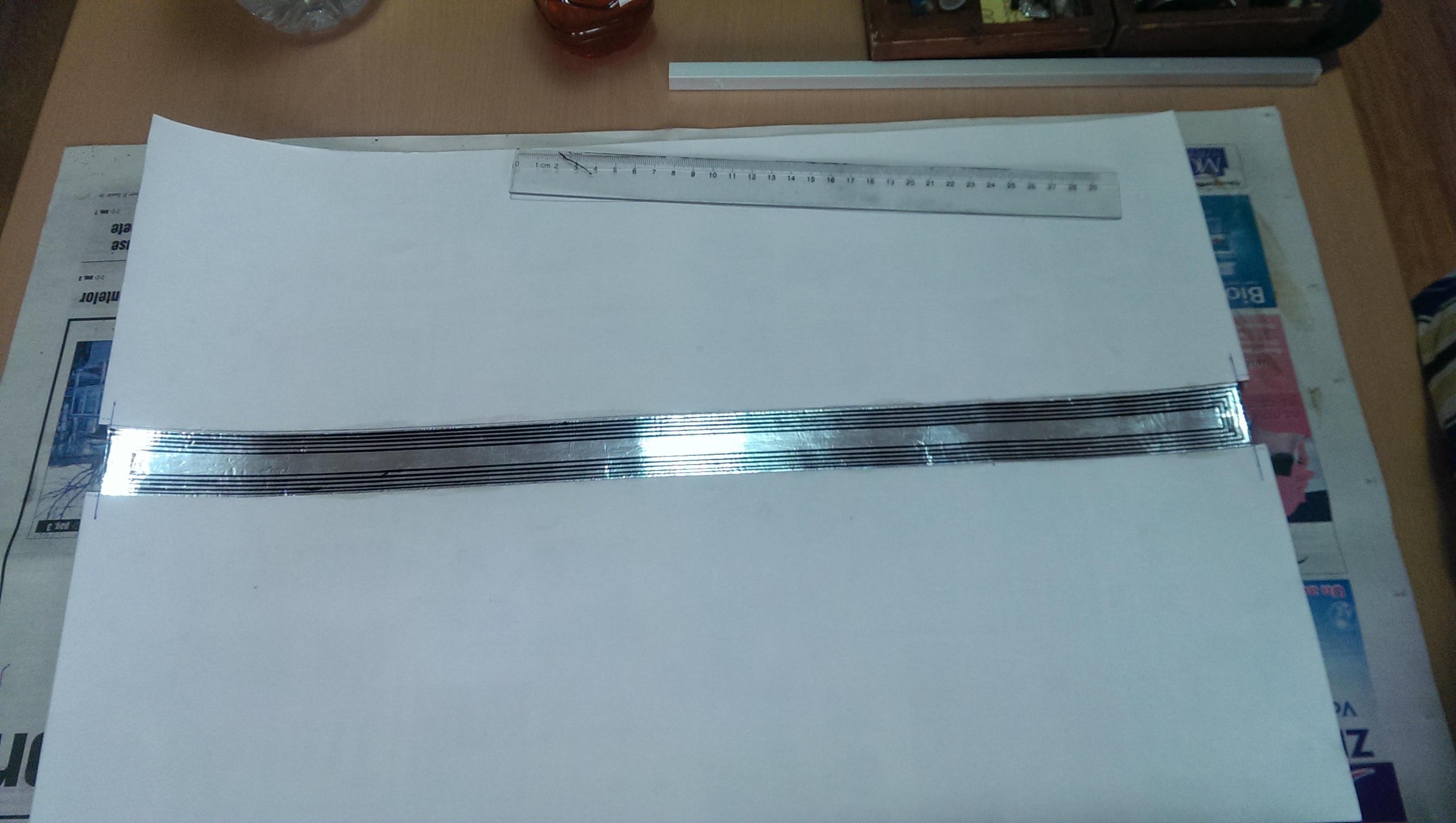

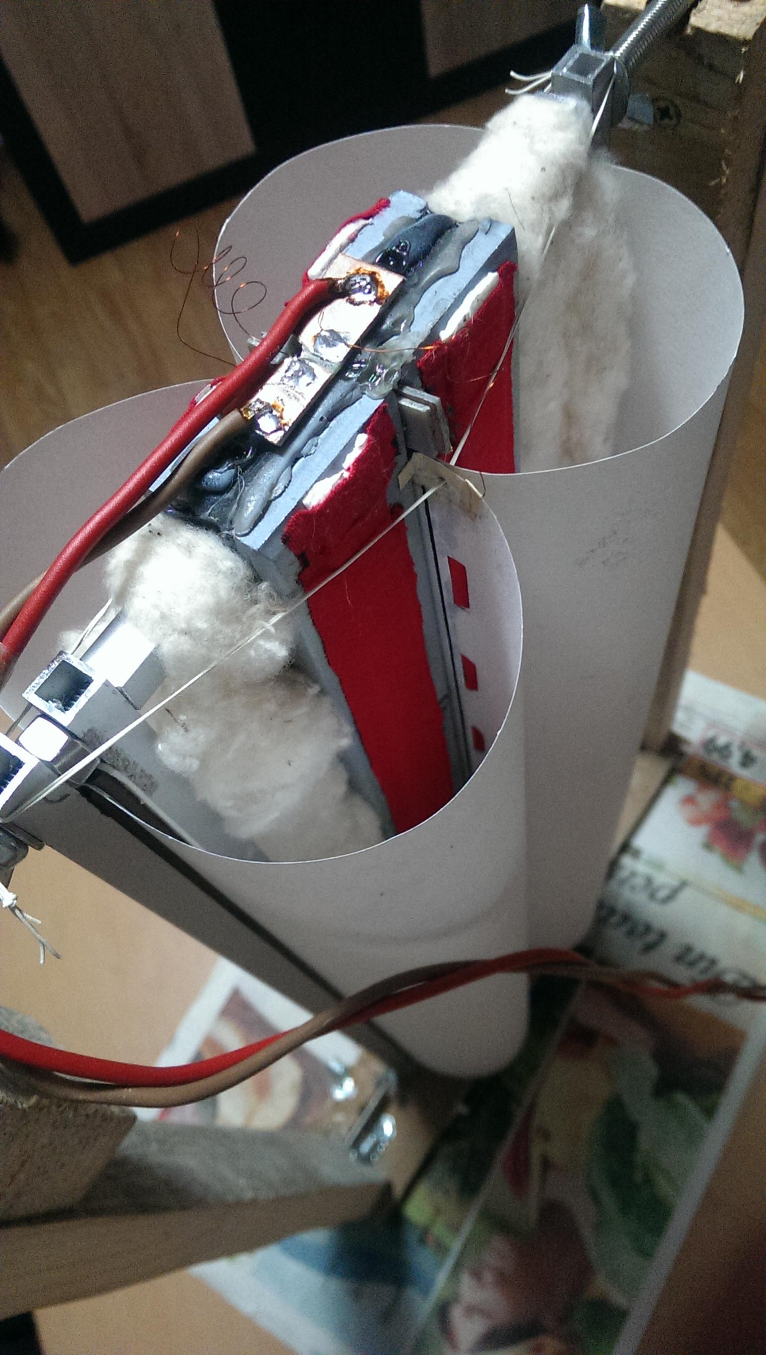

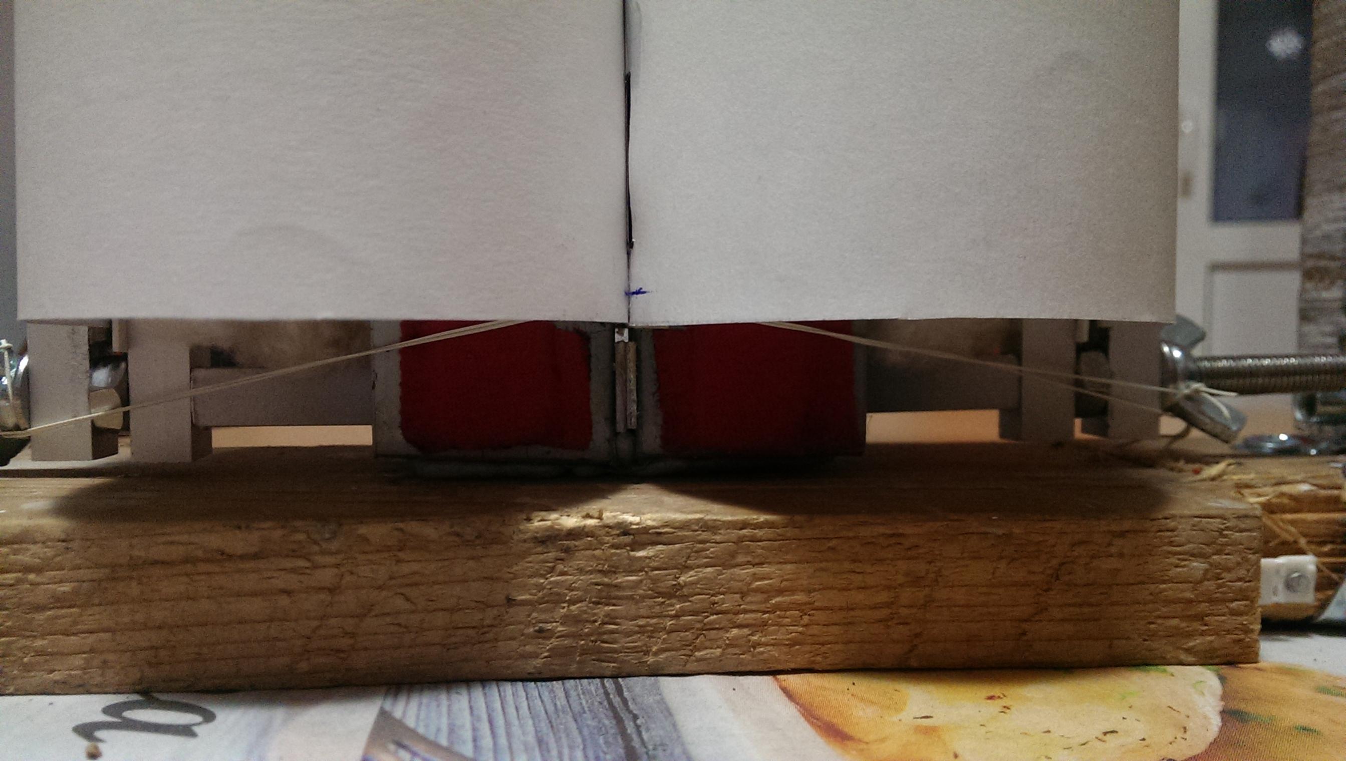

yesterday i build a mini version of the ruba, measuring 21 cm high, exact an A4 paper sheet. coil is around 3.4Ohm, DC. i used translucent transfer paper. 125grams. but it only reaches to 13Khz
When i remove the leftover paper on the backside that is only there to be able to use the rubber bands. it goes to 14khz-14.5khz. (i leave the top and bottom to still be able to use the rubber bands.)
Now it is clear for me why you dont reach highs. I think that at this point the patent is right: the hinges, at top and bottom are a must, because the coil is not stressed that much from the forces that creates the cilinders when bonded and keeped together in the gap, and moves more easily when you make cuts insyde the free space in the coil and in theyr lateralls, as this way we also reduce the coils mass.

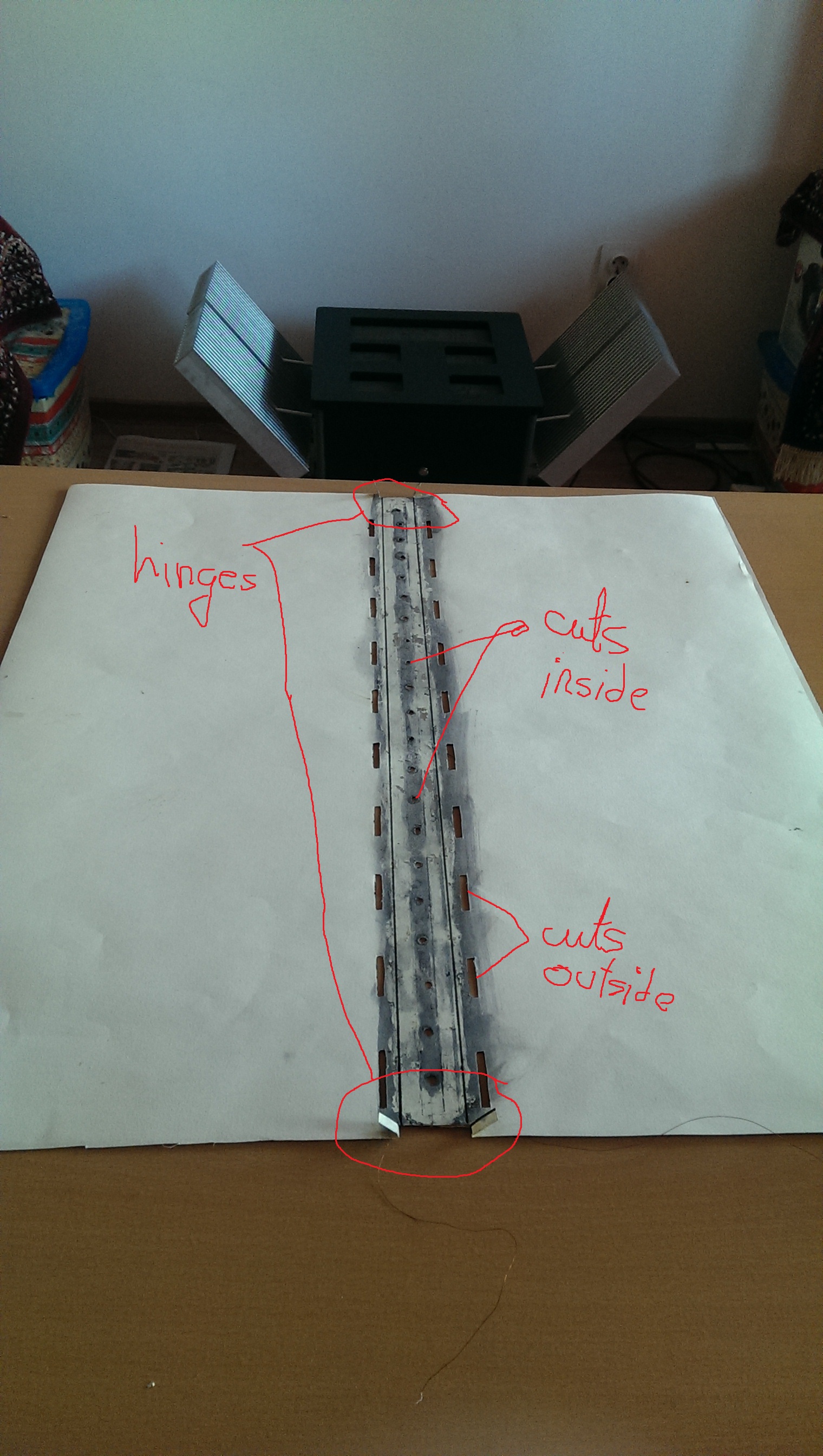

Be aware Wrine, the patent says, and the french guys from the other forum tested this: there can be cuts inside and outside of the coil but they percentage must be between 10 to 50% of the total mass of one sheet of paper (one cilinder-- and no more or less per cilinder) it has been tested that above 20% really has effects on the overall sound. I have now 23% removed now. It seems that the internall cuts lowers the internal mass this way improves the frecvency responce and the externall cuts somehow not only that lowers the coil mass but they also cuts or limits and improves the ruban frecvency response. Look at my pic bellow.
I'll tell you another aspect that i read not only from the patents, but also tested by the french guys, wich is the distance between the external cuts and the edges of the coil: it was found that 2 mm are optimum for getting best from both worlds (mids and hights), and there should be alligned with the hinges; and where the hinges are (top and bottom) there must be no paper at all on the 3cm width of the coil top and bottom (even one or two mm in plus are not good).
Another aspect that i want to ask from you Wrine: friday at the first listening tests that i conducted with my wife, i tryied to listen to the sound that is coming from inside the cilinders. To be honest i hoped to hear some hights from inside because i have seen in pics on the web that others reflect the sound thats coming from there twoo, BUT I COULDNT HERE A THING. My assumtion is that eyther the cilinders are well damped
(and there will be no sound) or there is no sound inside (or the sound coming from the inside the cilinder has lower dB than outside and its perceived as none) or my ear does not perceive them at all. Can you measure this aspect and please tell me what is the real truth?
Thanks in advance.
Cheers
Sergiu

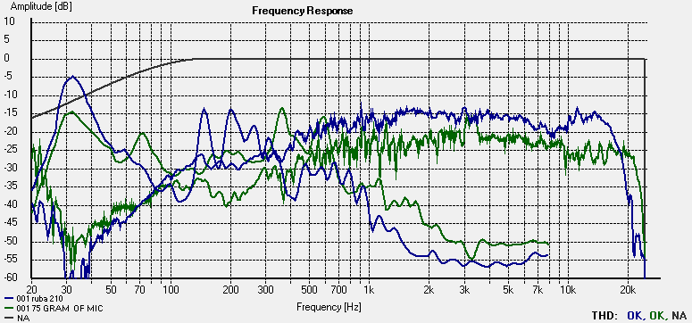

ok well you membrane is 225 grams m2, mine is 125 and also used 75 today. so cutting a few pieces near the coil as i already tried does not work(for me) i already cutted in te middle of the coil without any result. the lighter membrane does go a bit higher but what the biggest problem is , (and i again thought i give it another go) is the weird dispersion witch results in dips and peaks. the geometry of the transducer does not allow for a smooth top end.
let me try to explain. (my theorie)
you got 2 cylinders that produce a fullrange signal, but most of the high frequency's emit from center(or at least near the center) now the problem is that these 2 cylinders have an arc that measures around 2 cm from front to where both circles meet and is connected to the coil. when frequency of around 7.5 Khz are played you get a dip and a small peak. when you move your mic a little bit out of the center (so of axis) the frequency of the dip starts moving. its like having 2 tweeters at different distance getting the same signal. problem is at frequency with half the wavelength that is the same as the distance of these 2 tweeters there will be a dip since the wave is out of phase with one another. when you move the measuring mic only a few centimeters you get a complete different graph. with less of a dip or a dip at a different frequency.
when you would remove one of these cylinders at the front side the phase issues are still there be it far less. it also extends to 20khz. the low end will suffer though.
Blue = 2 circle (normal distance from front to where both circles meet, to the coil, approx 2.2 cm) witch comes close to the problem at 7.8 Khz
Green = Single circle measured at 45 degree since this is where the highs are correct , but normally there is another circle in the way.
It is annoying that these dips and peaks shift when you move your head. because in this way a simple dsp would not solve it, or only for one particular position. a lighter coil wont solve this problem either 🙁
I might try a far field measurement to see if the problem blends away 🙂 hopefully

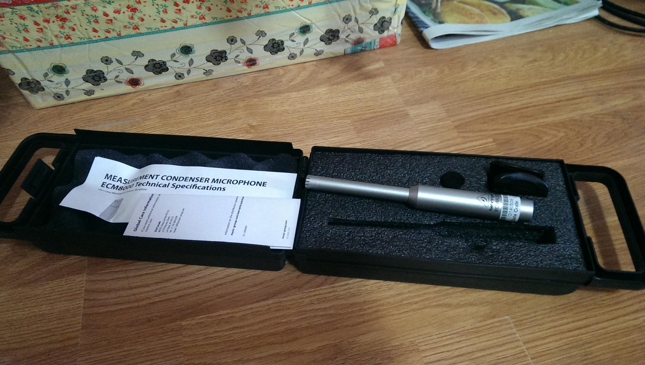

I cant wait for the mic to arrive today so that we can measure and compare. An interesting question is how do we measure it? What charts and conclusions should we take? It sounds really good but what influences what aspect?
On the french site those guys only measure the linearised frecv between 250 to 6khz to see how much dB it outputs and they say something about where should we put the mic to really measure it but i forgoted... I remember vague that you can only measure the spl from 1m but for all the frecv responce the "1meter" distance increses but i forgot about what is this distance and how to.. i have to reread all that thread but its on french and has almost 120 pages..🙁
Ps: Wrine i have buyed the Behringer mic. The umic was almost 120 euro and another 89 euro shipping......🙁
This behringer has only xlr conector. Do you know any adaptor to usb?

i doubt if it need any powering since its based on a panasonic capsule, if it does need phantom power you need some separate phantom power (48v) or a mic amplifier. with phantom, what does the brochure say ?
measurements would be usefull at 1 meter on axis, i understand why they dont measure the full spectrum since it is gone be shark teeth 🙁
yes you could measure a bit further away you will see the low end drop some more. but lets say at 3 meter you are measuring the rubanoide in the room. for quick stuf just to see what happens i measure more up close, you dont want to bother the neighbors with sweeps all day. then after fidling i measure it from a meter. i first put out a 1khz since and measure on my multimeter to 2.85 volt as a reference. i dont have a dB meter so real life dB is unknown for me. even if the mic is calibrated it is all about the rest of the settings in the chain.

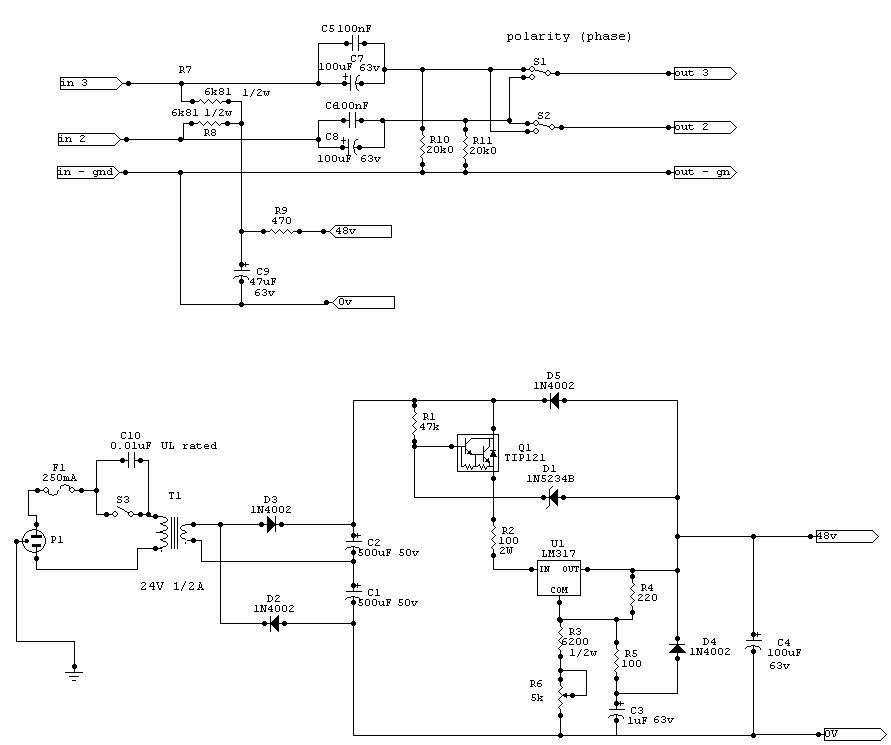

It seems that i need a phantom supply here. Do you know any cheap solution to use something else (not phantom) and conect it somehow to a mic input plug from a pc?
hmm no not really, best way is using for instance a cheap pre amp. or using something like an digidesign Mbox 1 or 2. i bought an mbox 2 for 30 euro, im not sure yet how they measure, but it is easy to check with a foldback loop. thats why i told you about the umik it has a preamp build in hence it is calibrated to that pre amp. if i remember correct i only payed 100 euro including shipping. there is a german company that sells them to, might be way cheaper then sending it from US.
Thanks Wrine. What do you say about this one. I can do a cap multiplier from esp eliot sound (instead of the regulated shunt) because its very simple and plug the whole thing into the mic input in pc. What do you say?
Cheers
Sergiu
well i am not really into electronics 🙁 as long as you get 48 volt if it uses phantom power. be sure to check the pins before screwing the mic up. and be sure you have to use phantom. 🙂 looking forward to some measurements. to see if i am completely mental or just being a purist on the freq response 🙂 if the last is true i am happy to be so 🙂. just curious about your results feeling lonely in this topic(as of now) feed me some information 🙂
i bet there is a complete schematic on phantom power on google. i am sure!

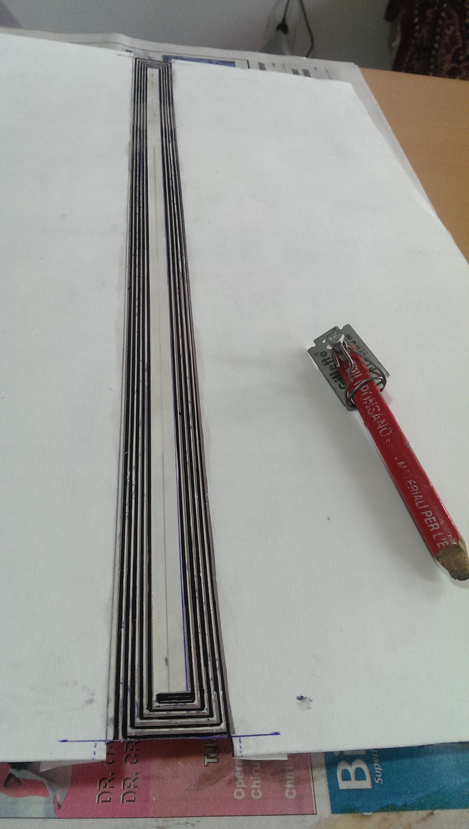

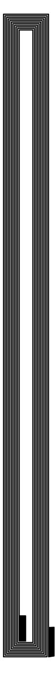

well the reason why people dont come back on it is usually an indication of, they dont give a poo 🙂 witch is ok of course. or they dont like sharing 🙂 i love sharing 🙂 mostly my misfortunes but hell its something 😉
About your findings it is quite hard to understand where you had glue and where you did not. here i got a picture of a coil could you play in paint and let us know what you did in 1st and second ? just crude paintbrush 🙂
Btw i thought of a remedy for the soldering question if i really want to use a aluminium coil (and i think the end coil should be aluminum) use thick thick aluminium tape of around 100mm wide or wider if possble. and print the coil and its leads that you can stuck onto the cylinders. the leads will end up near where the cylinder is fastened, from there it is easy to press fit copper on it or use a clamp. this was there is no resonance from the lead wires and you got a complete alumnium coil without a crappy joint inside the paper 🙂 although i like the chemical tinning idear better 🙂 but that should be tested and i ran out of money to spend on these kind of ideas 🙂
when rethinking for your massive version its not an option since its bigger then an A4 paper. for mine it is plausible, tinning the coil is still al option for yours. it also helps prevent corrosion(aluminium does corrode away)

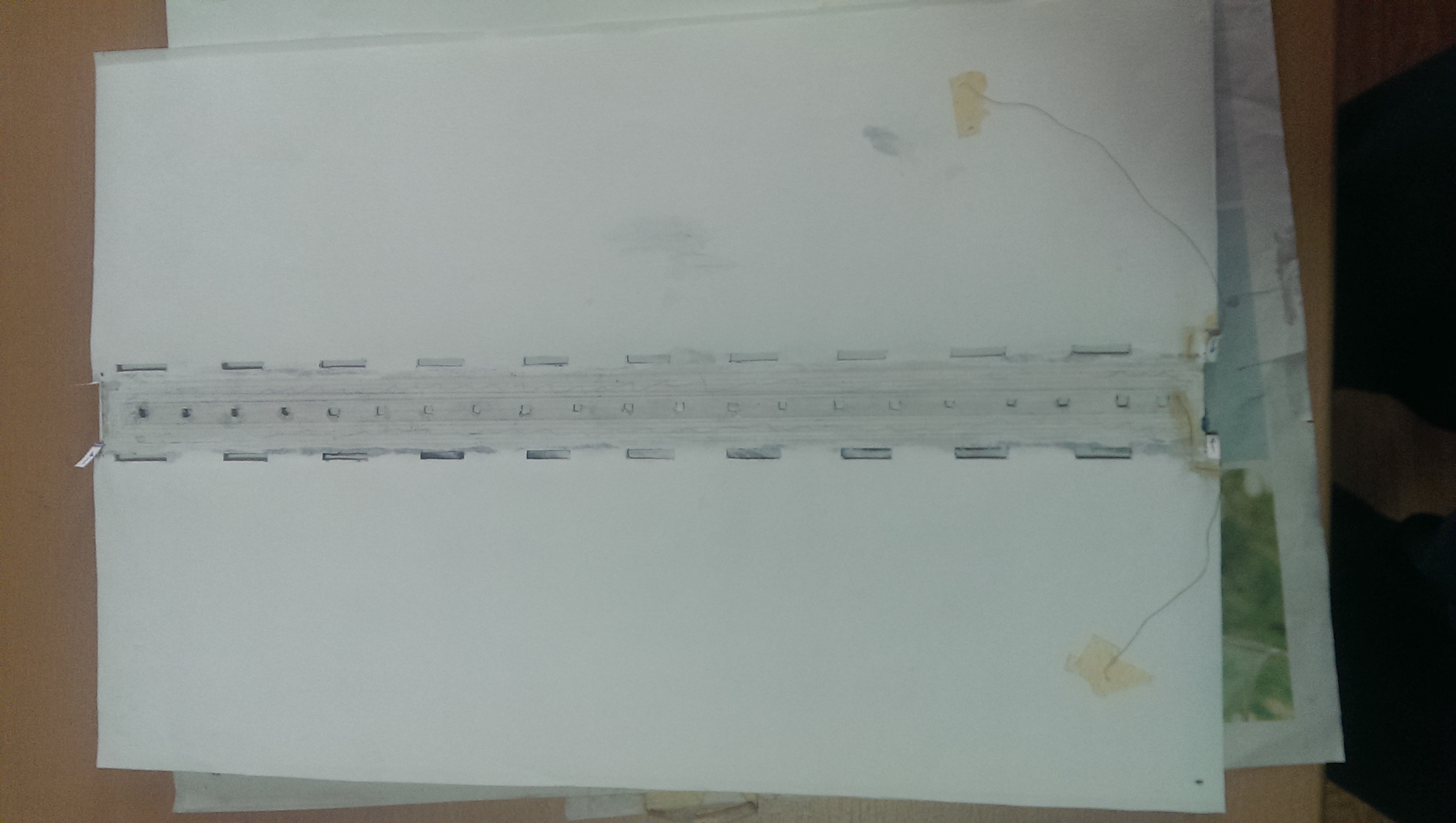

Hi Wrine here is what i finished and listened to all day. In the next post i will show you exactly on one of the first ruban cilinder how i sticked the coil.
I closed the pc my friend so i cannot draw, because of the lousy 7 vents of 120 mm wich i hate. I think that my next pc will be for shure all passive. I dont mind lower performance...
Anyway, enought of the pc. Here it is. This time it really pissed me off, this ruban had perfectly centered coil and exactly 4,5 cm half diam hight each cilinder. Nothing rubs whatsoever, and the cilinders are perfectly alligned, the coil is just perfect, no cuts no patches or stiches only the super glue trycked me...
Here it is.

looking good !, one thing the hinges. i really have no clue what they would do what the string could not? the hinges in the patent are for a tweeter. and are clearly there for production purposes. at least i believe. have you ever tried holding the coil with your hands? the high frequency wont change, only the lower if you really force it to stay in the same position. in the tweeter design they just glue those hinges to the structure, no rubber bands needed. it saves money. fiddling around with the bands 🙂
my speaker have sometimes a excusrion of 1 -3 mm playing fullrange, the hinges would not allow this.
