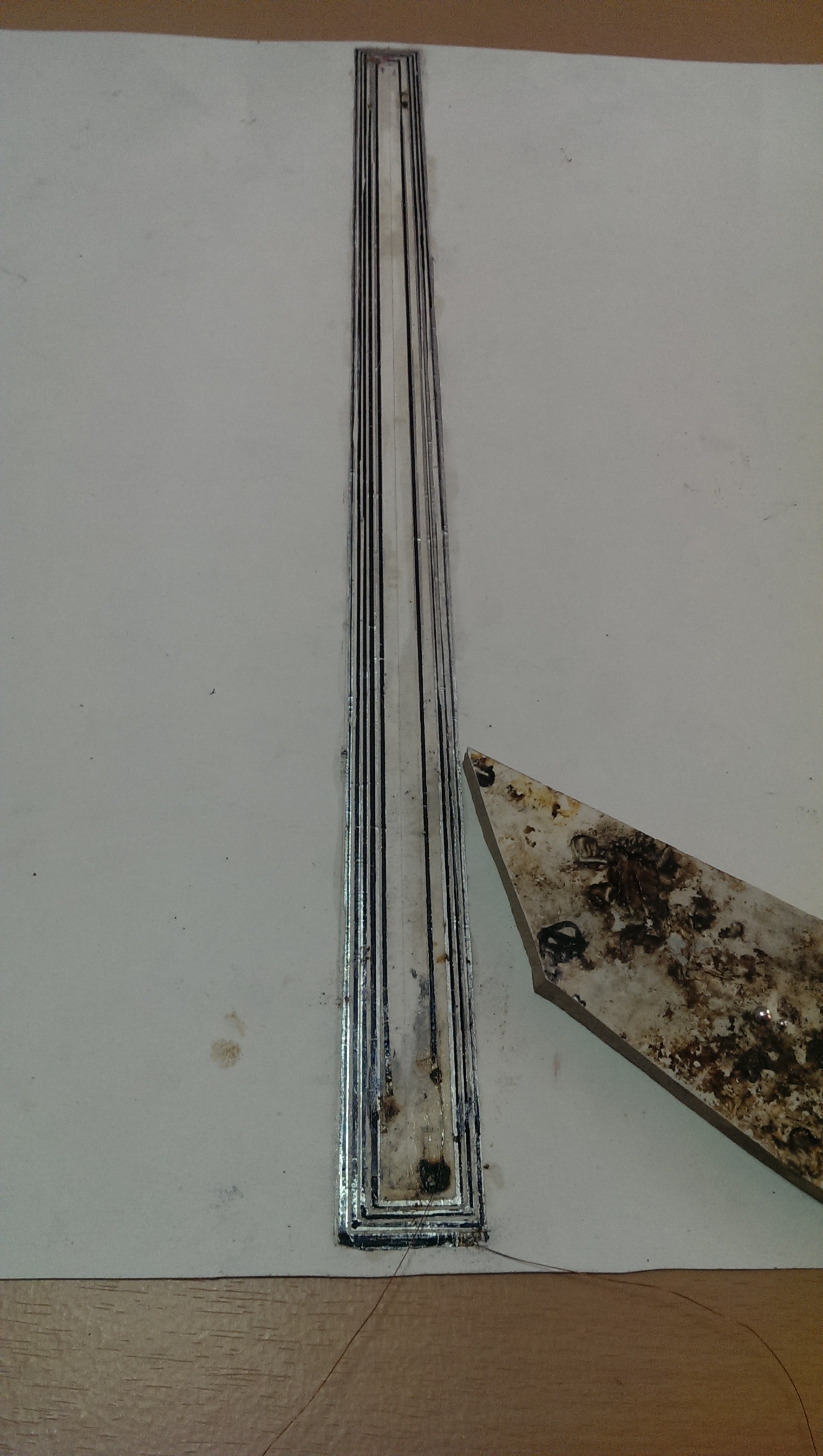

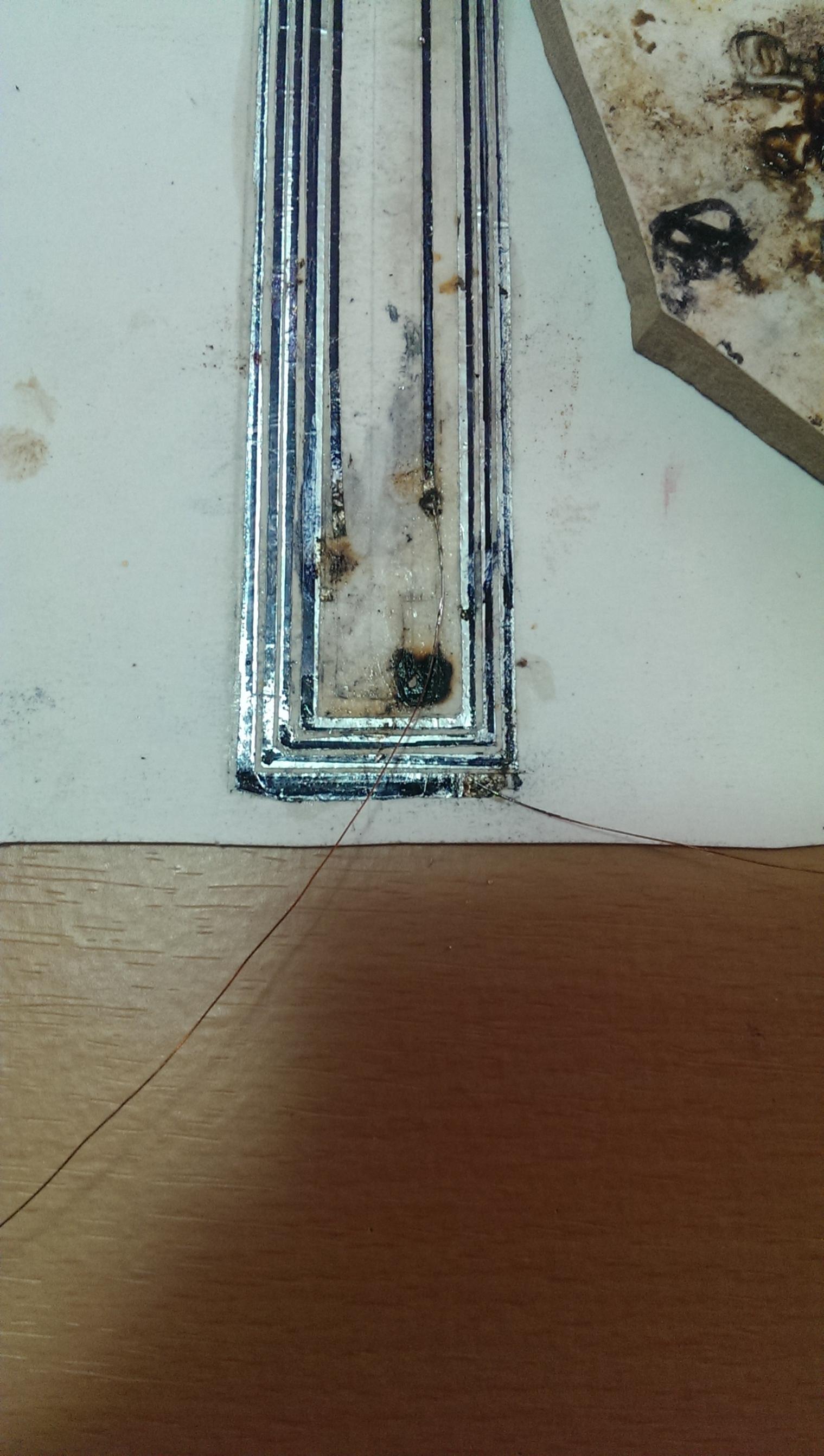

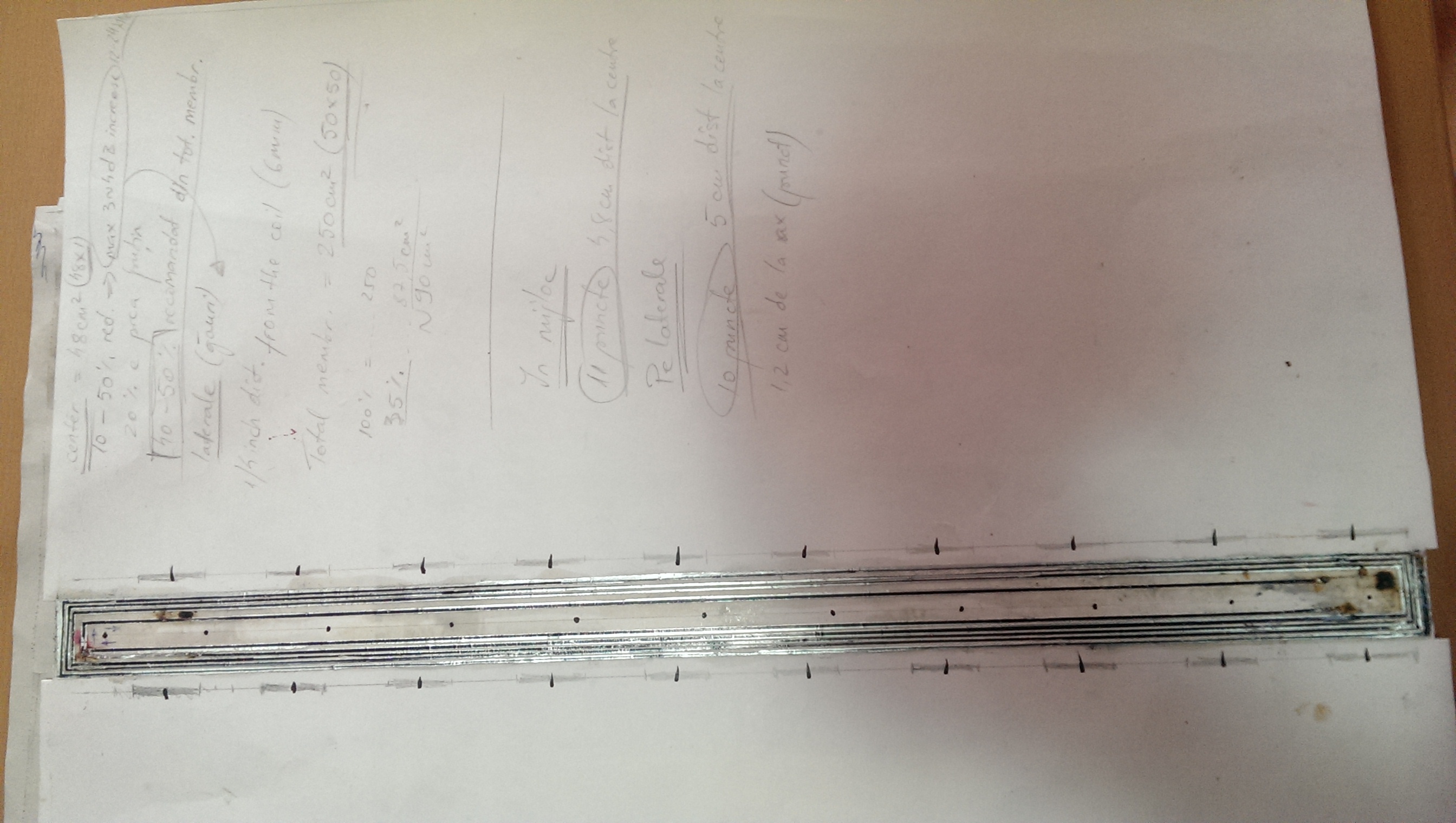

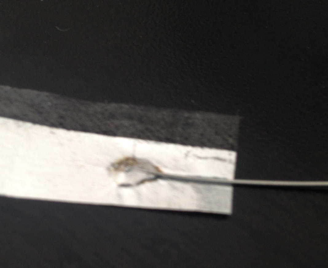

Ps: today i managed to solder the stupid Al coil. Bellow are some pics... You can see that i almost ruined it.
If you use the flux and soldertin I linked to you can make nice solderings.
A vary thin coating of flux on the aluminum and soldertin on the tip of the iron.
I unsoldered the wires from the coil to make the cuts.

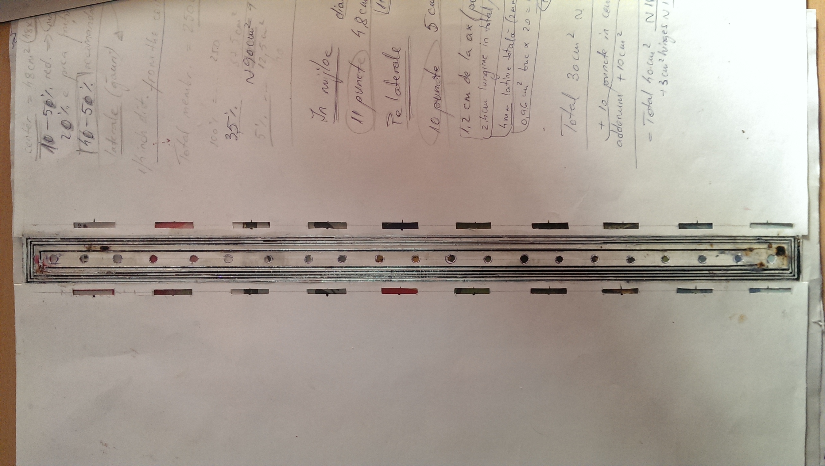

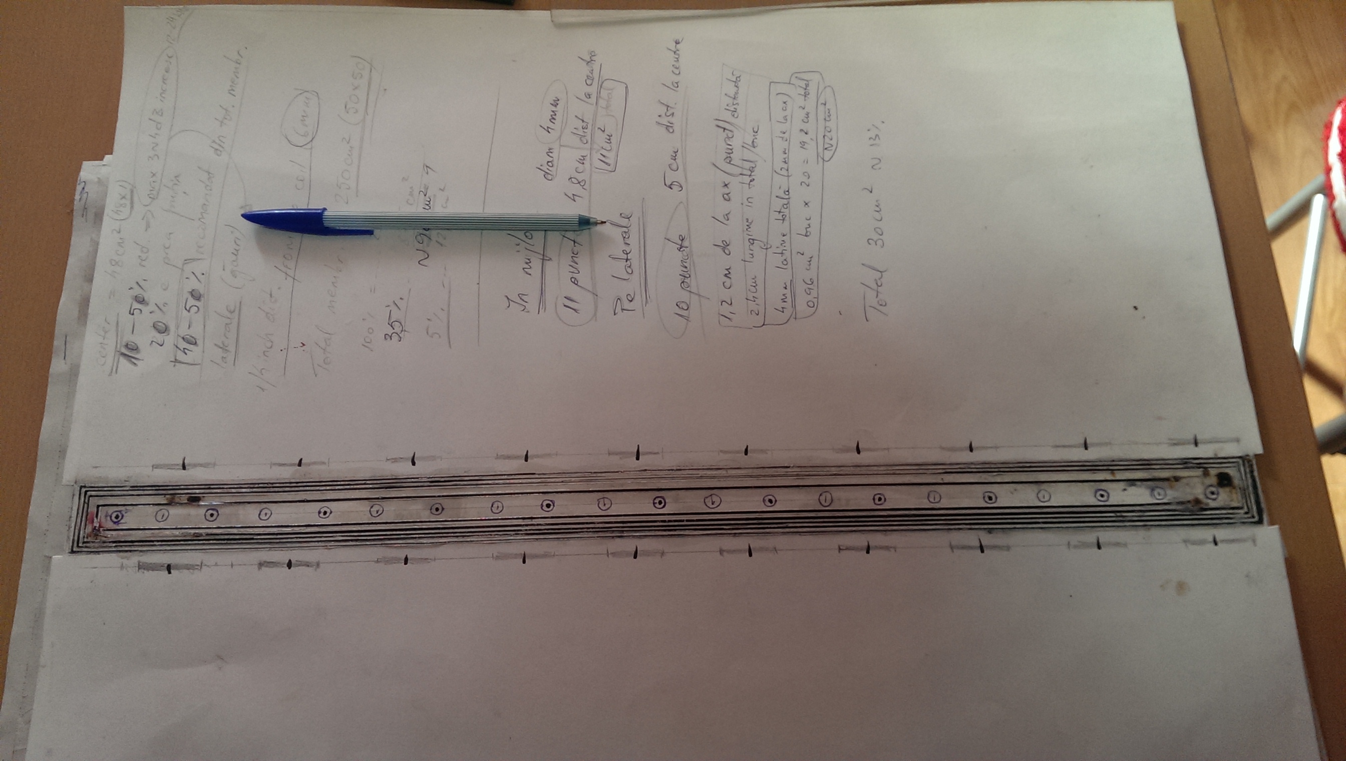

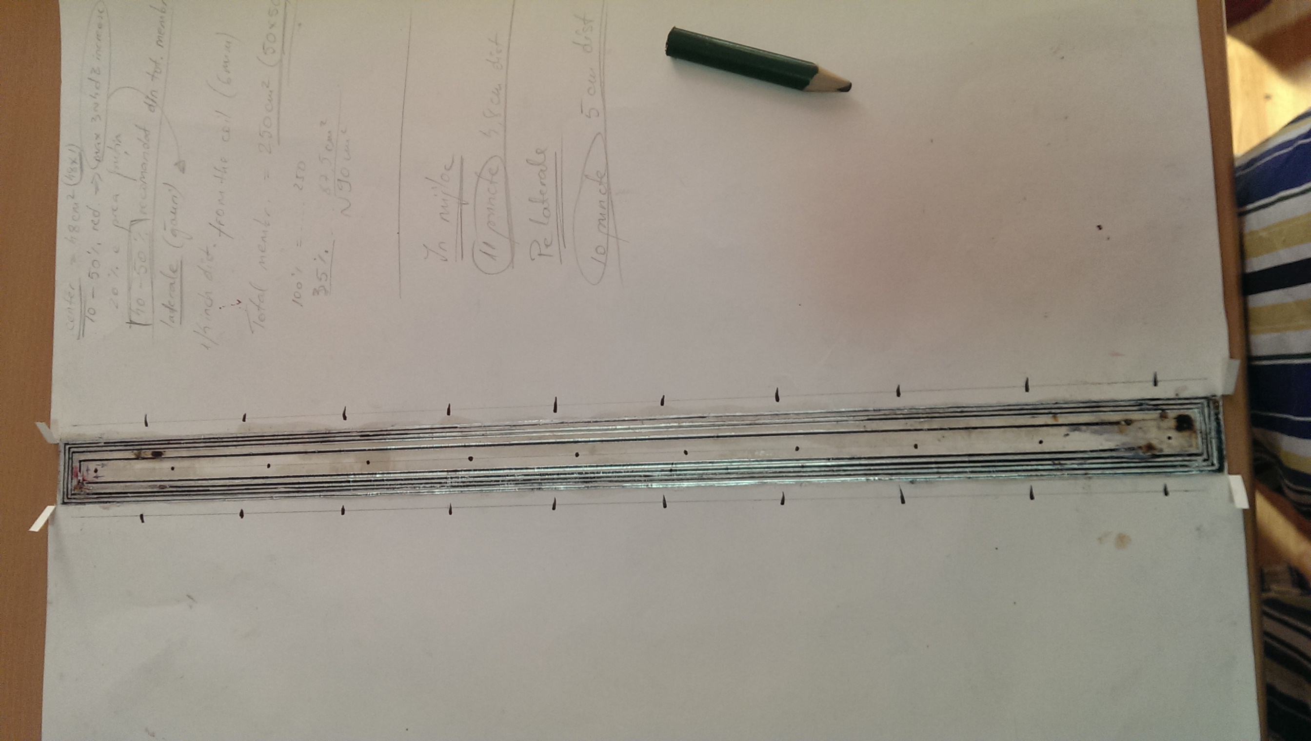

So here we are. Summing aprox 17~18 % of the total membrane surface. Now i have to cut the other half an the bond them together. I also aded hinges, and alligned all the cuts with them.
These cuts lowered the center mass and are calculated at precise locations as the patents says..
As the Lineaum patents says, from they're tests i should gain aprox 3 to 4dB in the upper register 12 to 24khz (to 20khz in my case i hope), dampen some spikes and extend the hights further.
I dont have a mic yet but so i think i will compare them with my 91dB 19khz tweeters from my closed bafle speakers that i have.

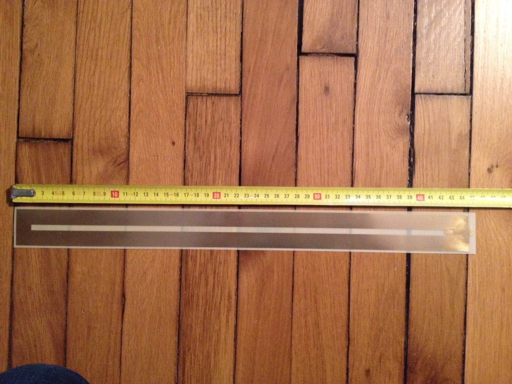

Hi all,
I have some VC if some of you are interested let me know.
nice one whats the trace thickness total resistance and the space distance if i may ask? looks like a prety amount of turns.
did you also etched them yourself?
they look nice

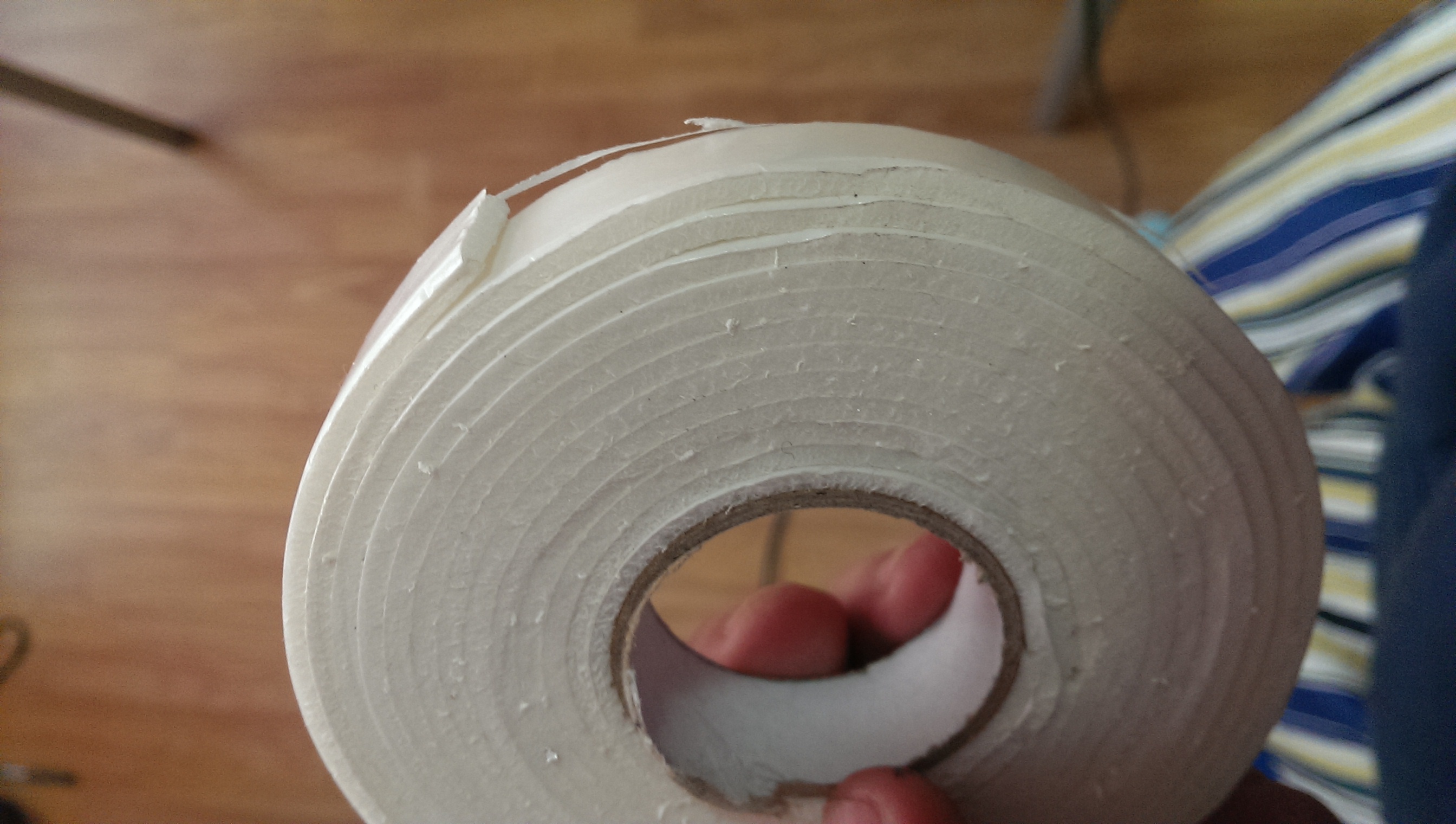

Does the foam look like the double adhesive type atached bellow?
Does it have copper on it? How will you etch it?
Hi all,
Hi Ondesx,
That looks pretty impressive. Can you give some dimensions, impedance? Do you have double sided flexible pcbs?
Thanks in advance.

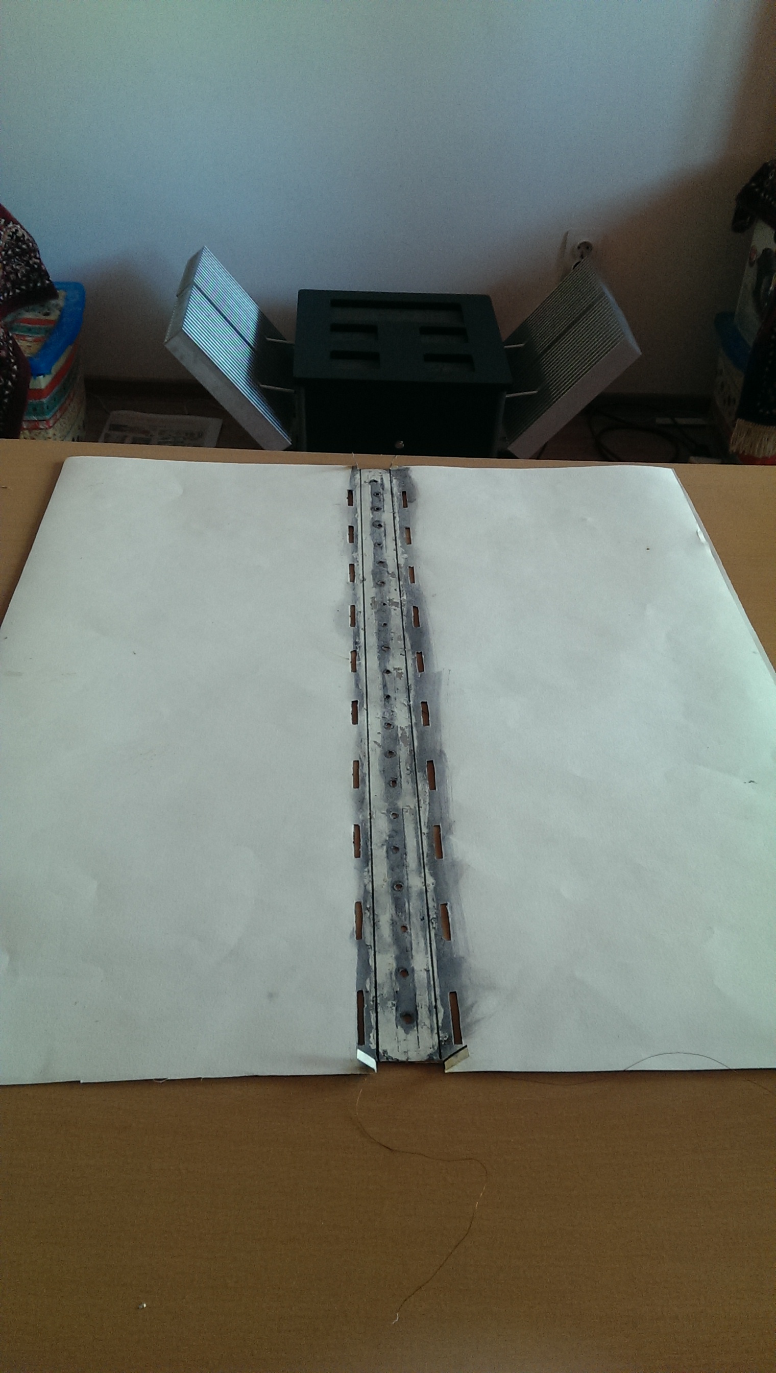

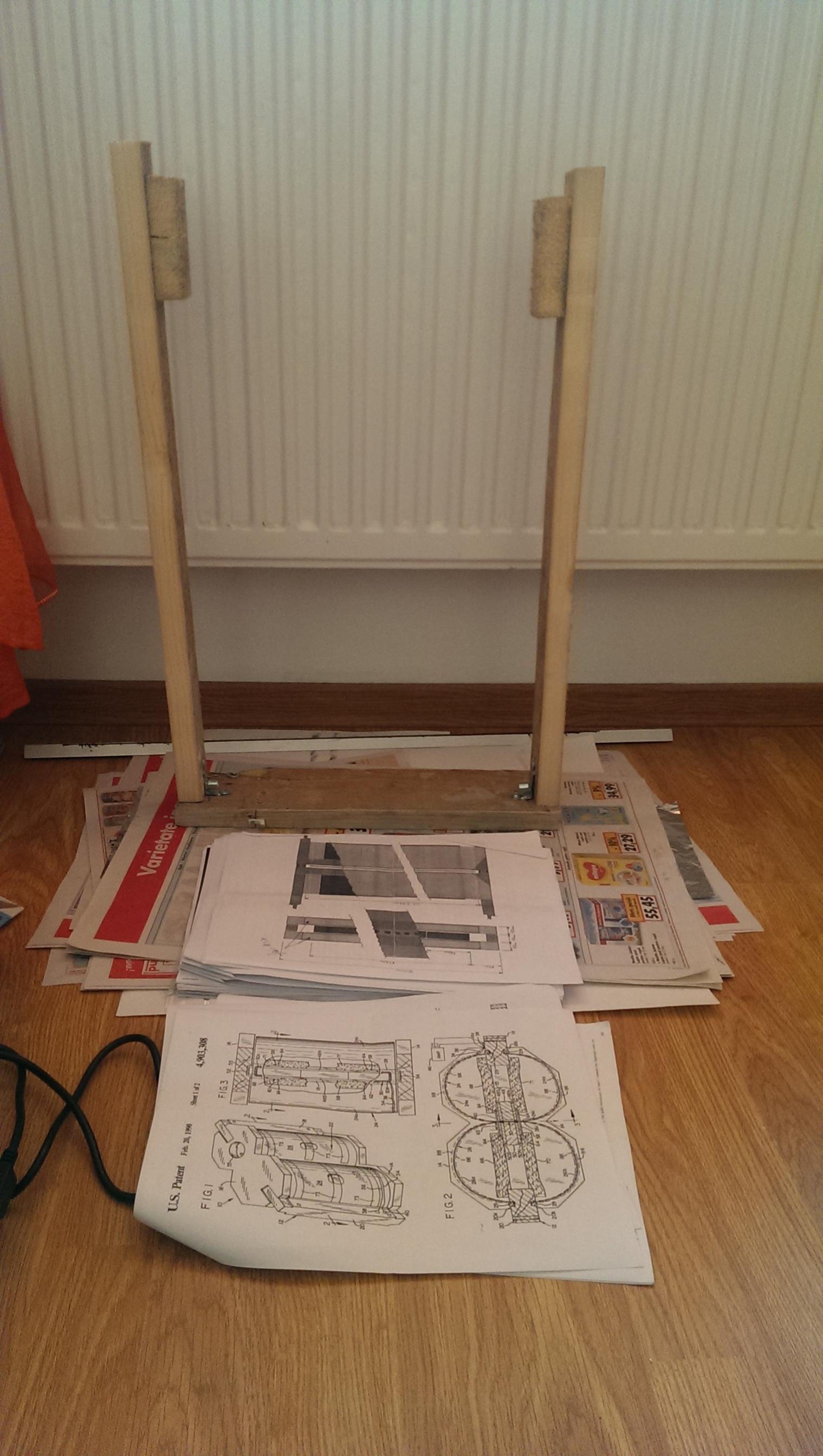

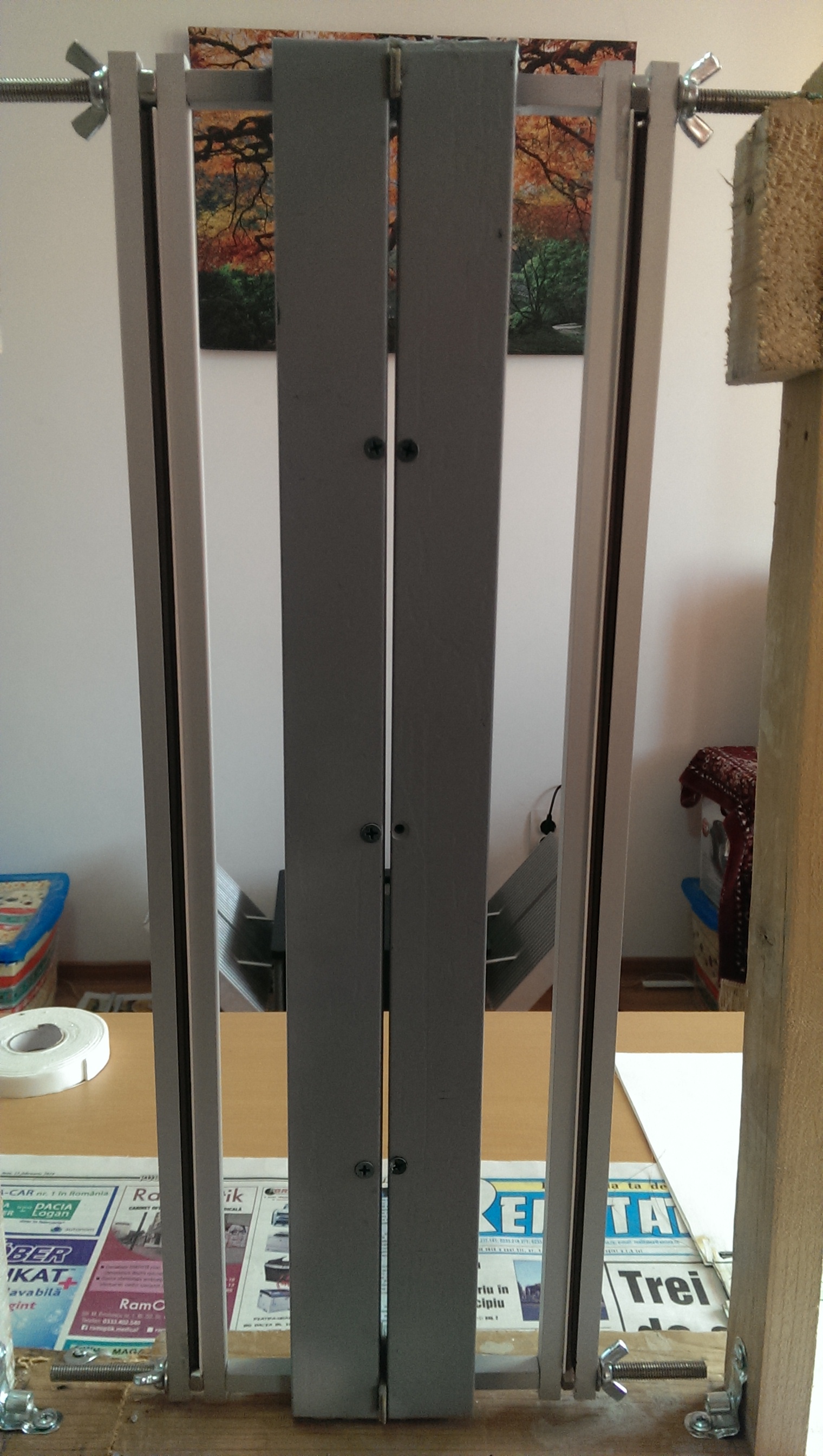

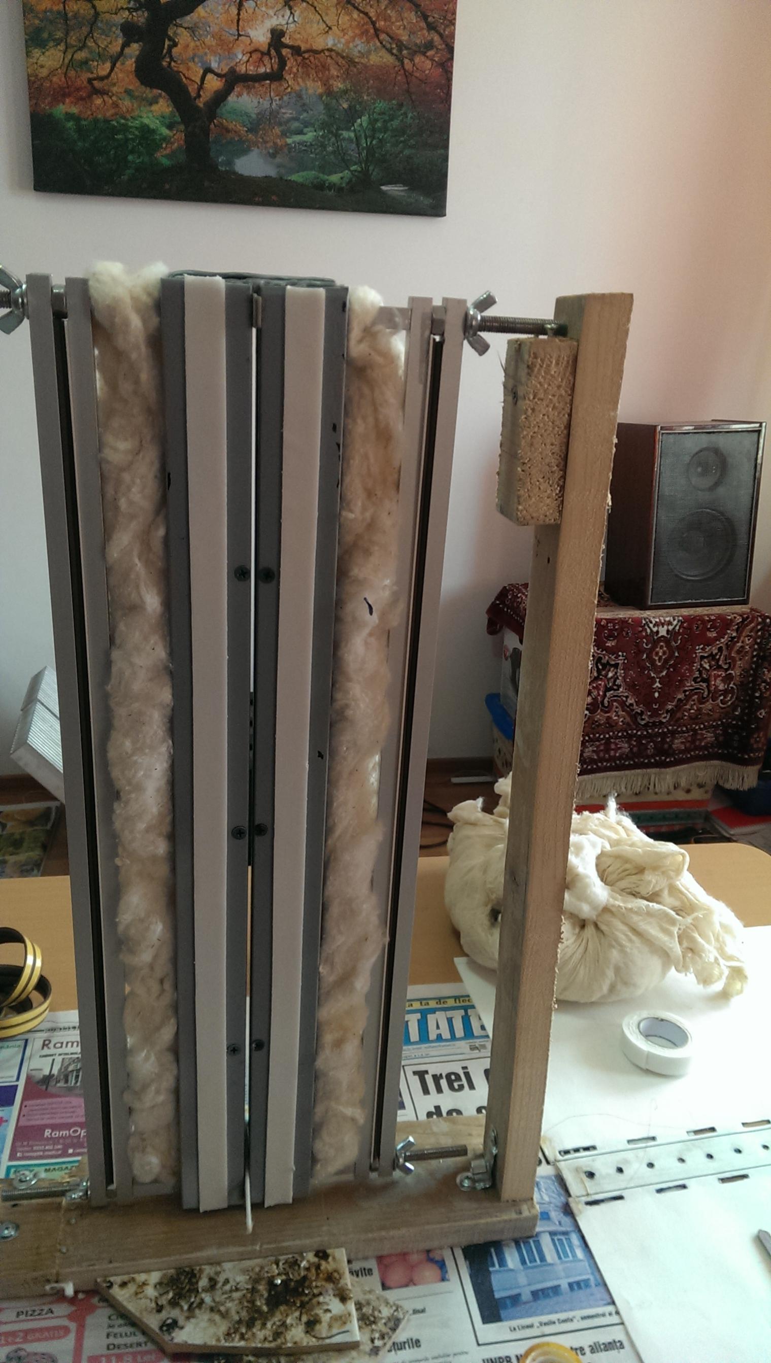

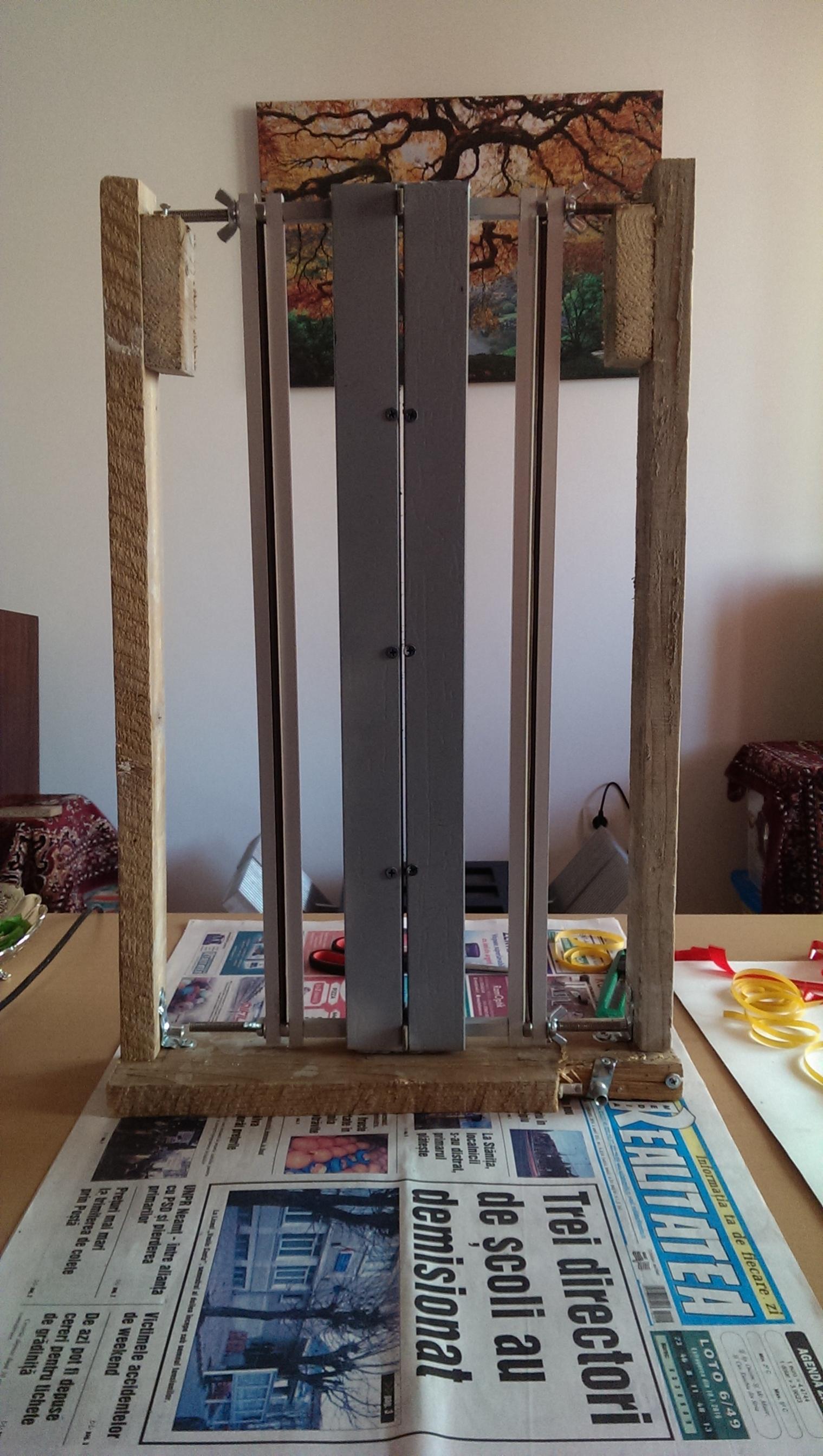

Well, yesterday i waited for the glue to dry, made a frame and today i'm preparing the final assembly. Here is some work in progress. I have only to add some internall damping and then the membrane.
Note: you can observe from the pics that the quality of the paper used is not so good and the frame looks fragile. It is so because this is only for tests. I have the rest of aprox 15meters of 120g/sqm canson paper in good condition in the closet and will make better frame for the finall version.

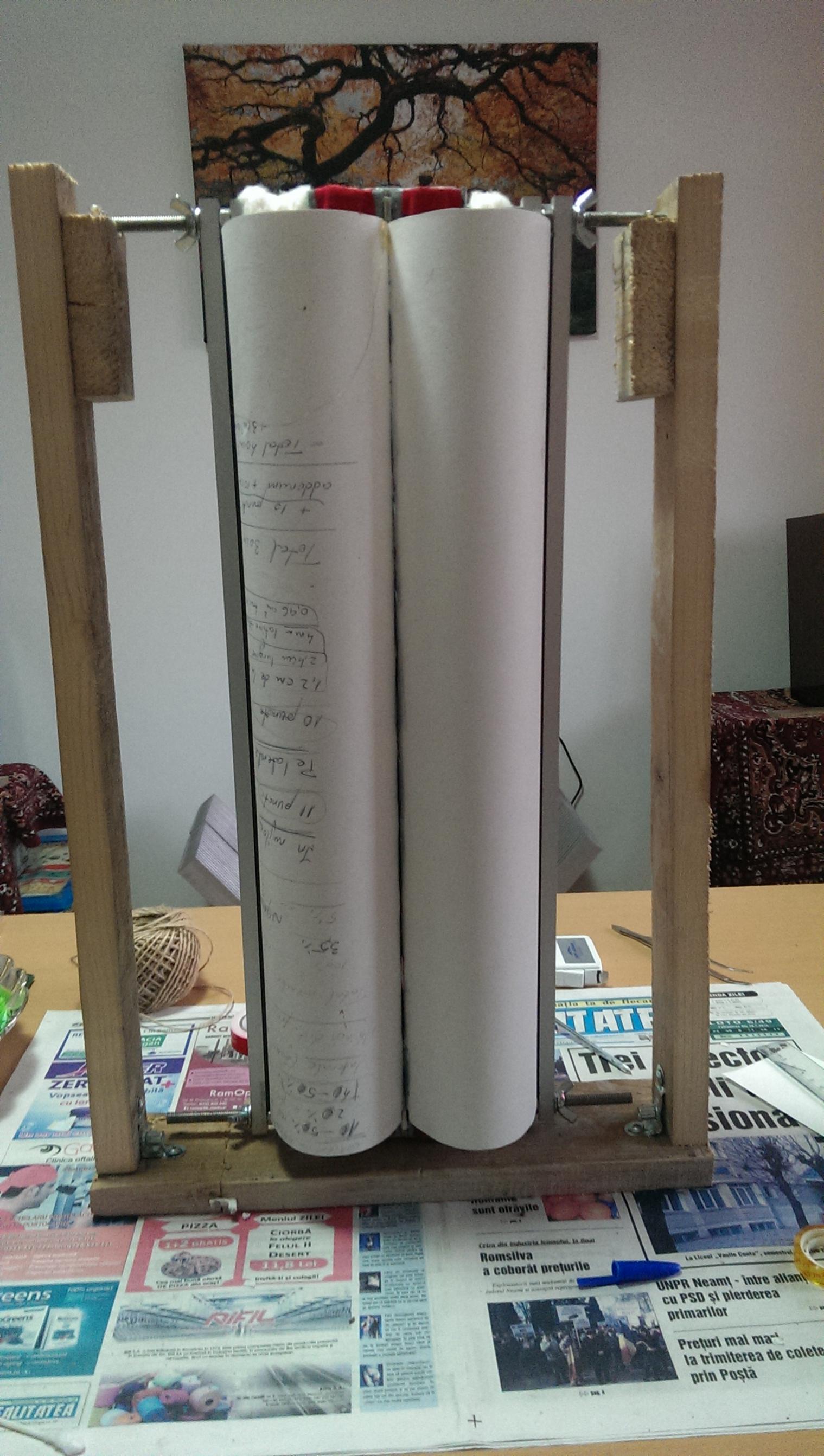

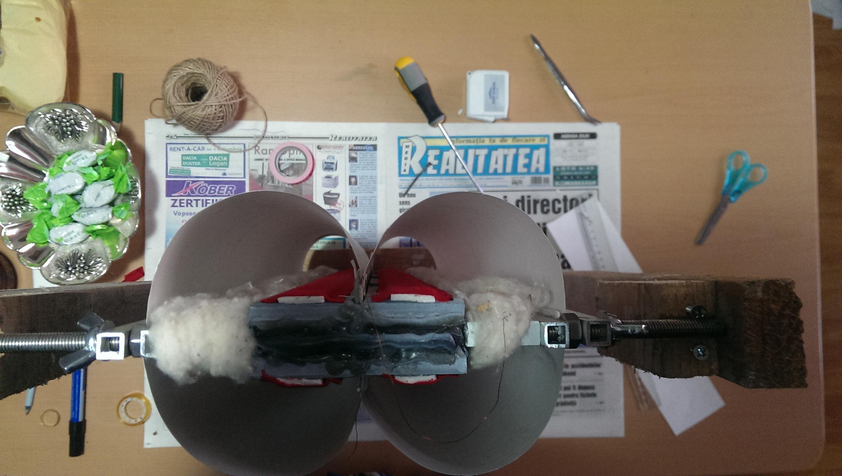

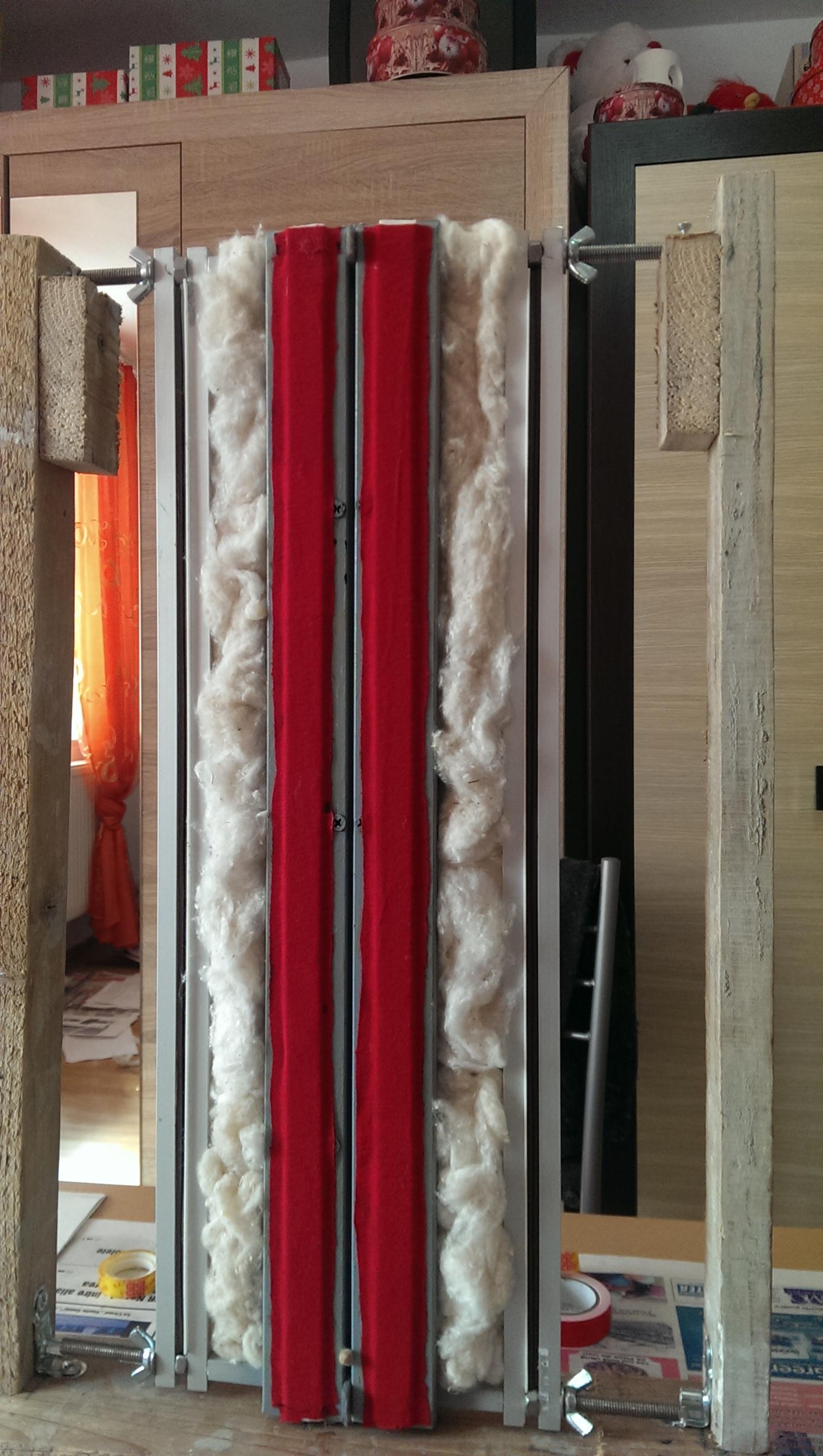

Well i just finished the internal dampening for just one speaker... It tooked me some time because needed some slim and fine 100%cotton material for the metal plates. Fortunate for me i found a nice red 100% cotton Tshirt of my wife (unfortunate for her!!)..) This is original diy, right here. Hope she will not be mad on me. I hope i will finish in time till she comes home.

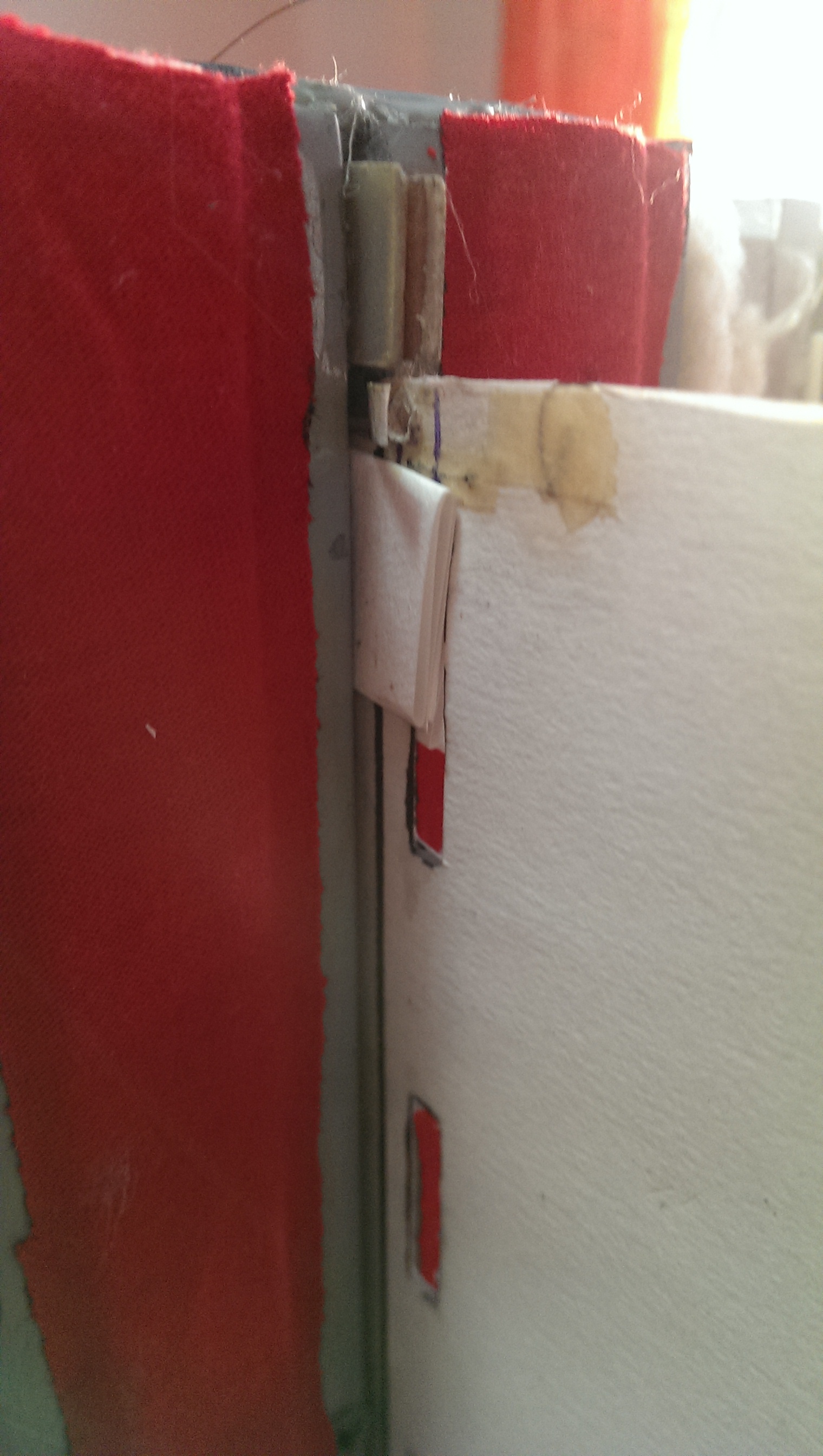

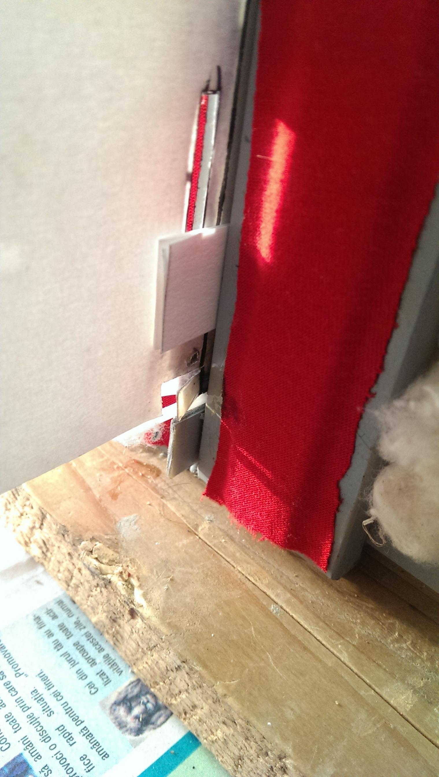

Centering the coil:
As Lineaum ssid in theyr patents, the hinges for lowering the center mass also helps you allign the membrane and the coil in the gap. The hinges will keep the coil in the gap and the membrane will not depend 100% in the elastics. The elastics will just keep the membrane suspended without interfering too much with the coil in the gap. The adenum of the hinges also helps reducing the overall distorsion, improve the frecv response and add some gain (thats what the patent sais).Peace of cake. Draw some verical lignes (1mm from the edge of the coil, to outside) as you see in my pics from bottom to top, this will help when centering the coil in a maner that you will see when its in the gap or out.
First step is to add the plastic stick (these are plastic sticks wich you use to clean your ears from wax) at the boton of the membrane. Second add the wraped paper "like nails" as you see in my pics, then center the membrane, and look at the vertical lines that i told you earlier to keep the coil in the gap, then glue the hinges, then stick them to the metal plates.
From the pics bellow you can see clearly the "circle" cilinder shape from the top that i was talking about in the earlier post.
In the other pics you can see how the paper from the membranes is hold toghether and alligned.
