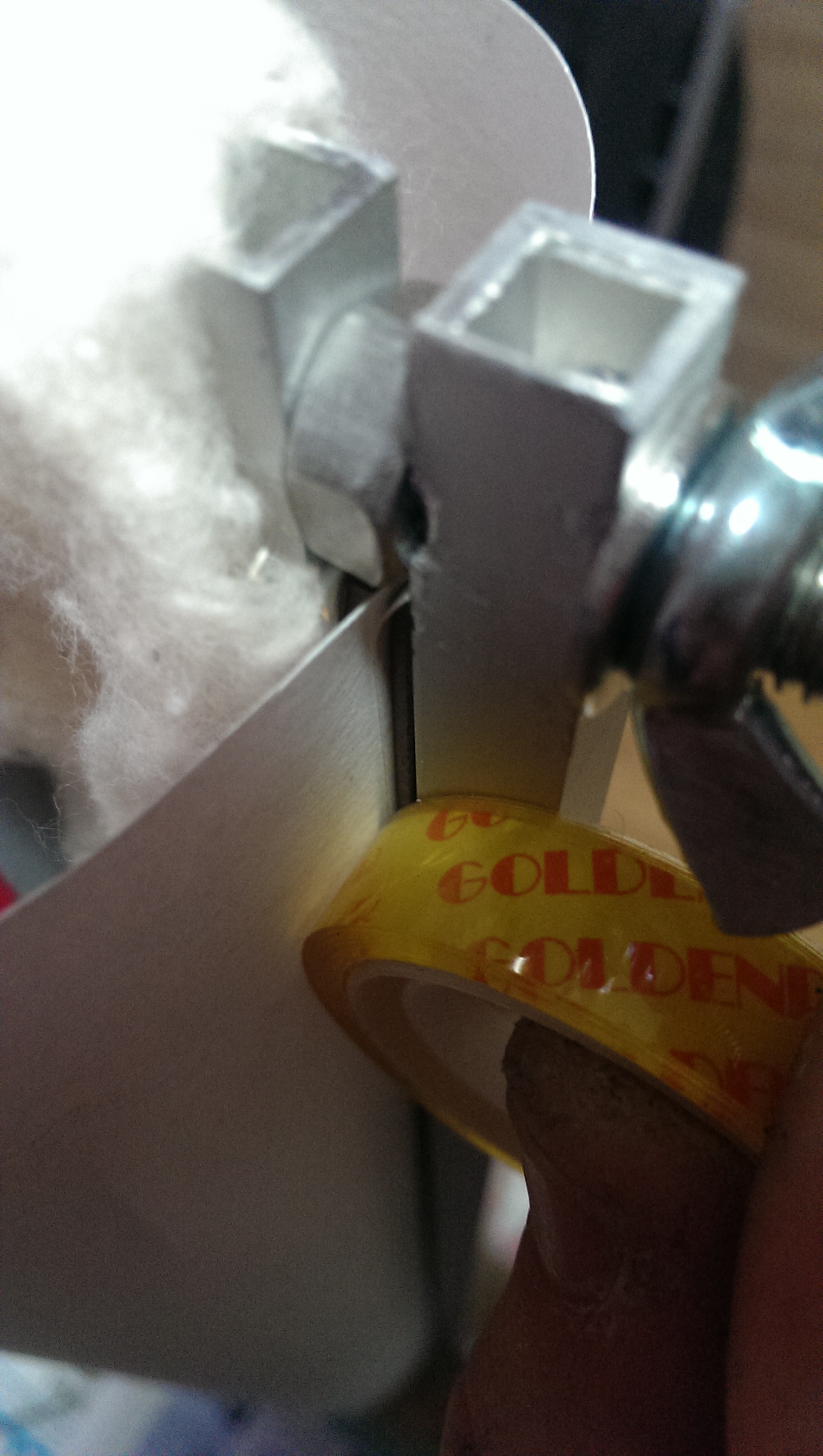

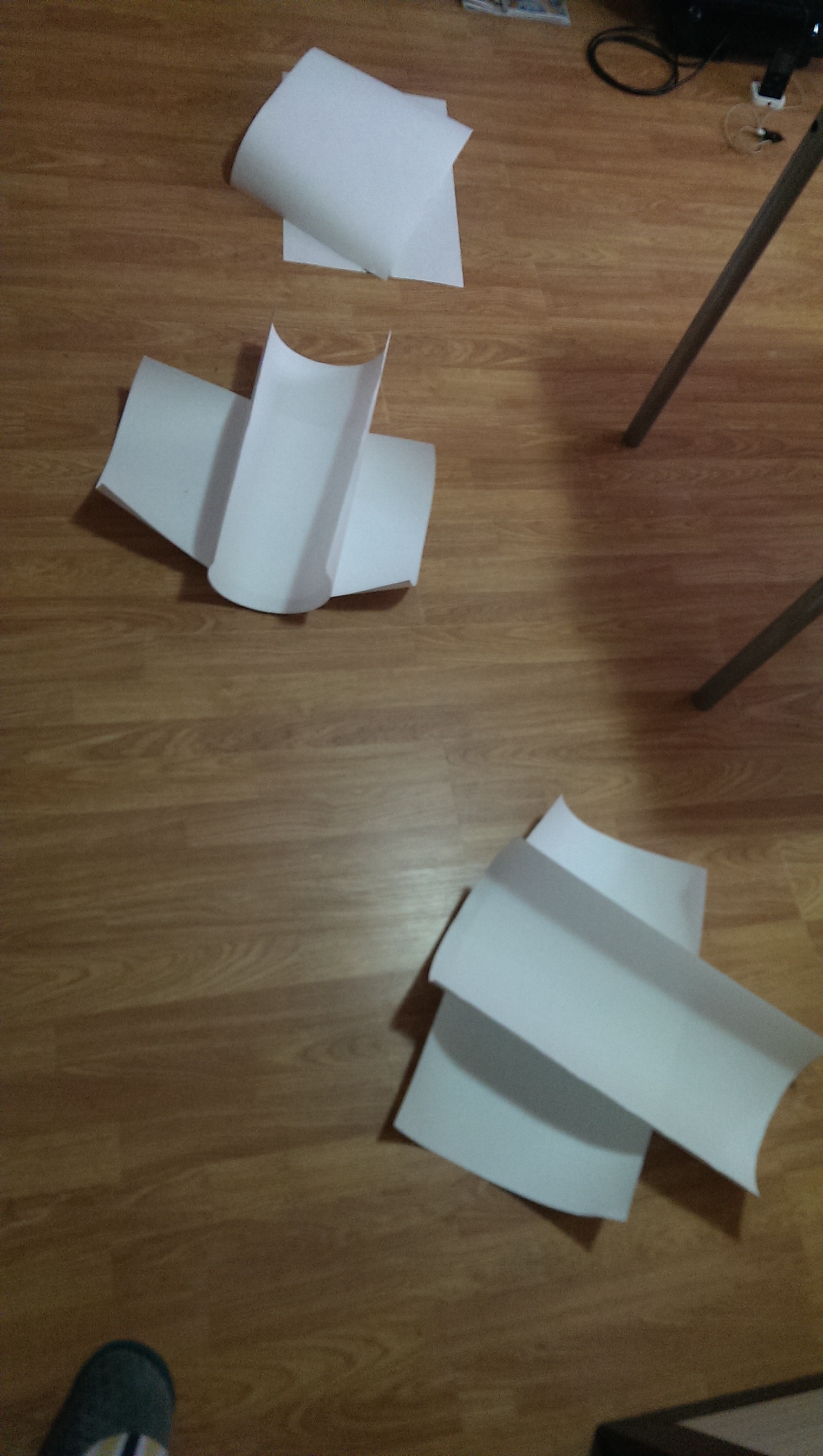

Next step is the elastics wich i wont tell about because is too easy.. I am serious. When you are at the step that i told you about it will be peace of cake. After puting the elastics and tension them right then you can unbolt the membrane from the paper "nails" that i told you earlier. It is very important to allign the coil into the gap perfectly or elese it will distort. But if you follow these steps you will be fine.
Bellow i will atach another pic so you will see how i allign the edge of the paper to the aluminium square bar.

nice making some progress. i found out it actually does not change when you tighten the rubber bands. at all! you can do as you please and the measurement wont be different. dont forget that allot of the stuff in the patents are not all true :0 since noone tested it but it sets them asside from another patent.
Yes my friend, the thing with the elastics is just what i discovered today. The actual thing it that they should be tensed well (not too hard because it could break the paper) because the membrane of my speaker moved more than 2 mm before it breaked down half an hour ago... If the elastics woldnt be tensed well the speaker would have blown from the start.

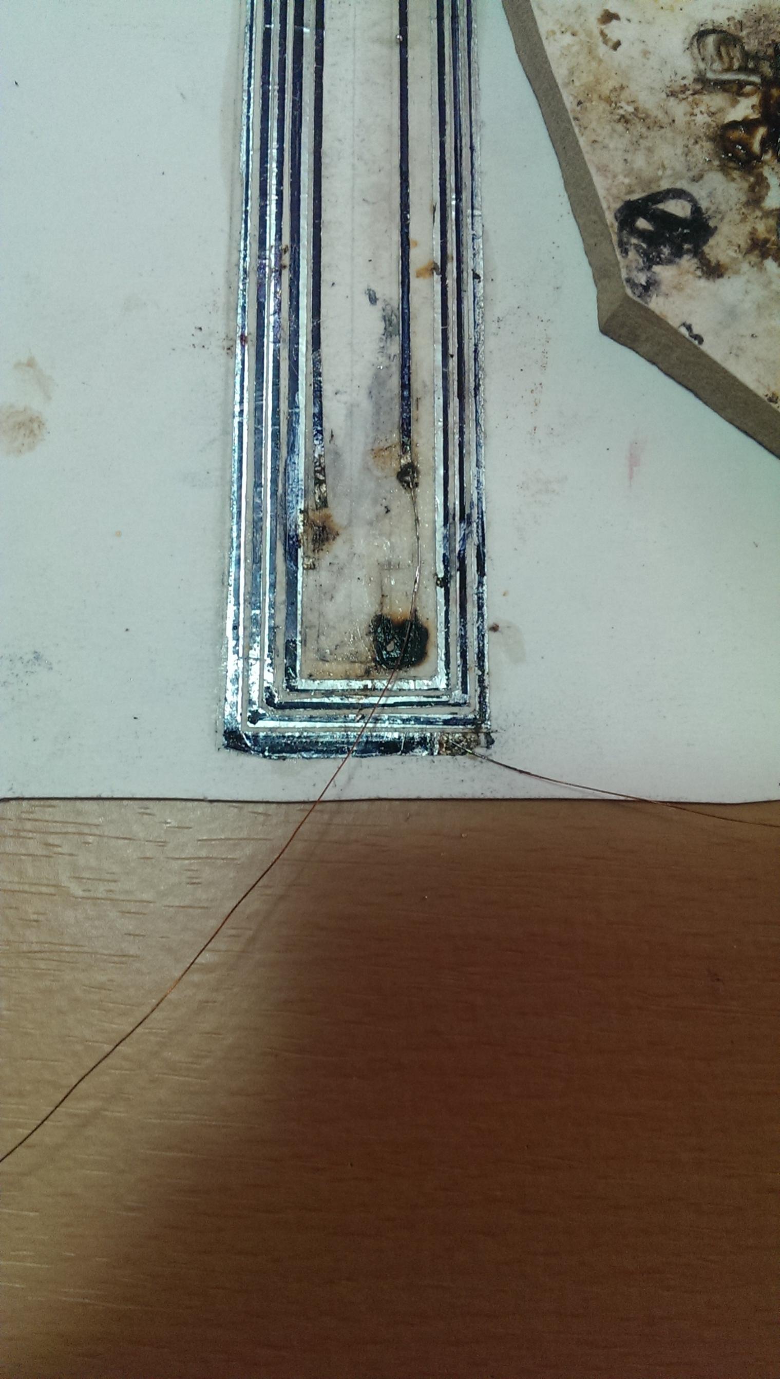

wel nice you enjoyed them , what crossover did you use ?
since they cant withstand fullrange. btw the coil looks liked you abused it pretty hard.
i must say get a UMIK mic since we are comparing apples with peers when we cant measure anything. especially with the 18Khz claim. very often highs are prominent but not so much the extends. so you might hear a huge peak in the 15 Khz range. maybe i am wrong but just saying. also these speaker usually have a way higher efficiency at 800-14000 Hz etc. so measurements are needed but im glad you got it working although being it for a short time but it is fun to hear a contraption after so much work.
i dont want wreck a beautiful evening. but when you measure you will see you have some issues in the resonance departement. distortion will be high in these places, and not always can be heard on normal music tracks. i tried all the cuts mentioned in all these patents, and for me they did not do much, so i would really like to see they do work in your setup
Wrine, i must admit that this was a very interesting experience.. The wrecked coil is what i used from the start, who knows how it looks now because i havent opened it yet. Even if i coudnt hear/measure any peaks (even with stressing piano sounds) the beast sounded darn good. It really impressed me. I didnt use any filter thats why i think i fryed it..

Today i want to see the burned coils real shape.

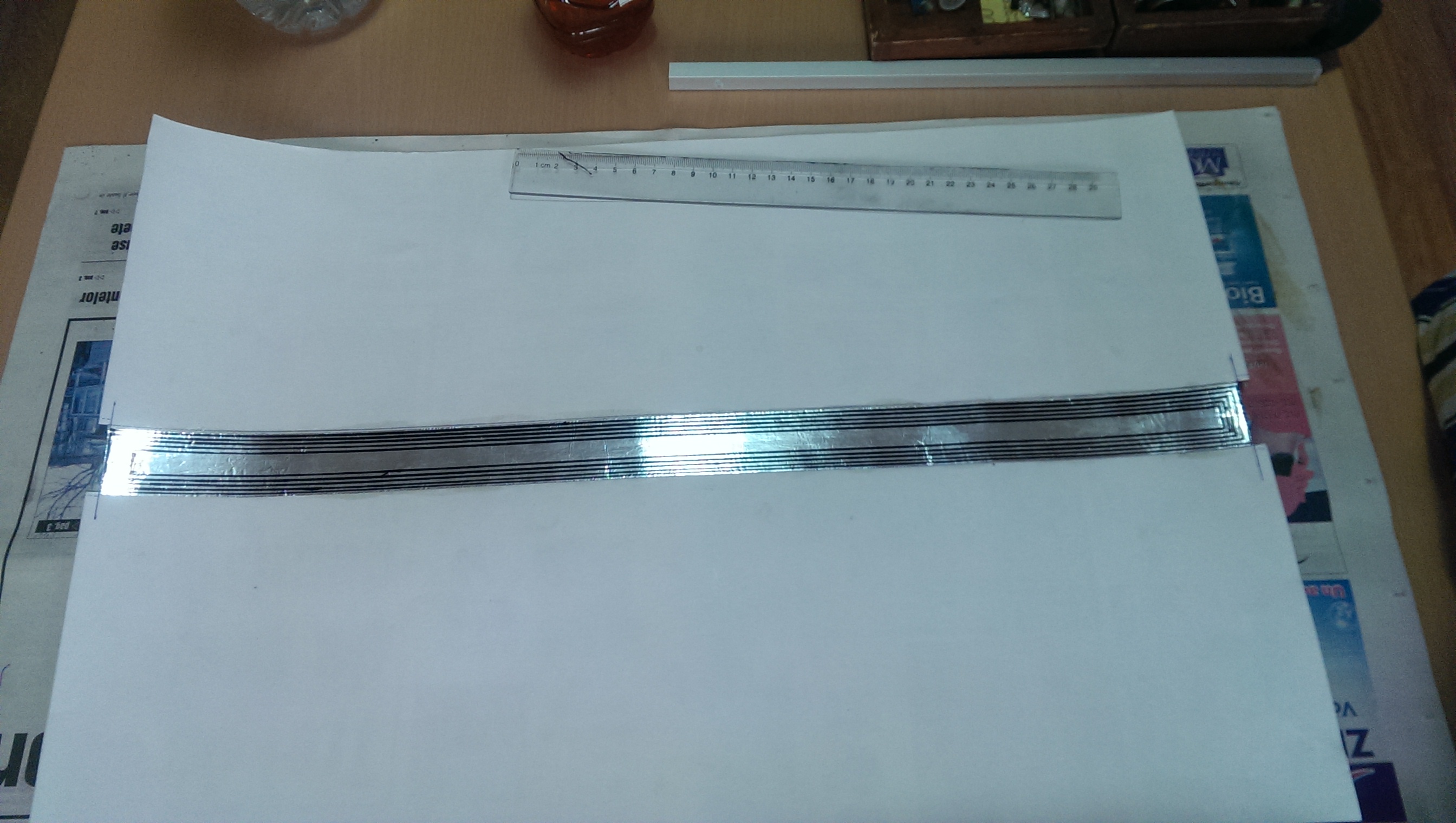

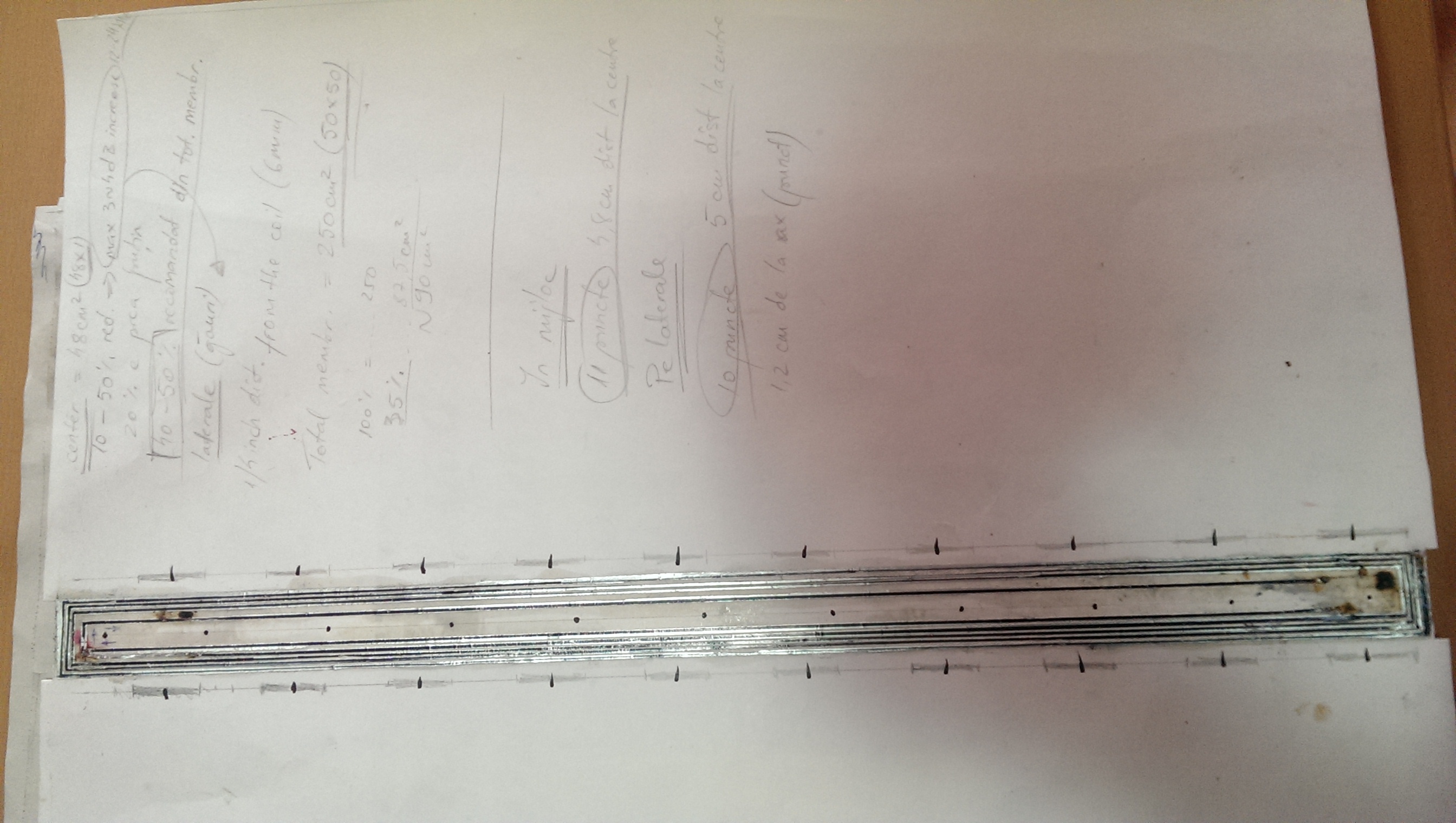

Hi Ondesx,
I am very dissapointed about this printed pcb and let me explain why. It is because it is too heavy... I just measured my aluminium from my ruined, burned and petched 8 ohm coil and found that i have had only 3,4 grams of aluminium and you have 16 (coil+support). Just imagine, if i use my bonding method: concentrated laqueur on all the coil and 2mm in plus on all the edges (for better contact and Poxipol (cyanoacrilic glue for better strenght) on the 2 mm edges and dots in the center of the coil i gain, lets say five to six grams maximum (in the worst case scenario or an accident when i dropped too much glue from mistake), wich means almost half of you mass, and in your case if you use your glue + coil you will have almost 20 grams JUST the coil and glue, wich is in my opinion too much.
In my case of cutting the coil it takes 2 hours of very meticulous work wich can be done faster i admit, but you get 9 ohms from 5 turns, larger traces (bigger contact area per trace) and much lower mass (wich i think its a very very important key aspect in the rubanoide construction). It is true that its very hard to solder on it but it can be done, and i prefer this aproach to be honest.
I must say as an observation that it cannot be done on 80gr/sqm because its too thin and you will cut the coil out (i tested this). I think in this case you have to make the coil on another support and then sticked to the coil.
My sollution of sticking the coil to the cilinder and then stick them together to the other cilinder is the best approach that i tried:
1.first i apply one very thin layer of concentrate laqueur only on the surface where i will stick the coil (3,2cm*50,5cm) to saturate the paper area (canson paper is very very absorbant).
2.then i cut the aluminium 3cm*50.5cm from a roll of aluminium used for backing with a scisor.
3. then i apply another thin layer of laqueur only on the coil area 3*50.5cm and stick fast the Al to the cilinder and put something heavy on it for 15 min.
4. i make my traces with a marker to cut the traces corectly and cut the coil and eliminate the AL from the center.
5.i apply a very thin coat of laqueur on the other paper 3.2*50.5 cm(cilinder) for paper saturation;
6.let all dry for 15 min.
8.put a paper scotch on only one side on the exterior of the cilinders (paper sheets) only to centrate them right on spot;
7. apply a thicker coat of laqueur on both sides and very fast apply cyanoacrilic glue only on the coil cilinder (my super glue has almost 60 secs till the complete dryness) ,all around it, and dots in the center;
8. stick the cilinders together and really realy fast put something very heavy on them and leave them under pressure for 2 hours..
9. let them dry for anothr 2 hours in an warm open place (room).
10.Finish
It takes me a day to finish a coil (all these steps) and the ruban fully assembled from 10AM to 6PM (1 hour pause and lunch break).
This is my humble opinion and coil construction steps.
Cheers
Sergiu
Guys I am very happy for this detail in the description! I can not wait the new tests.!!!
I was describing all the above steps just for other colleagues interested like you who doesnt know all the details of the construction... To start with something... When Wrine started the construction we only have some squetches, the patents and what i have readed from a french forum wich also started building this wonderfull speaker, but now, we have a ton of info, and another ton of info to test.
I hope that the others who builded this speaker will join this thread, with other solutions, tests, impresions and measurements so that we dont run the same things twice.
Cheers
Sergiu
yesterday i build a mini version of the ruba, measuring 21 cm high, exact an A4 paper sheet. coil is around 3.4Ohm, DC. i used translucent transfer paper. 125grams. but it only reaches to 13Khz
When i remove the leftover paper on the backside that is only there to be able to use the rubber bands. it goes to 14khz-14.5khz. (i leave the top and bottom to still be able to use the rubber bands.)
Part of the reason why it does not reach that high is in my believe the glue used, i used a spray glue this time and i think it damps the coil , not a good thing. I am not sure yet what glue to use instead, it has to be thin and fast drying. but cyanacrylate dries to fast
Here is what glue i used in my earlier sticking method in combination with very concentrated laqueur. See the pics. It says in romanish that it fully dryes in 60 secs and cannot be fully used (stressed) earlyer than one hour.
