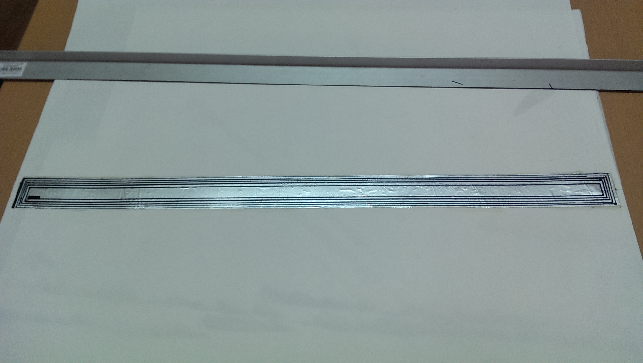

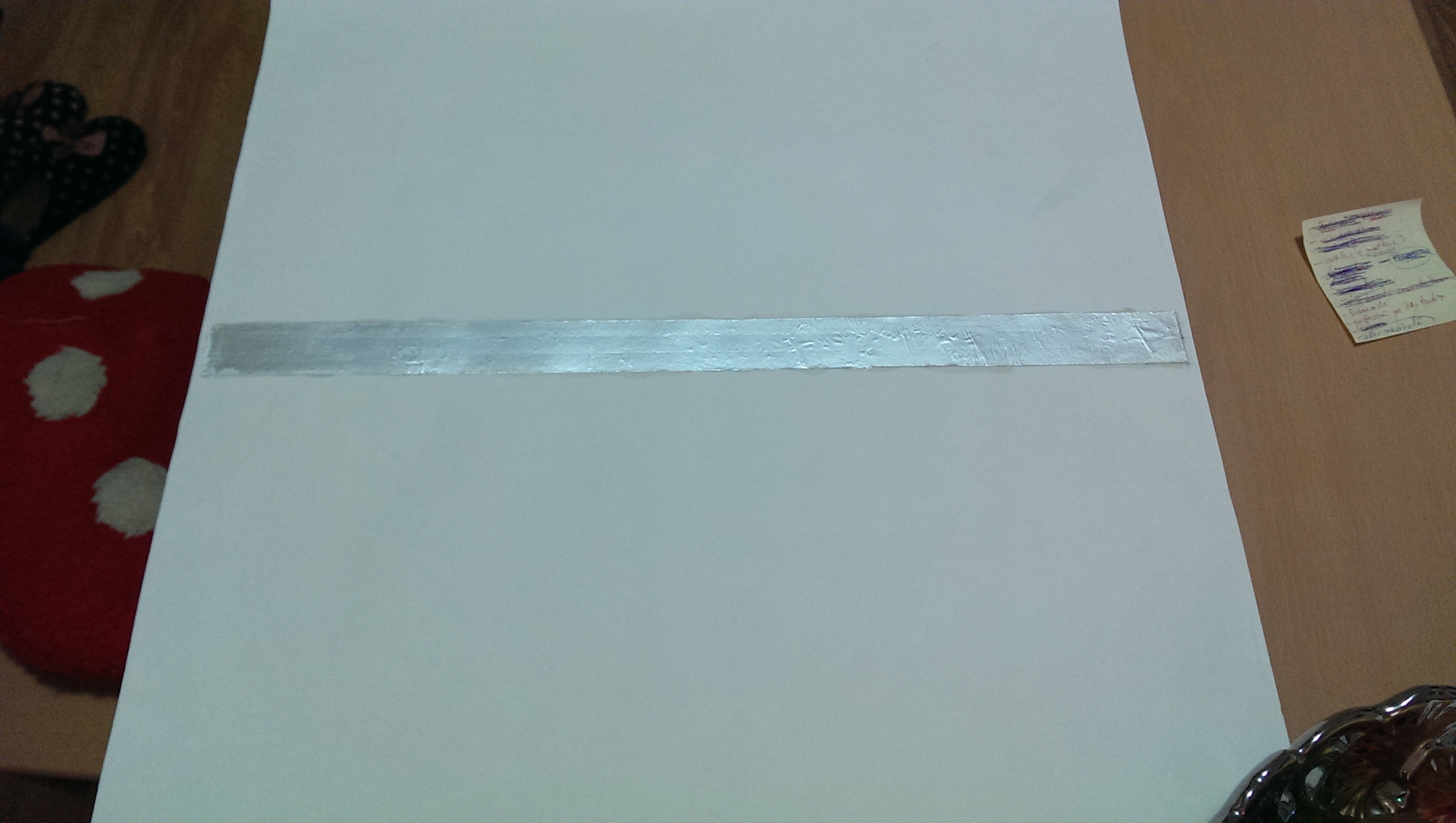

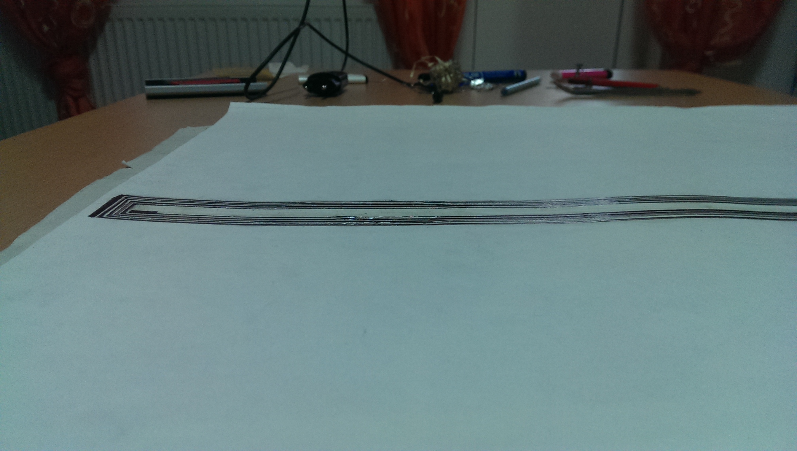

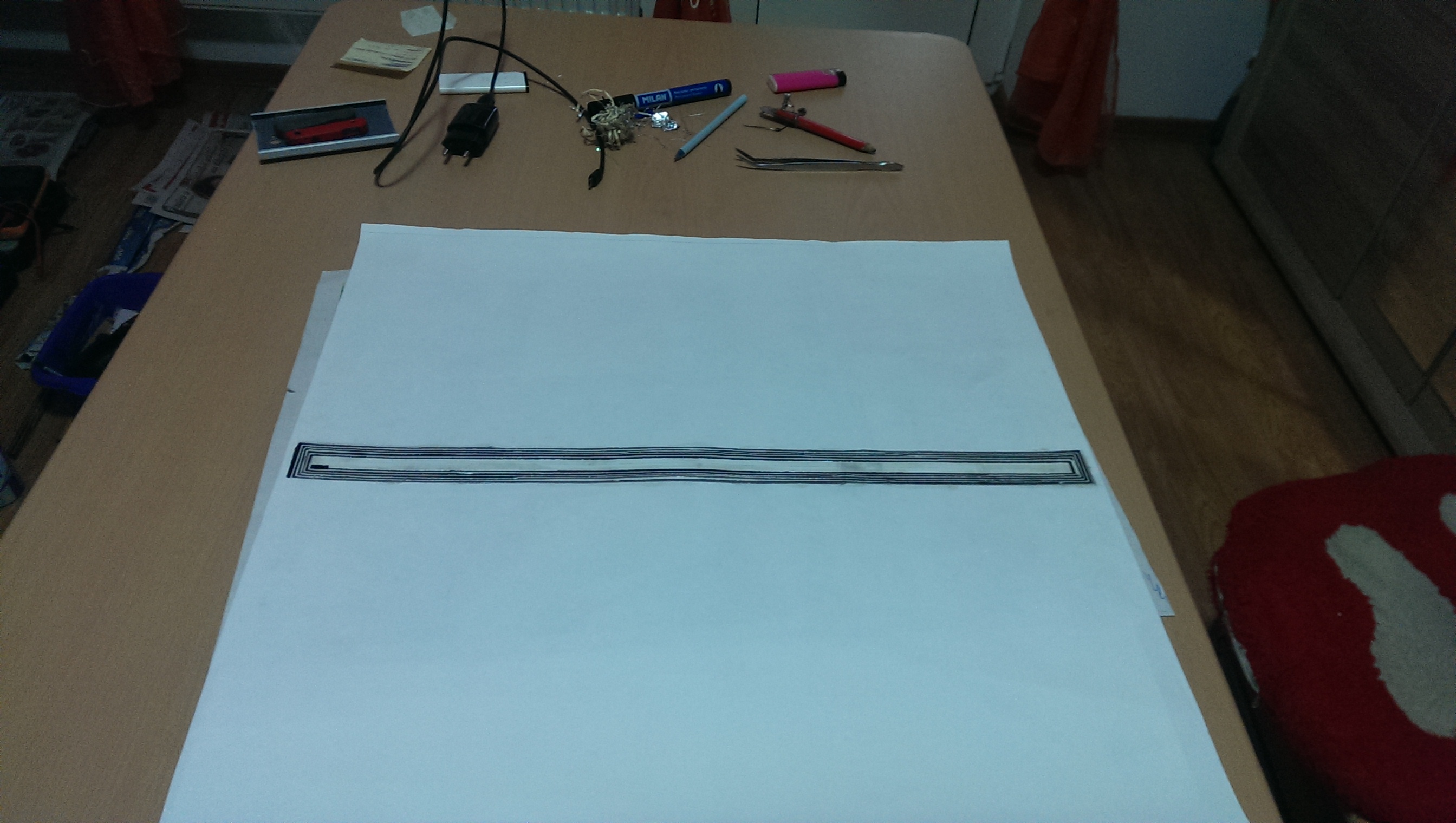

Anyway. Monday i started making a coil, manually. 5 turns have almost 11 ohms.
It seems that a very goood way for making the coil is sticking and cutting them directly on the paper.
It takes a painfully wopping 4 and a half hours to cut the coil with razor blades.
Now i know why the inventor of the ruban has used canson paper. First of all it doesnt bend when you use laqueur on it (look at the pics), and second, it is very absorbant wich is not good in terms of humidity resistance.. i have buyed two bottles of special laqueur for paintings wich i hope will saturate the paper making it humidity resistant.
Tomorow i will stick the cilinders together and see what happends. Today i will try to solder the wires to the Al foil.
Cheers

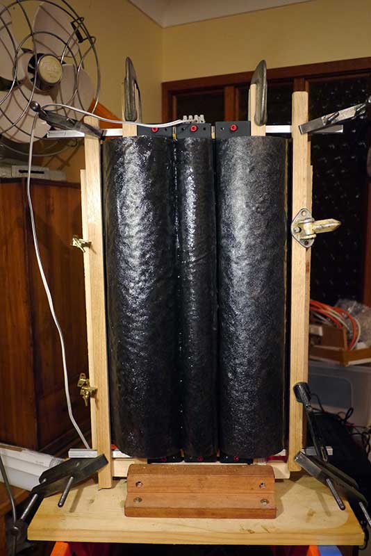

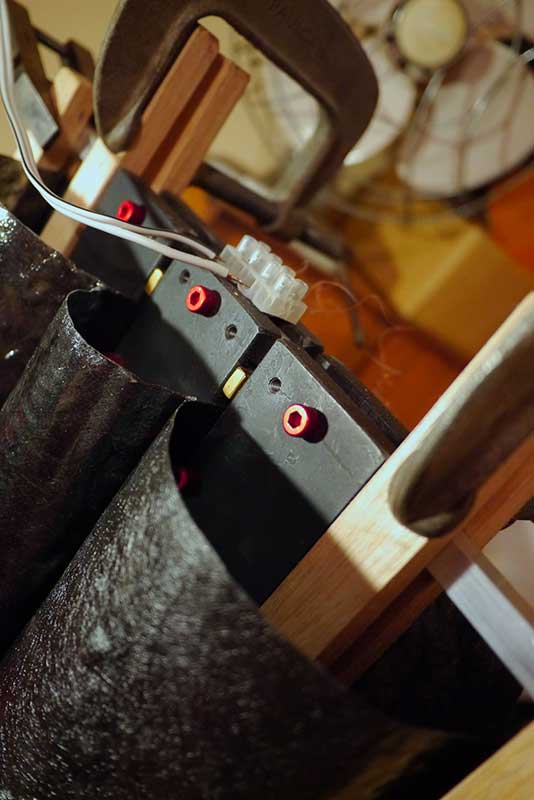

after all your valiant efforts with rubanoids, i was inspired and decided to try a rubanoid spin-off of my own design. due to my twisted style, love of difficult things, and general stupidity, i am attempting to use three lobes, the theory being that the middle one is pistonic. so, you ask? well, ok, 3 is my favourite number....
attachment.php
this first test one works well. it makes music. :D amazing. the fun and wonder of making my own speaker, not just building some boxes for store-bought drivers like usual, is pretty great!
attachment.php
450mm long membranes in carbon fibre and epoxy. N52 magnets - too many for someone who has not much money. hand wound 0.2mm copper wire coils - 33 winds - 16 ohms per side wired in parallel for 8ohm nominal. here is a vimeo video of it playing....
i have two questions as i go further:
  • has anyone found any good sources of info regarding membranes, resonances in them, and how to dampen it all, and generally understand what is going on in the vibrating surface?
  • where is some good info on measurement of speakers with inexpensive equipment?
next up in this project is making the magnet assembly for the other side, proper measurement, lighter membranes (silk or paper doped, with the coils set in epoxy between the lobes), sourcing copper braided wire for connections to the membrane, and a new system of hanging/tracking to keep it all perfectly in the air gap. surprisingly, i removed my dodgy noisy trial tracking setup because it was not needed - the membrane stays pretty well in the gap once aligned on the sides....until some heavy bass, when it starts to go out of shape and move like a jellyfish....
my initial thoughts on these working prototypes:
  • my membrane is carbon fibre with epoxy set over a three-part mould - too heavy. i am thinking of trying doped silk and paper as well. yet the carbon fibre still gets clearly to 13khz with this weight, but drops dead at higher frequencies (or my ears do....)
  • they are also very directional at higher frequencies, not so much horizontally (though there is definitely a sweet spot), but vertically - they need to be placed at the right height....
  • they have some ringing on certain notes, evident in high pitches of piano and xylophone - certain percussive high tones really can be harsh. need to track down those resonances and trial damping methods in places....
  • the bass is very nice - especially drums - they sound like real drums! i would like to chase this bass side of them a little, maybe through a trial with an upsized wave guide (at this size i guess that would make them more like sculpted O.B.'s...?!)
  • its all untested as to efficiency or any other hard numbers....
  • they are a ridiculous pain to make, especially the composite membranes, and the coils, and the magnet assembly (having three plates makes for more fun and danger....), and the final tweaking to get rid of rattles and hums, not to mention finding bad resonances yet....
thanks to all of those who posted on this - i was inspired, and am now having fun mucking about with possibilities and learning heaps along the way. great stuff! will post a proper build thread when i get a little more done.

I am unproud to say that i ruined almost half the coil (still getting 7.4ohm on the DMM)even with dedicated flux.
Because the surface area is too small and thin, when rubbing with the soldering station iron on it, the trace will snap (if you peel the trace from the paper to solder it) or the paper will get burned (if you solder the Al trace directly onto the paper)...................................
I have setted the soldering station to 420 degree celsius for the first try and the soldering iron gets oxidezed. Tryied different temps and found that a good temp is around 320-340degree celsius.
I think that i am missing something here because I managed to make three solders on the Al coil but now I cant. Its really ******* me off.
Funny is that i have tried the flux on trafo steel sheets and i managed to solder really easy on those.:mad:
Wrine, you where right, the oil technique works but only on bigger surfaces where you can conduct the oil in one place preventing it from spreading when soldering.
I will post some pics with the dissastrous results.
Cheers
Sergiu

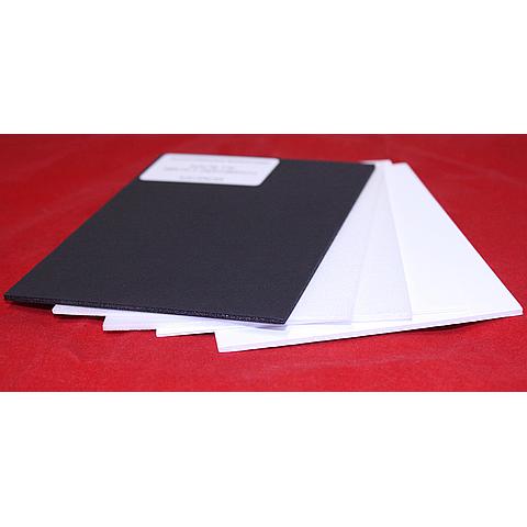

by the way about stiff and light i looked for foam board 1mm thick this i could squeeze into my magnet gap and is stiff enough to not warp into the gap and is very light. it does exist but i need to buy 50 pieces ..... i dont want 50 pieces :) so if anyone is interested for a trial. i would be willing to co buy or something :)

Wrine, can you post a picture for the foam pcb? Never heard of this before.
Thanks in advance.
it is foam board. the sandwich of paper/foam/paper. since it has a foam core it is very stiff yet light. it works in DML loudspeakers and since a rubanoide is a bending wave transducer mixed with some pistonic movement it might work. or sound horrible. we just dont know :) well if you are in Germany and near the border of the Netherlands please come by for a cup of coffee or a beer :) my English is not that great either and my spelling and way of writing is a complete disaster :) most people have no clue what i write. haha.
