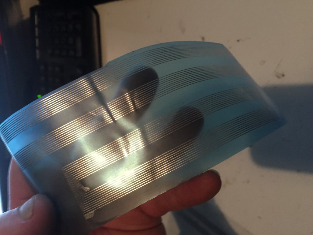

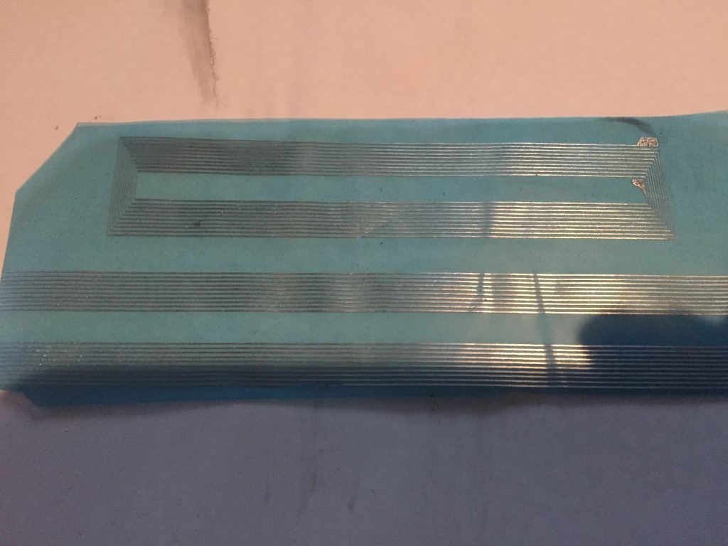

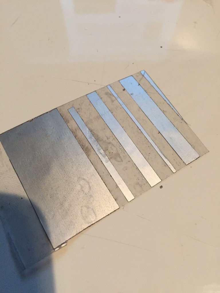

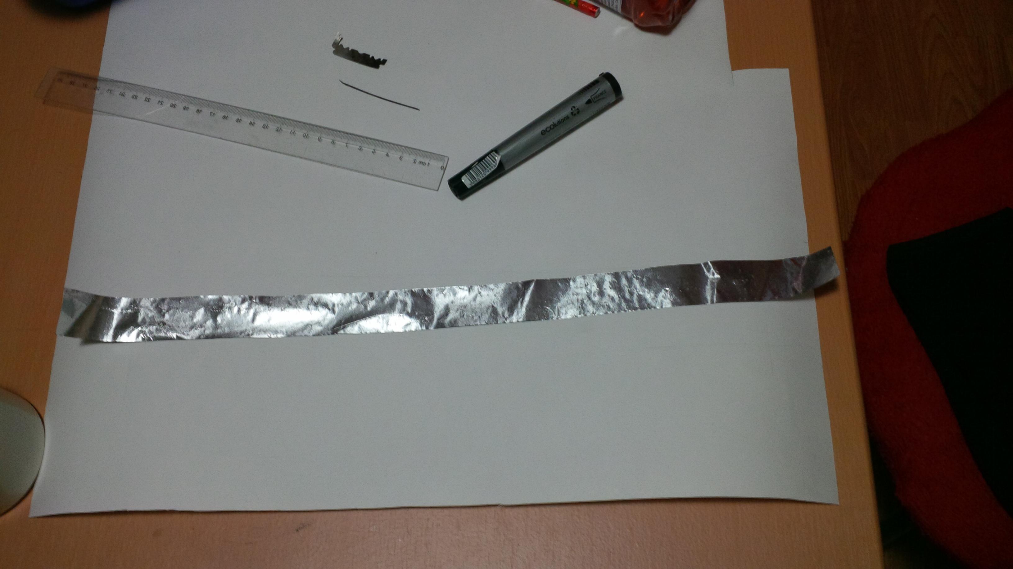

Ooooooh yeah, i finally got a aluminium etch to work.
i used tape on common household foil 10 micron thick to make a flexible laminate. i then dumped it in the etching tank for few seconds.
it then removed it and cleaned it with alcohol. taped it to a plain paper. ran it to my solid ink printer.
i diluted my etch acid allot still do use hydrogen peroxide + hydrochloric acid. so it takes a bit longer but finally my wax print does not come lose. look at tyhe pictures this is beter then i could even dream of. that small line is 1.1mm wide. love it i am pretty stoked

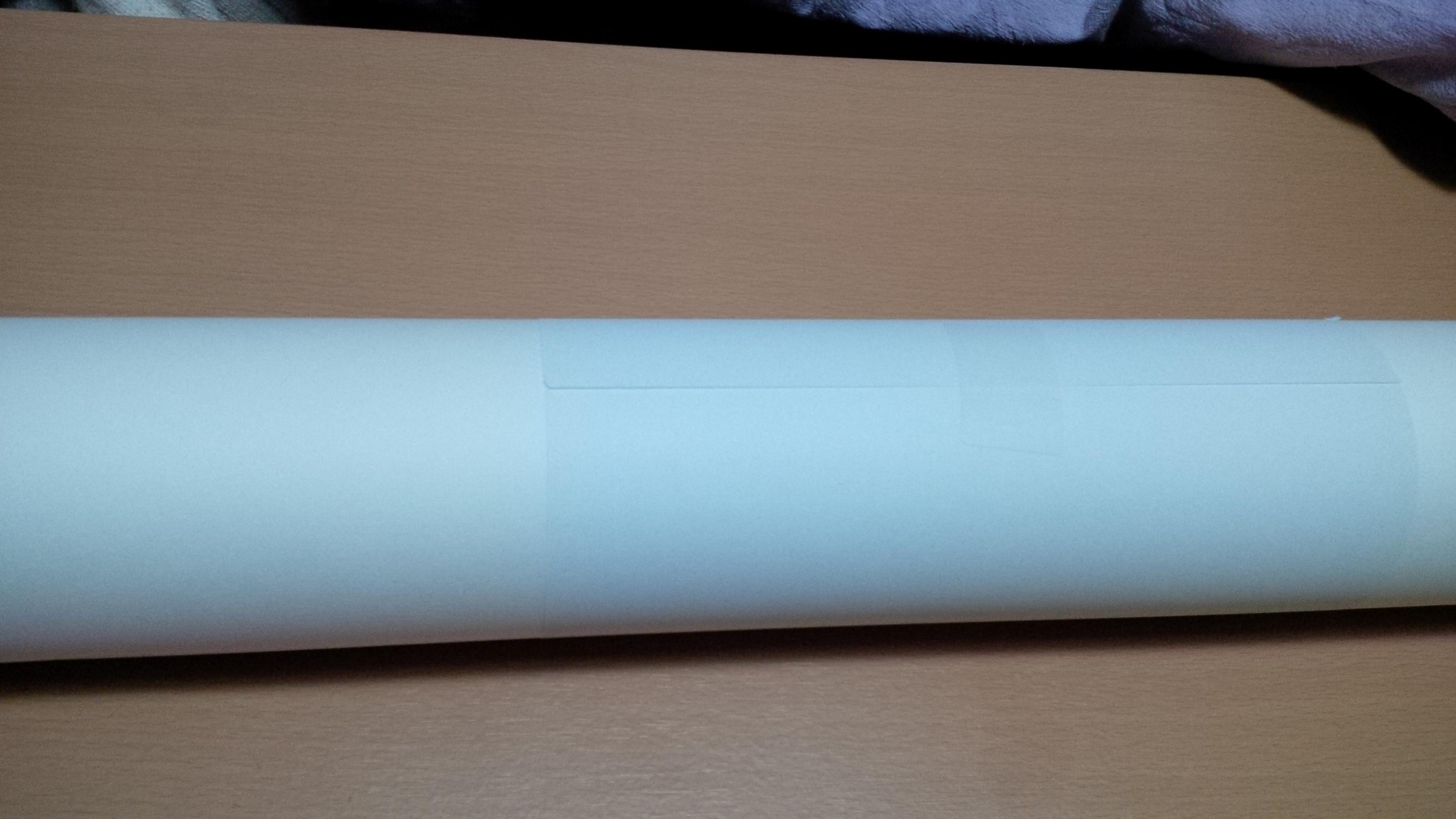

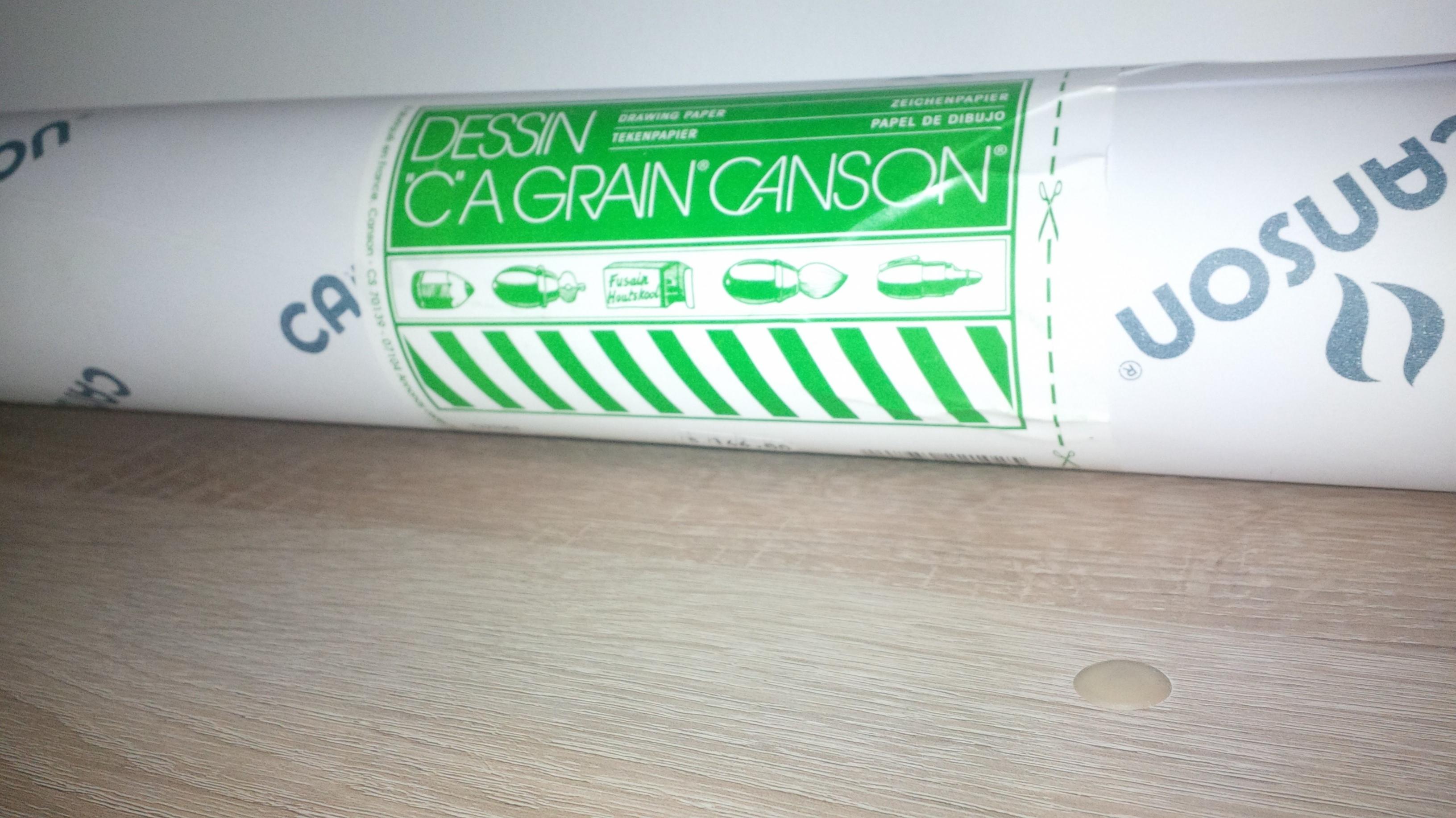

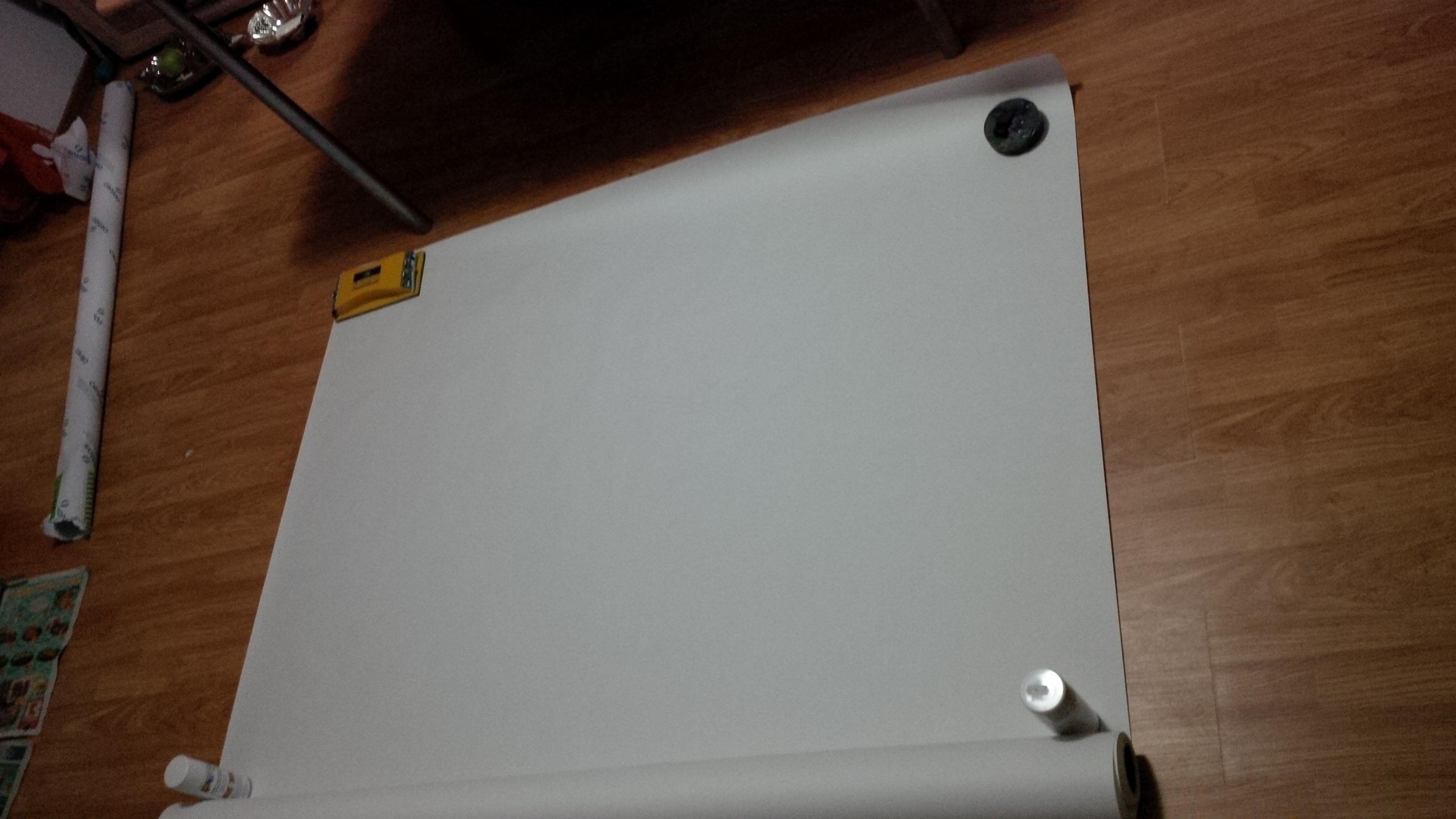

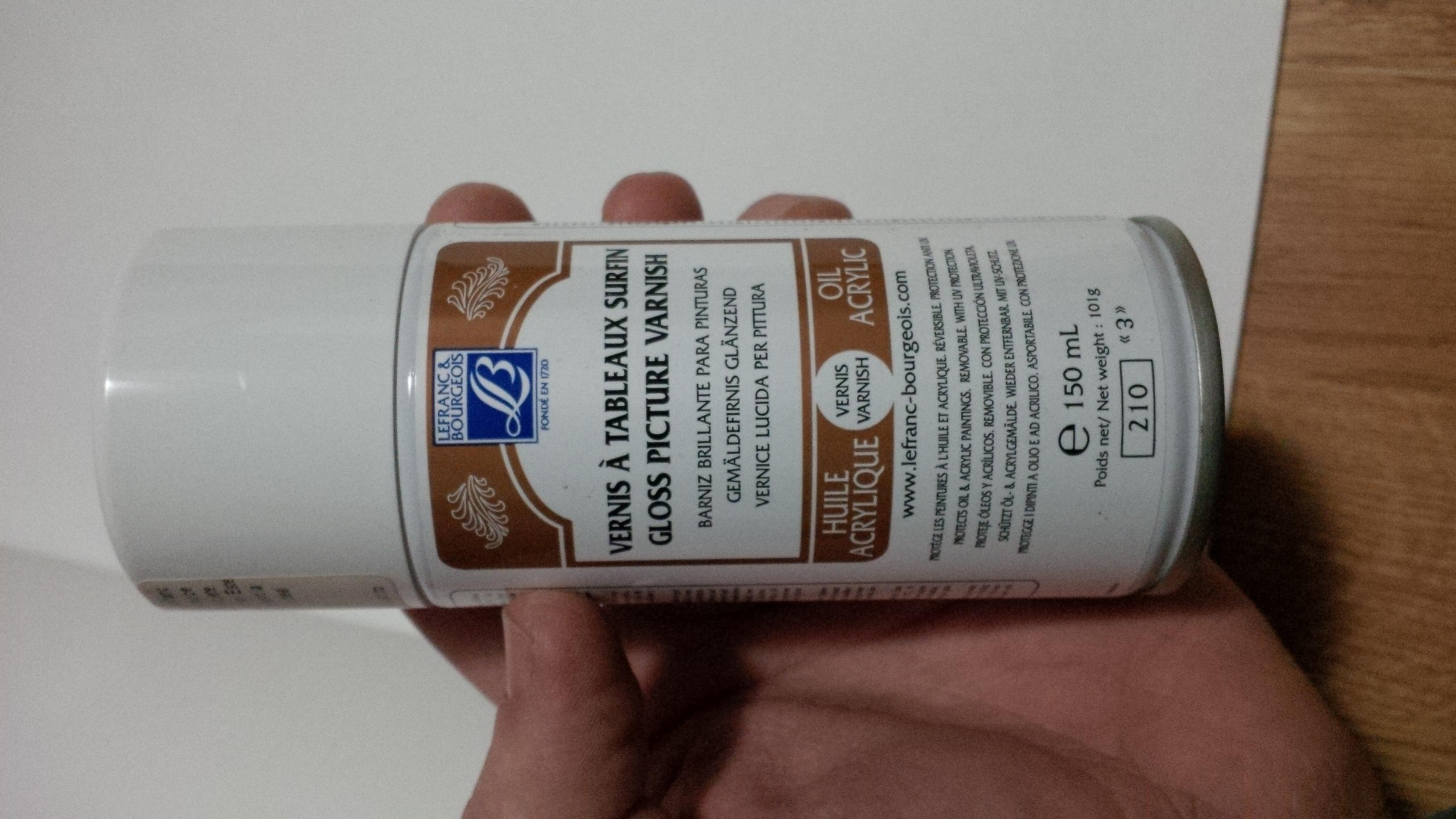

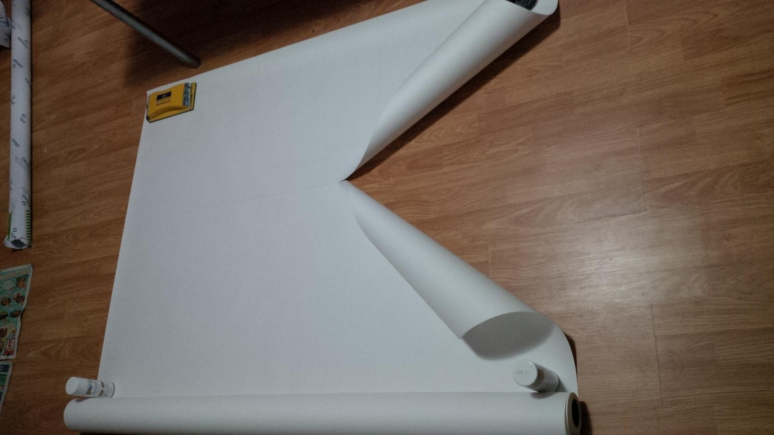

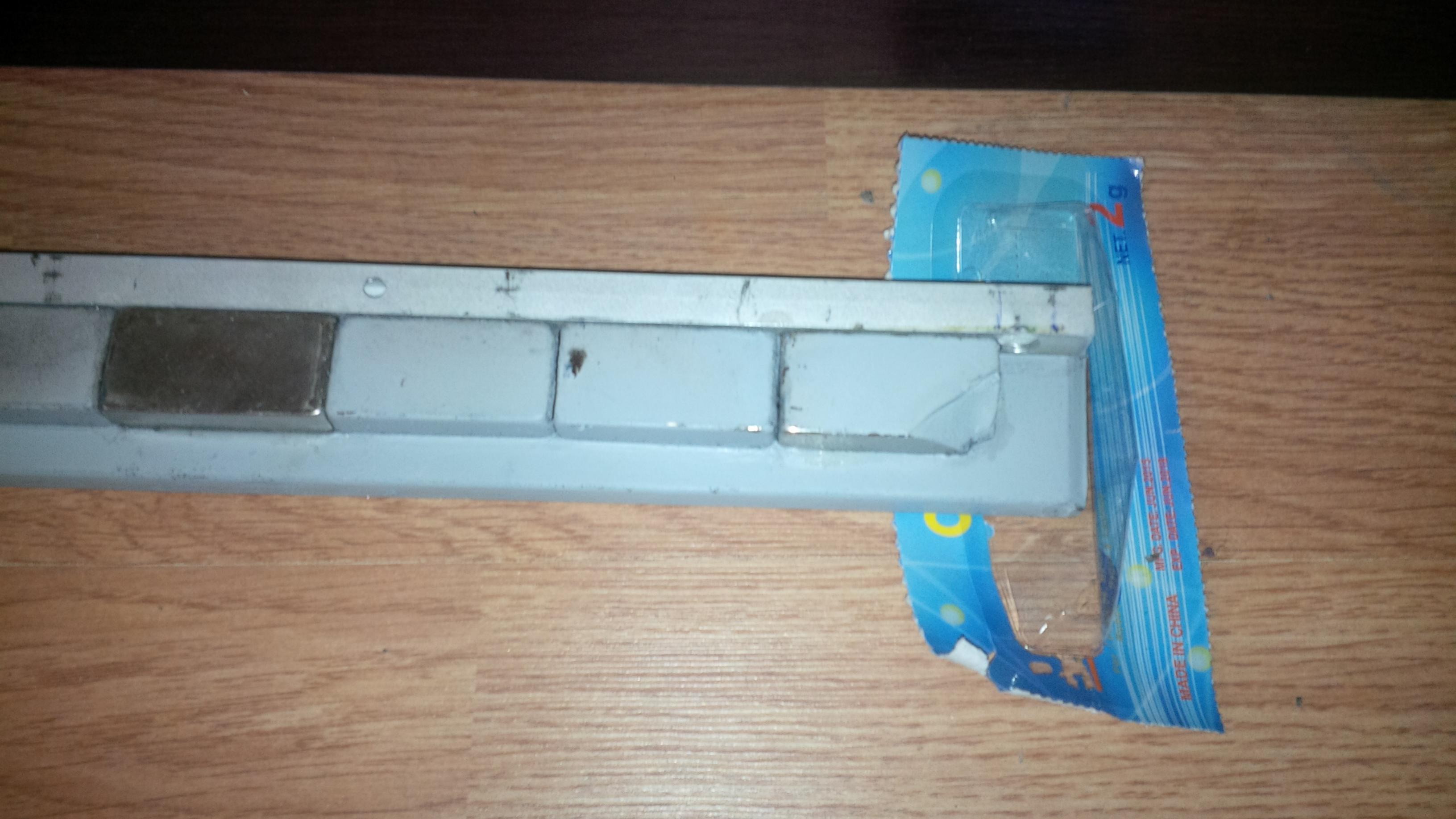

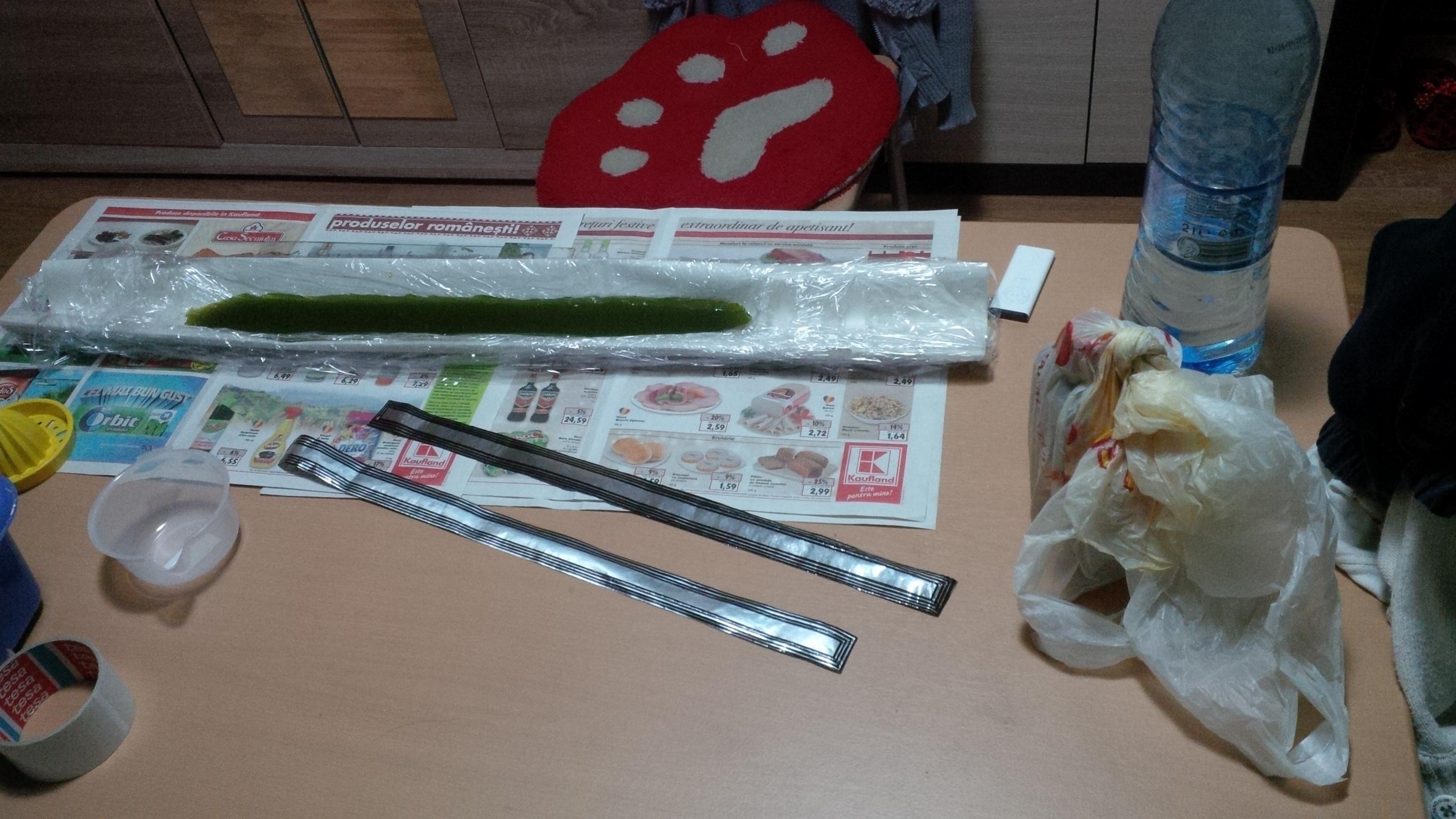

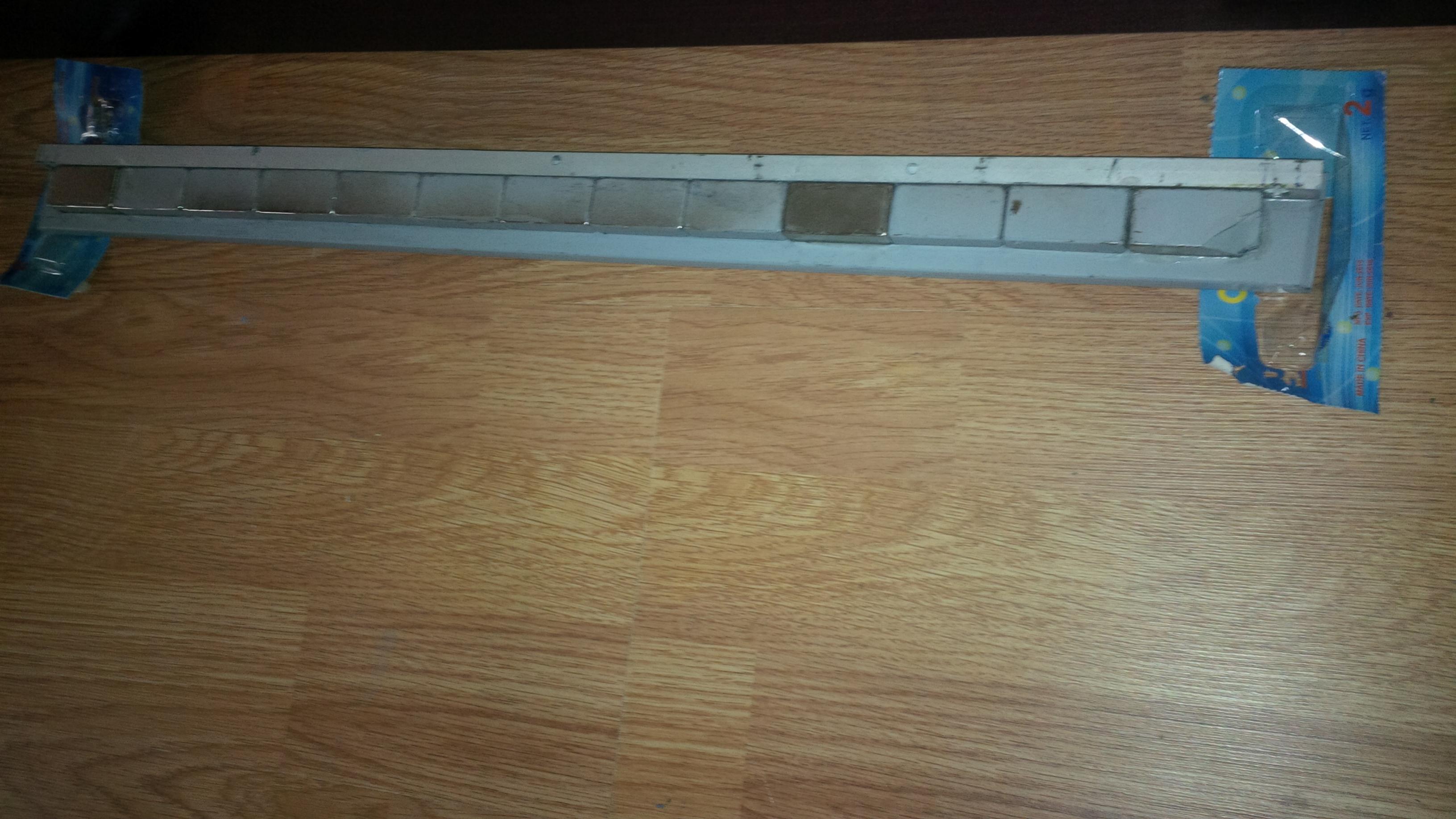

Here is some work in progress:
1) first two pics represents the paper that i told you about: the canson 120gr/sqm paper;
2) the second two pics represents the chopped magnet that i told you about;
3) fifth: the laqueur that i told you that i want to use to spray it at the finals for humidity resistance;
4) last pics: some work in progress;
I also found that its almost impossible to wind the coil; i didnt found a feasible and fast method to wind them..
Wrine have you found a method for winding this oval coil with copper wire?
Can someone recomend a solution for this problem (winding with copper wire)?

1. aha when i give it another go ill try the paper.
2. magnets is not an issue i thing.
3. it does add some weight, but dont know if it does anyhting

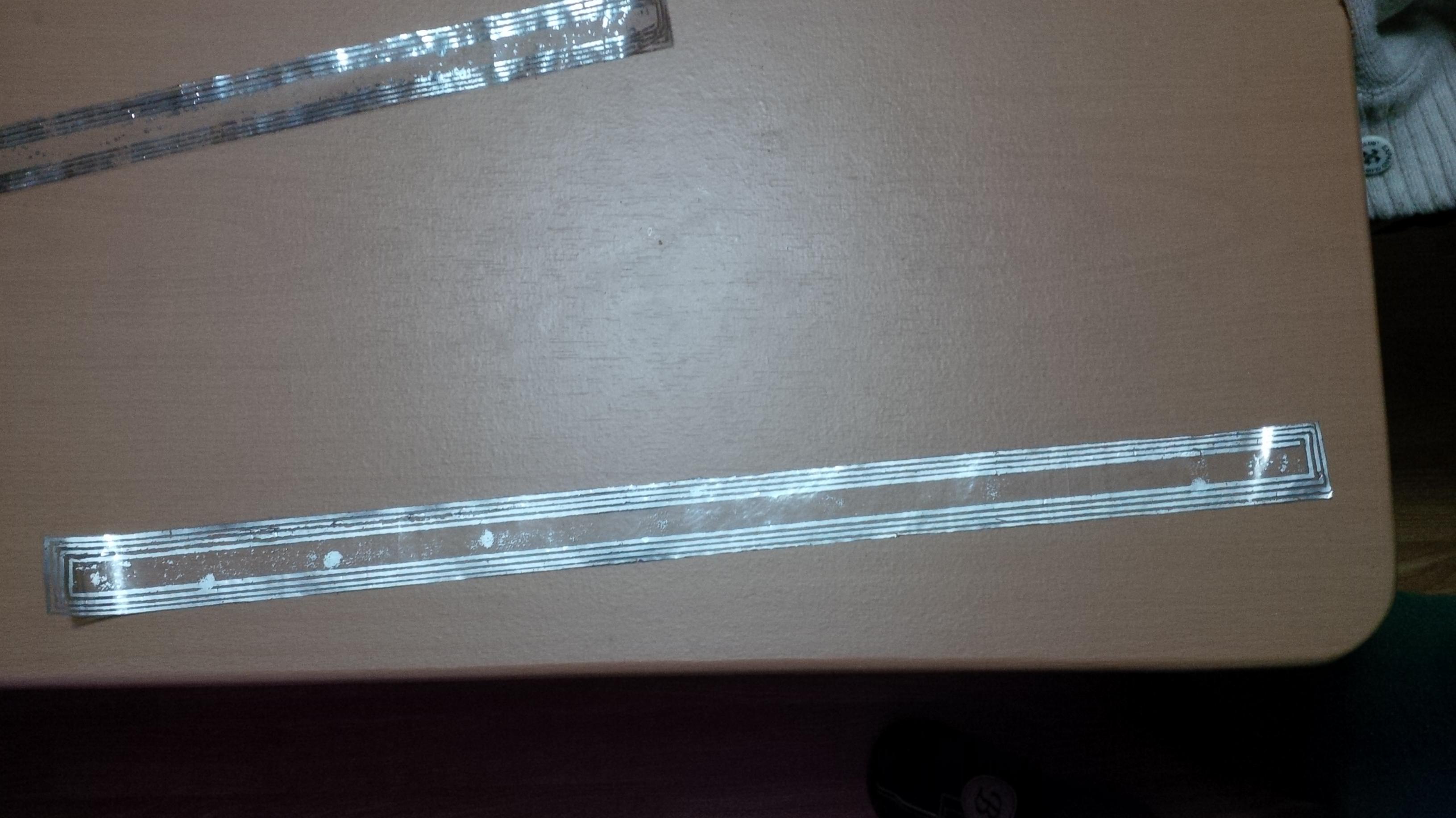

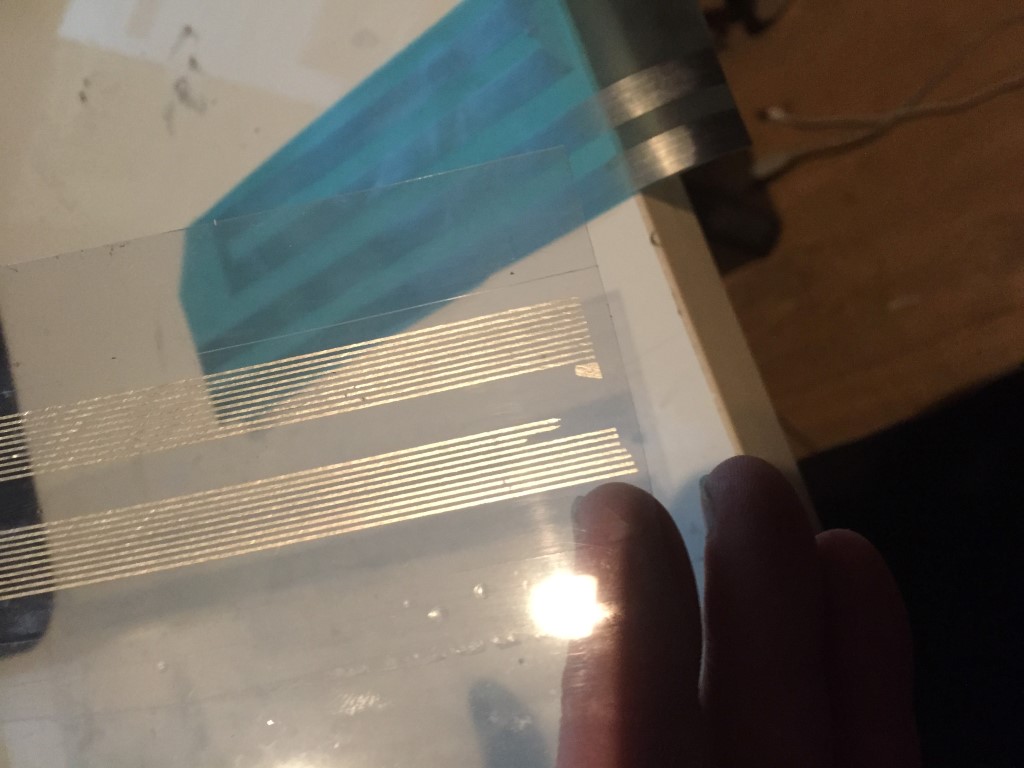

4. Coil winding sucks indeed. thats why i make etched coils. it gives me now as well the oportunity to use aluminium witch is nice. again lower weight. and to use it on thinner material like tape. or mylar. or directly onto the stuff used for membrane.(only possible if its not paper ofc). here a picture of glued foil to pvc transparant then etched. some lines came of due to my fast glueing of the al foil. but it should be possible. thats is a coil without a carrier. i do advice you to score a solid ink printer somewhere. you should be able to pick one up for les then 75 euro. look for xerox phaser line
and the blue foil is 7 micron alu on 7 micron mylar. lines where over etched. to agressive solution
i used Another less harmfull solution coppersulfate with salt.
well still , my xerox solid ink is type 8500 and does not have the greatest DPI, 600 so it has some small problems with smaller spacing of 0.3 mm, still pretty decent but. etching makes it slightly more ragged. well atm no money for a 8550 or beter. this will have to do
ordered some new ink since it is bitching for new black ink for half a year. i also noticed some small striped in the ink, witch can be seen in the end result so maybe have to do some cleaning. and last but not least. tests showed that reheating the print seal the tiny holes that might be pressend in the wax ink. to much heat will smear the edges so dont overheat. or leave it as is. to bad you cant print twice onto the same material... it wont align and makes a mess of the ink already present. i can imagine the printer wont like that idea either

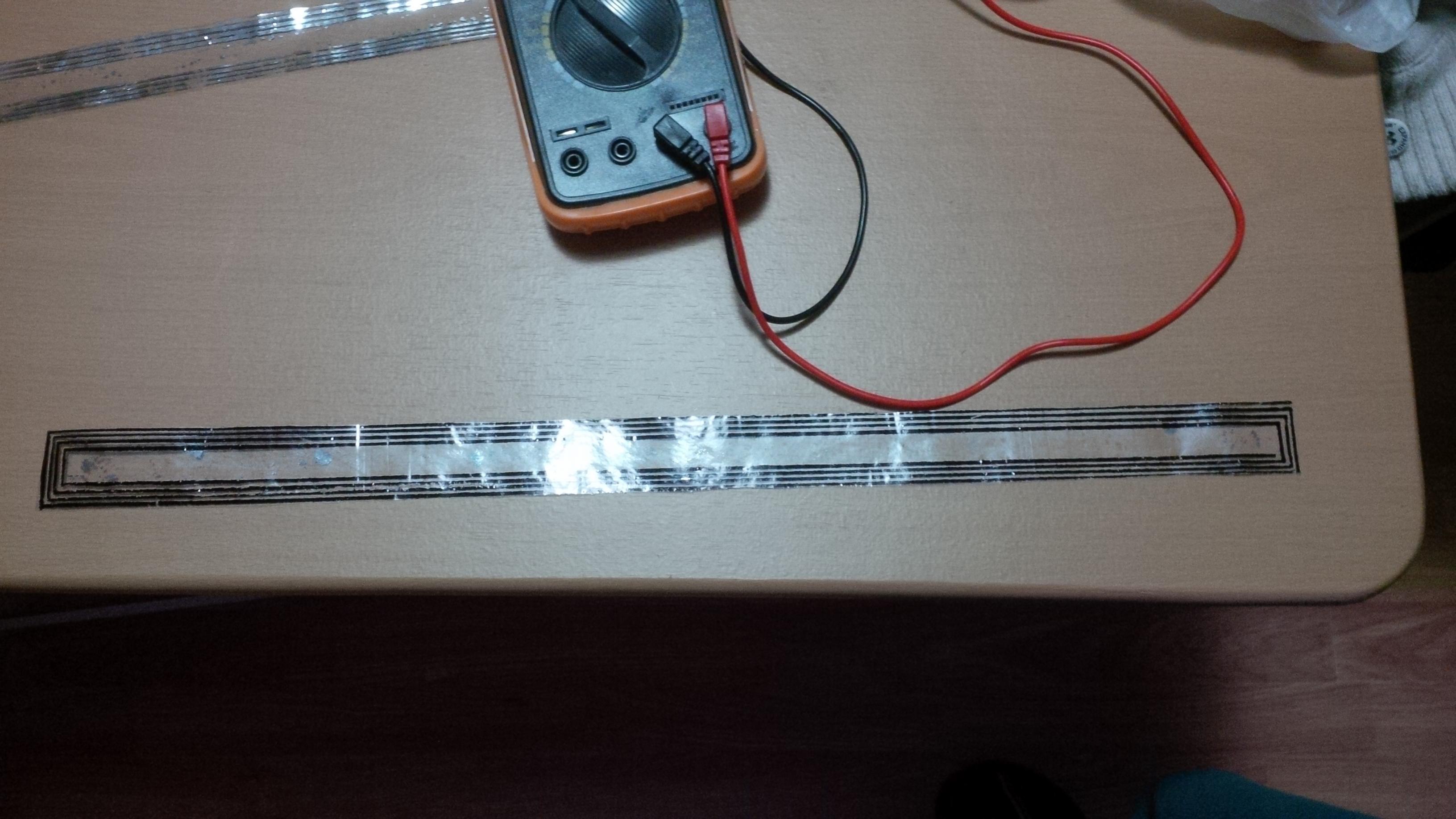

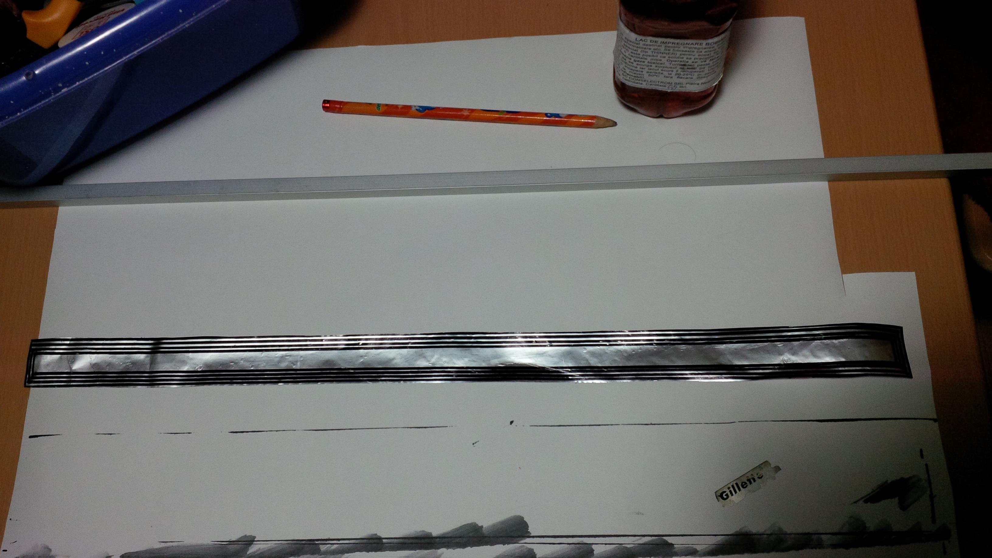

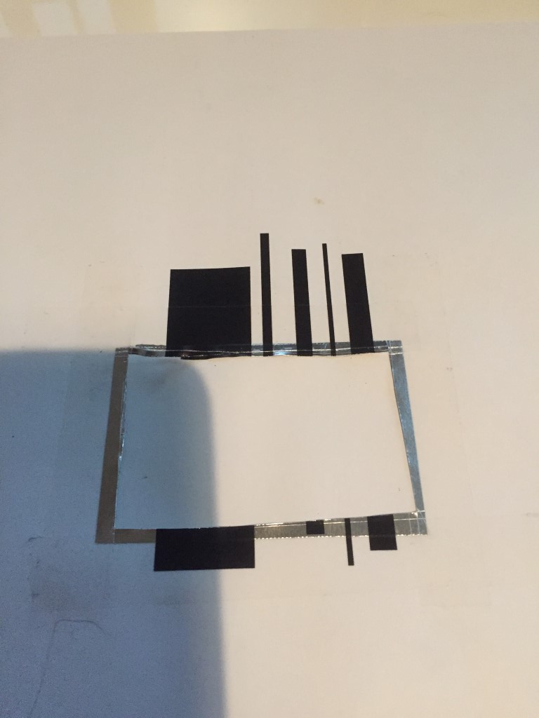

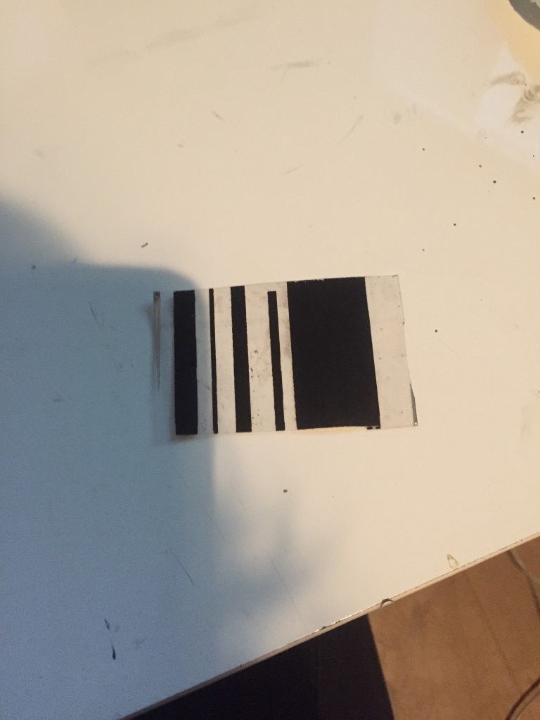

Hi Wrine,
Nice progress.
I have given it a shot too. Look at the pics bellow.
It does need some finishing touches but I draw it with a permanent marker. I have to make some tests with the FeCl3 solution first to see if it doesnt etch all the coil. And another issue is how can I bond wires to the aluminium coil... I was thinking about taking the begining and the end of the coil outside of the cilinders and stick it to some screw joints but would it be possible to rip outside?
Do you know any sollution for this issue Wrine?

1 before you start. do rub the alumnium with some steel wool or anything it has to be really clean. use alcholol to clean after.

Hello my friend Wrine,
I have made some progress so far. In the pics bellow you can see the first "almost good" coil from almost 10. The FeCl3 is very dangerous and REALLY fast. It disipates allot of heat and toxic gases so you have to keep the windows open when doing this. I had to dillute the FeCl3 to aprox 1:3 with water. The coil has 3.9 ohms so this means the dims are good.
I think this solution is good if you have a steady hand a good permanent marker.
I have to do some more tests. I still dont know how to make some joints to the aluminium coil.

Oh yeah connection is a huge problem tried copper plating buy ofc to plate aluminum is very difficult and involved way more the I thought it would
Hello again my friend,
Here is what i found lately. It seems that there is a solution for this issue:https://www.youtube.com/watch?v=_mYkM9lHMho
(i think that this is very easy, especially when you use enameled copper wire for making leads to the coil)
