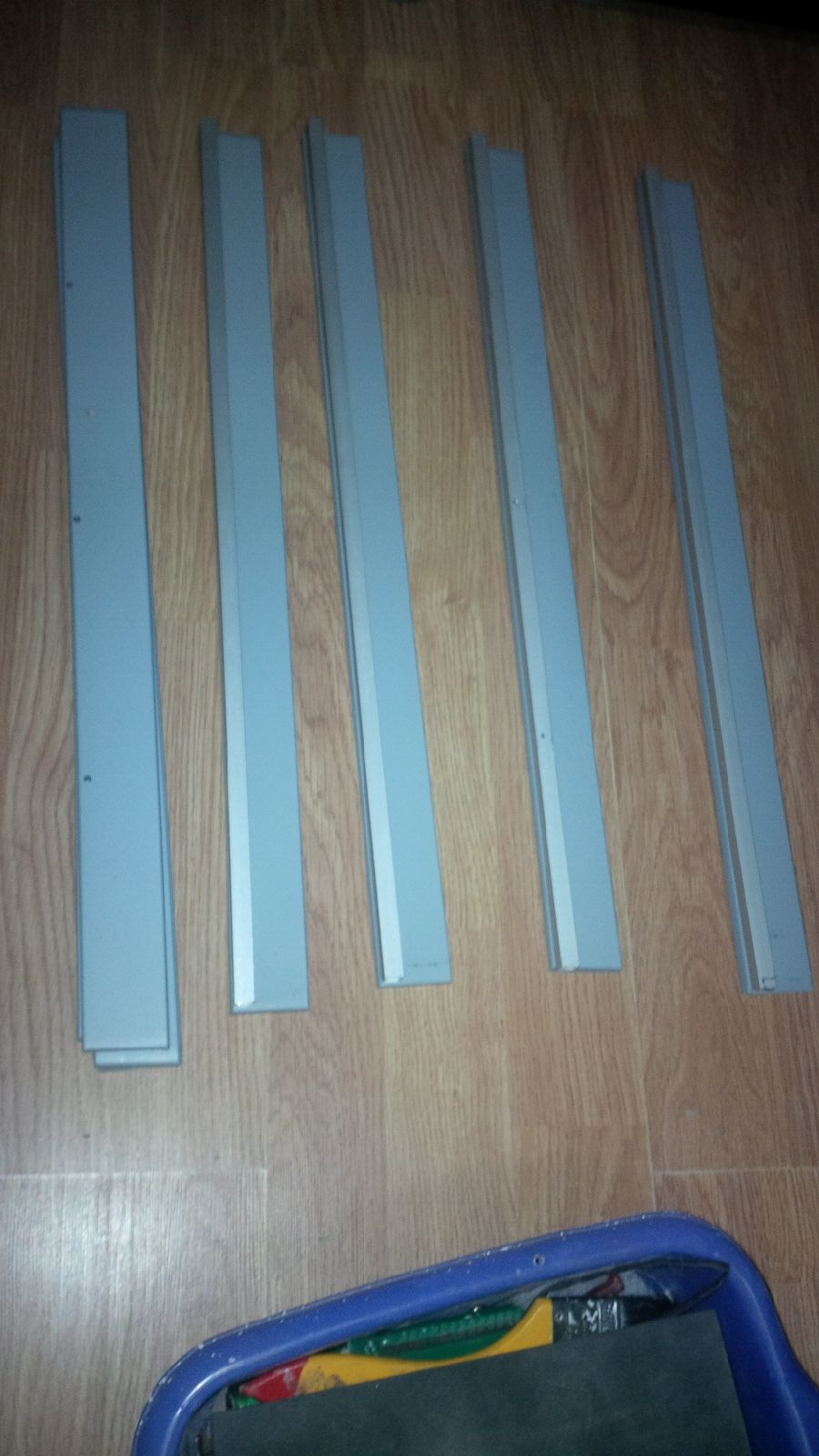

Hello my friend, Wrine. How are you? I have seen that you had left the rubans behind..
Im sorry that you didnt get the results you wanted.
The rods are wider, 55.5cm*4cm*1cm so that it doesnt bends (I hope).
I want to try some new things and stuff BUT I dont know where can I find some 110 micron mylar here in Europe....🙁

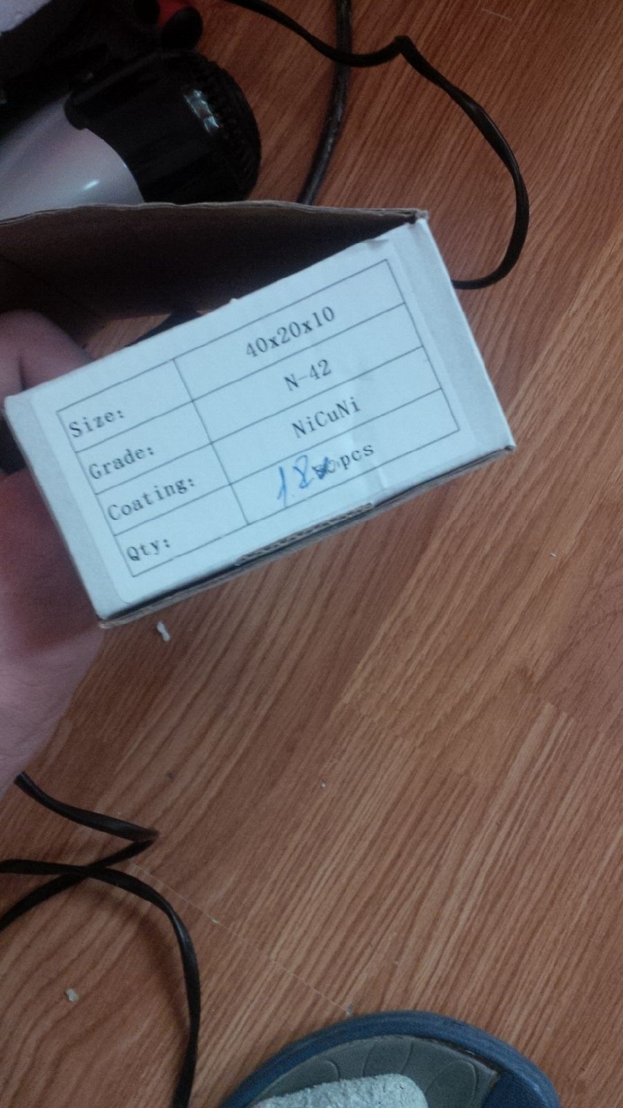

The power is tromendous, I had a chance to loose a finger when I sandwiched the plates..
I have a question, how did you put the two motors face to face without breaking some magnets or loosing some fingers?

well i always had a top and a bottom plate, milled. with the right spacing for the 2 magnet structures. i then used same size plastic or wood. i put it on top of one of the magnets asembly's then slide the second one on top of that and tapped both in the bottom plate, then taped the top place on the 2 magnet assembly;s and then removed the piece or pieces of plastic in between the gap. but your magnet motor is way stronger then mine. so i dont know if this would work. just be really carefull you can make a mistake easy. and it will cost a finger. in my version nothing rubbed, and i used single coil and dual coil. only thing i can think of is i had not enough turns in my coil? since i had a flat etched coil.. or the choice of material is not right. although i used many different stuff. the plain paper damped with foam worked best for me. it had the lowest distortion. but still way higher then lets say a ESL.

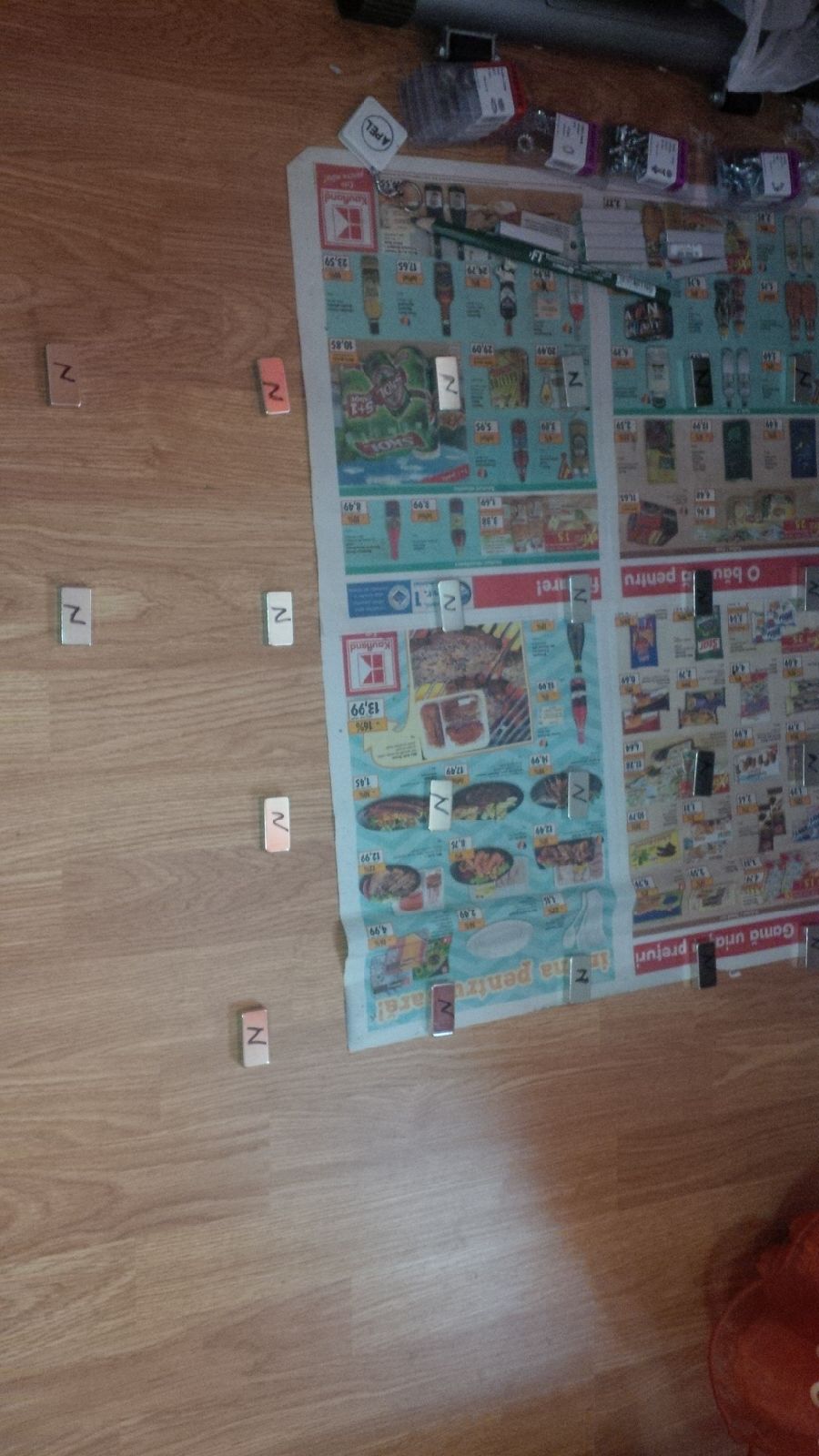

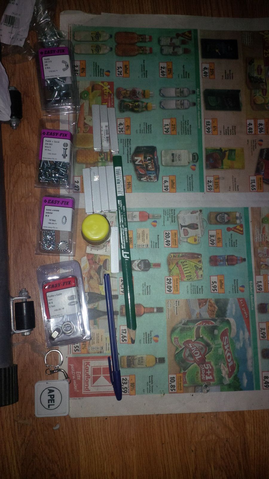

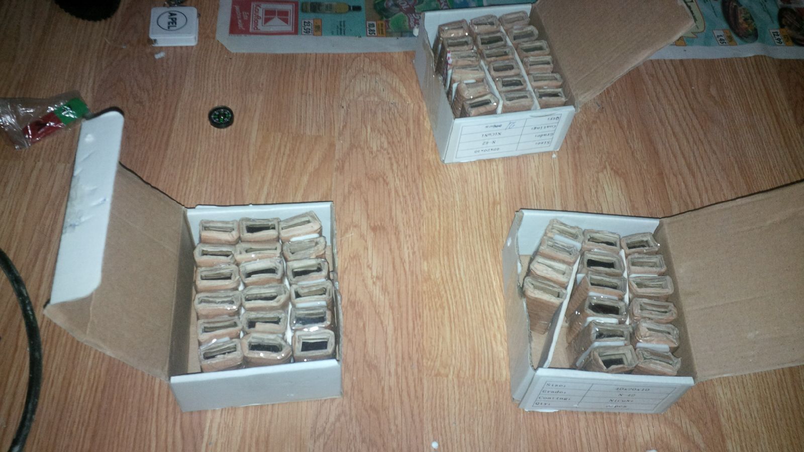

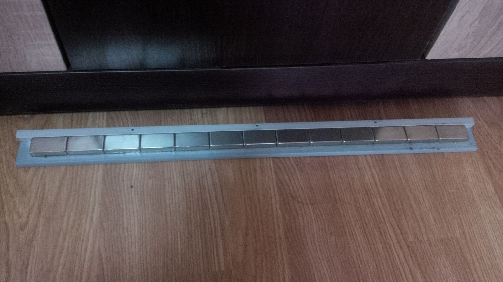

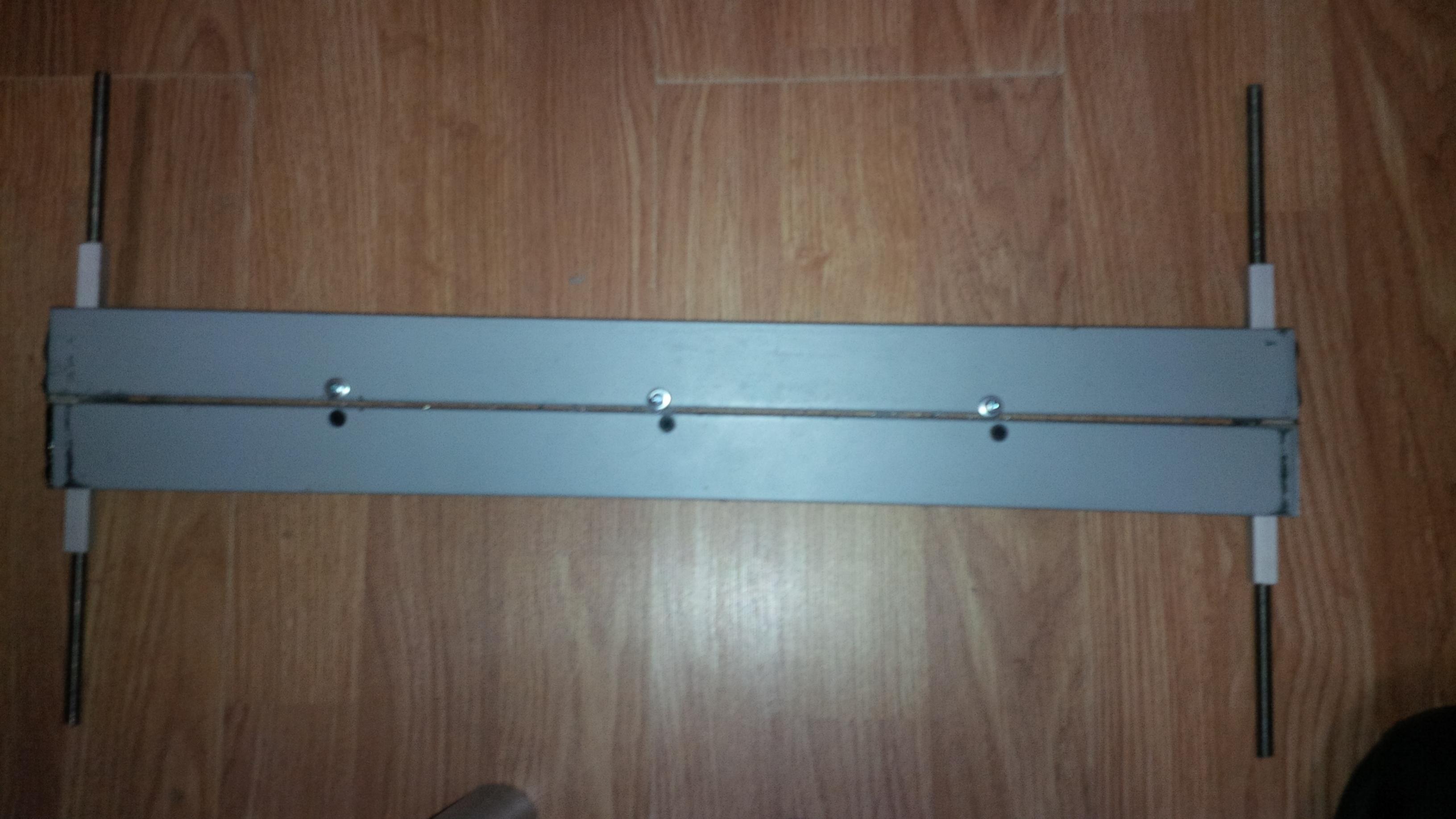

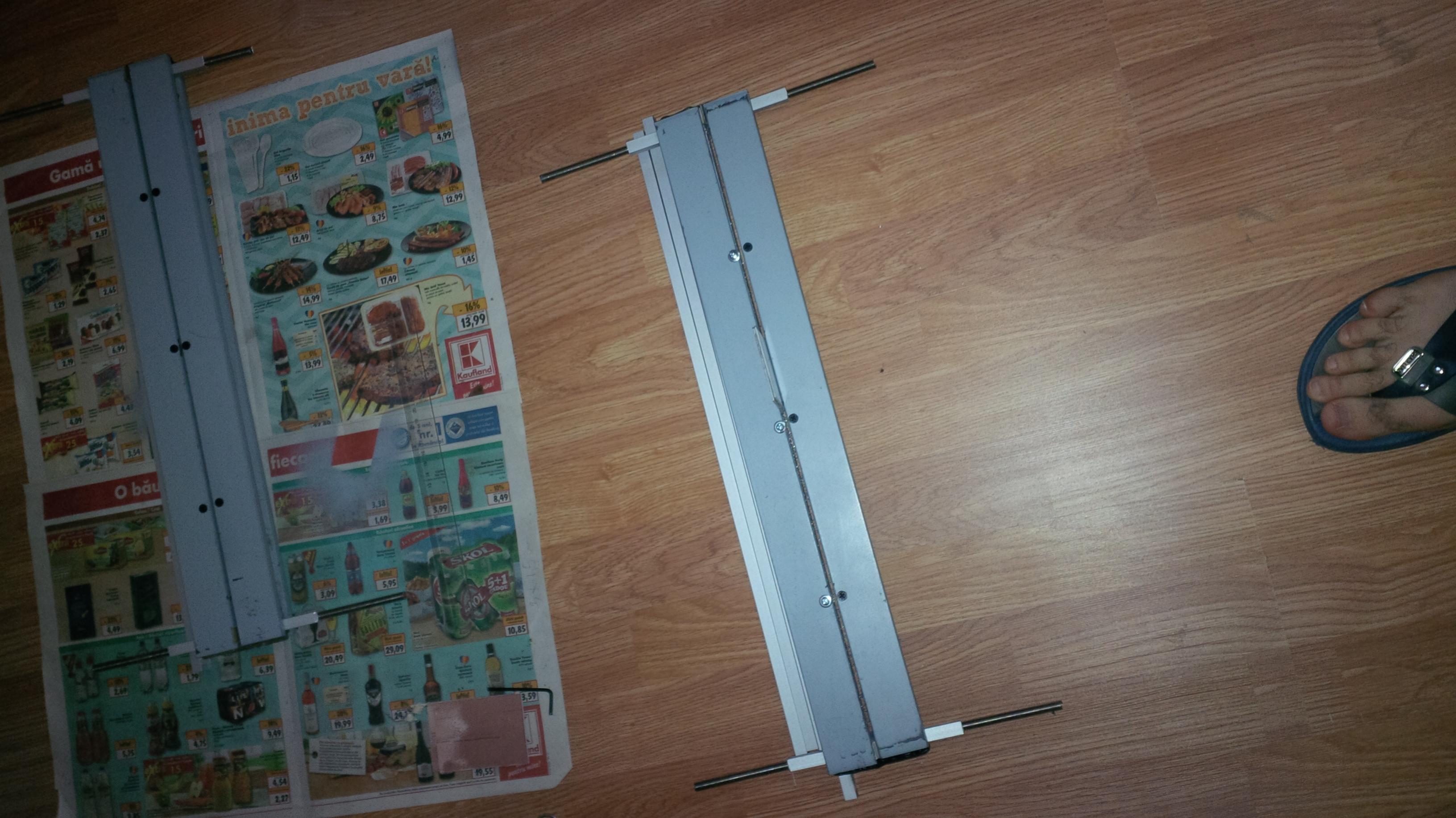

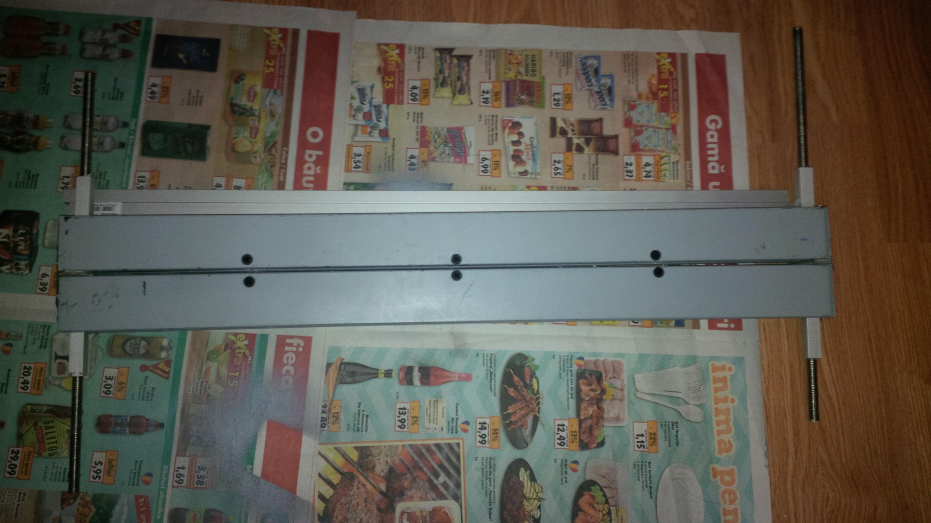

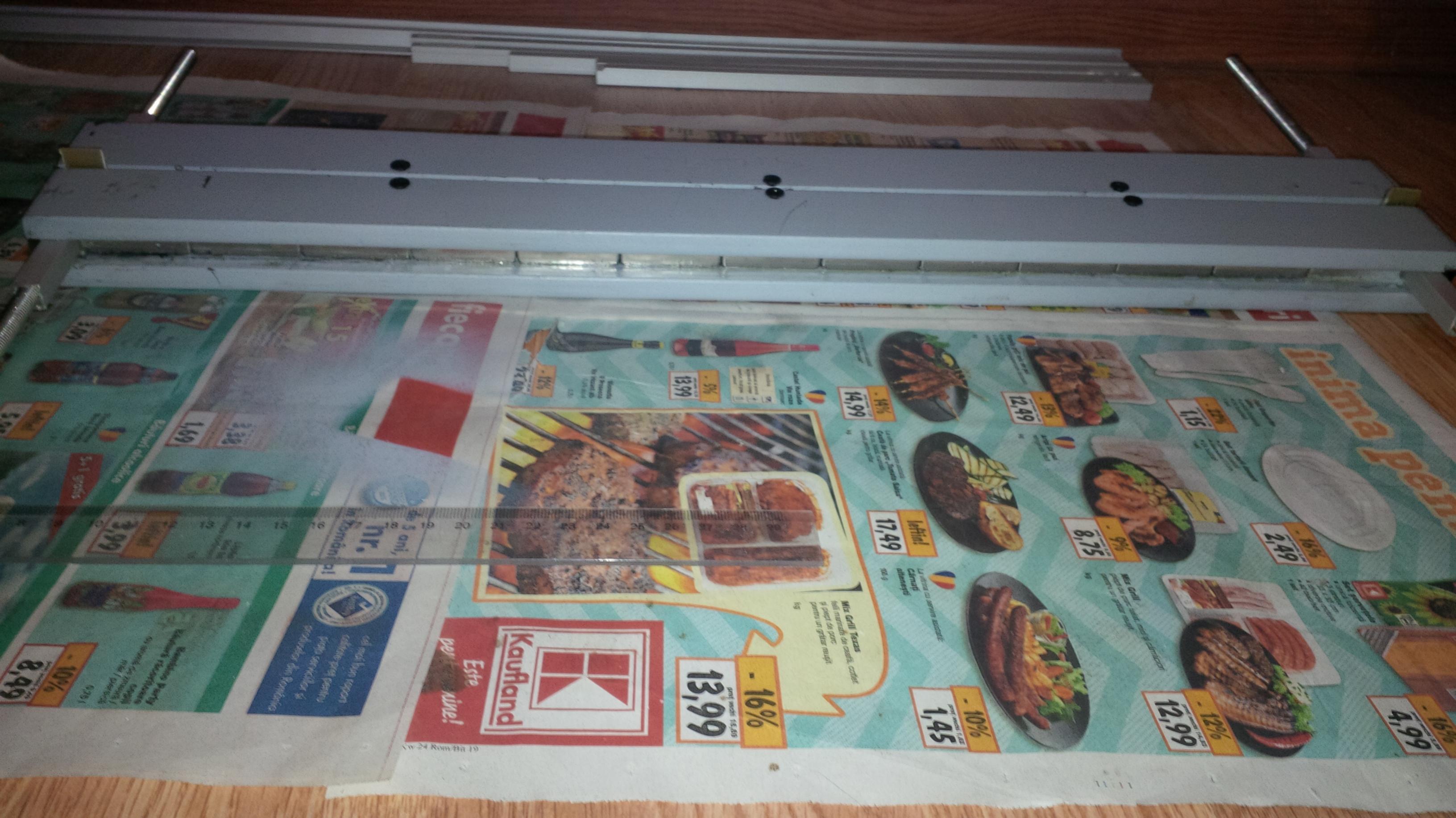

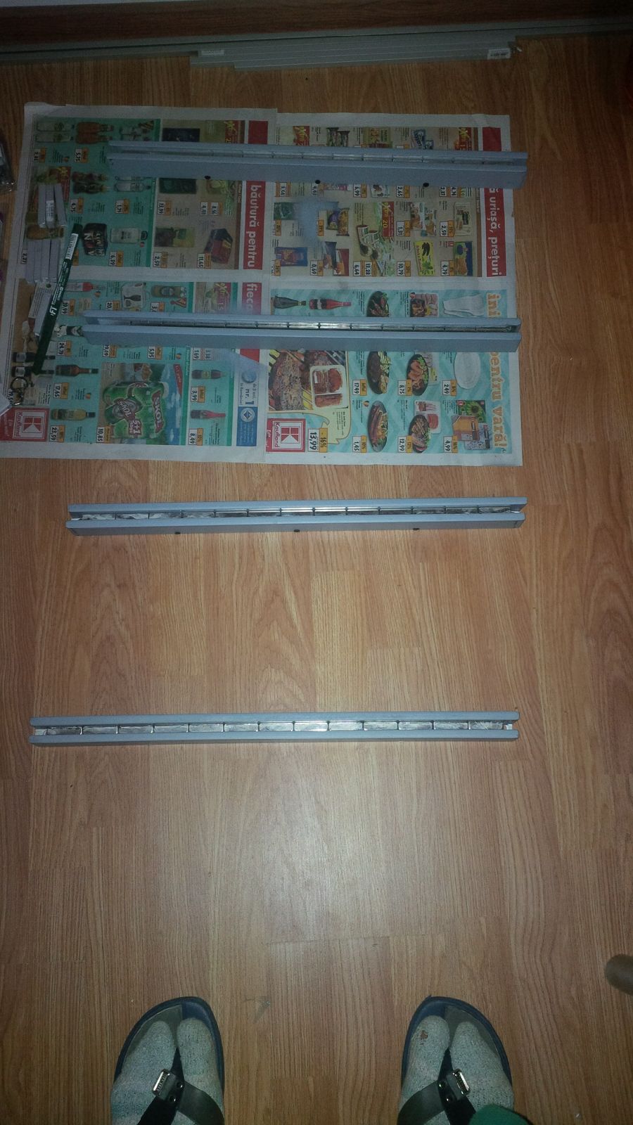

Hello again,
Wrine my friend, I think that your ruban is small and the membranes doesnt have sufficient surface to proprely damp the resonances. I cant wait for you to begin the tests again so that we can compare and improve this speaker.
Here it is some work in progress ( in the pics bellow). This isnt the final version because it has to pass the "one week test" (a french guy recomended this to me) wich means that you have to test your jig as it is in the final form for the magnet gap, my case 3.2 mm gap for one week and if it doesn bends than you can finally glue them 100%.
Unfortunally one bar just bended. You cannot see it in pictures, it is the bar with the chromed screws. If the rest of the bar bends even further than this I have to change it. The bar bended from 3.2 to 2.4 mm.. so I introduced some spacers to keep them like this till the next weekend so that I will change them all at wonce.
In the end I buyed miself 120g/sqm canson paper (the originall janus 50 had 210g/sqm canson) and a speaciall laqueur for prevent humidity not myllar or other stuff. After this week I will begin the testings. Does anyone knows a source for flexible pcb near Romania?
Cheers
Sergiu
Cheers
Sergiu

ooh wow, thats some massive magnets structure!. looking good. i hope it wont bend any more!. canson paper what is that? ill try to look it up.
about the size, i think it should not be an issue. biggest problem was high frequency if i remember correctly. almost impossible to get a flat response without heavy eq.
looking forward to first measurements!
