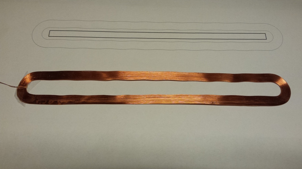

So, first coil is baked.
Resistance: app. 7,5 Ohm
Wire Ø: 0,2 mm
Length (straight wire): 180 mm
Turns: 32
Weight: 4,17 gram
Density before baking:
Baked:
Henjo

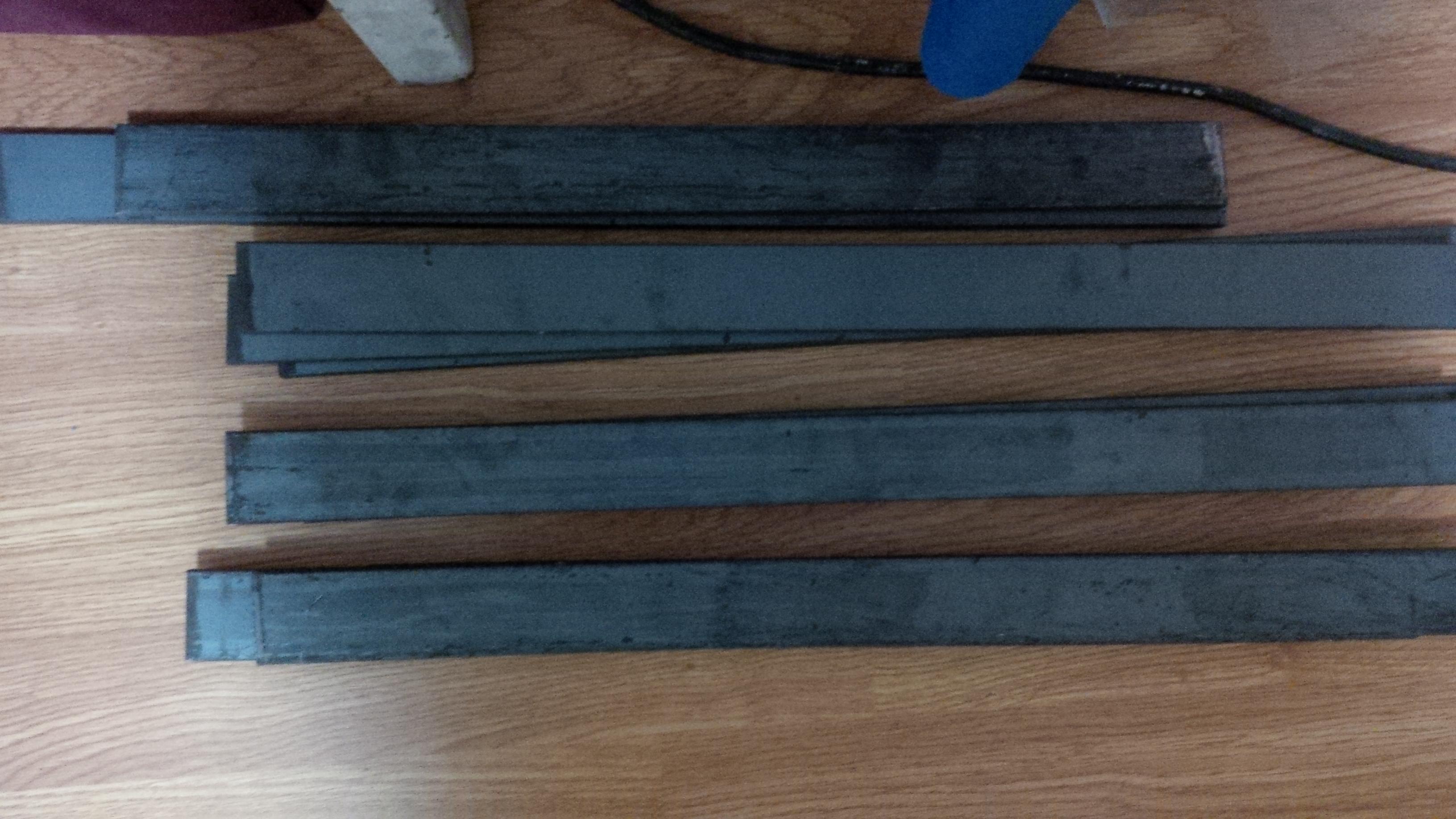

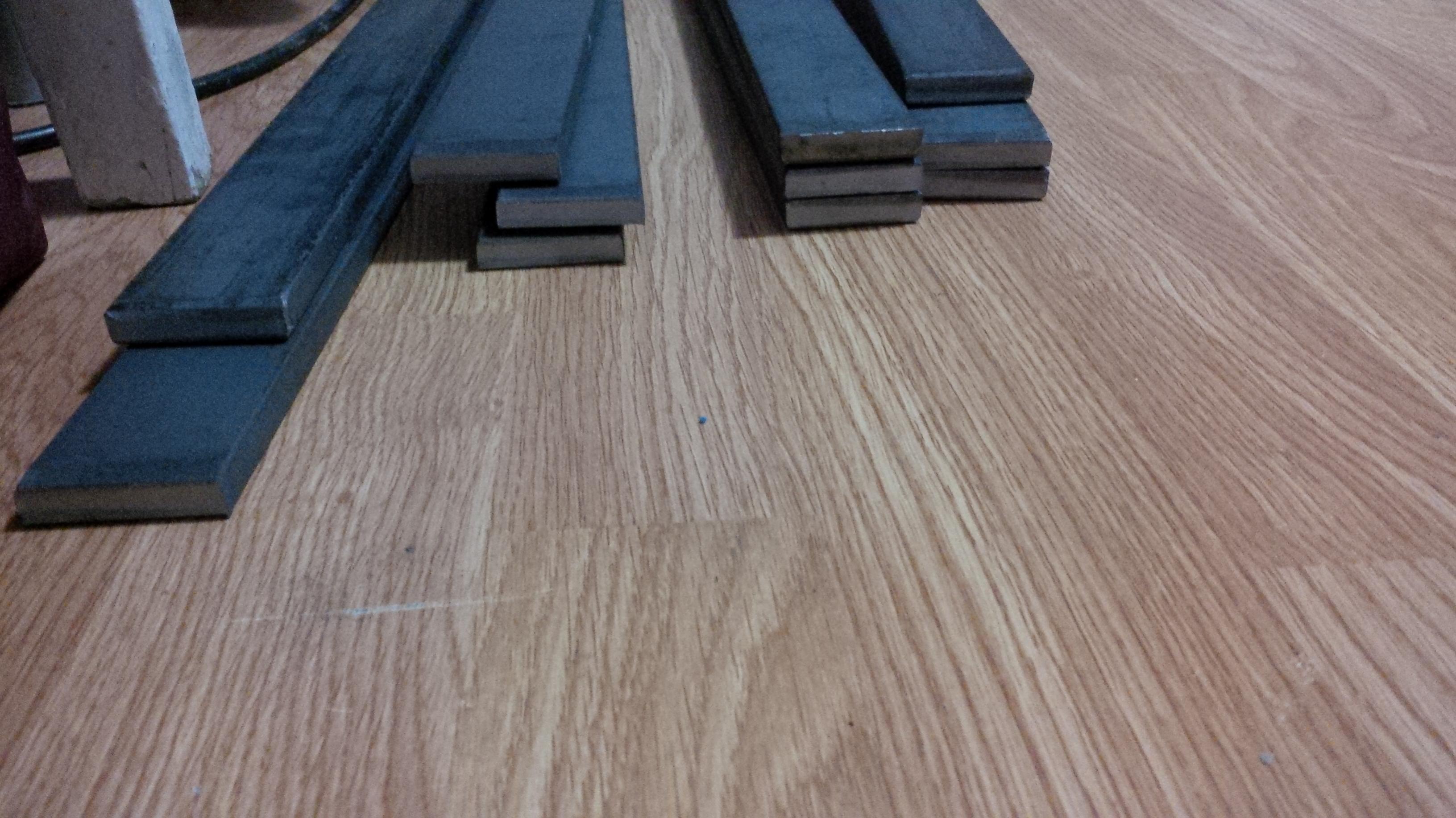

Hello my friends,
The steel bars had just arrived today, freshly cutted. They have 55cm*4cm*1cm and a total of 10 bars and a little one from a 6 m bar. I found cold rolled steel equivallent for AISI 1015 . 😉
Tomorrow i want to place an order for rice paper and cottone paper, and hope that friday will get the copper wire so that i can began the assembly.
Cant wait.
