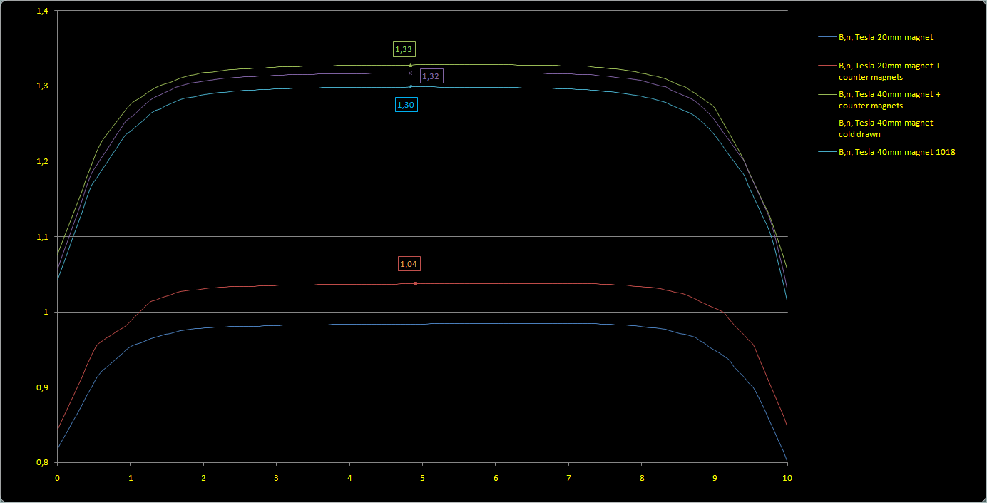

Hello my friends,
Yesterday a got a quotation for the olc15x (aisi1017) and I was blown away. I have to buy 800kg of steel because the producer didnt want to remain with stocks.... I am really sad right now.
I started to reorientate to pure iron. Can someone give me some dimensions for the above design?
I really need you help guys.
Thanks in advance
Sergiu
Hi Sergui,
I would not worry too much about the quality of the steel strip.
This determines only 1% or 2% of the quality of the speaker.
I would use cold rolled steel, which is probably for sale with any metal shop.
Here is a chart showing the differences in magnetic flux.
Use your energy for the coil and the membrane there is more to be gained.
BG,
Henjo

i think you are right about that!. if you want the same coild for instance as i used buy a solid ink printer for 50 euro with ink. and some chemicals for instance. dirt cheap but gained a solid way of making coils consistend for instance. just to name a thing. or buy beter material for membrame or glue whatever.
dont let ur whole project going to waste because of the metal. you will have sound in the end maybe few db less then you predicted. but this is a gambling anyway with materials used etc. you got 300 euro of mangets laying around. do something with it. maybe the right metal comes around and you replace it later?

Every dot is 0.5 mm.
So the Neos are 40x10 mm and the gap is 3 mm.
I've attached the corresponding dxf file. You'll have to change the file extension to dxf.
If it doesn't work, I can mail you the femm file and dxf file. PM me your mail address.
Otherwise I agree with Wrinex, a local metal shop is the best bet to get the steel. Perhaps they even can make it from the dxf file.
