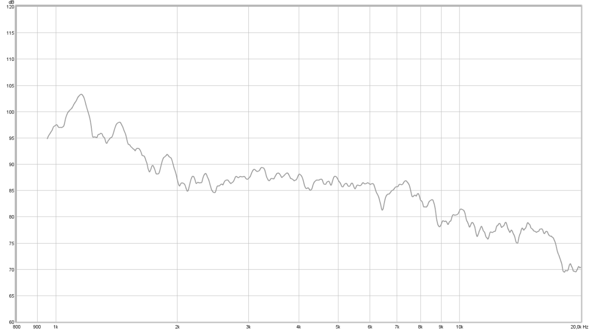

looking nice, but do you got any measurements ? since im worried about weight and high frequency responce on ur design. and maybe im wrong and i can beef things up to
Ok, if I can find some time today i"ll do a view measurements.
At the same time I can test my measurement app. on the phone.

i used mini dsp as well. mostly for test purposes. i got bunch of TPa 3116 boards that i would like to put to use for once. but in the end if i could make it passive i would do it right away. thats why i want the best freq response without using my minidsp. i could easy get rid of the peaks and dips with the dsp. but thats not the the trick 🙂 dips and peaks usually indicates something is wrong or just to heavy.
reason for passive is that i might want to sell some complete speakers, and i rather make these as simple as can be(for theres and my sake ). like 6db oct filters or maybe 12db. most people love to use there own amplifier. also with 4 hypex and a minidsp things get expensive fast.
btw weird you still got to almost 20 khz with such heavy membrane. some heavy eq in the mindsp to get to that verry good looking end result there.
you system faslls off from 500hz as well. its weird, my small one did that and the big one to.

Btw what grams/m2 did you use first and now ?
because im thinking of using or trying aquarel paper hot pressed. maar dat is alleen vanad 180grams beschikbaar
Yes the heavy membrane was heav(enl)y DSP-ed.
But the end result was fabulous.
Never heard so much space and "be there" in a DIY system.
My first one was 200 gramms/m2.
For the small one I use 120 gramms/m2 (heavy pressed aramid paper)
Here a Q&D measurement without DSP.
The low end From 400Hz could this be the cancelling out of the dipole?
