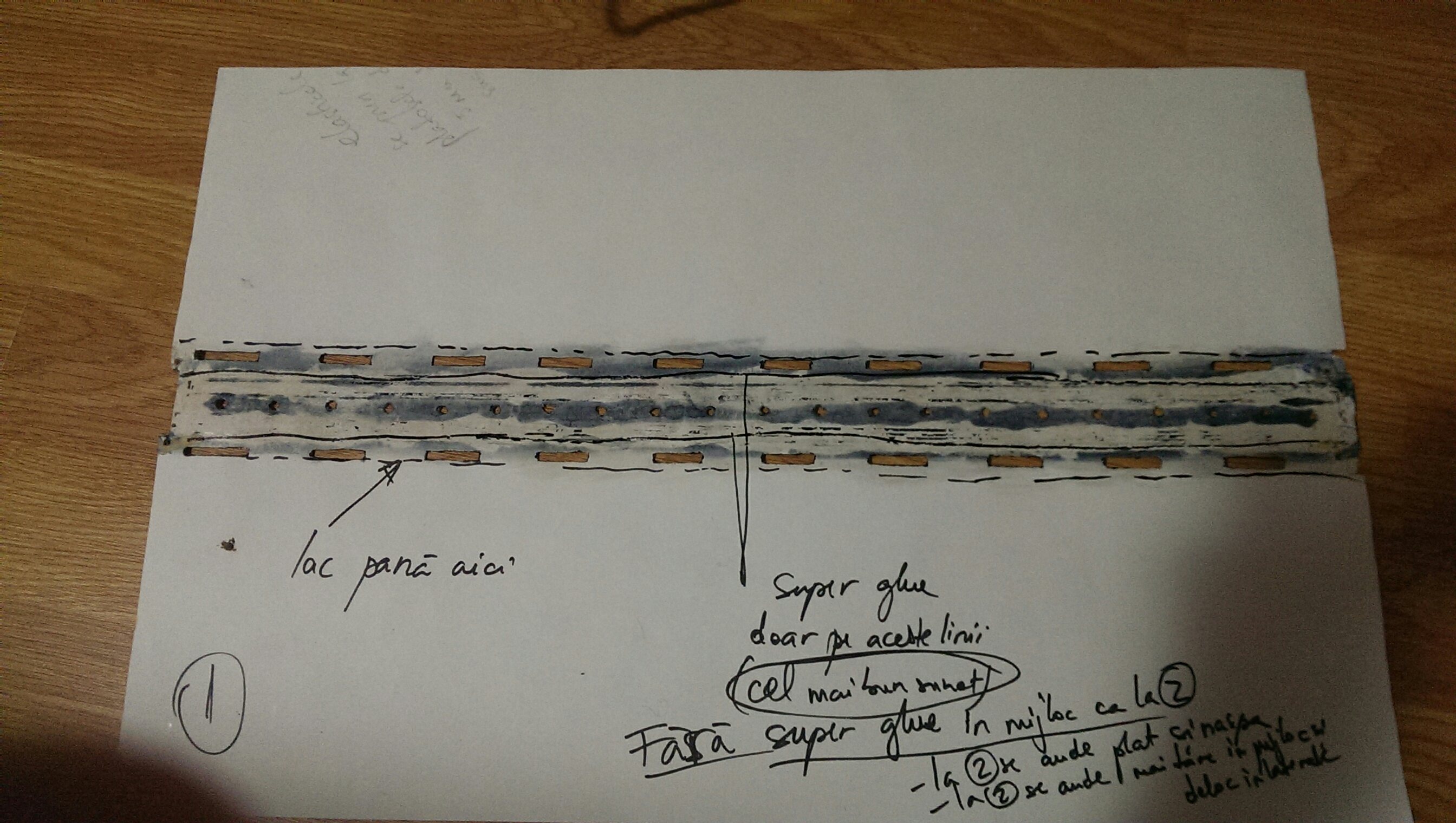

First of all i want to tell you something that it was used allot on old papercone tweeters and the ones that i have in my old speakers are paper cone. The thing is in good old times the engineers laqueured (very thin) 20 to 30% of the membrane of the tweeter from the coil to otside the dust cap to extend the top end, and that is what i used first time, and i was right. Thats why the ruban sounded so refined and microdetailed. Look at the pic bellow. You cannot see because of the low light but there is concentrated laqueur on all the coil and it extends outside the coil to the exteriour edges of the cuts (i used interrupted black lines to show where it extends). I used a very thin layer of laquer here just to saturate the paper snd to make it resonate to hights.
In my first version i used super glue only at the laterall edges of the coil (where you see the continous black lines). On my second version i surrounded my coil with super glue (black continous lines from first version+ at the top and bottom) and putted dots of super glue between the wholes from the center of the coil. The results for this second atempt are dissastrous.
Tests takes me very few time, as now i know exactly how to center the coil, the cilinders, make cuts, adjustments, i have another 14meters of paper to test with..BUT the biggest time takes me to do the coil( 2hours or more) and bond the whole thing (another 2 hours). The bonding has to be perfect, and perfectly alligned, or else it would caise some serious trouble when aligning the cilinders..
My bigest prob is the production of the coil...

BTW one thing is hard to tell since you opted to use every patent in the book 🙂 is where stuff works and where it does not work. i would be happy to send you some coils when you got your mic sorted out. because of this.
I cant test all options alone, and if we for our self want to be clear what works and does not work should test it. when you use every trick at once you wont be able to tell what works and what does not work at all. and i bet there are quite a few of these patents that just not justify the effort.
For me for instance cutting holes int he middle part between the 2 rows of traces did not results in more high freq but less. cutting of the backside did work, cutting of the remaining 1 cm of paper that was still being there doing nothing resulted in another 1.5 khz . i think the trick is it has to be really really rigged from coil to the arc's since this is how it transports the high's to the rest of the membrane, the more you cut in it the less rigid it is gone be. i can imagine where you cut the pieces out in the front next to the coil need some sort of reinforcement just so you did lose weight but increase rigidness as well.
Yes i use the patents but only the things that improves hights and lowers the mass as this is the key for further improvements. Lowering the mass too much improves the hights quite well but dont favorise the lower end. It has to be just right.
My strategy is to first find out wich is the best "cut" or wich cuts are better and wich not. Then test double coil vs single coil, and at the end i want to test just for my amusement a 30gr/sqm paper with double sided Al coil made on 120gr/sqm former with all the hinges and cuts included just to see how it works, and then the supreme test use silk or rice paper (has also 30gr) in the same arrangement as the standard 30 gr paper. Try finding a method that works and write everithing here so that others will do/ try and then save all this thread to a word dock and print it because im too laisy to write two times. This is what i plan to.

i can tell you this, the cylinder itself needs to be rigid and usually heavy(damping)the center must be rigid and light. 30 grams from where they meet to where they are fixed to the structure is not gone work. i tried washi paper and the results where terrible. 🙁 when you play low frequency's the cylinders are gone wobble instead of making a normal forward motion
This last variant has more than 3mm moves. I measured and reaches 4mm at peaks with hinges and the elastics with no filter.so it is no prob. The secret is that you dont have to glue them on all their surface, you have to glue them only on the half (or more) of their surface wich then is sticked to the metal plates. This way the coil moves more freely. The hinges also keeps the coil always centered and in the gap and they always needs to be allinged with the coil. Now i figured out that they have the same role as the interior cuts. Also in my case i dont hear any hights coming from the top and bottom but somehow they contribute at lowering the overall mass of the coil and this way the coil moves more freely and produces more mids and hights. The only cuts that really produces sounds are the cuts outside the coil from the front and back. When those cuts are very close to the coil they boost the hights but when you increase this space you lose hights thats what i discoverred but didnt noticed if you gain mids because of the lack of measurements.
Thats why when you cut the rest (the surplus) of the back you gain more hights.

what weight is the current paper you use ? if i may ask ? it looks rahter thick
120gr/sqm canson paper. The 220gr/sqm was used by Francois Deminier on the originall Janus 50 but comsidering that o dont habe those bigger magnets and the originall steel i used this lighter paper. And another considerent for this is that the french guys from the french forum used this paper with succes with the original magnets and steel and gained some more dB. 😉
So my conclusion is that we have to lower the coils internal mass so it will move more freely and extends the hights, and then find the right combination of external cuts to boost outside in front and back the resulted sound.
