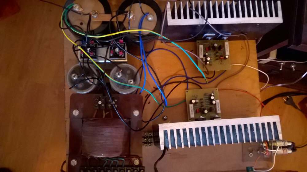

A few pages back I showed you my Apex A40 and for several years listening was the best amplifier of all I compared it. Apex plays much better than factory amplifiers for a lot of money.
That's why I started a new project.
I start building 2 mono block with A40 circuit in bridging mode with 2 wires per bridging channel.
I think I'll lift the rest of my life and I'm convinced it will improve the sound.
In the process of building I will show here step by step.
Here's the beginning.

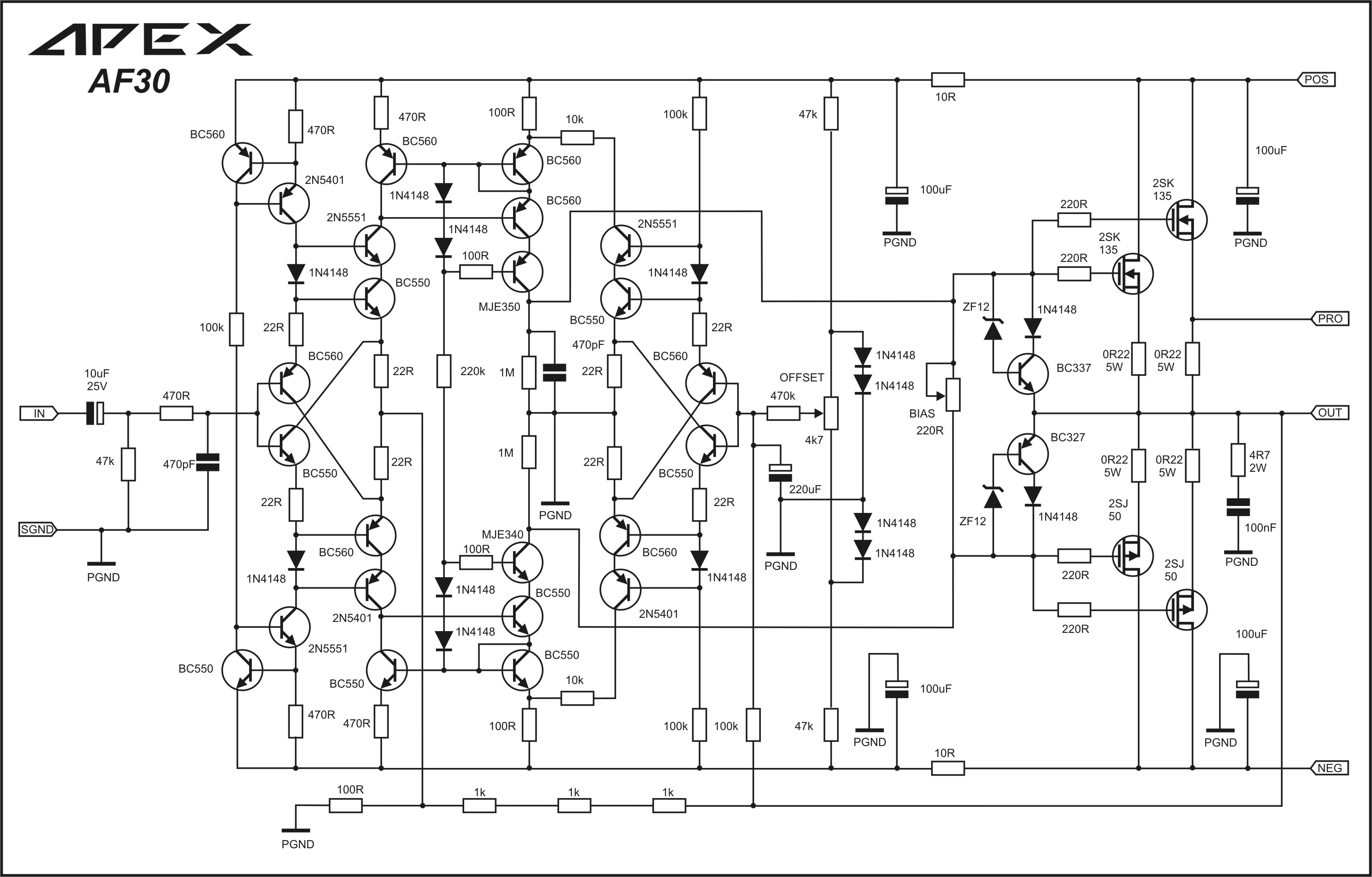

I chance upon this thread and wonder if APEX got any design that uses 2SJ50/2SK135 mosfets, as i have been keeping a batch since i was a school boy.
Now its time to put them to good use.
Thanks for any input or directions.

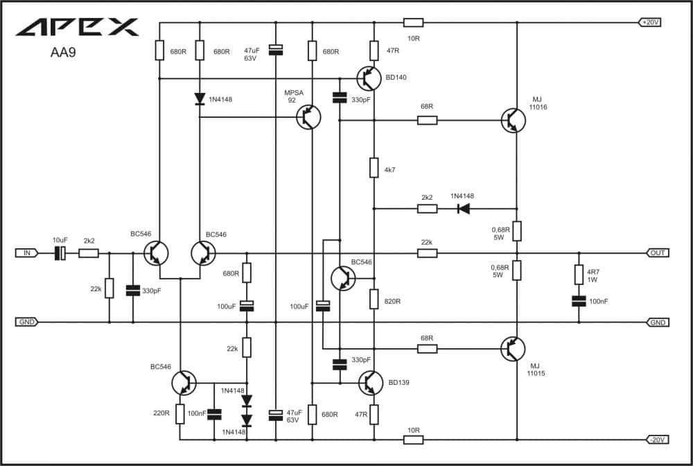

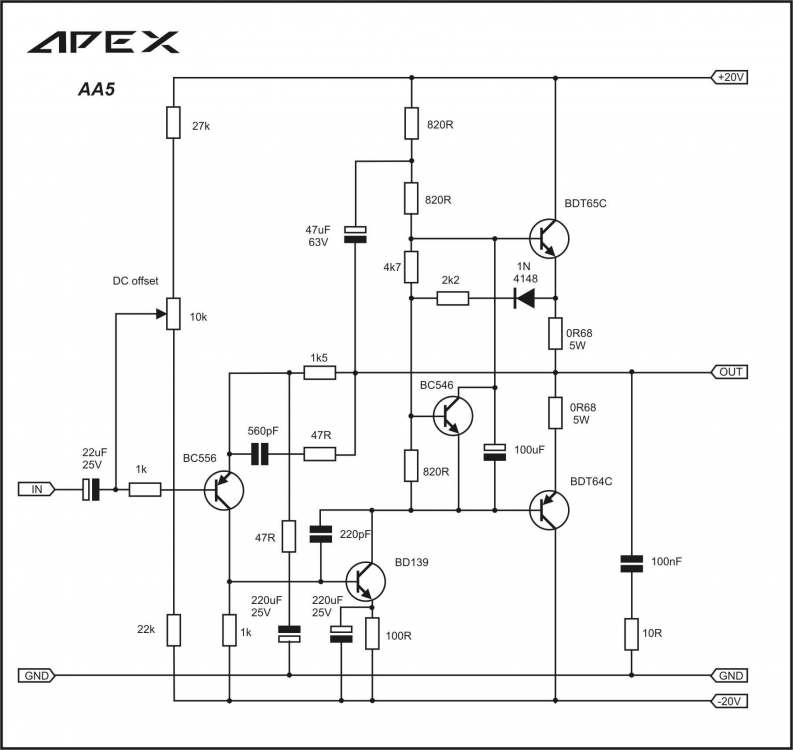

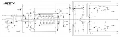

You can use output stage from AA14 or AA9 and use it instead diamond output stage of A40 if you want. There is AA5 class A amp with single transistor input.
