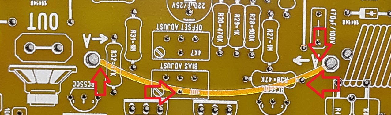

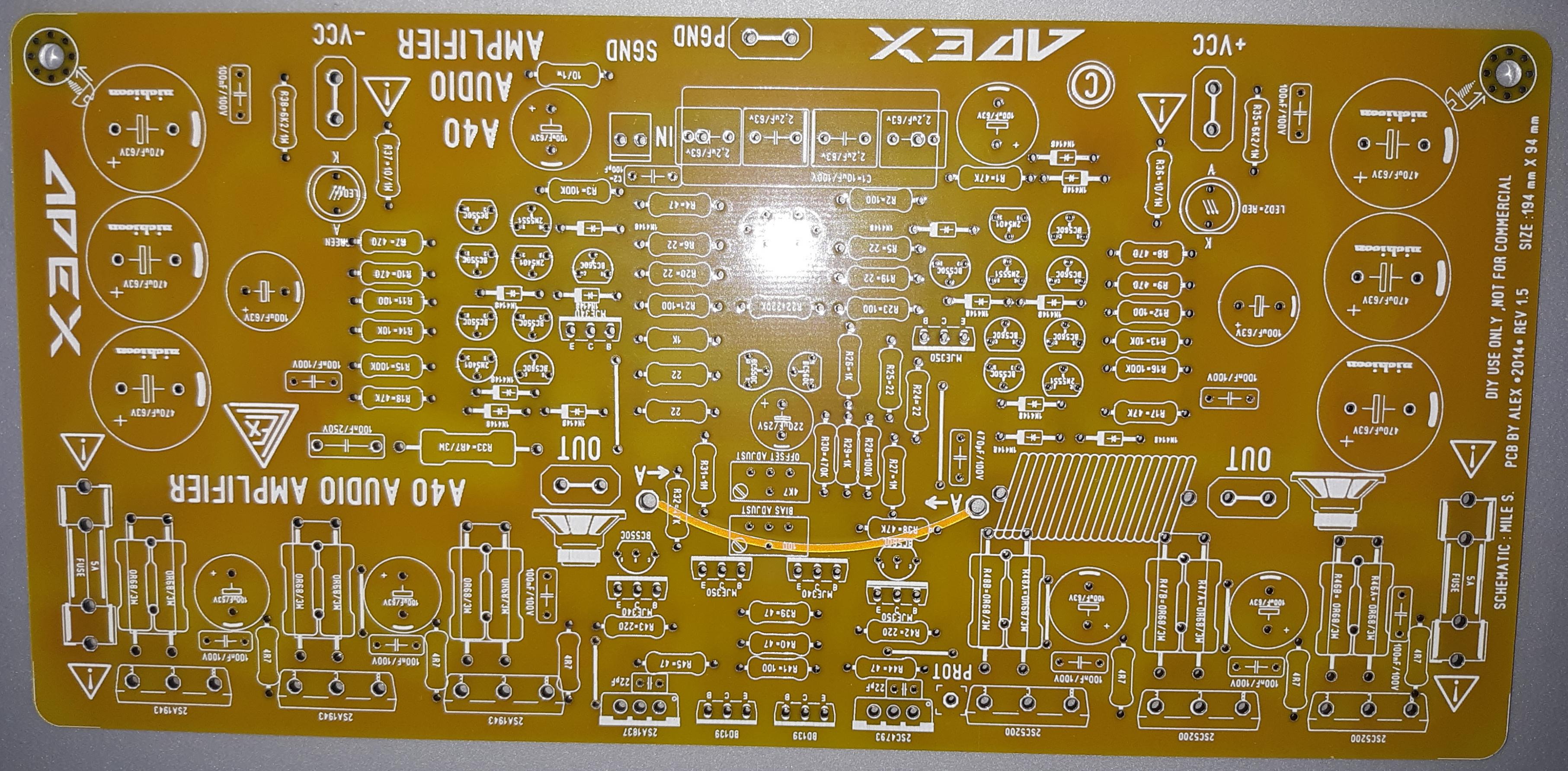

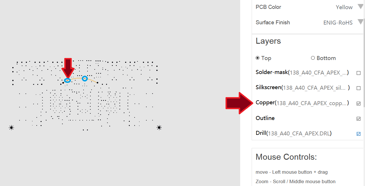

I don't know if this is the best place to post but I would like some advice/help with A40. I went ahead and ordered the PCB attached in the A40 build thread but it looks like there is a problem.
I have attached pictures of shorts on the front side.
I assume I should dremel away the top copper trace. (The gerber files in this thread have a top copper layer with one copper arc.) It looks like the amplifier will badly malfunction with the shorts to the bias trimmer and resistor.
Perhaps this post can serve as a warning to others regarding the gerbers in the A40 build thread. I hope that the amplifier works when assembled with these PCB after the dremel fix. The parts are fairly expensive for two of these boards so I hope the gerbers attached to this thread are good... If there are other problems with the gerbers I would appreciate a warning before I waste all the components and time assembling this.

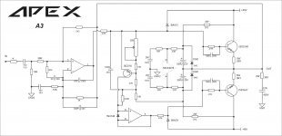

re you sure that in Apex A40 exactly bd139 should be on the radiator? They are in the mode of diodes... Maybe those mje340/350 that are connected to them in series
