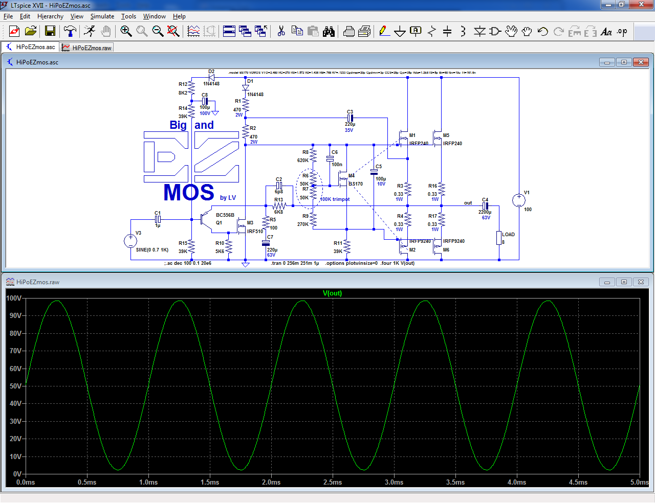

Would it be possible to modify the FX 4 to run off IRFP240/9240 mosfets ?
You would get an FH5, based on Apex naming convention (not an actual amp, yet). That’s where the FH9 came from: FX8. I modified the FX8 to use hex FETs. The switch to hex FETs requires addition of a VBE multiplier to compensate for thermal runaway. This adds one more active. The nice thing about FX4 is that it is a singleton input stage - gives dominant second order harmonic distortion.
It could be done but would require a simulation.
Thanks for the reply. I do prefer the sound of a singleton input stage and I have a large 0-80v 800VA transformer lying in my office which would give a dc value of 113v and a couple of IRFP9240 and 240 fets given the price of latfets has gone through the roof. I was thinking of building the EZ MOS by LV but this also a simulated amp or maybe use his Vbe multiplier in the FX4

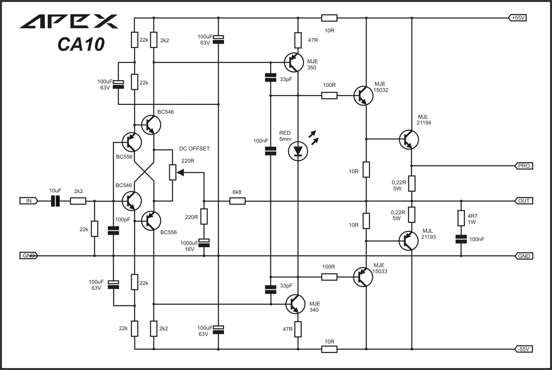

Can anyone please tell me what PRO prefix stands for on some of the Apex designs.
Eg on the A40 and ca10 amps it is between the POS and OUT pads.
Thank You,
Graham.

Hello,Can anyone please tell me what PRO prefix stands for on some of the Apex designs.
Thank You,
Graham.
link to ca10 schematic:-
https://www.diyaudio.com/forums/att...00w-ultimate-fidelity-amplifier-apex-ca10-jpg
Can anyone please let me know how the protection works ?
I assume is connects to a separate circuit which would cut power to speakers or amp.
If there is an Apex circuit for this can you please let me know the name of it and I will look for it.
Thanks again,
Graham.
Ps I am planning to make some Apex A40's
You’ll have to search the Apex thread for his speaker protect. It’s relay based if I recall.

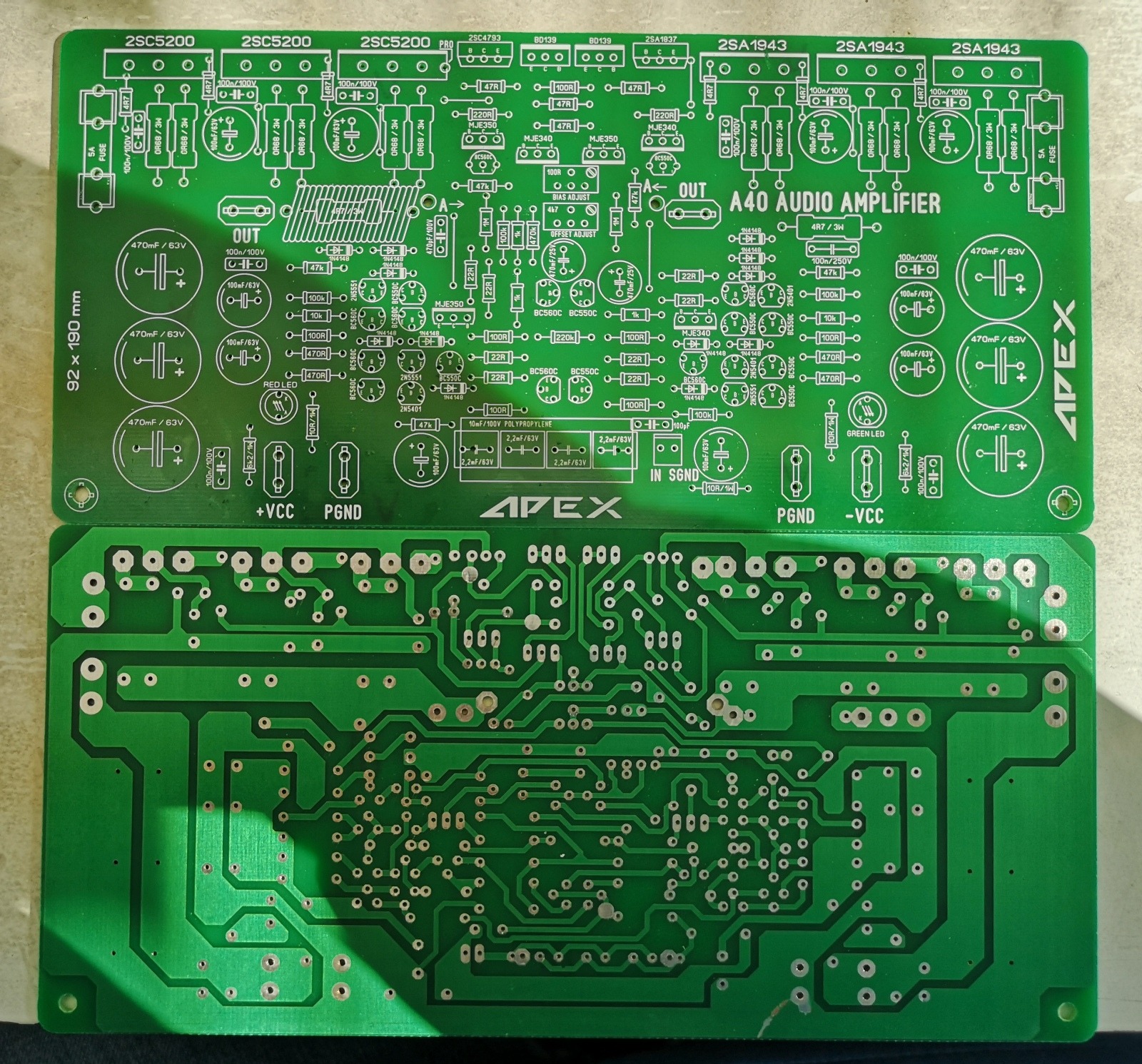

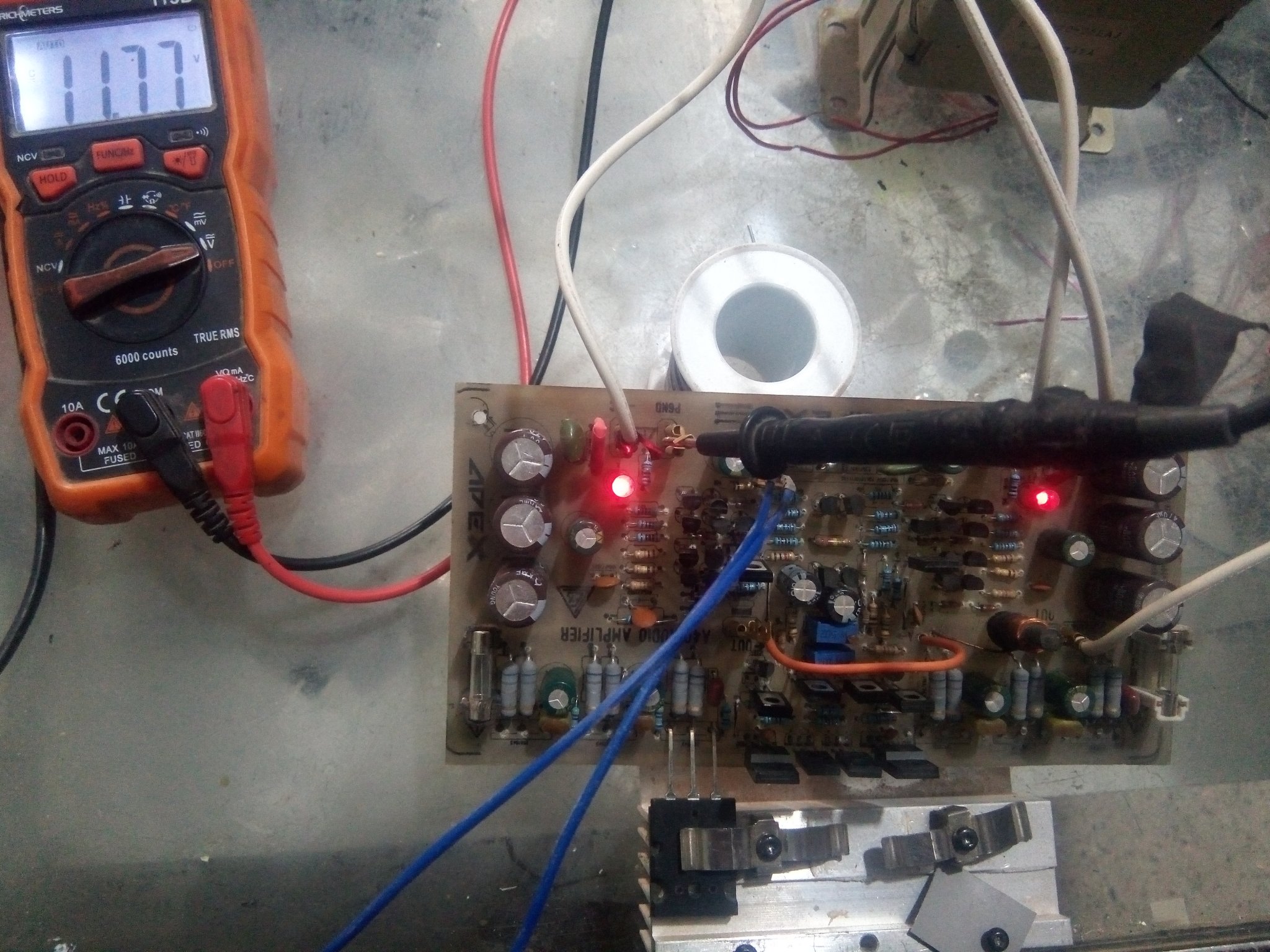

hello everyone
i had my eyes on an apex amplifier for a while now, after seeing a number of successful attempts on this site, i decided to have my go at it, so i printed the motherboard (PCB) at home - bear in mind this isn't my first project - and it turned out pretty good in my opinion, afterwards i wanted to test it, so i used one power transistor 2sa1943 to minimize my loses just in case. and started testing, i found 25v in the emitter and 12v in the output, which is really unusual, its usually less than 5v in the emitter and less than 1v in the output, i kept looking for the error but to no avail, but i have my suspension on two things:
-the 5 KOhm offset adjust variable resistor set on 4.7 KOhm.
-the 500 Ohm bias adjust variable resistor set on 100 Ohm.
and I'm still not sure.
i really need help completing this project. so for anyone offering it here's my questions for you :
-i usually find the SGND and PGND in the same spot unlike the apex's datasheet displays, what would happen if i put them together?
-other then those things what am i missing here?
