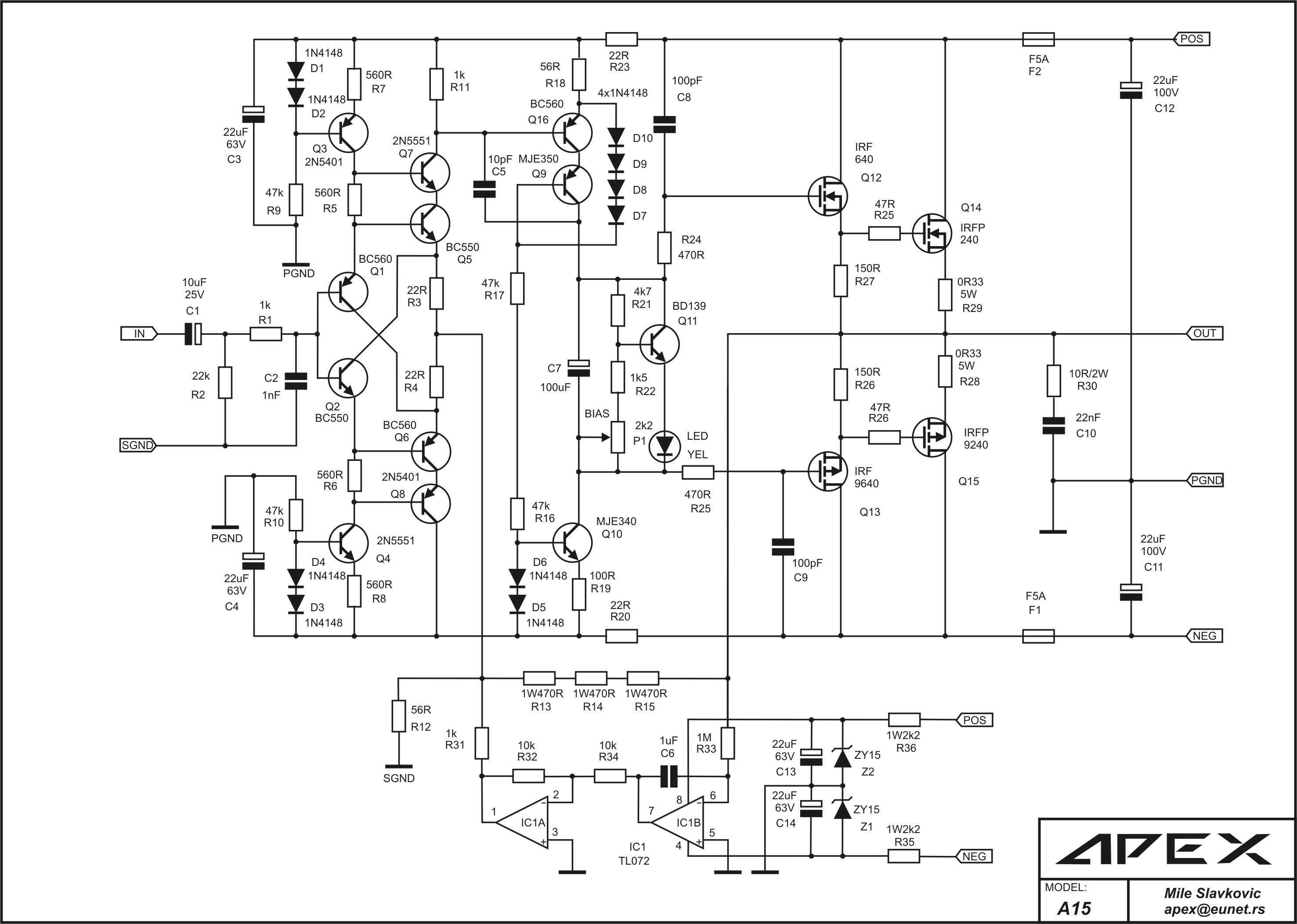

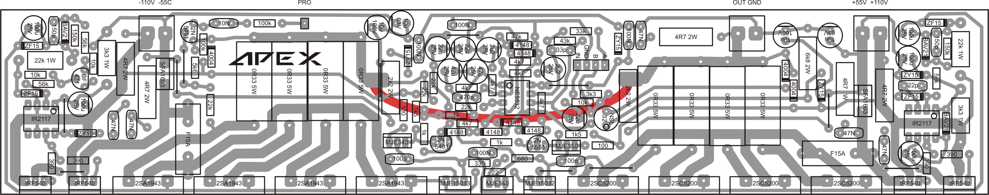

I ran across this layout for an "Redesigned" Apex B250 online, looked like a nice build and I was wanting to try it.
I have this PCB artwork and a component layout/stuffing guide, but I can't seem to find a schematic that matches this layout.
Can anyone help me please?
JohnR
Reactions: stewin and 44250
@ Yurik_V,
that schematic looks pretty close, minus a pair of outputs/emitter-resistors, and I don't see an LDR on this layout.
also, the Input connector labeled A B C IN, looks like C is signal Gnd, but does anyone know the purpose of A + B?
and the PRO output from the 2N5401?
JohnR
