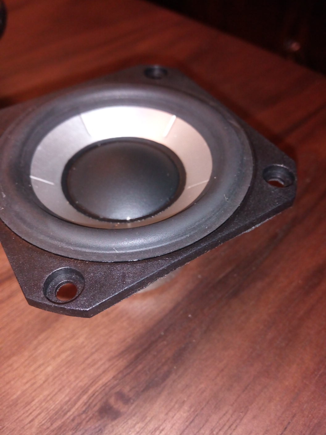

OK - Finally the SB65s have arrived!!

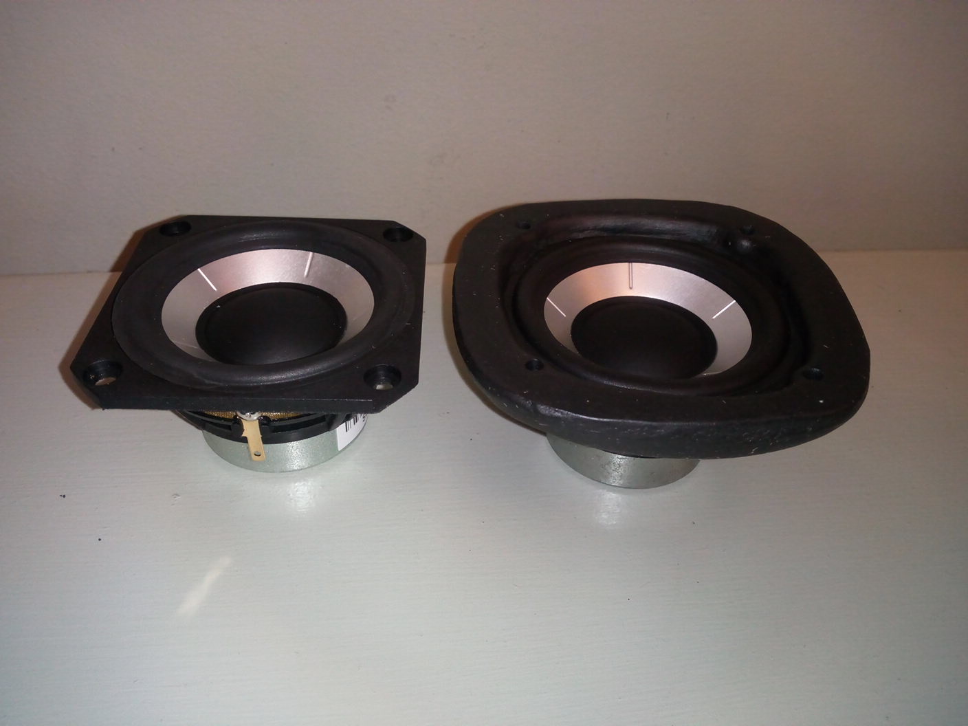

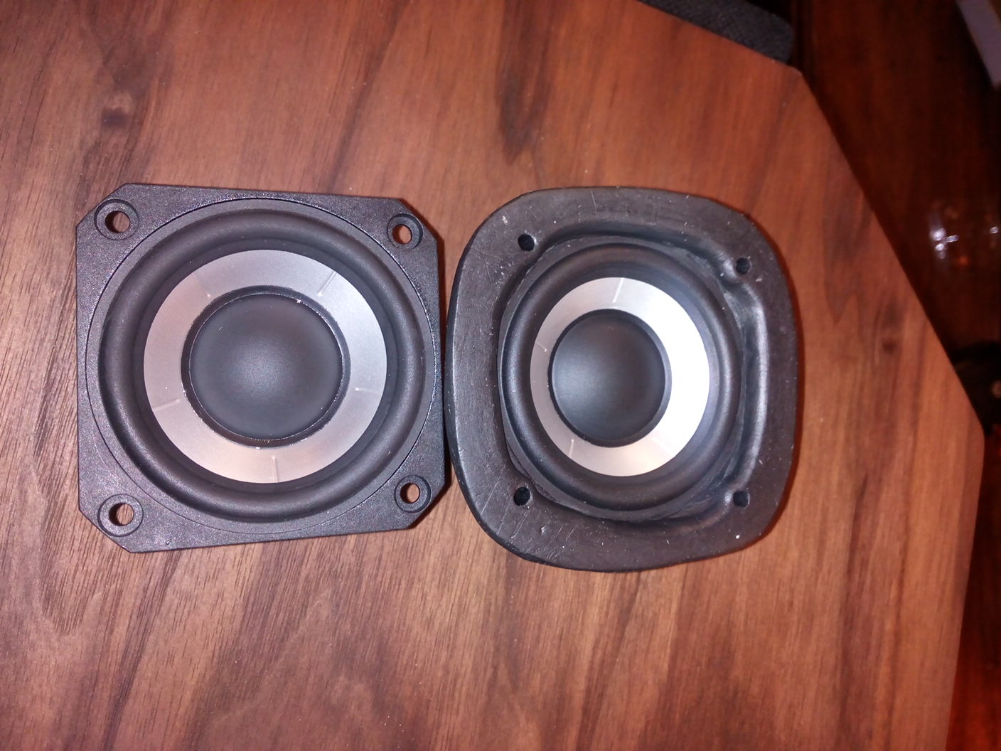

I have spent some time trying to work out how I will be able to mount these solidly and without any air-leaks to the horn with such a tiny 'lip' to work with.
The lip is only 1mm wide and 1.5mm thick. I was going to have to cut an incredibly accurate circle in plywood then mount it perfectly centered, then somehow sandwich a compressible gasket between the two without compressing it beyond the 1mm lip so it doesn't foul the surround....didn't like the thought of that!
I therefore came to the conclusion that if I could somehow build up the driver frame with epoxy putty to form a raised gasket with a decent strength and size to sandwich a sorbothane gasket........it might work.
So here is my first attempt. It is bonded to the SB65 frame and marries perfectly to the smooth throat I routed to the horns, so hopefully will provide a diffraction free union.
Just have to make the other one. Let them fully harden. Sand them a little to neaten them up, then fit sorbothane gaskets and mount to horns.
Then......measurements begin. 😀😀😀

And you said X is fast! The drivers are only here for mere minutes and you've already customised them 🙂.

Nice work on expoxy frame. I found that the little 1.5mm lip seals just fine so did not mod my bezel. All that epoxy may have side benefit of reducing frame buzz or vibrations.

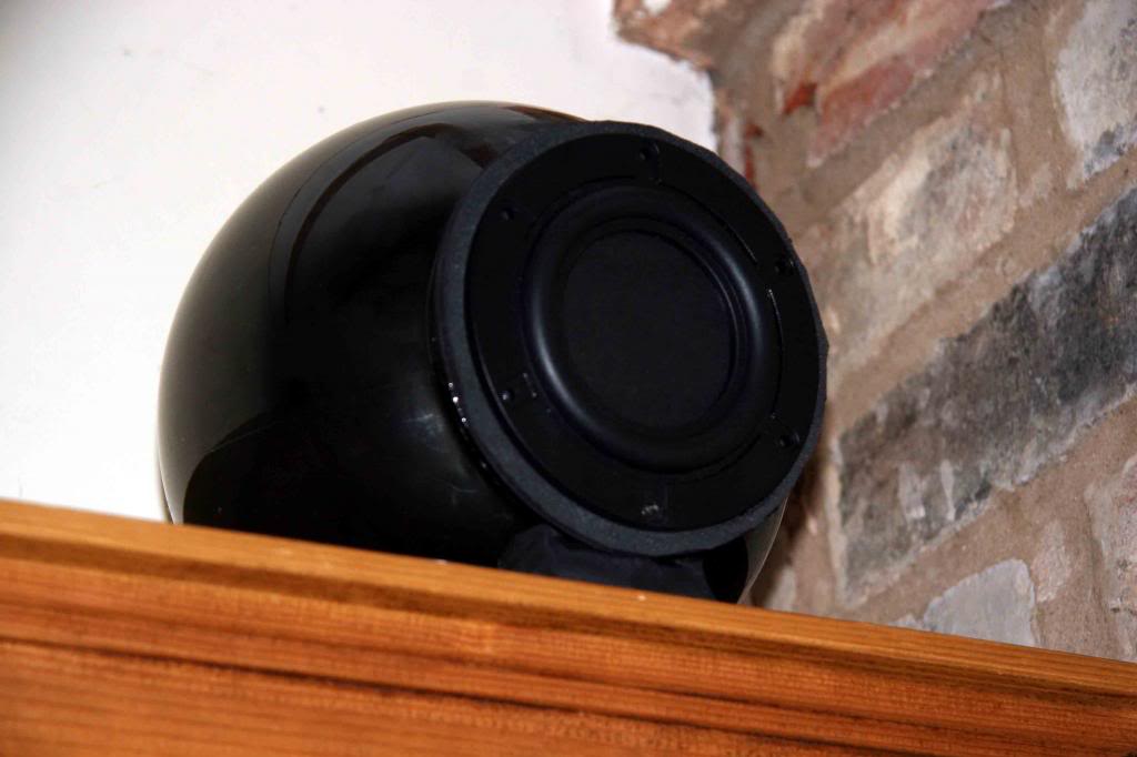

Sphere with damping in the middle of it would not exhibit the bell mode, would it?
After all, the speaker isn't in the middle of that shape. The damping should be. Plus I'd use wool felt on the walls. But that's easy for me to say because I have it available.

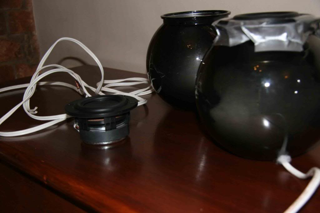

I know a sphere has the worse bell mode - but all my 'sphere enclosures' are divided in half with a vertical brace running back from the driver - this effectively creates two hemispheres which are surprisingly mode free. The other option would be a dagger enclosure like yours of course - funnily enough I came to similar findings as you regarding this shape.
When optimizing the sealed mid chamber for my 12MU in my three way build - I experimented with loads of enclosures and found a simple tube with a rolled stack of felt at the end - staggered to create a kinda dagger shape - was the most effective.

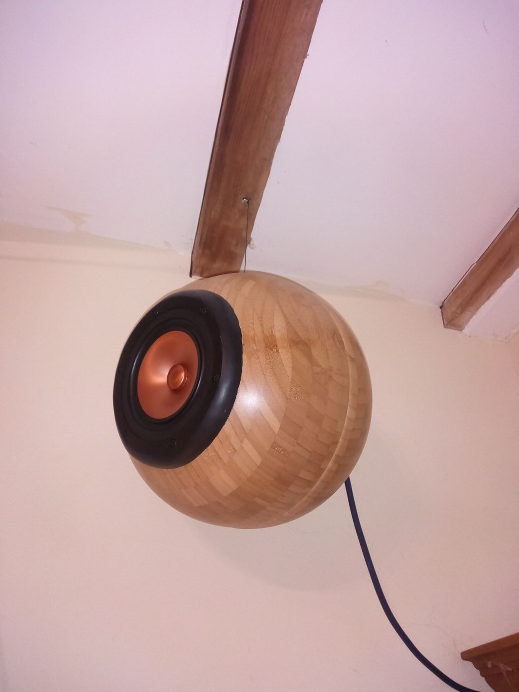

Wesayso - A sphere does suffer with a single overwhelming dimension (and therefore mode) - it's diameter, but you are right, this mode can be easily almost completely suppressed with a good stuffing of fiberglass!
Great idea! I see you are already an expert at minimizing parasitic effects that can muck up an otherwise perfectly good response. I am keen on trying sorbothane too.
Wesayso- absolutely! Too many people forget that. And also don't realise how good densely stuffed fibreglass is.

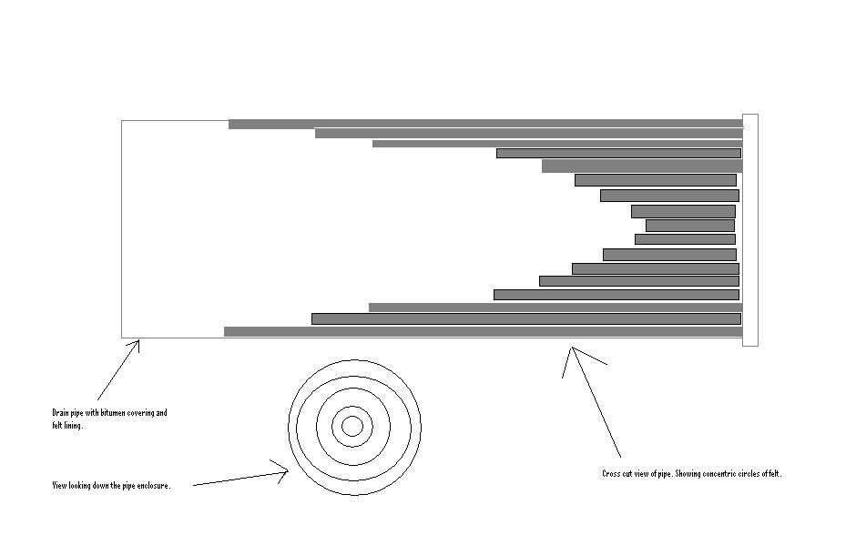

Xrk- the beauty with the tube and rolled felt, is, it is easy to quickly make, the tube is very rigid, and the felt not only creates the dagger absorption shape, but the felt itself absorbs some of the rear wave.
When I stuffed the tube with variable density fibreglass - loose behind driver to firmly packed at the apex of the dagger void, it sounded better than anything else I tried.
When I stuffed the tube with viable density fibreglass - loose behind driver to firmly packed at the apex of the dagger void, it sounded better than anything else I tried.
I found that nothing sounded as good as a Dagger stuffed with fiberglass. The spiral tapered Nautaloss was just as good reflection wise but a much larger volume. Some drivers like the 10F like a small 1.3 liter rear chamber. I could not measure any back wave coloration from the Dagger and the HD was very low. The impedance confirmed how clean it was. I really like your simple rolled felt design. Instead or concentric rolls you can cut a triangle and roll it continuously for a felt dagger. Rolled up sheet of triangular corrugated cardboard topped with a cone of felt might work too to save on cost of felt.
Yep - that's how I did it - a long triangle of 3mm thick wool felt, rolled up.
I also found that a stiff, rigid, plastic pipe 3mm thickness, reponded incredibly well to 4mm extensional bitumen damping.
Completely 'dead' to the knock test. Much better than similar damping techniques on 18mm MDF/Ply.
So all in all, it makes for an excellent mid/full range enclosure - particularly if it can be hidden away.
