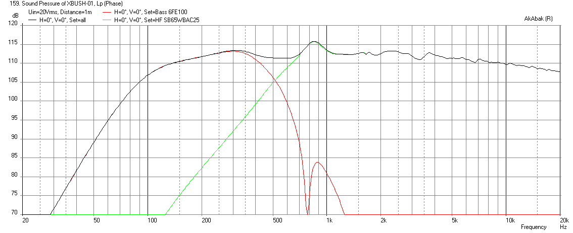

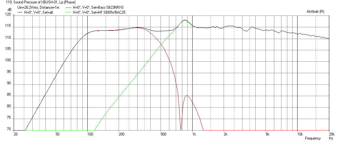

32mm dia holes with SB23
Ok, so I am eeking everything I can out of a smaller hole. Now at 32mm qnty 4 and I moved the port to 5cm from the horn mouth. The smaller port shifted the tuning up a bit so f3 is now 89Hz. Max SPL is a formidable 113.6dB. So basically I think this driver can work, and if you like small injection ports, 32mm isn't a bad size to stick 4 of on the wall of that pretty big WG.
Ok, now onto a sim with the 6FE100...

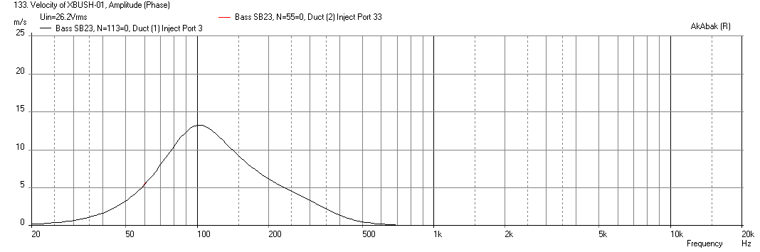

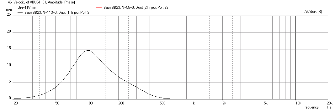

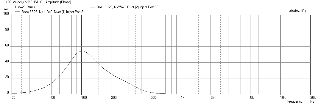

But before we go there I had a sneaking suspicion that the velocity from an 8in woofer going full bore through a couple of 32mm holes isn't going to cut it. And no it doesn't - velocity at xmax is a screeching 50+ m/s = a recipe for chuffing and wind noise. At 65mm dia it is a much more reasonable 13m/s. There are tradeoffs everywhere. Maybe we are just pushing this little guy too loud and need to stay below say 105dB or so? That way, you can use smaller drivers, smaller holes, etc...?
Here is injection port velocity at max SPL for 32mm dia holes:
Here is injection port velocity at max SPL for 65mm dia holes:

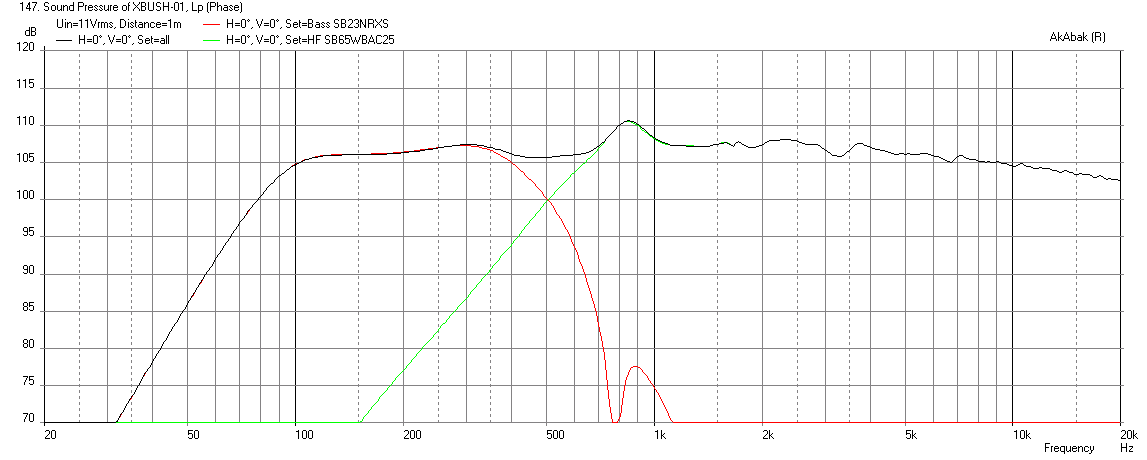

So.... if we widen to 40mm dia port hole AND ease off on the juice and go only up to 11 volts (heck my, little TPA3116D2 can do that) we get 106dB SPL and 14.7m/sec max velocity. On the top limit of wind noise.
The moral of the story is: If you want 113.6dB max SPL, you need monster port holes, if you can live with 106dB, the 40mm hole is quite doable. Although, to be fair, a curved arc slot may not look so bad to achieve same CSA as 65mm dia round hole which is obtrusive looking as heck.

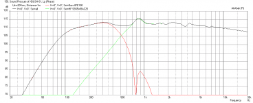

Must say 8FE200 have nice sensitivity data in 95dB, 6FE200 is also 95dB but could not reach low end target roll off.
For all three 8FE200 examples either 2 x38mm diameter ports or 1 x 52mm should do job with the 1mm frustum lip, and spl is for one driver only so add 6dB for dual drivers inside 1/4 wave rule.

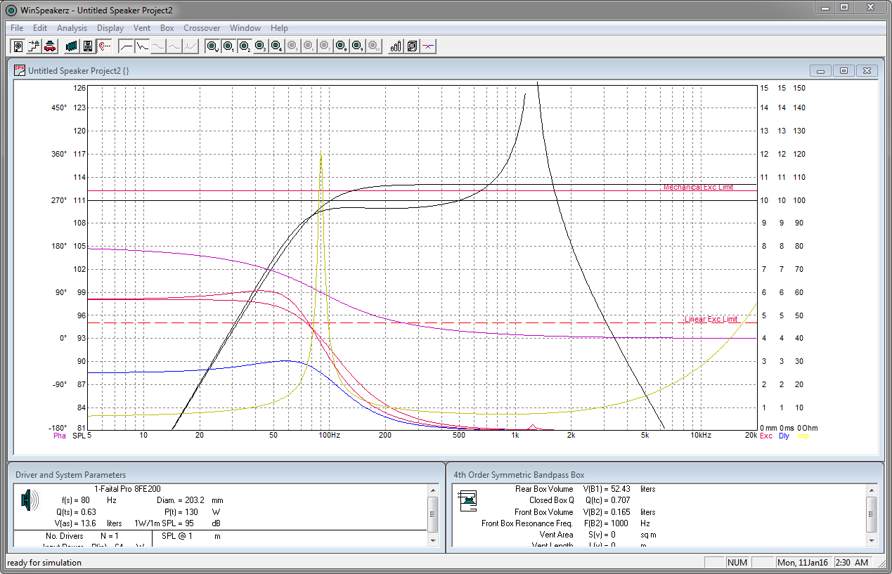

Picture 1:

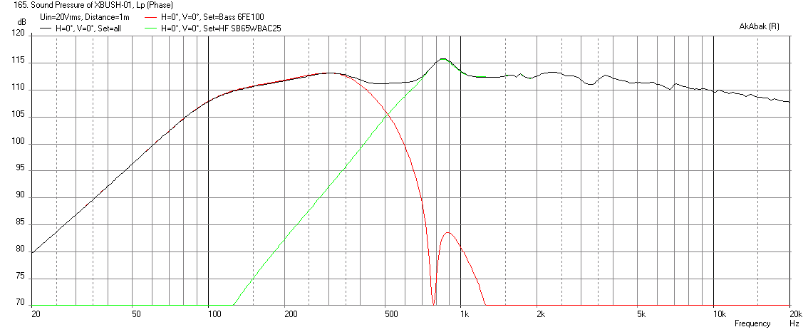

64 watt input sealed Q 0,7 f3 89,78Hz verse band pass with same high volume Q 0,7 52,43 liters back box, 0,165 liter front box with 1000Hz resonance. Comments is impedance resonance is close to our target roll off slope but we live what such for subs and XMax limit lacks so lets look a smaller back box volume than 52,43 liter.

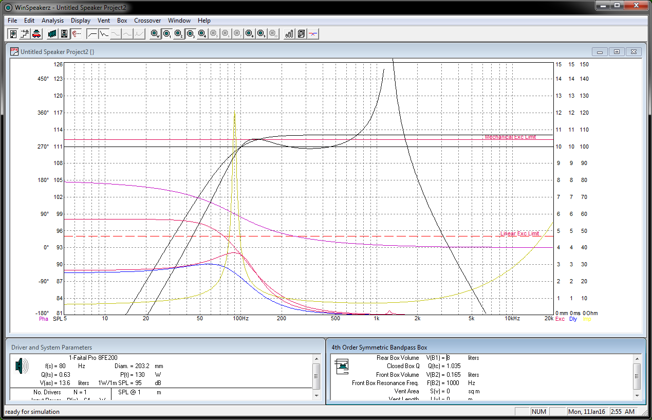

Picture 2:
Same as above but with 8 liter back box it gives overshoot going from 52 to 8 liters volume but low end reach seems lost.

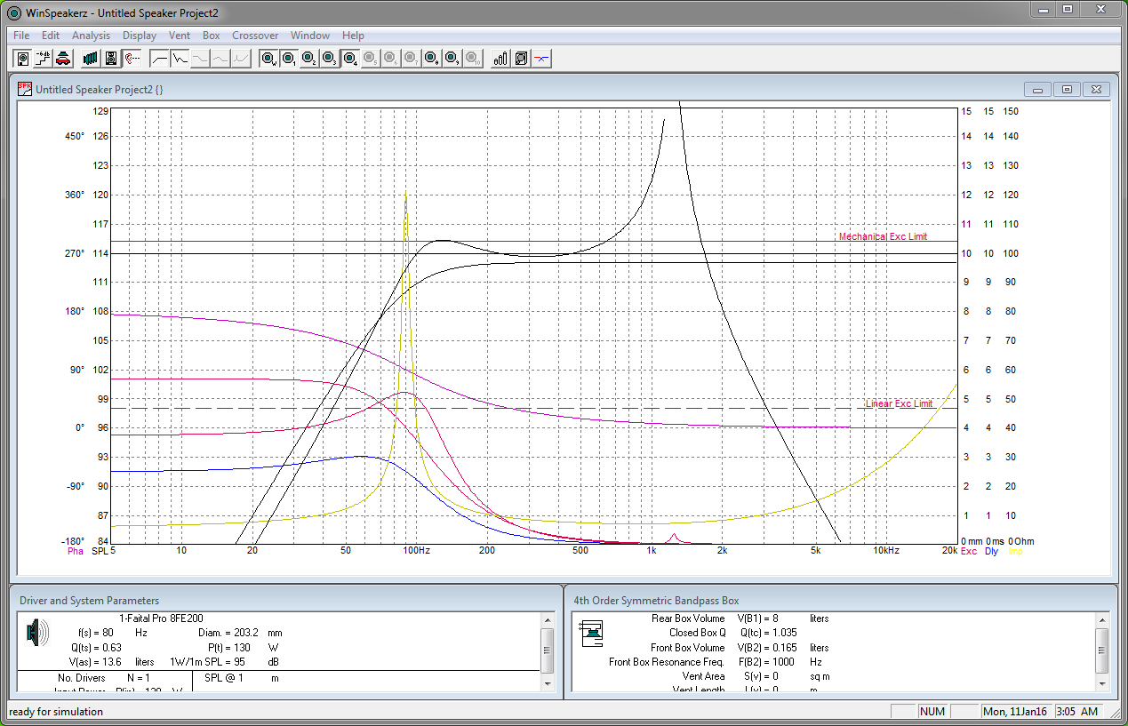

Picture 3:
In that excursion went down with 8 liter back box volume then if feed 128 watt and we see only one driver is close to 114dB in band pass there should be room to EQ overshoot and roll off to a textbook BW2 in 80-90Hz area.
Regarding port diameter like the the smaller footprint for 6FE100 two times 23mm diameter injection ports per driver or with one port 32mm diameter per driver.
4FE35 in picture or 4FE32 looks good as rear mount driver will check later with 4 times those 91dB sensitivity drivers 4FE35 or 4FE32 they both available in 4/8/16 so six configs to check if they can hit low end reach and have advantage in lower diameter for injection port.
Picture 1:
Picture 2:
Picture 3:

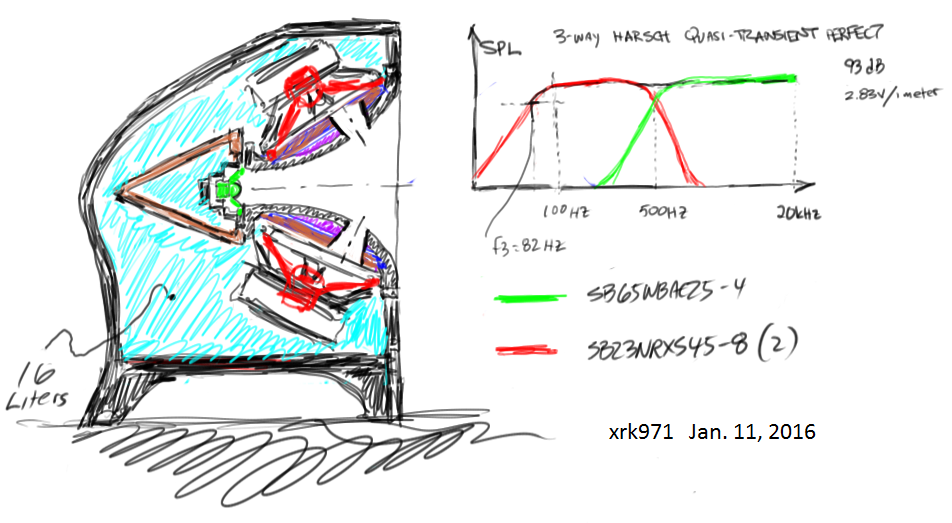

I think this is going to work well with the dual 8 inch woofers.
And for reference, sensitivity at 2.83v is about 93dB:

Just throwing an idea/question in here.
Is it possible to convert the back chamber into a folded TL and then gaining more low-end? And/Or then use 3"/4" full range drivers instead of a woofer. With this you could probably shift te ports closer to the cd mouth.
