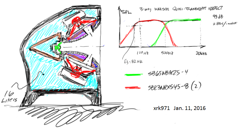

Picture 1 is xrk971's sketch. For fun edited that sketch to band pass forward fire ring port for woofer, detail is something we talked about some time ago. Band pass port is not there to replace electric XO but to bring down ctc distance to less than real center of woofer and improve XO area vertical power response.
Your artistic skills are pretty good Byrtt. You should make more drawings like this 🙂

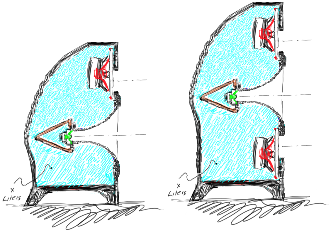

Prismatic boxes are fine - use a few angled walls to reduce reflections of possible but egg crate foam and fiberglass work wonders on straight walls.
We have to go crazy and dream of curved surfaces. Foam core can do that curved stuff just fine. Look at bendy plywood or bendy MDF.
Larger volume is Ok - it will reduce Max SPL. So if you are aiming at hitting 113.6dB Max prediction - then add volume filler blocks (bricks, wood blocks, rocks, etc).

Mainly because it looks cool but it may be needed to keep volume down if you want to get close to 16 liter target volume. A rectangular prism is full of volume.
Have good teacher to learn from : )

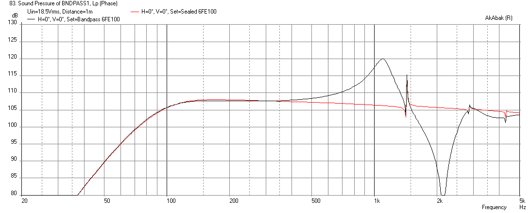

Weird when seen in light of for SB12NRX25-8 our sims were in agreement, then i only see reason one of us have wrong T/S parameters set for 6FE100 or accidently choose closely named 6FE200, but let it be SB23NRXS45-8 will do the job nicely and when lowered in system spl their 60 watt thermal power specs is not pressed.
TS parameters used were correct:
Def_Driver '6FE100-8' | 6in woofer 5.25mm xmax, 100w
fs=61Hz
Re=5.4ohm
Le=0.5mH
Qms=6.0
Qes=0.60
Vas=14.1L
Bl=6.8Tm
Mms=14g
Sd=143cm2

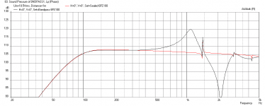

So I went and sim'd a plain bandpass box with 8 liter rear chamber and 165cc front chamber and 65mm dia x 30mm long duct and get a pretty flat response. Although the f3 is now 91Hz. This is with 65Hz BW2 high pass filter so that should not be affecting low end extension.
So I will have to see why it sags when put in the xBush horn.

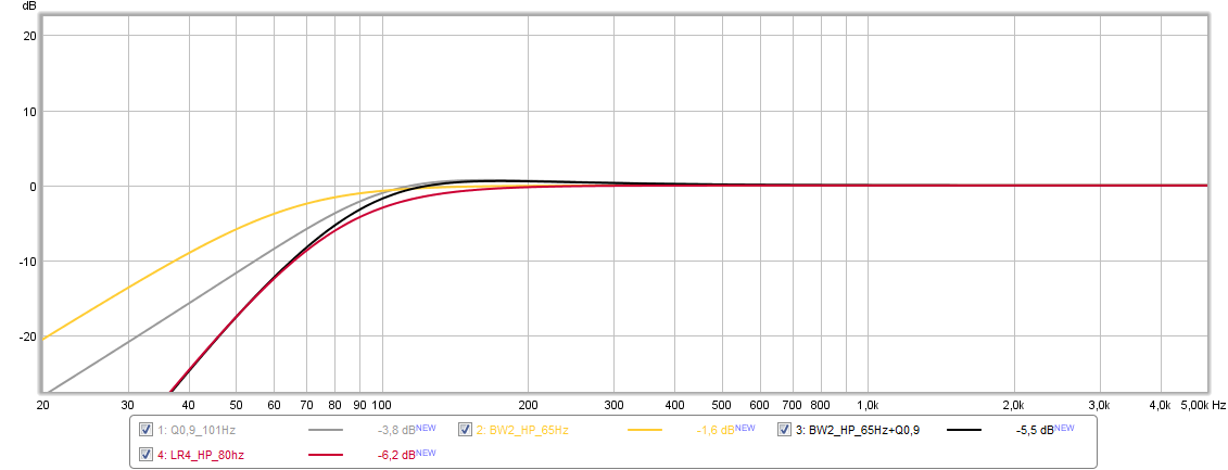

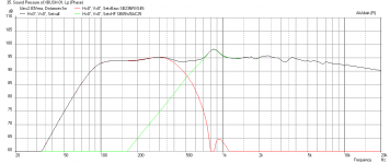

Below example grey trace is BW2 HP 80Hz and same as acoustic output if a 6FE100 live in a Q 0,7 sealed box.
Orange trace is BW2 HP 65Hz filter.
Black trace is sum when they cascaded and looks close to what shown in Akabak.
Think for bushmeister's build target is LR4 HP 80Hz to integrate with sub so show that LR4 HP filter in red trace, cursor at 80Hz -6dB.

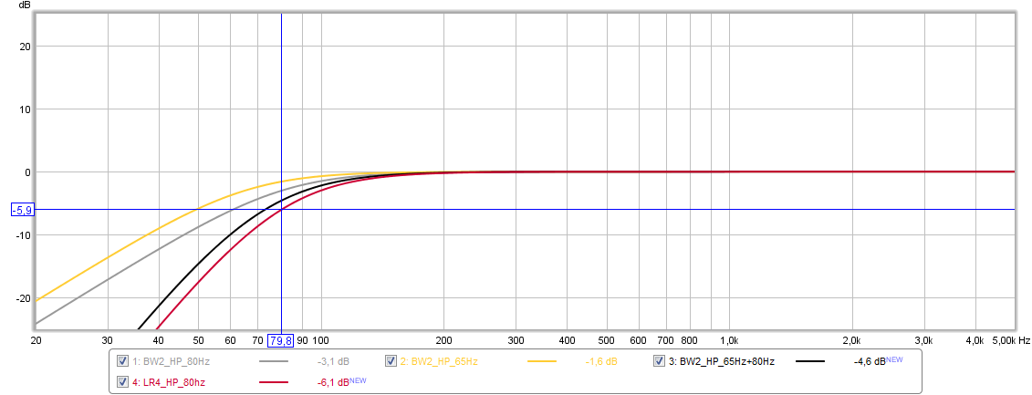

Tried with more precision because when 6FE100 live in 8 liter sealed volume its actual Q0,9/101Hz as in grey trace.
Black trace is sum when they cascaded and looks as Akabak sim.
Black trace is close to red trace target LR4 HP 80Hz to integrate with sub, looks as one strategic right set PEQ would correct black trace to same as red.

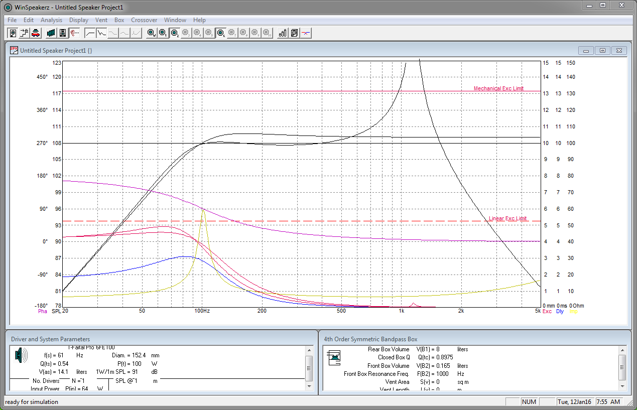

Picture 3 is Winspeakerz 64 watt into 6FE100, one plot is sealed 8 liter the other is symmetric band pass 8 liter back box 0,165 liter front box. Goes lower than Akabak because lack of BW2 65Hz HP filter.
.....This is with 65Hz BW2 high pass filter so that should not be affecting low end extension.....
I did take another look in Akabak and it still slopes down on left like previous sim. I think what is happening is that the WG is providing a mild gain to mids above 200Hz to the right and this makes it look non-flat as if it is the woofer's fault. It's just that the bass over shoot on the Faital is less than the SB23 that it looks that way. I could not find any typo in the script. So probably as you say, a little PEQ can help and probanly either driver can work with the Faital more suited for a flatter Q. The SB23 just actually has more self induced bass bump which in the end - works out flatter acoustically.

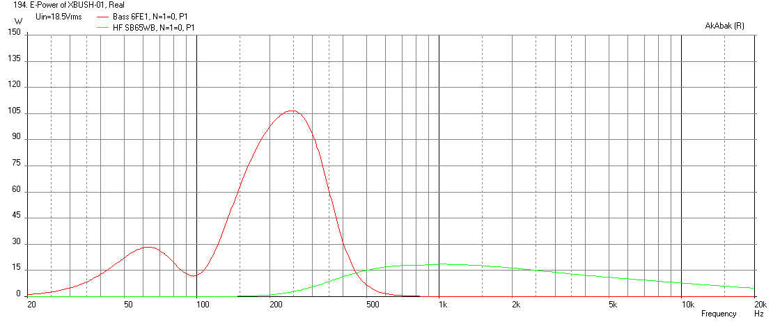

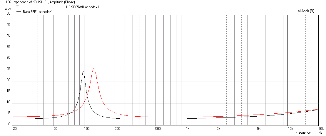

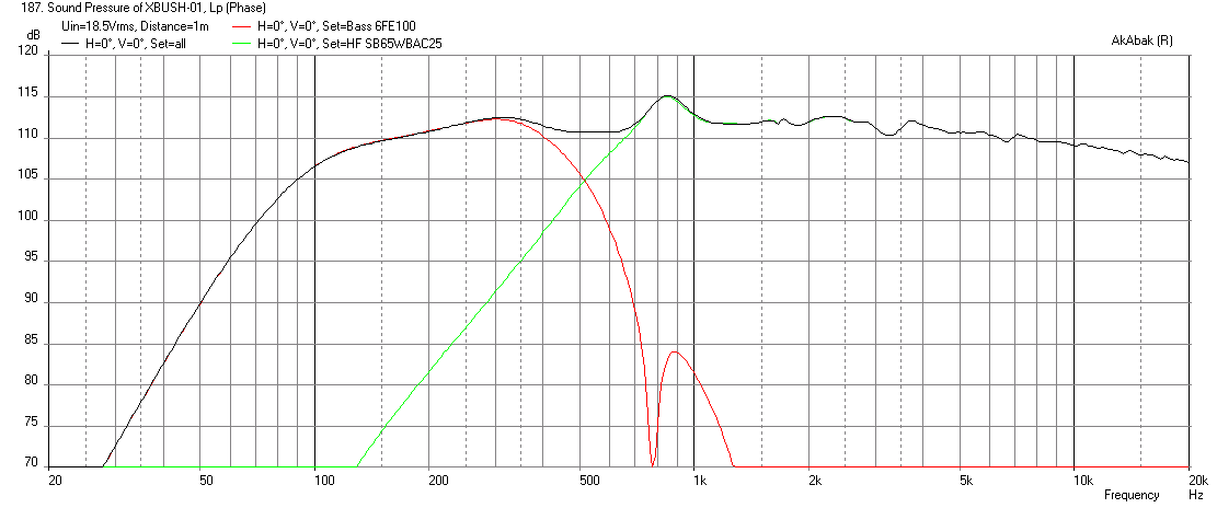

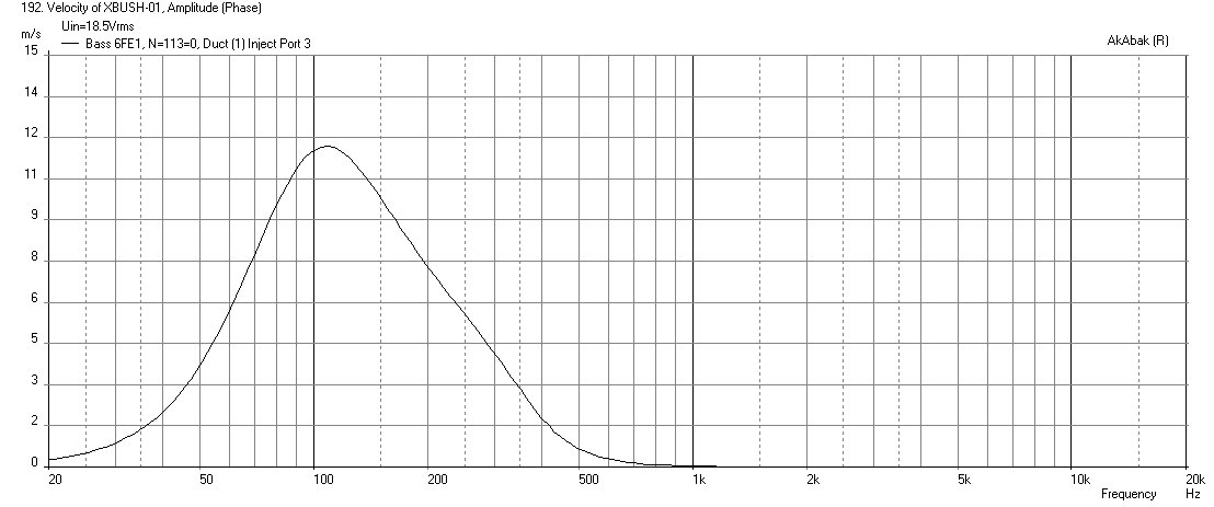

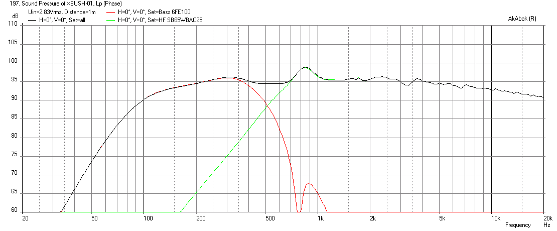

xBUSH v1.1 with 6FE100-8
I wanted to look at all the other aspects of using the 6FE100's to see where there are going to be differences. The biggest thing with the 6FE100's is that they are smaller, so the displacement for given stroke is less and this means that they will be *displacement xmax* limited at max SPL vs the SB23's which will be thermally limited before hitting their xmax. The 6FE100's will be more sensitive though. The f3 of the 6FE100's in this system will be in the 90Hz range rather than 80Hz range for the SB23's.
Here are the results for the predictions with a qnty 2 per driver x 50mm dia x 12m long injection port (making it 12mm vs 1mm gives a little more bass extension). 65Hz BW2 HPF to protect over excursion and cross to sub.

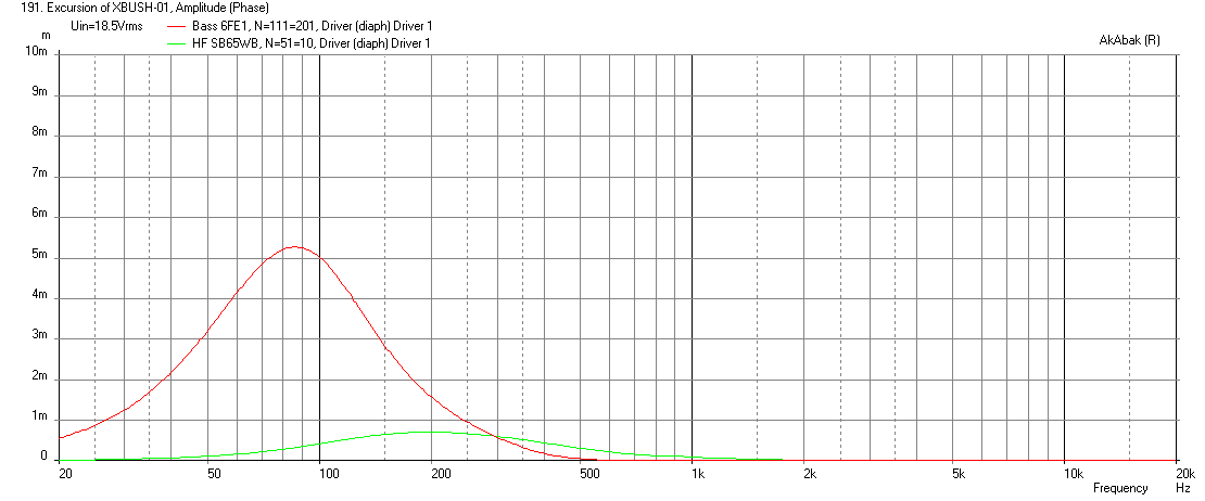

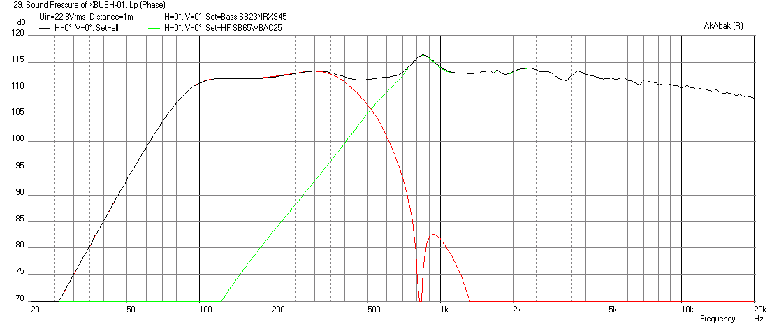

Max SPL at 5.25mm xmax:
Cone displacement at xmax and 18.5vL

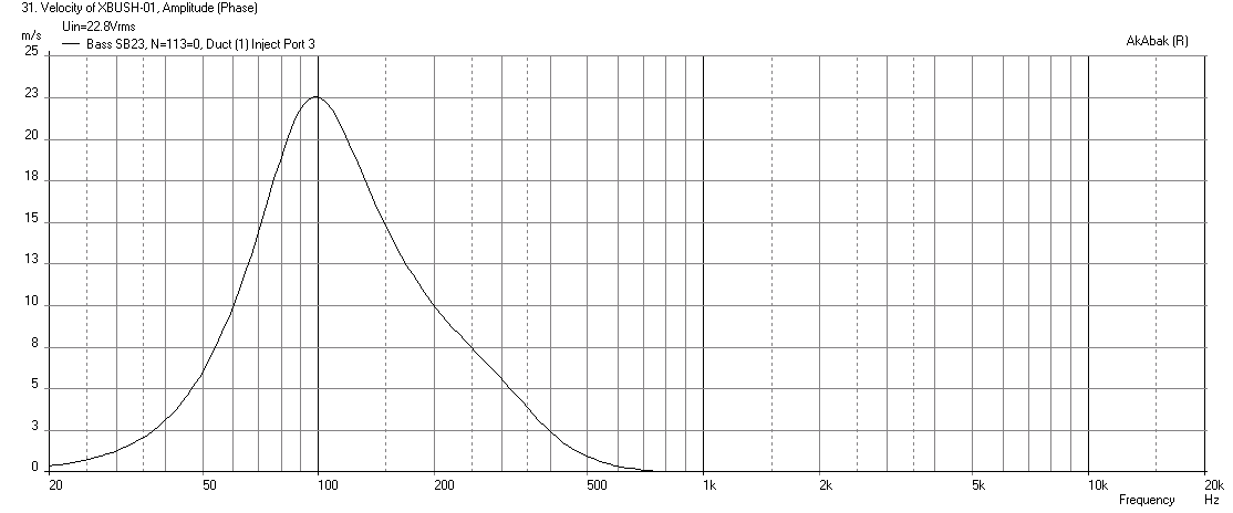

Velocity through qnty 4 x 50mm injection ports:
Electrical power for 6FE100's and for SB65WB:

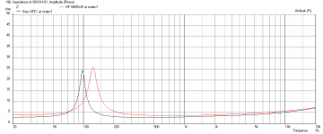

Electrical Impedance for both drivers:
System Sensitivity at 2.83v:

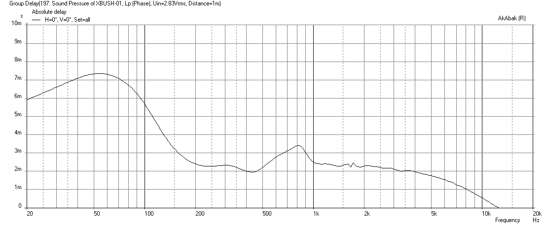

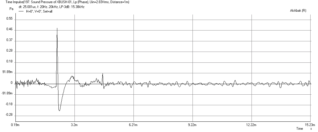

Here is predicted Impulse Response - looks pretty clean ( assuming the SB65WB is well behaved in WG):
Here is predicted Group Delay without any EQ which should flatten it more, and once the sub is integrated the GD rise in the bass should be reduced. It shows that the speaker has a native time delay of about 2ms (also shows up in location of peak for IR), but in general, the GD is flat and will provide nice tracking of frequencies over a broad range with less time smearing.

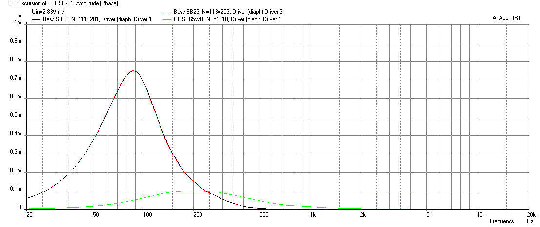

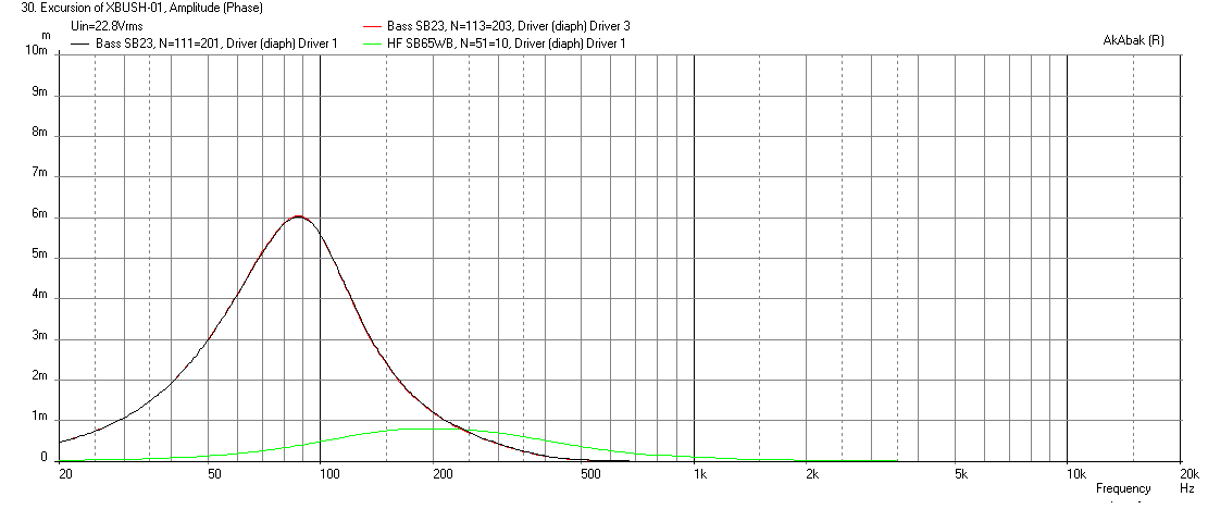

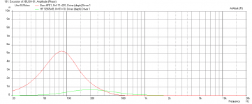

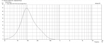

Same sim with SB23's
Just for comparison with the above sims for 6FE100's. Here is same sim but for the SB23's in the same setup with 50mm dia x 12mm long ports, 65Hz HPF, and now thermally limited to 170 watts or 22.8v.
Cone displacement at thermal max:
Velocity through 50mm ports at thermal max is high and will chuff. Probably need to make bigger:

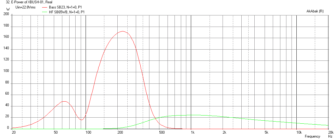

Electrical Power Input (170 watts max):

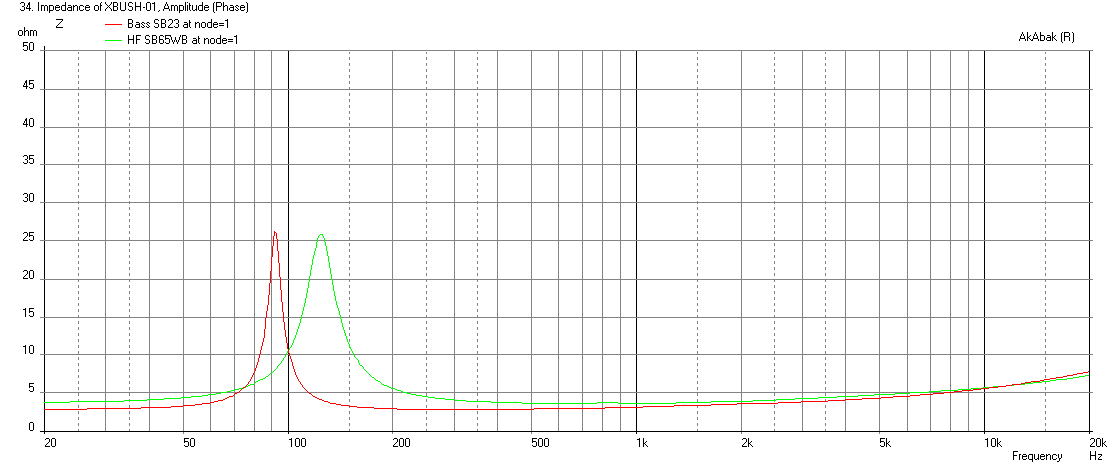

Predicted electrical impedence:
Xbush-01-sb23nrxs45-8-max-SPL-IR-22.8v-50mm-12mm-thick-65Hz-HPF.png15 KB · Views: 1,131
Xbush-01-sb23nrxs45-8-max-SPL-Electrical-power-22.8v-50mm-12mm-thick-65Hz-HPF.png11.6 KB · Views: 1,121
Xbush-01-sb23nrxs45-8-max-SPL-Velocity-22.8v-50mm-12mm-thick-65Hz-HPF.png11.2 KB · Views: 1,124
Xbush-01-sb23nrxs45-8-max-SPL-Displ-22.8v-50mm-12mm-thick-65Hz-HPF.png13.3 KB · Views: 1,125
Xbush-01-sb23nrxs45-8-Impedance-50mm-12mm-thick-65Hz-HPF.png11.2 KB · Views: 1,122
Xbush-01-sb23nrxs45-8-SPL-Sensitivity-2.83v-50mm-12mm-thick-65Hz-HPF.png13.9 KB · Views: 1,609
Xbush-01-sb23nrxs45-8-SPL-Displacement-at-2.83v-50mm-12mm-thick-65Hz-HPF.png13.2 KB · Views: 1,608
So why go through all this trouble to make point source horn besides it has better directivity control and seamless multi-way integration?
Look at the cone displacement at a typical listening level of say 94dB (2.83v) - quite loud actually. The horn loading does a great job of reducing excursion and cone moves 100 microns, while woofers (although not horn loaded) are also only doing 0.75mm of movement. These are all at a small fraction of their linear xmax cone travel so the distortion that normally comes from cone motion is greatly reduced. It should sould super clean at 94dB, and in fact will sound so clean you think it is not as loud and will keep turning it up.
